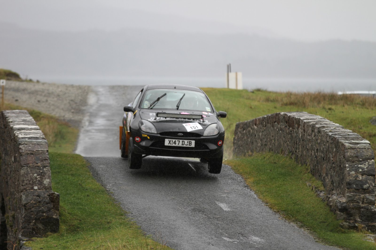

Why was your heart not in the Puma? Just asking as I ran a puma for road rallys and stage for years. You may find that the 1400 is one of the most competitive classes as you need to spend to get results as you will be down 50-70bhp down.
You would probably be better in a MG zr in the 1400 class to start with.
But at the end of the day it's your choice and if you want to do something different in that class why not!

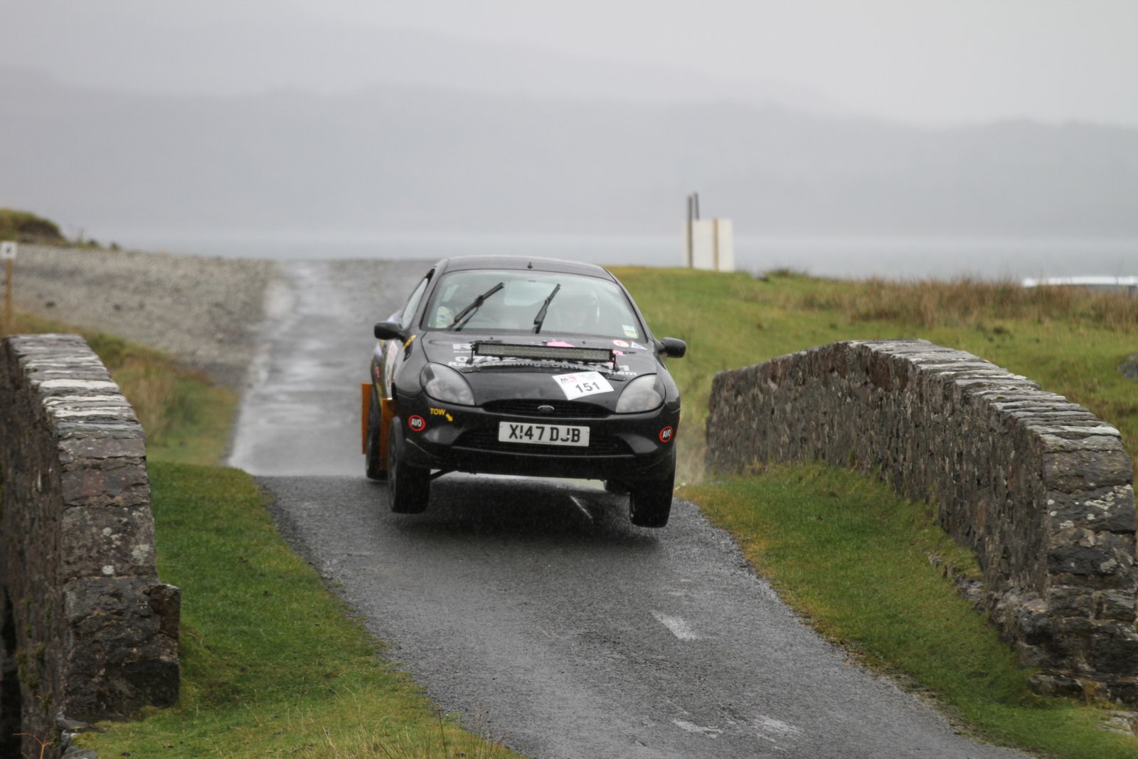

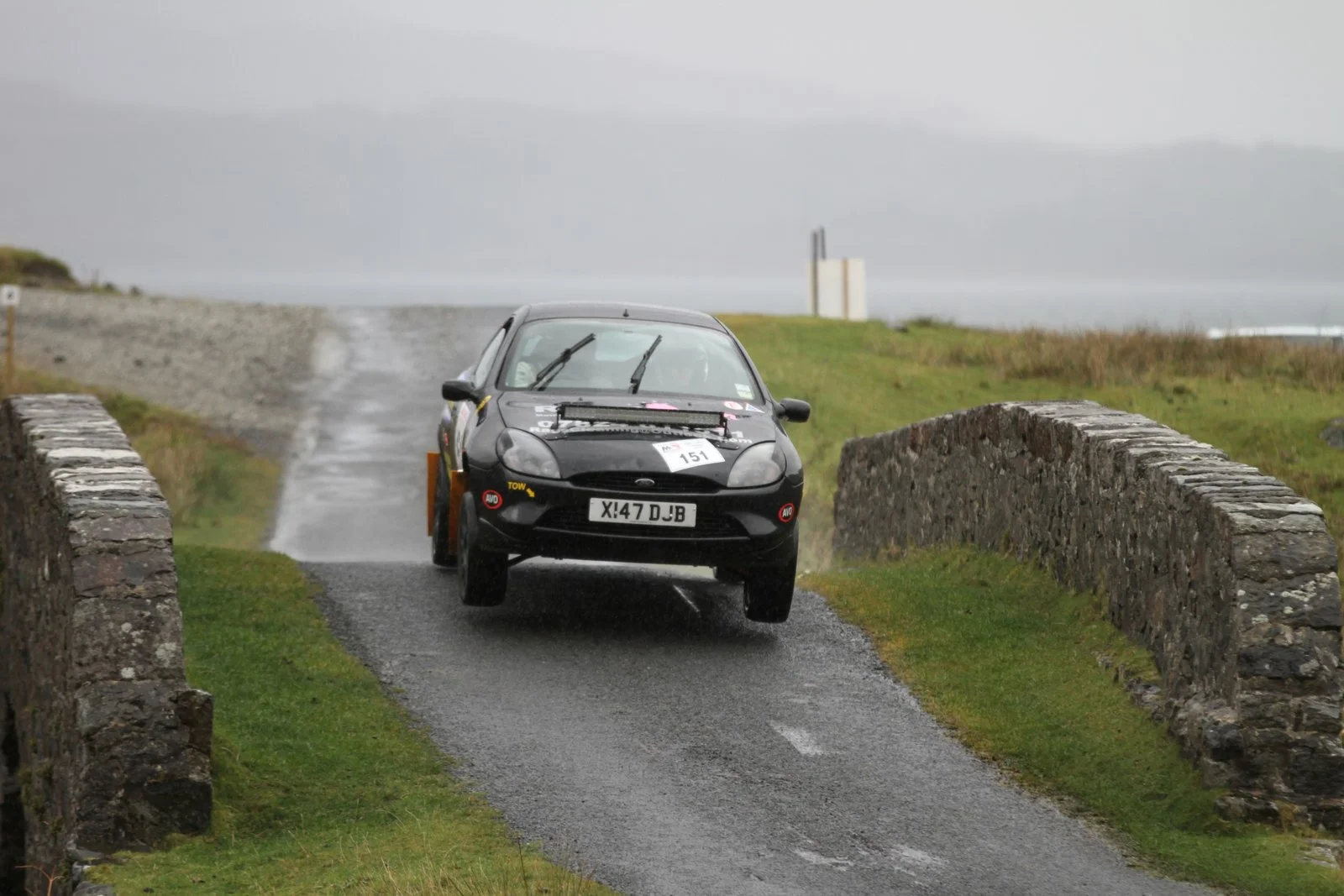

I had it for around 8 years and it had done over 100 events the rear arches ended up being the usual puma rust but it wasn't the worst out there by a long shot.
Its still going somewhere so I can't of built it that bad lol.
