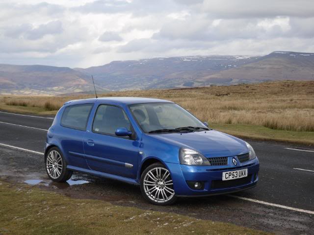

I have 17's on my RS now and I love them. I dont care what people say about them and as for the 'handle like s**t', my car doesnt so that rubbish. What difference does one inch make on the way the Clio handles? Nothing...
