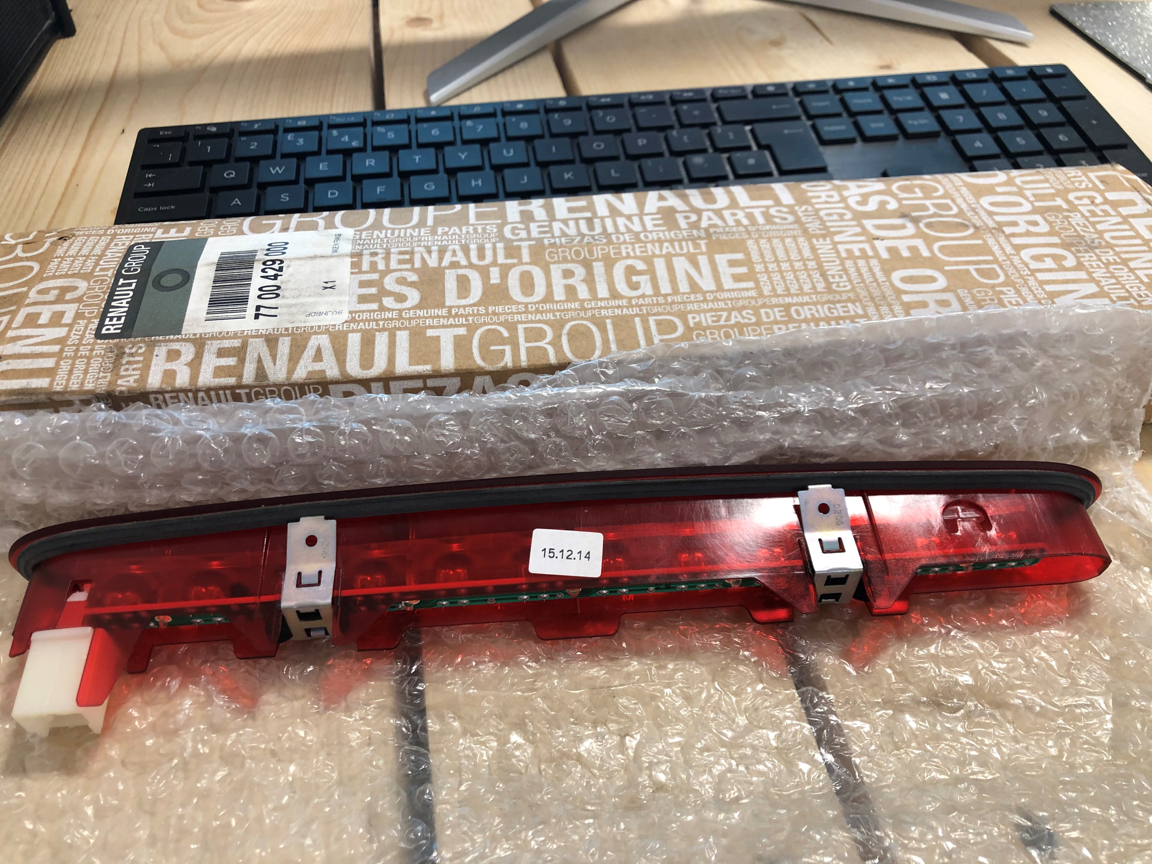

They are about Fishfire, this is my spare in case i get a 182 one day but you can see the part number etc.
They're rarer than hens teeth!

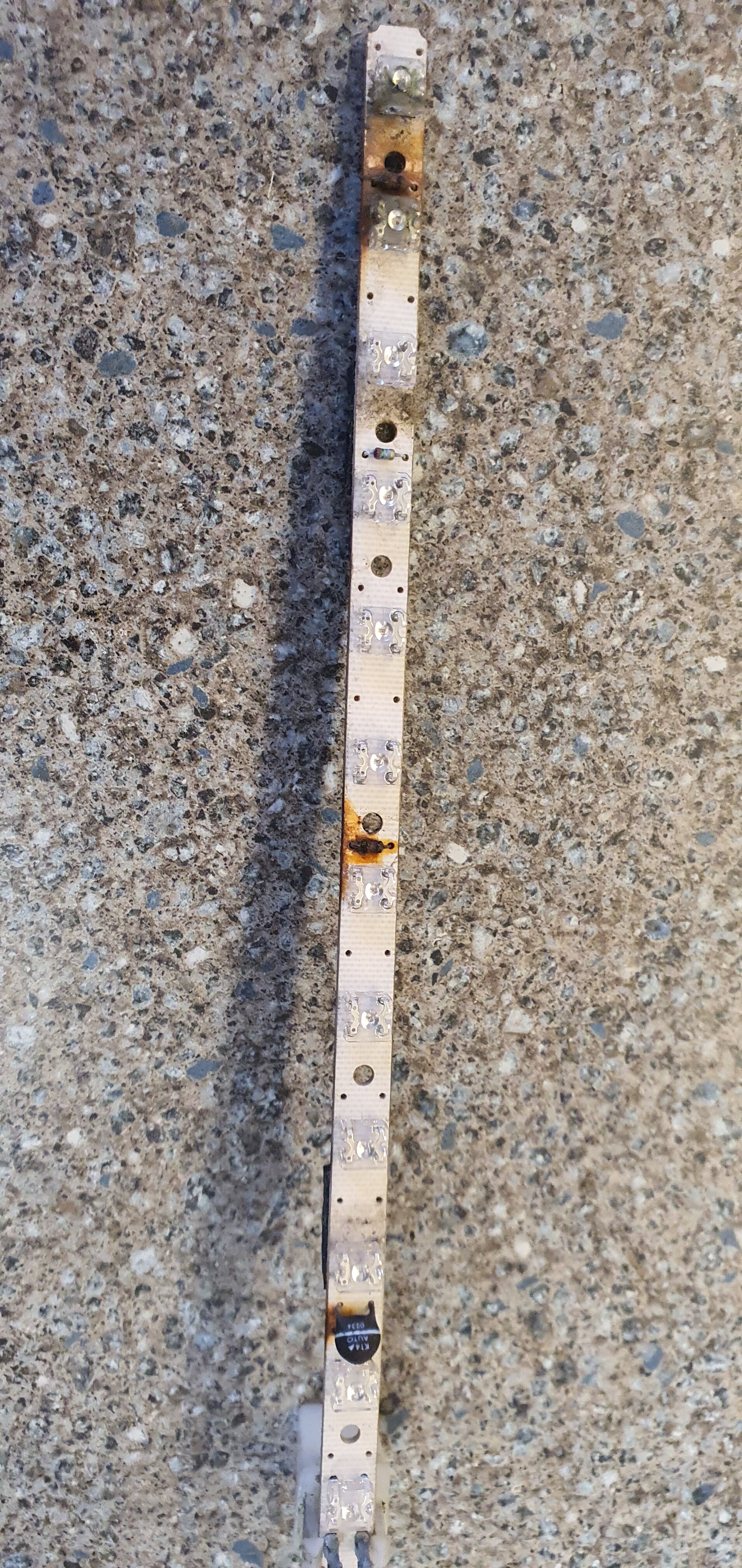

On a plus note I've got my brake light out, and can confirm that the LED strip is totally FUBAR 😏

I've rescued the lense on mine, although the LEDs are fried. I'll put a new LED strip in there which has worked for a few people from what I've read 😁

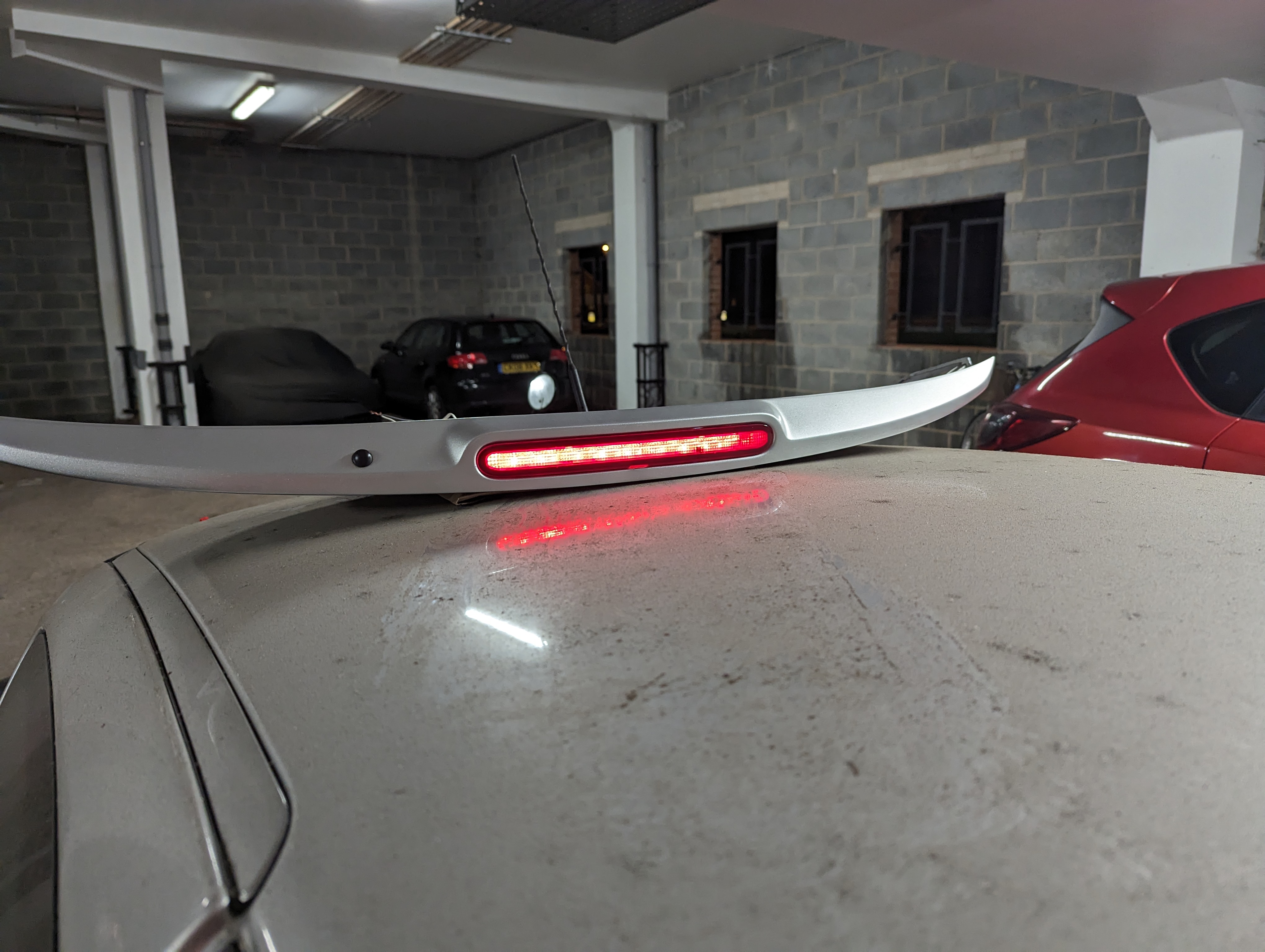

Boys , use a 300mm 12v led light strip from Toolstation.
Works a treat.
I used the spine of a dvd case to stick LEDs to, and then wedged that into original red valeo light housing. Original metal clips then hold it in place nicely. Leave the original circuit board out.
Use solder and heat shrink. Don't just twist wires together for gods sake.
Works a treat.
Use solder and heat shrink. Don't just twist wires together for gods sake.View attachment 1627794
