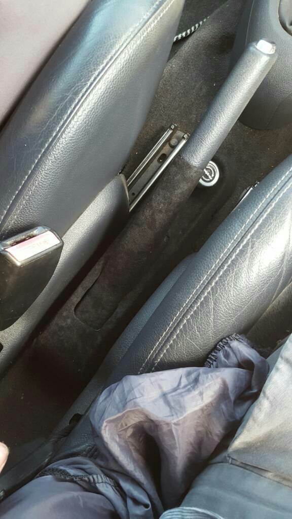

Yes it will go 50/50 iirc you could plumb in a bias valve as i have in mine
Just unplug the abs harness under the car located within the front passanger a-frame. Don't listen to all the hype of "you'll die if you pull the abs" yeah its not ideal on the road but works great on track. I'm gonna plum in a bias valve eventually like above.
Here's mine with 50/50 bias on track...
