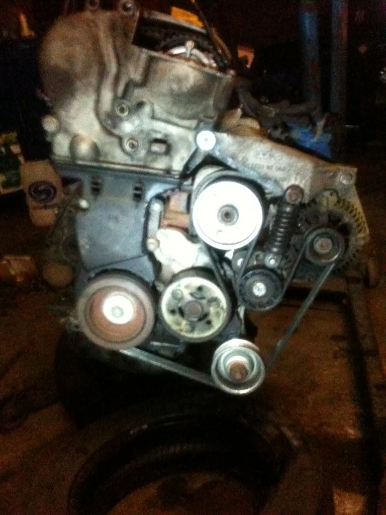

he used the original tensioner and a bigger bottom pully. i think its of a toyota avensis, ill double check

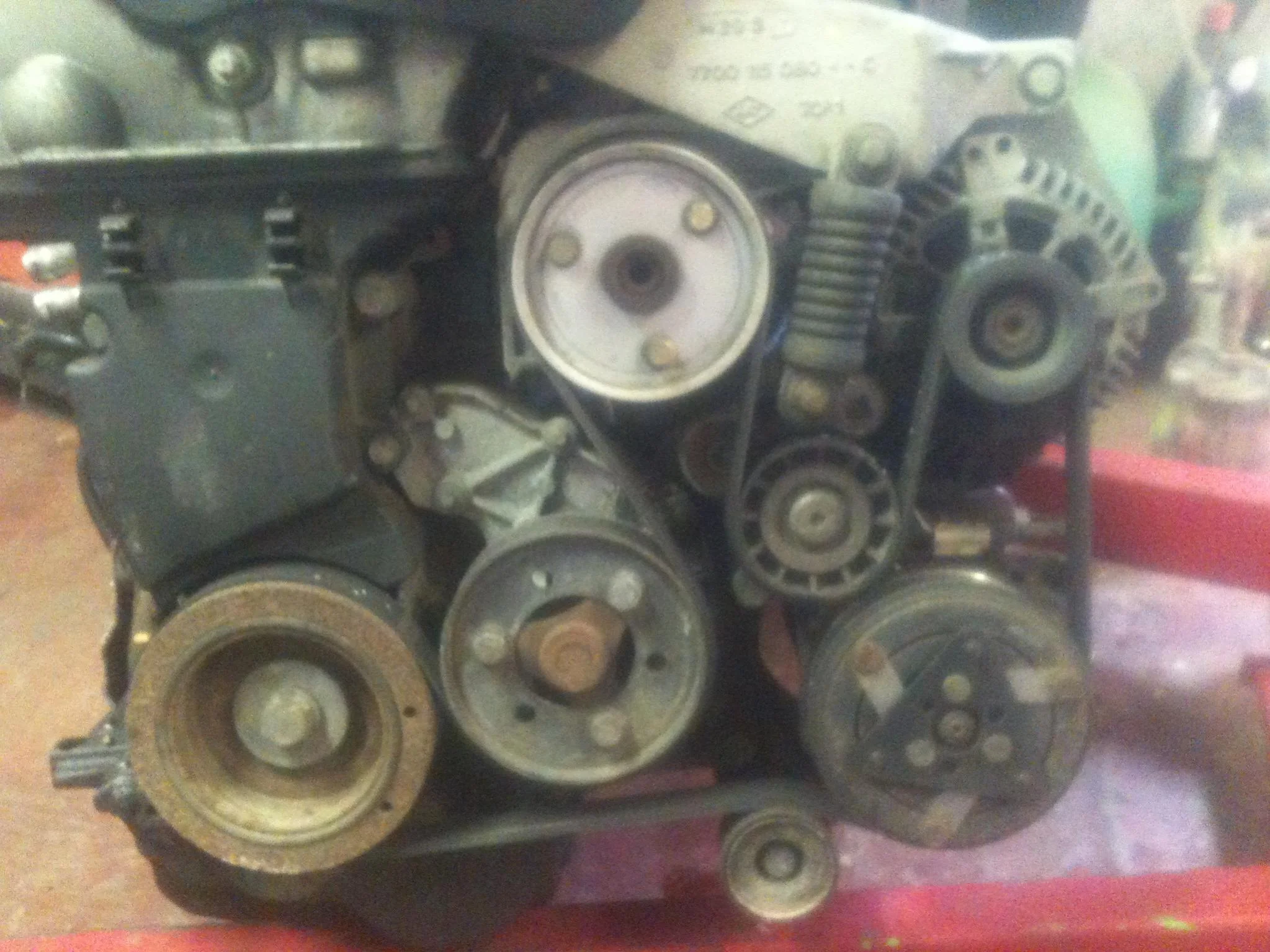

ye thats the thread. as far as i see it bolts in place of the original, even if the new pully was bigger or smaller you can easily get a belt to suit
But it still runs round the same half a dozen pulleys plus uses the tensioner. :S
The only advantage is going to be weight saving.

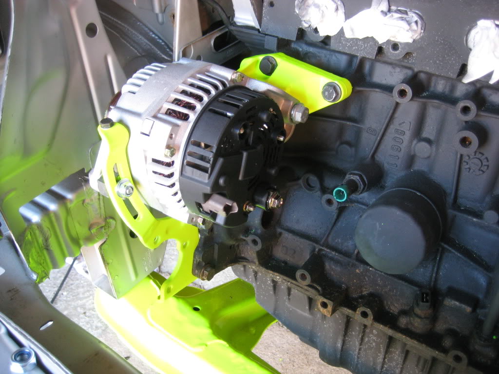

Not the best set up for you as I removed my pas too. Brackets cost £10 and I just bought a new alternator!
Only runs the crank, water pump and alternator.
Sure less belt drag would be more of a advantage than the 15 odd kgs you'd save in weight.
Wait till your alternator packs up then the ''proper'' conversion will only cost roughly 20 quid ;)
there will be less belt drag when the ac pump is removed and less weight. i cant see there being any noticable gains doing it the proper way over this method
Depends exactly how must belt drive zaps performance in the real world. With your set up, bar a idler its pretty much the same b/track as the normal AC set up.
Other downside is the tensioner is still utilised so no ease of belt changes like you get with the Cup set up plus you would still have the expense of a tensioner which again you wouldn't get with the Cup.
