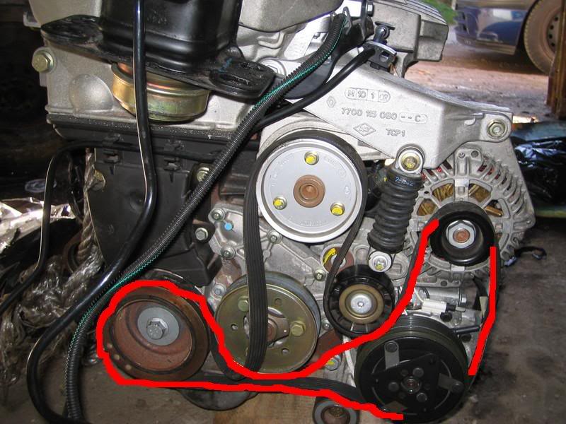

just a quickie i know alot of people have deleted the PAS pump from the 172 belt system how did you go about it
also how the hell did you go about sourcing a belt
cheers
something along these lines?
might aswell just leave the ac pump there use it as a pulley
