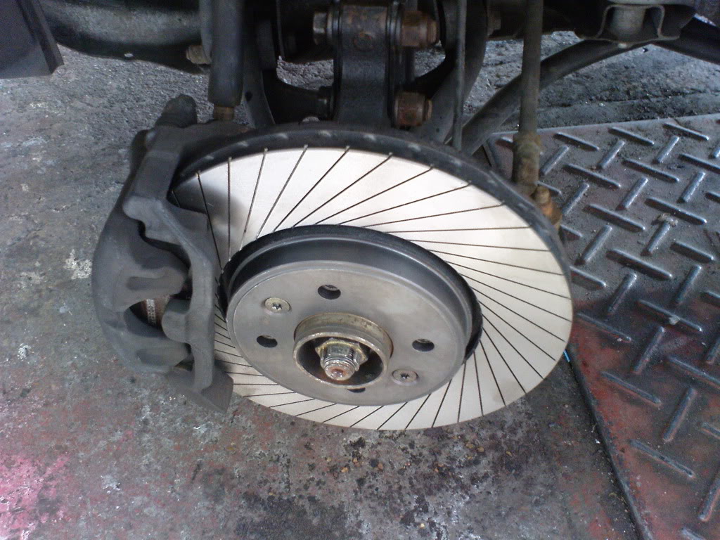

Brakes are already fairly decent. My setup is Tarox G88 front discs, oem rear discs, DS2500 pads, Goodridge lines and Castrol Super Response Dot4 fluid. Never had any fade at all on track.
Picture of my discs
All you need is ds2500's, brembo hc discs and braided hoses. But watch this space re pads;)
