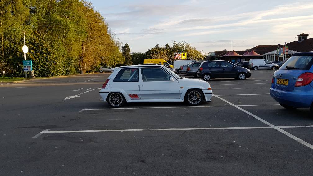

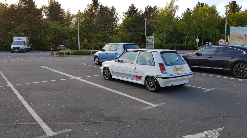

172 Clio into an R5 GTT
  R5 GTT
Bloody hell, that’s some serious power! What the engine and turbo specs?
Phase 1 172 engine, STD head with catcam valve springs, bottomed end, wossner pistons, arrow precision rods, forged crank, ACL race bearings. Gen2 gtx2867r turbo with .86 rear. 630cc dekas. Helix full Paddle, adaptronic 440d
Custome exhaust turbo back.

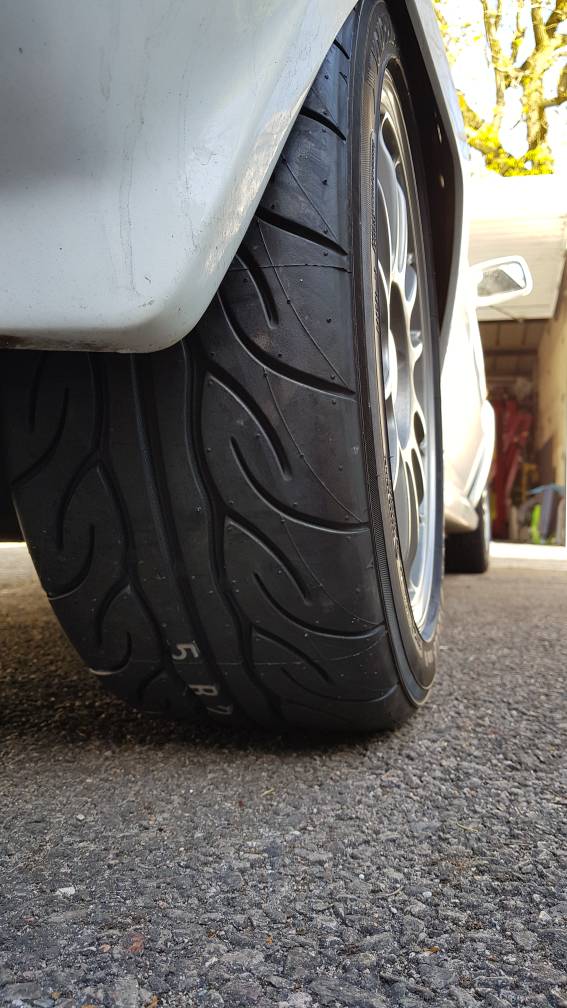

  R5 GTT
New boots yesterday, couple of external shota
