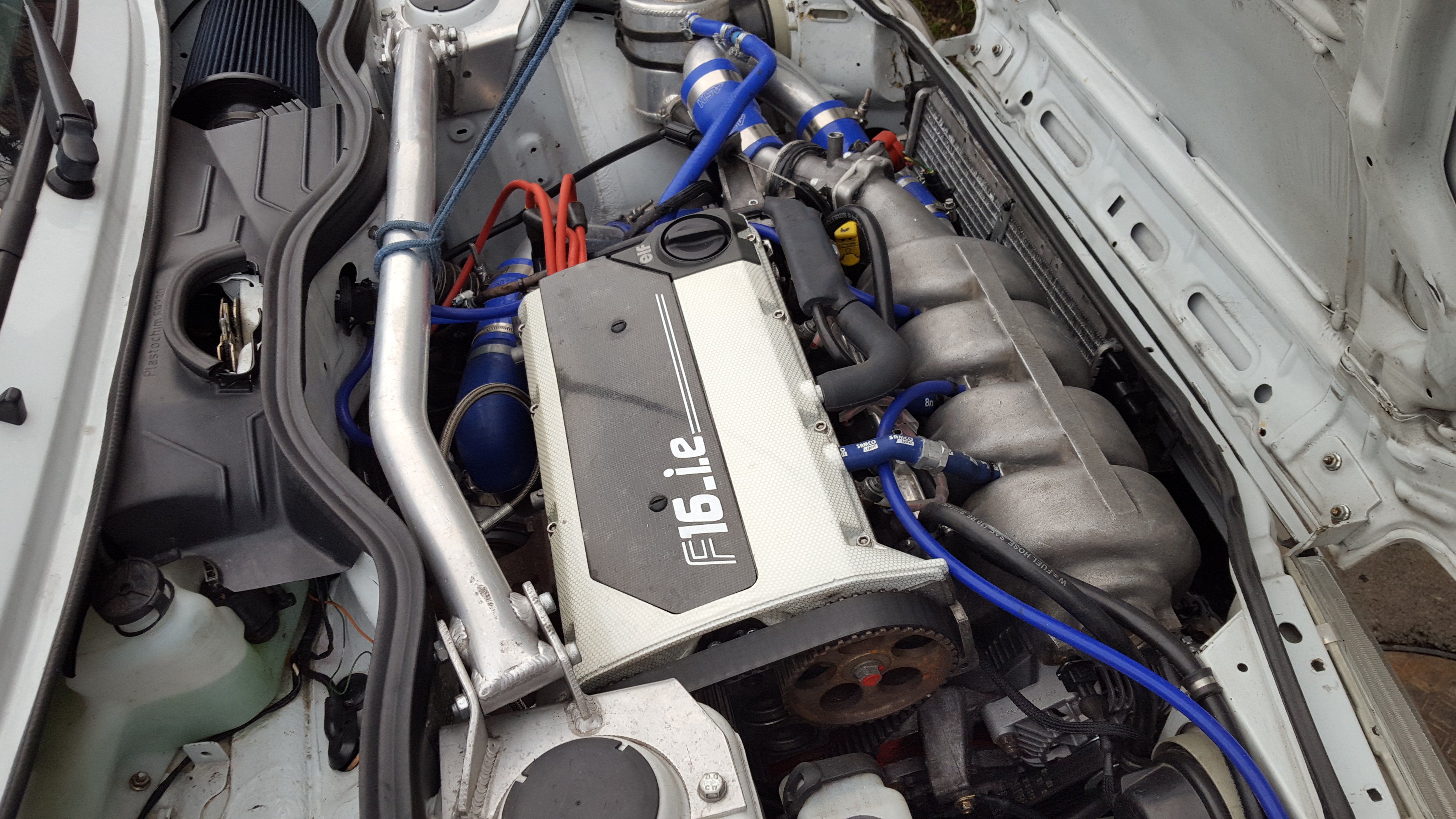

Well should update this there was good news and bad news.

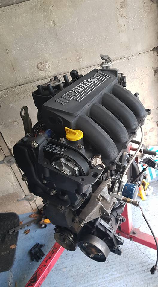

Good news is she started and ran for a few secs the bad news is the engine was not as good as I was told she turned into a smoker straight away comp test showed number 3 was down to 45psi all the other were about 150psi

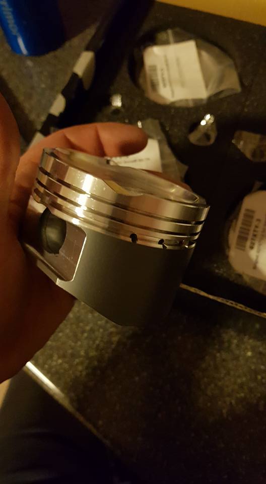

Engine is now like this

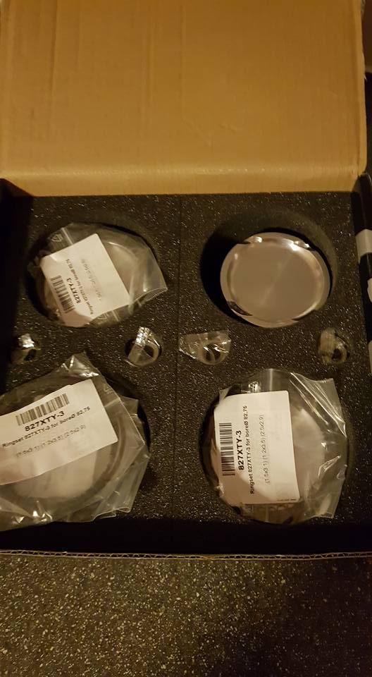

JE Forged piston
JE Forged Dished piston for low comp
Removed number 3 piston and found the top 2 rings stuck in the piston once removed found damage to the ringlands as per below luckily I have a local machine shop whom are look at it and i should be able to fit some standard size rings in it once they have finished sorting it as the JE Rings are thinner than the OE jobs

Yea of no faith, she is fully running properly now. Turned how to be down to injector O ring not sealing against the head properply

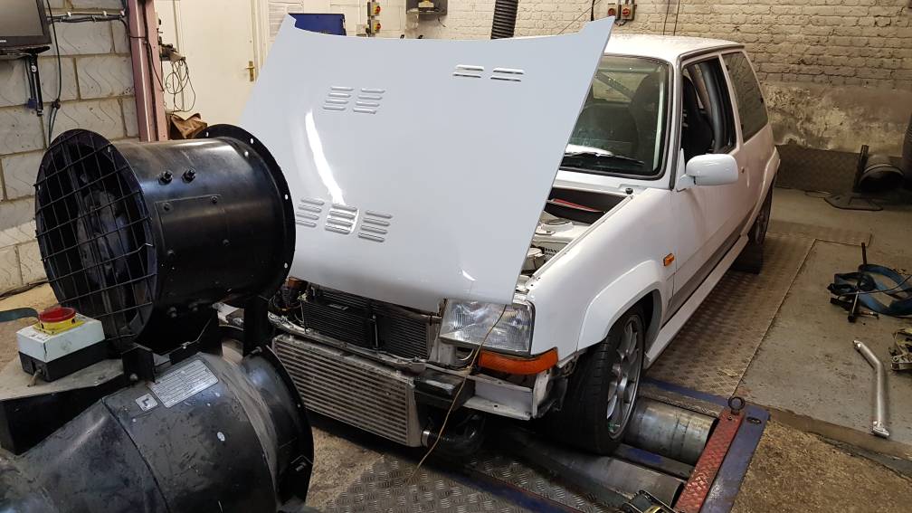

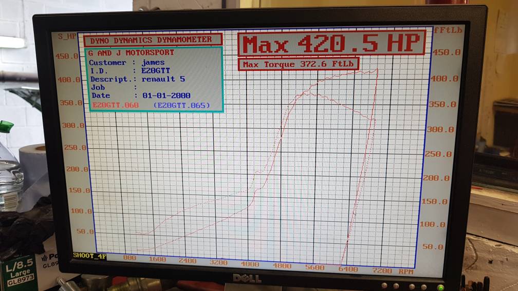

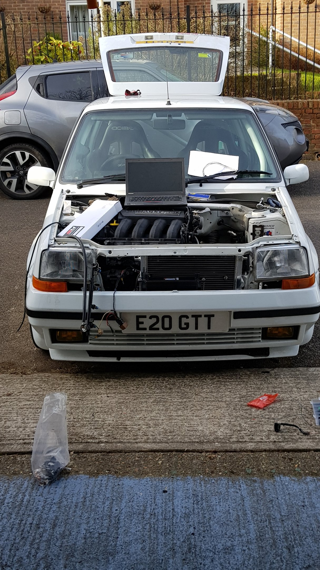

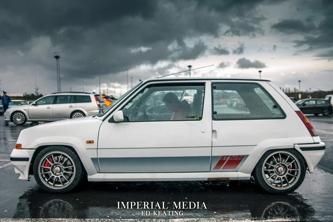

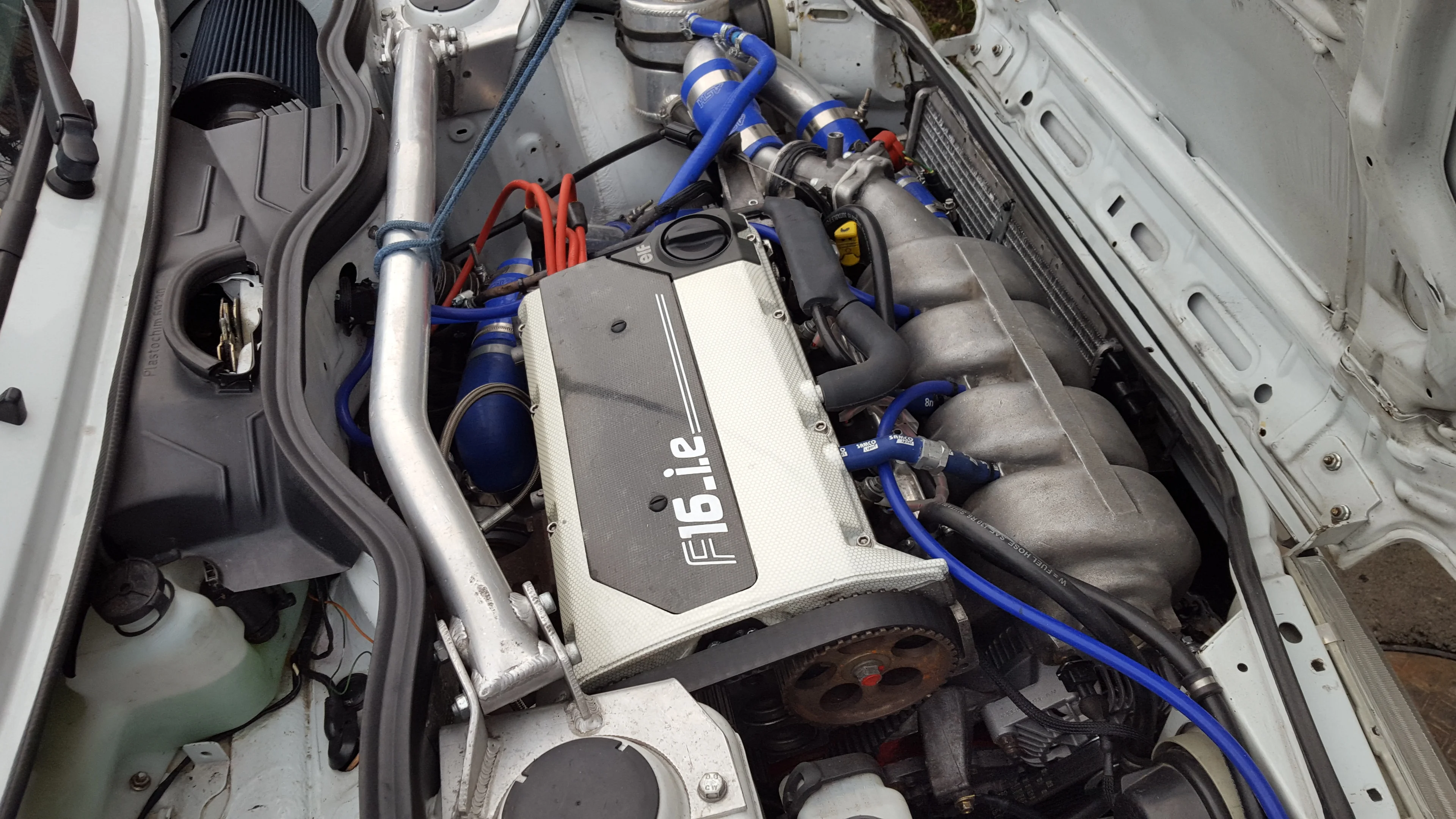

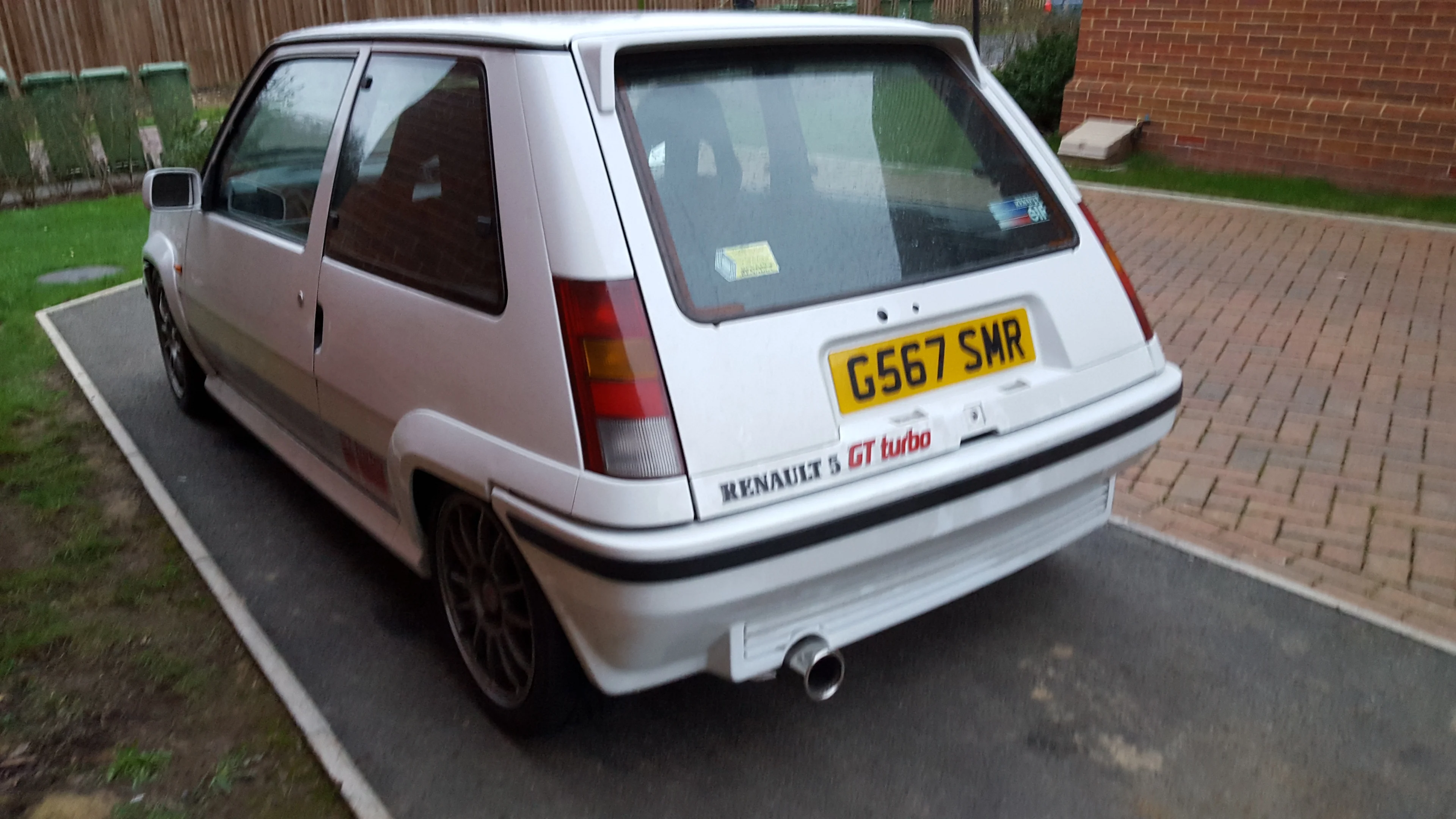

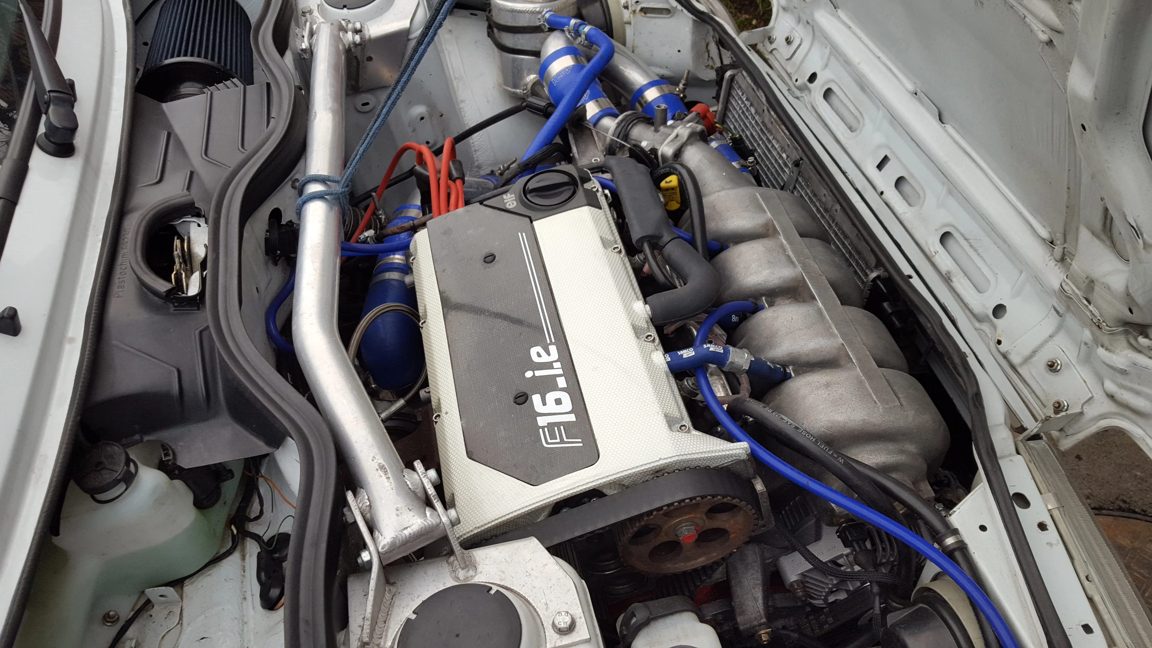

Crikey been a while since, I have been on here, anyway still not really a clio yet another R5 GTT, they I have done an F7pt conversion currently mapped and sitting @330bhp@18psi :).
Small video (Just to add this was me testing out my new camera and genuinely done with out exceeding any speed limits). Was scared of camera falling off.

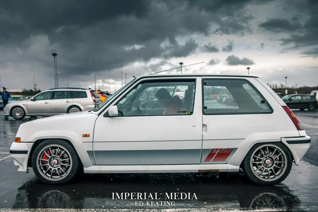

Have to ask but how do you go about putting that sort of power down? What do you use the car for? Looks like a road car? :confused:
I use the car as a road car but like to use it at Pod. Don't do track days due to how hard it is to get parts for the shell.
The only parts of the car that are standard gtt are the shell suspension, dash. I run 172 rear hubs and fronts, JC5 box with quaiffe (Currently broken so on a diesel box at present). power in the wet and cold is no point even trying just wheelspins. In the better weather and warmer tarmac / asphalt still wheelspins but still manages to push 450bhp+ evo's etc.. out the way with just not so good in the bends
