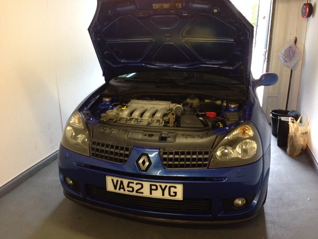

Had my 172 Cup now 2 months after buying from forum member Harry. Always fancied one at some point and thought now is a good time as prices are fairly low now. Owned a Williams 3 and a ph2 172 before so nice to compare it to them and get into another Renault Sport Car.
After searching for a month I found this car and made the 450 mile round trip to collect the car and bring it home.
The spec was perfect for what I was looking for,
RS Tuner 98 Ron Map
Ktec stainless stealth exhaust
ktec/vibratechnics engine/gearbox mounts
powerflex purple dog bone mount
ITG panel filter
Ktec solid top mounts
Eibach solid top mounts
Cup dampers
brembo HC discs
goodridge braided brake lines
whiteline ARB
carbon front splitter
speedline 2118's 15"
yokohama neova ad08 x2
yokohama parada spec 2 x 2

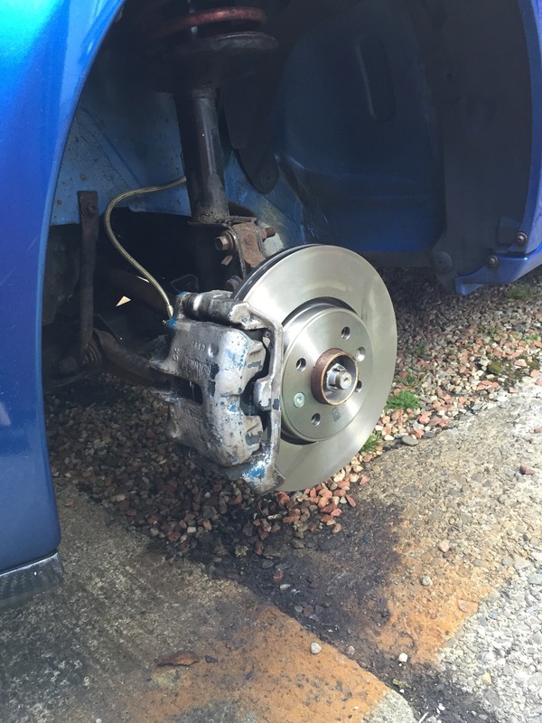

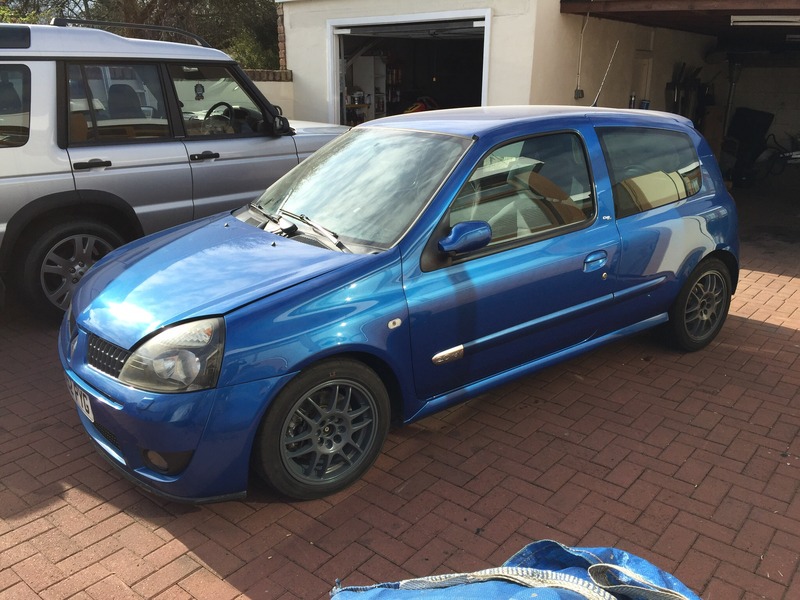

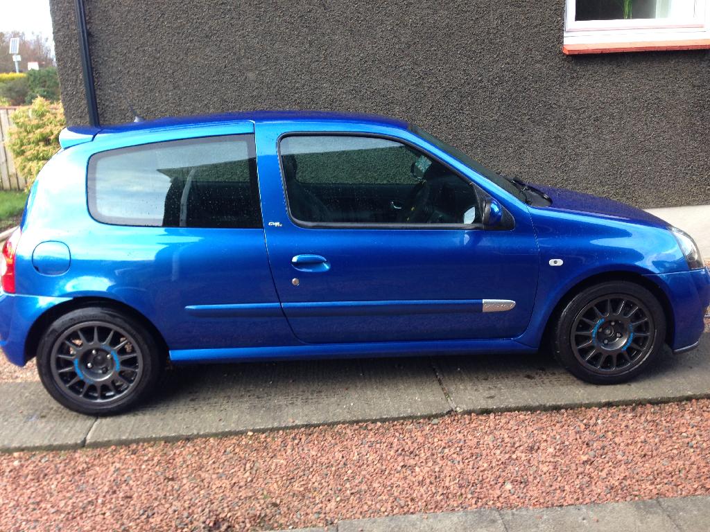

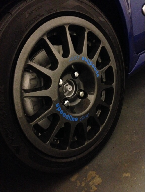

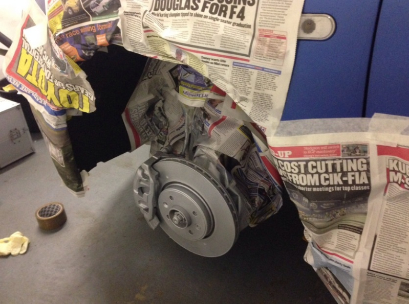

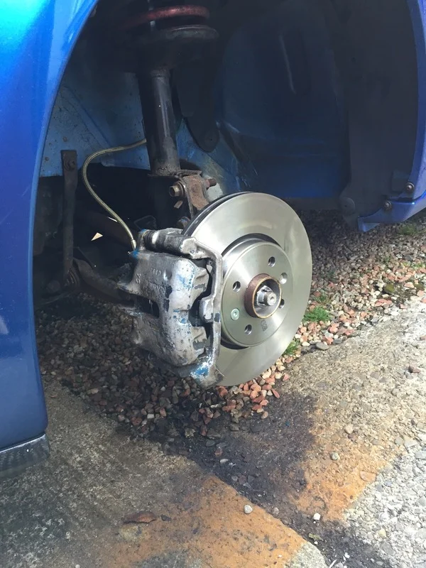

The car was in fantastic condition so no real major work needed as all recently serviced inc belts etc. All that I wanted to do was freshen up the brakes as they were painted blue and tone down the wheel colour of the 2118's as White was a bit too loud for me.

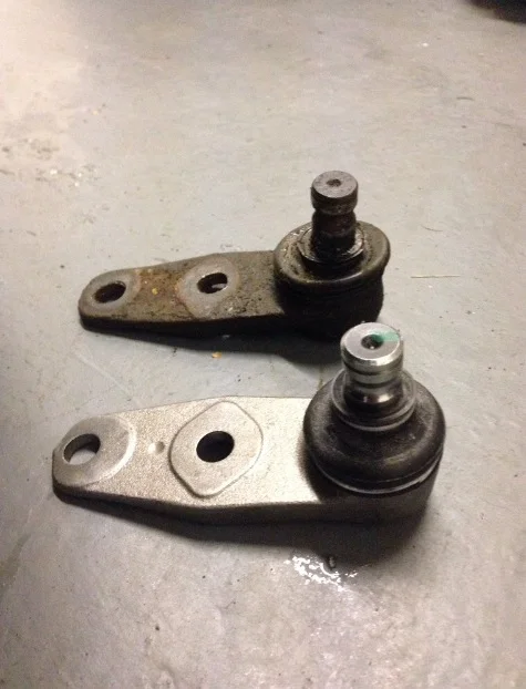

also decided to put some new bottom ball joints on

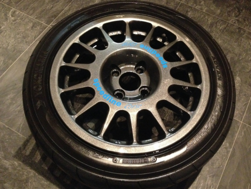

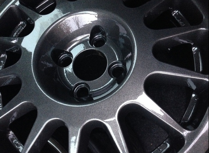

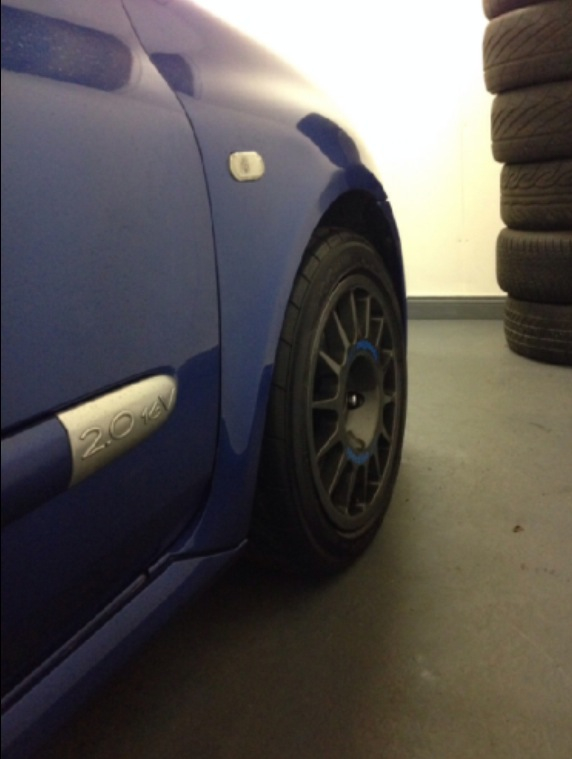

Got my wheels refurbished in anthracite grey
very happy with them and the finish is excellent. I also ordered some blue speedline decals to coordinate with the body colour.

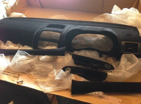

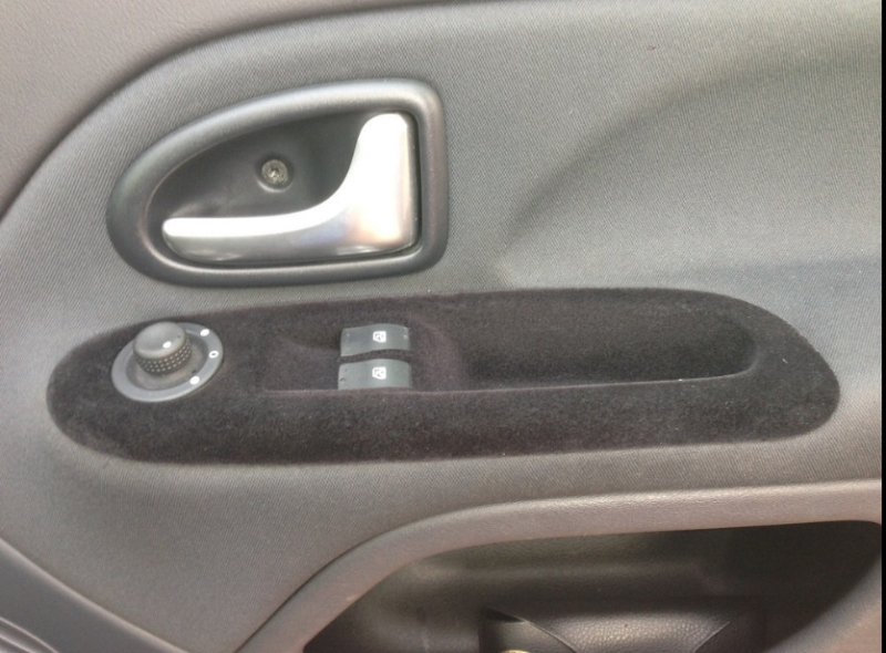

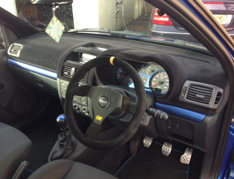

Wanted to do something with the interior as you all know Cup interior is fairly boring, decided to get it flocked.

Main things I prepped for this was oil/filter change, brakes were also serviced and Brembo HC front discs and Ferrodo ds2500 and fresh fluid. Spanner checked all main arms/joints. All good no problems.

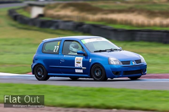

The cup ran perfectly well on the current set up and would be a great start off point for anyone wanting to get into track days. Lapping at 1:03.8's in traffic and having a bit of fun. I however was looking to alter and change the set up going forward. I needed the ability to dial out the mid and corner exit understeer and also more more feel through the steering from corner entry. Corner speed was where I was losing most time.

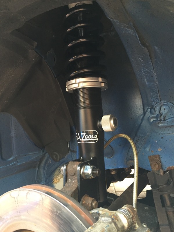

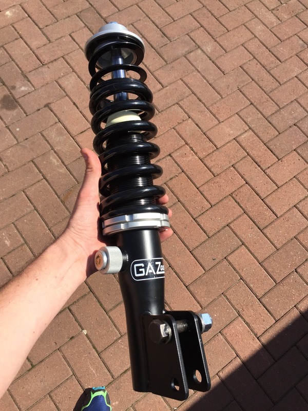

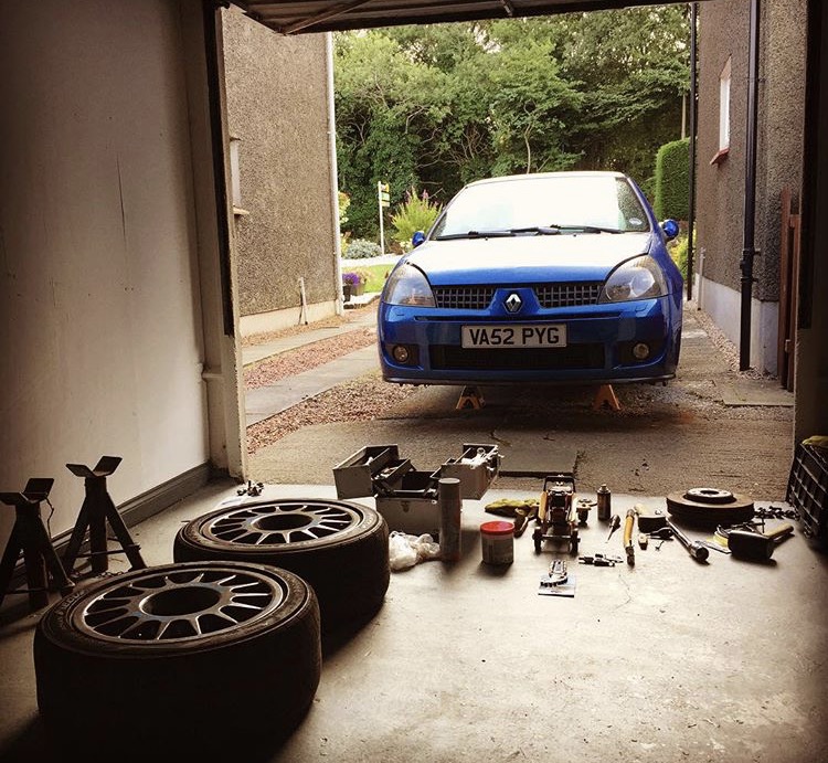

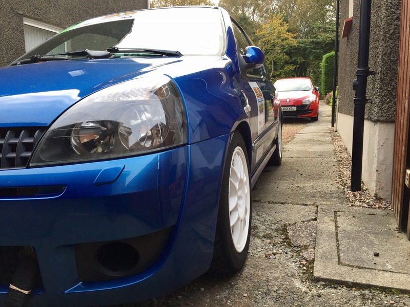

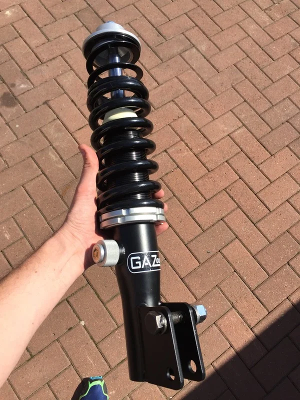

After a bit of price comparisons and speaking to a few guys I decided to go for a set of GAZ Gold coilovers up front and I kept the standard rear location set up of separate spring and damper but also changed them to GAZ gold. Reason for no coilover on the rear was to comply with road car regs for SLS series, damper units/springs had to remain in original factory location. These were going to be perfect for what I needed for the Cup and at a fair price of £900 all in.

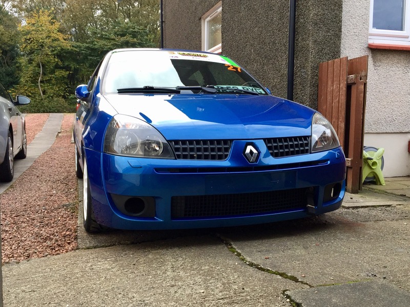

Fitted and sitting on the tarmac. Not set up at this point so little high at the rear. Also had picked up a cheap set of original OZ F1's from another forum member. Had them re furbed and would be my 2nd set of wheels for older/newer rubber.

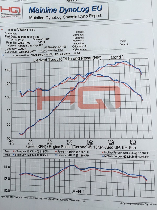

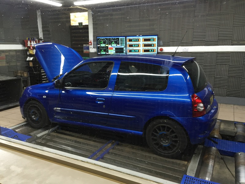

Next up was to get the car power tested on a rolling road and weighed. I made the trip to Performance HQ in Fife Scotland.
On the rollers the engine performed as expected, a healthy standard wheel power of 146bhp and the graph curve looked ok.
Weight wise it was 1086kg with half a tank of fuel.

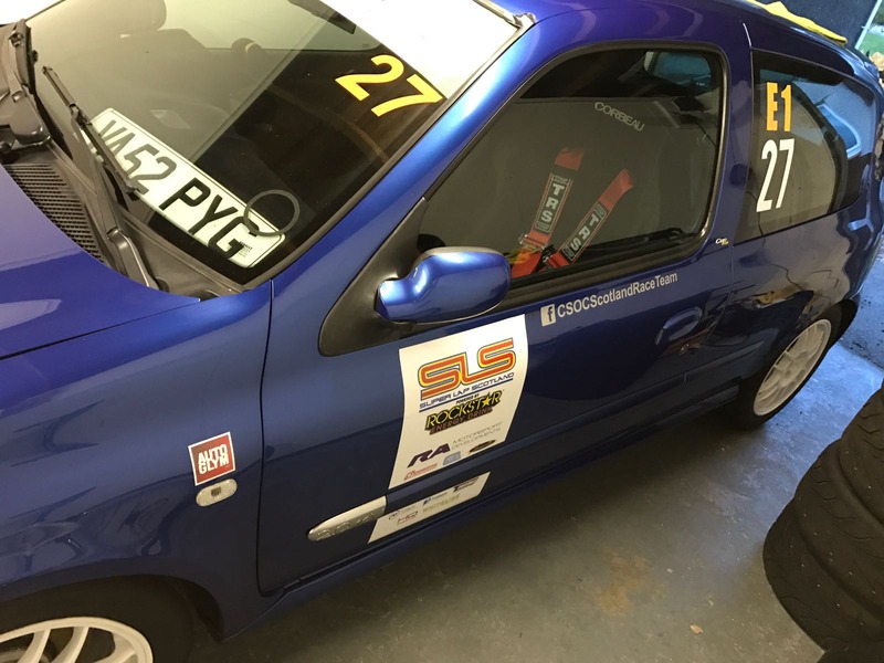

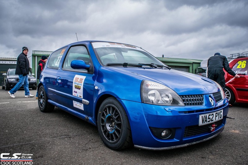

It was now time to get ready for the 1st round of the SLS. By this point I'd been in touch with a couple of friends also running clio's and members of CSOC Scotland on Facebook we formed a bit of a team for the season ahead. This meant more knowledge between people to be shared and more hands around if help was needed.

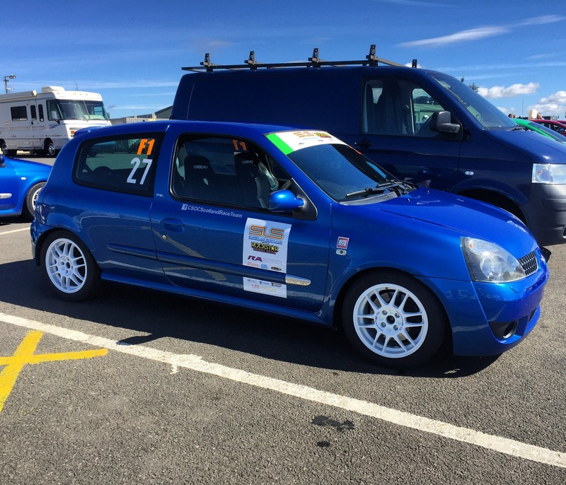

Car sitting in the pit area all stickered with SLS series decals and ready for some timed action.
1st round went pretty well. Was lapping in the high 1:02.7's and 8's but with testing timed limited before the event I was gambling on set ups before I went out on track. Gambled going into the final and went slower but it was mainly a test session for the rest of the season.
Great 1st meeting out with no problems at all and virtually have no testing before the meeting the car went great.

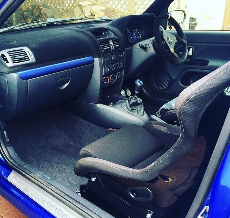

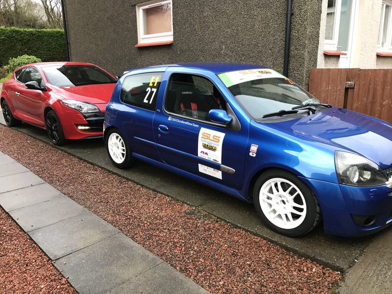

Running in road car class I have to keep the standard interior including the rear seat bench. I was allowed to add race seats and harness for safety but this isn't necessary. Racing with standard Cup seats and belt up until this point wasn't ideal and I was losing a bit of feel from the car too, so I purchased 2 Corbeau Club Sports and a set of TRS 4 point harnesses from Turner Autosport near Glasgow. Great friendly service from the guys there!
I was really happy with how they looked in the car. One thing thats good about road car class is you dont need to savage the interior of the car. Keeps it more Club Sport spec and easier to put back to OEM.
I did think about adding a rear cage for safety but it was out of my budget having spent my start off budget getting the car ready at this point.

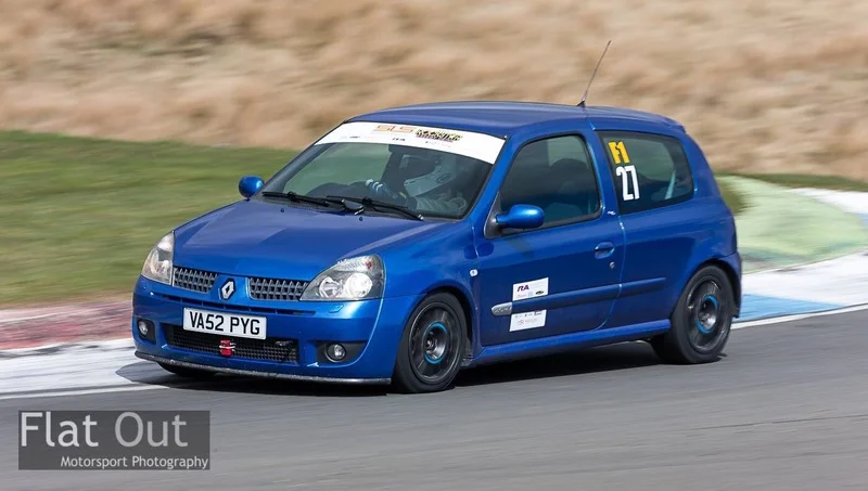

As the season went it I had an absolute hoot of a time! The series is fantastic and a great entry into motorsport. The friendliness around the pits and support you get from everyone is superb.
I managed a number of top 5 finishes in class and was regulary fastest clio in class which was my aim.

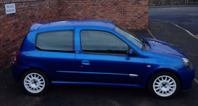

Had the Oz's re furbed in white. I ended up using these more so than the Speedlines as they saved a bit of weight.
