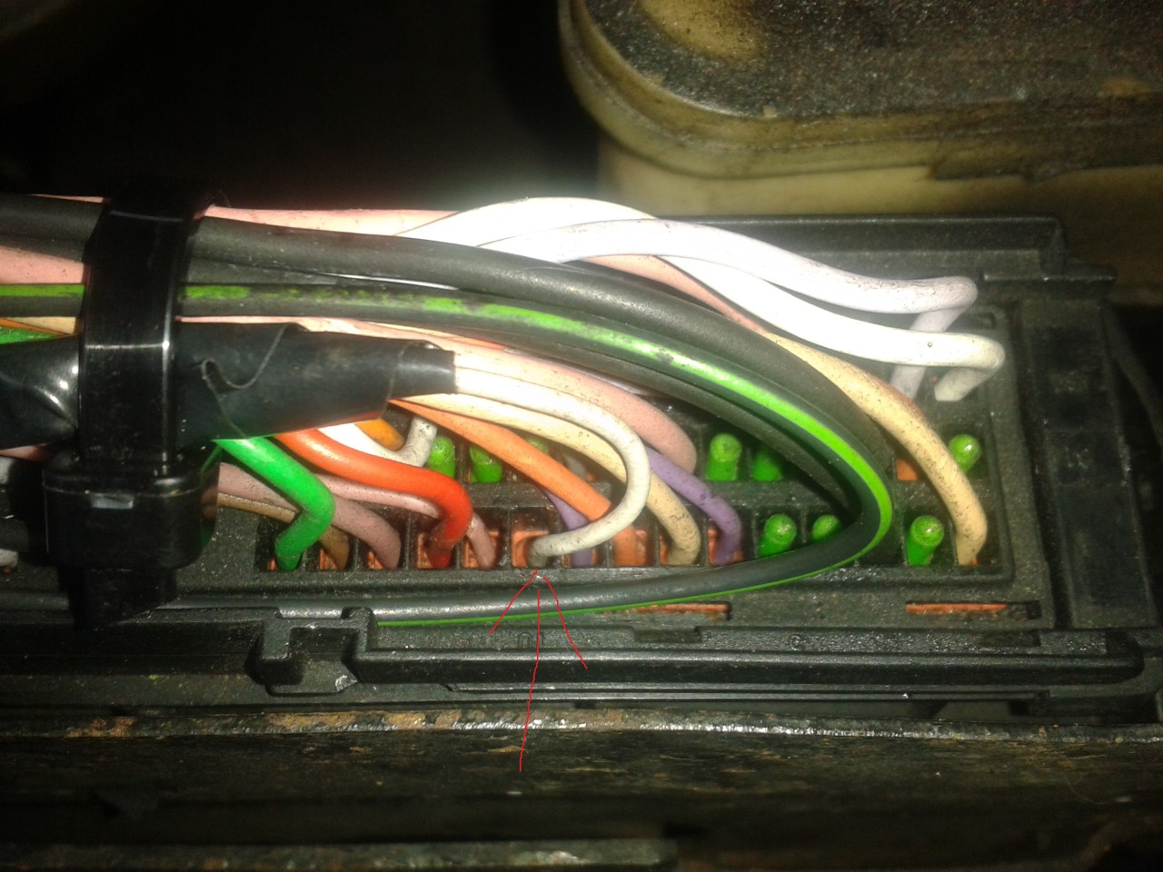

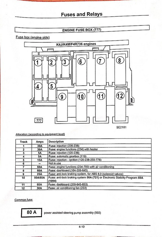

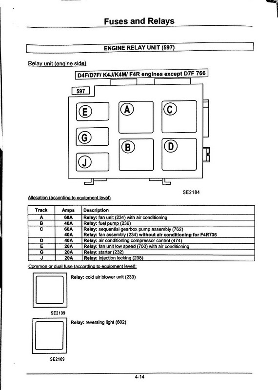

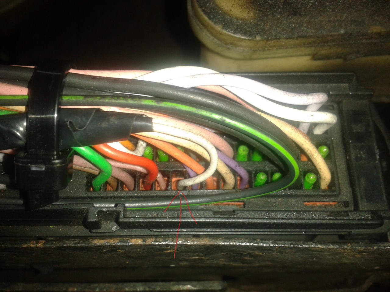

Check 5 amp fuse 3 and its 12v supply.
Check continuity to relay J
Bridge relay J
Check continuity of white wire from relay J to ECU pin 11.
M90SR
My apologies, I wrote my original reply from memory, but have since revisited the subject.
I think this is a 172 cup fuse box, Relay J is the small brown one with a white blob on it.
I was in error, the white wire goes to Pin 10, not 11.
Release the 90 pin connector from the ECU by sliding the black top cover towards the wing, and then slide the locking arm to release the connector.( see picture )
Check the continuity with a multimeter, though you may need to use a sewing needle or similar get a contact, as the leads on most multimeters are a bit stubby.
Also 30 amp fuse 1, is the power supp[y to the relays, and 5 amp fuse 3 is the power supply to pin 30 of the ECU.

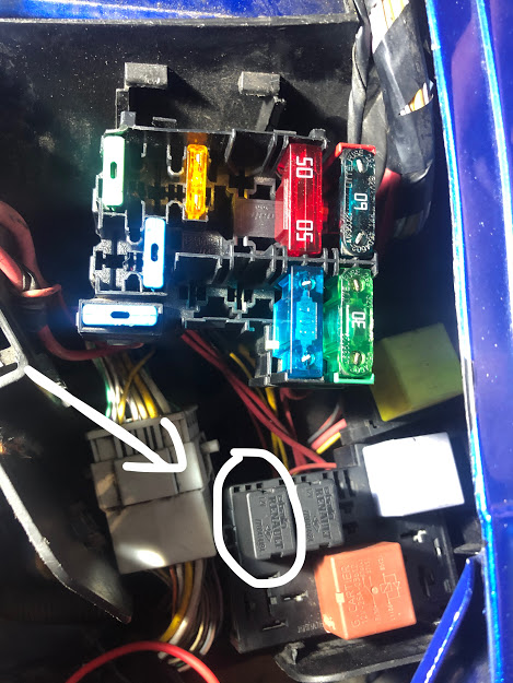

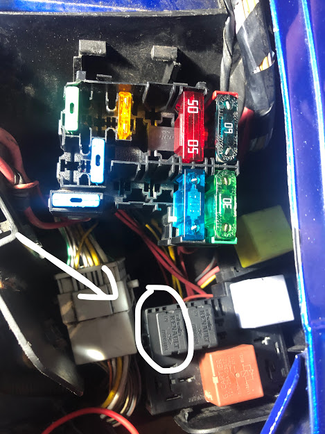

Afternoon All,
After checking for Spark & there was fuel getting to the fuel rail. thanks for Eddie for the recommendation of removing the injections... they weren't pumping :( appeared to have only 2-2.5 volts getting to the injectors which i can only assume isn't enough for them to even prime.
Anyway... i ended up bridging the relay below and the car runs perfectly. unfortunately i can't find any split wires etc... any further advice ? hoping to get it to a specialist end of the week after my trackday (and no its not in the clio :) )
M90SR
Afternoon All,

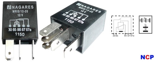

hmmm how about just replacing the relay?
