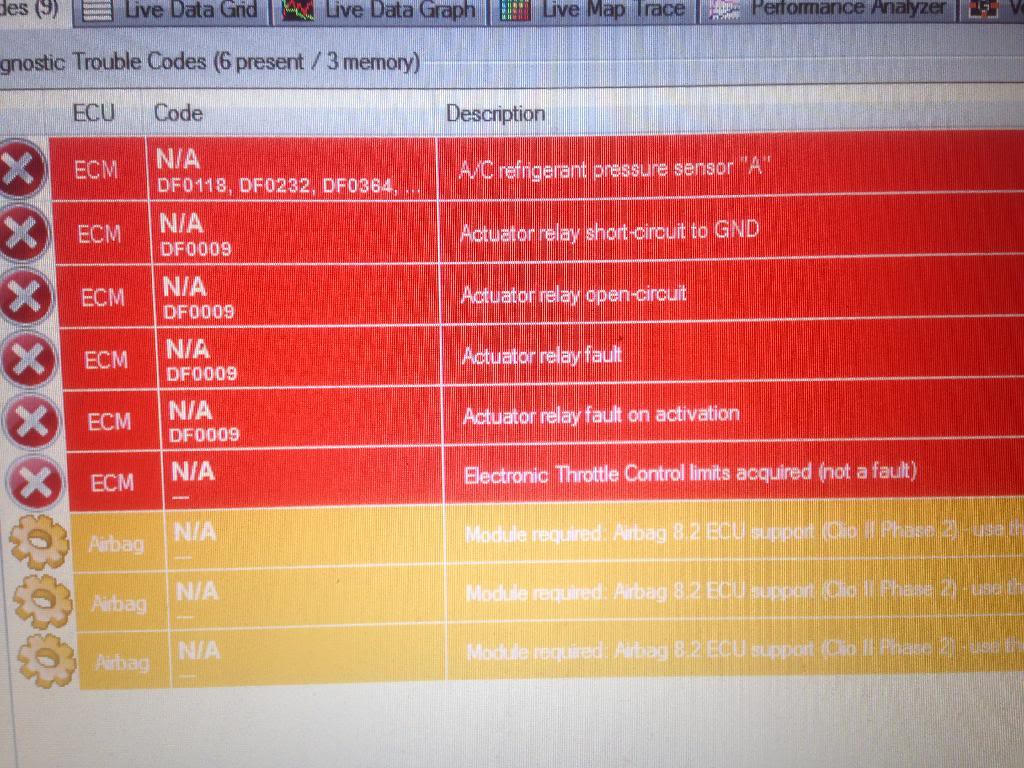

Hi after abit of help with a few fault codes that have come up on the car.
i know the airbag ones are old from when i changed the steering wheel, i also know about the throttle one not being a fault. Its the rest of them that i am stuck with, am i right in thinking it could be a broken cable or bad connection? The car starts and runs fine. i am not that bothered about the a/c one as that will be coming out soon anyway.
cheers harry
Cheers for the link but I'm sure df codes a Renault only. Unless you can convert df codes into normal ones it doesn't help.
The fault code is actually df009. Google df009 renault clio.
Theres a page which mentions broken wire to ecu but first i would check the plugs and the 3 brown relays in the engine fuse box for corrosion.
