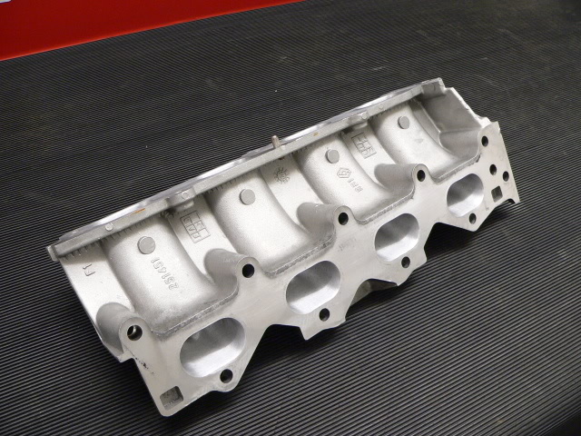

THere is a miss match, its not quite the same thing as the casting ends there and its not always machined flat. But the whole inlet track should be modified from plenham to head.
Which parts do you fettle on your manifold mod? Is it just the one joint (as per the thread) or do you do the head to manifold matching aswell...?

This is the inlet manifold (pinched from Bens post)
And this is the plenham
The manifold gets matched to the head ports and the two sections of the manifold are also matched where they join together.
Hope that clears it up... I still end up calling the plenham the manifold tho lol :rasp:

If you look closely at the picture i posted you can see the plenum marked up in blue as well.
I did both but the worst and most important bit is the manifold to head join.
If you want the plenum cut open and heavily modified as mentioned earlier then speak to BenR. I just haven't got time for that kind of mod at this time of year.

Its is very simple to fit as long as you've got a half decent tool kit. Its about a dozen bolts and you have to remove a bunch of connectors and a couple of pipes.

I have had extensive inlet head/work done on a lotus engine, they were ported flowed and matched which saw massive gains the flow through the head increase from 126 cfm to 170 cfm, After this the inlet was removed again and a rifling pattern was added to introduce turbulance through the manifold, We didn't notice any performance gain from this, but engine effiency was improved and a cleaner burn was obtained.
  GDI Demo 182, Rsi Spider
just a note of caution
we have tested a couple of these manifolds before we map them with the afr meter, and after the work was done the AFR never went below 14.5 (on full load)
so its running lean and certainly not enough to get the best power which is at 12.9 on the clio.
there are a few people that have run this without fueling adjustment with no problem (the std ecu had good knock control on it)
just to make you aware thats all.
