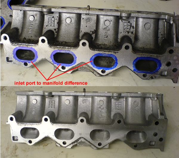

After reading a thread on here last week about the inlet manifold, i decided to take it off at the weekend. I found the quality to be pretty poor being unfinished cast aluminium.
The pictures below show the manifold where it meets the inlet port. There is a big step as can be seen with the inlet port being the thin scribed line in the middle of the blue. I matched the manifold at both ends and also matched the other part of the manifold not shown and blended this into the throttle body where there was another slight step.
The car has not been dyno'd but seat of the pants the pickup is much improved from just before 3000 revs to about 5000 revs. It also revs out much better and hits the rev limiter before any noticeable drop off in power like before. The car also runs smoother below 2000 revs when the engine is cold where it would lurch along before almost unsure how to fuel itself.
A nice cheap mod for a gain you can feel. Just thought i'd share it.

It all needs to come off the car, then you need to mark it up to see where the problems are.
No polishing, waste of time.

Yes. See above. I used a die grinder. You need an aluminium chip carbide bit and then some sort of sanding rolls or spiral band to finish it off.

Took me about 3 hours including marking up and refitting. I do this for a living though so would take a lot longer if its your first time.

how did you 'scribe' the engineering blue to show the lines for the head ports?? did you creat a template?
or did you just use the gasket as a template?

gasket lined up, blued, and a scribe to scratch the blue area.

They were very close on mine on the inlet. You will see how good when you take it all off and know then whether or not it will work this way.

yup, they are very accuratelt made steel gaskets, none of this paper crap, so they are stamped.
They are slightly bigger than the ports, but this is why i leave a 20 thou smaller step so people fitting it, or anomaly ports dont introduce a leading edge step.

Do those (marked area) have a same kind of step to 'upper' inlet manifold?
..also, 'upper' is with bigger ports?
THere is a miss match, its not quite the same thing as the casting ends there and its not always machined flat. But the whole inlet track should be modified from plenham to head.
