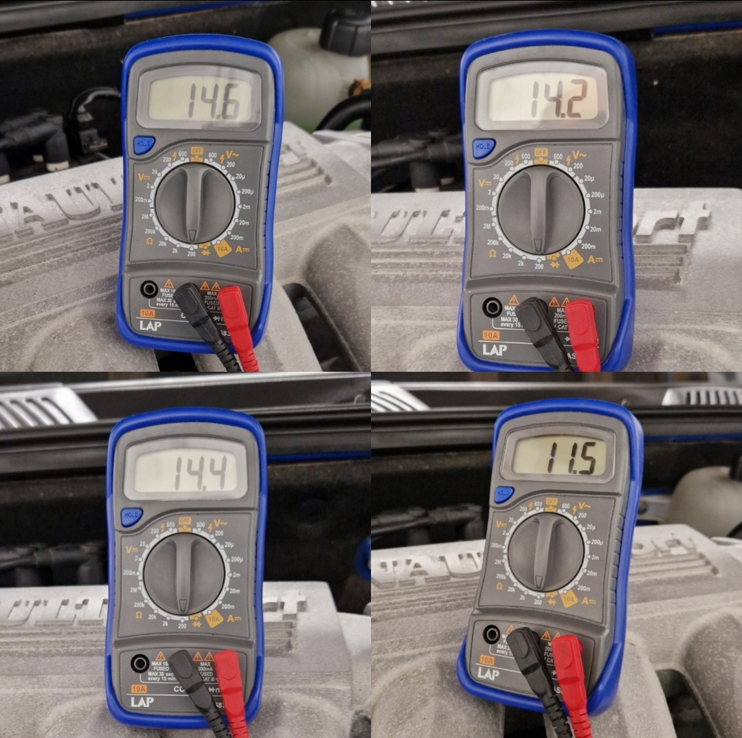

I did notice that the EML flashed very, very briefly.

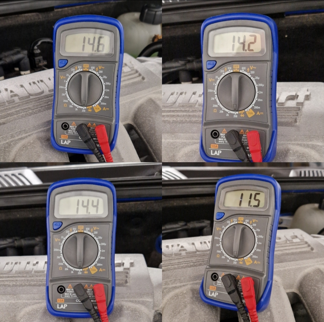

Took a quick reading of the resistance at the Injectors.
x4 new genuine injectors from AETmotorsport.

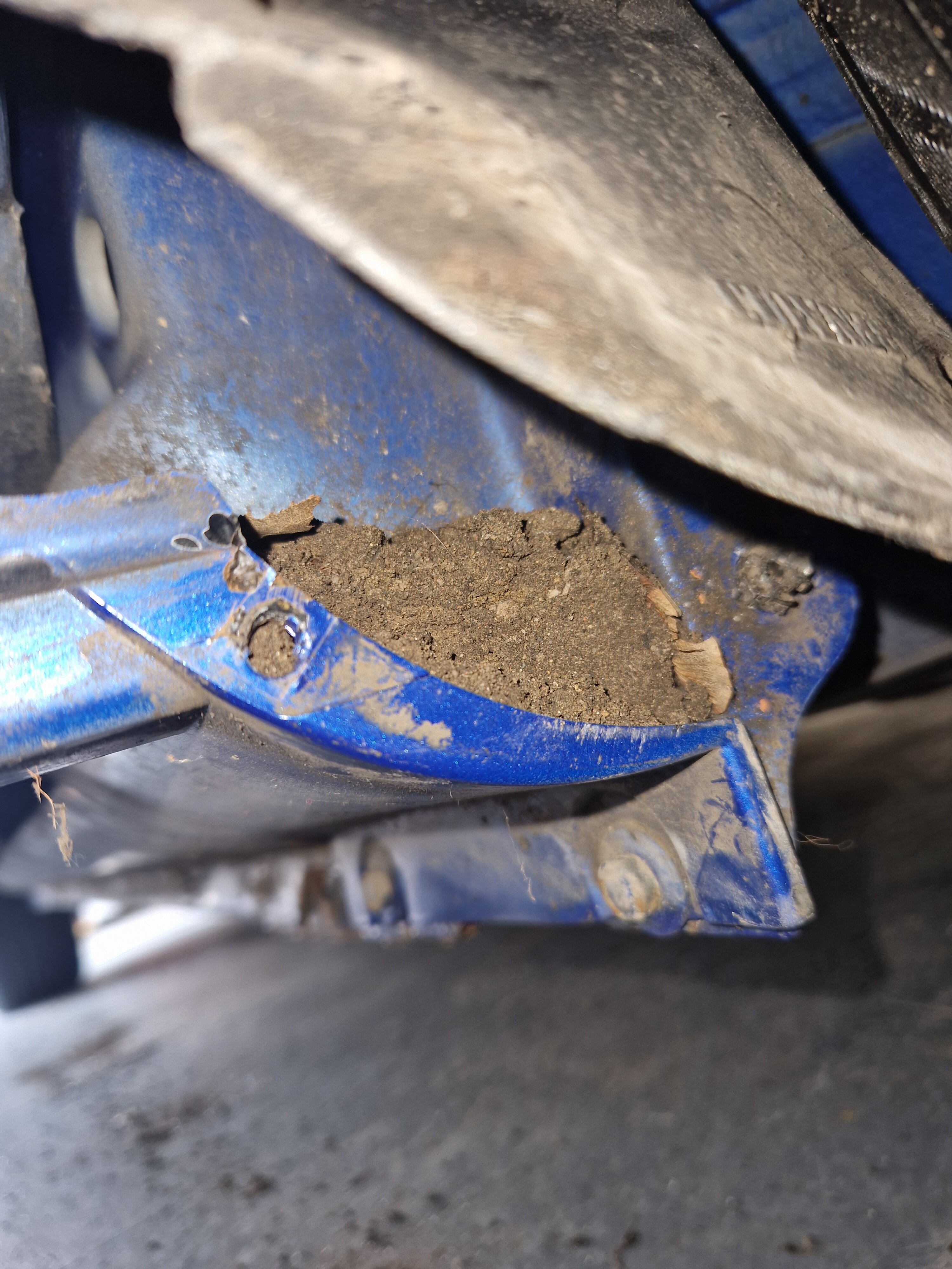

Next. Rust.

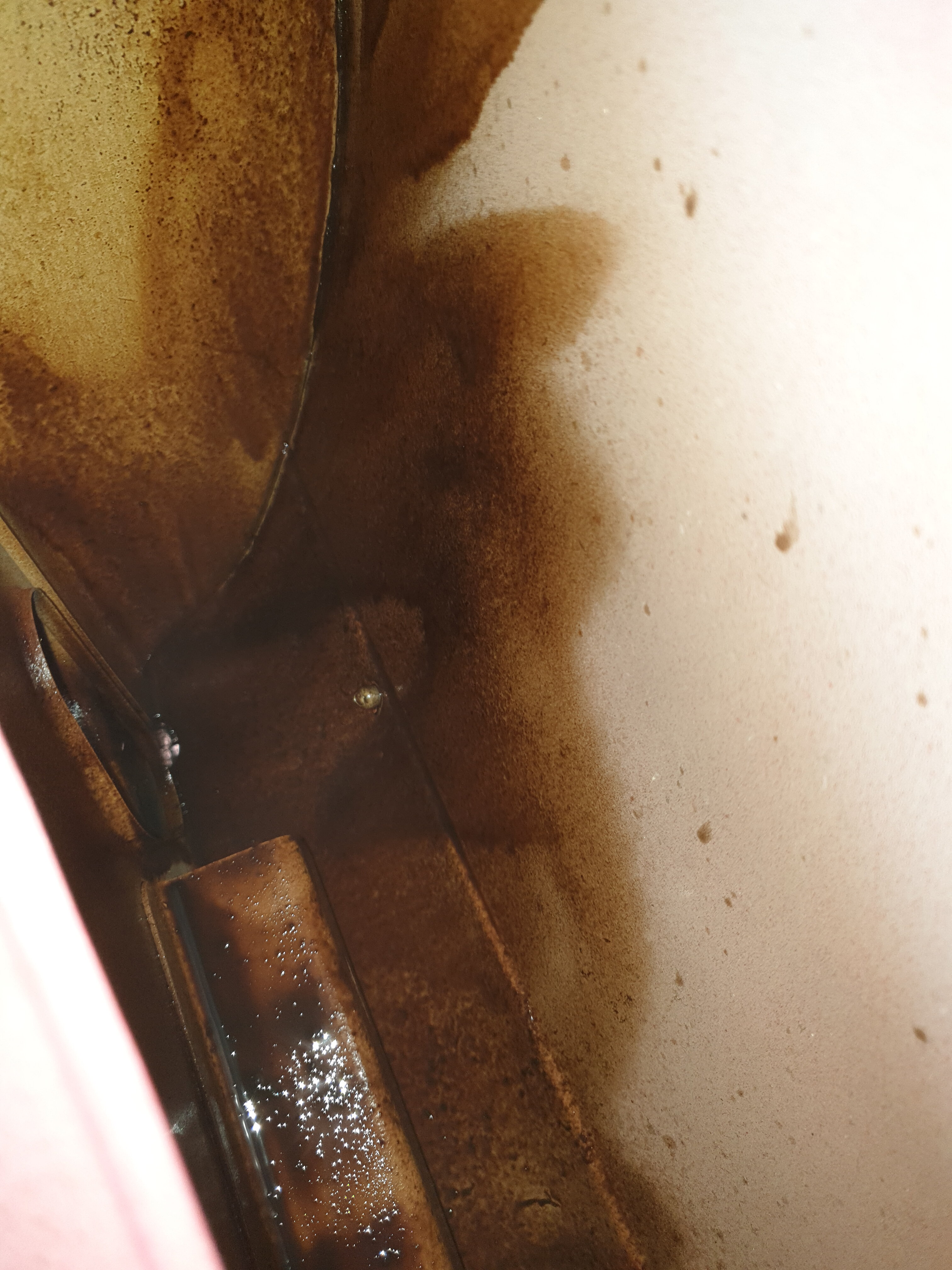

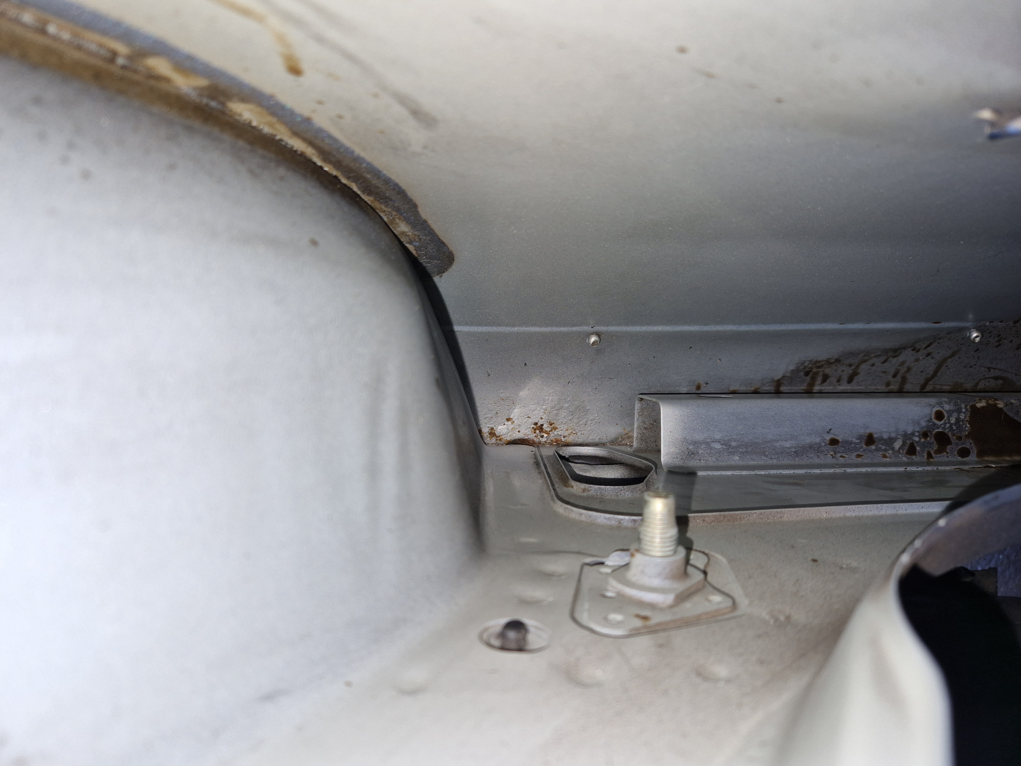

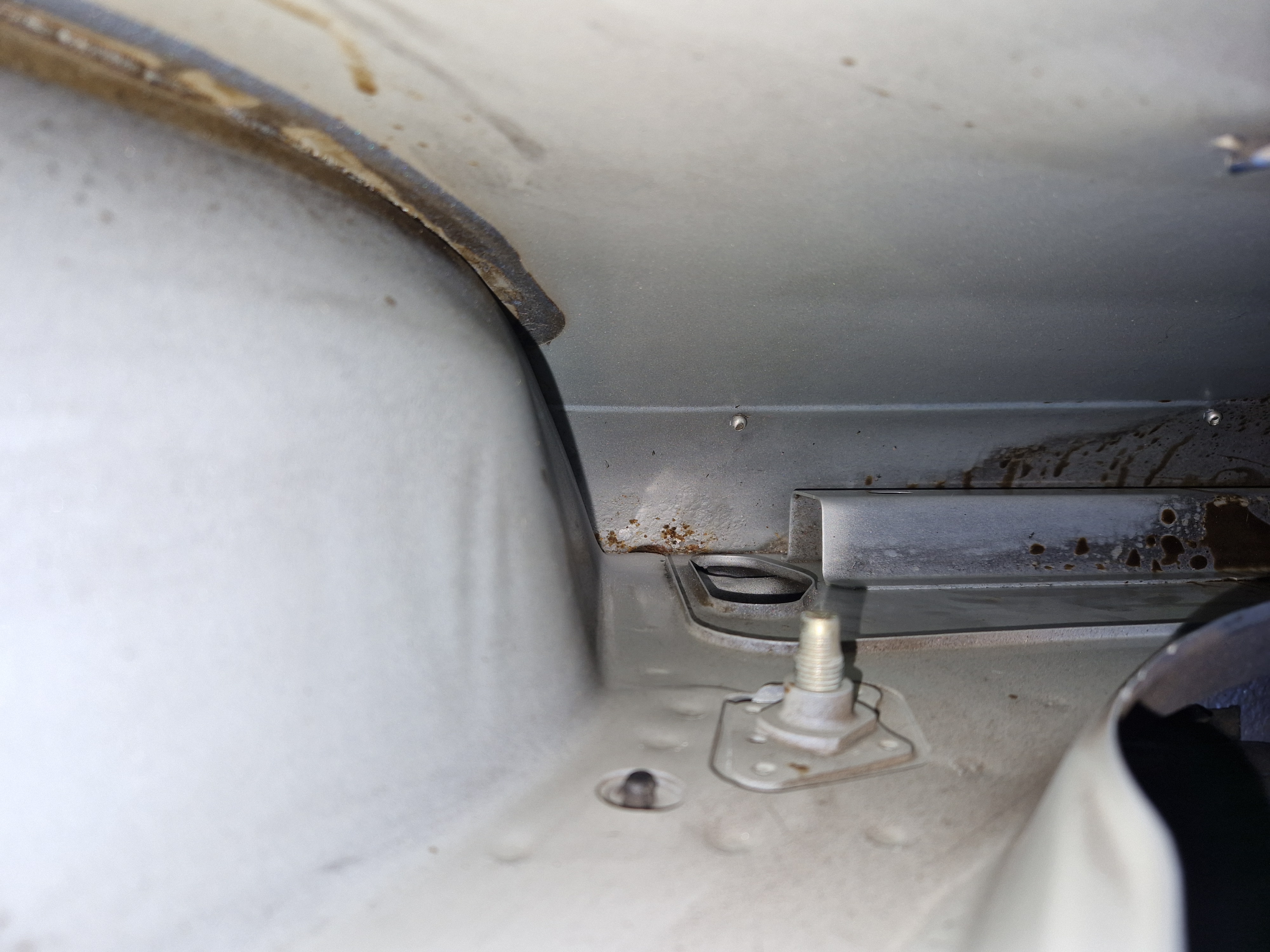

I noticed that the previous owners hadn't mentioned rust and when I put this 172 Cup on Instagram I had some comments "How IS the rust?" which made me think "oh sh1t".
I peeped in the rear door cards and
I'll take that. Other side was much the same but no photo as I was filming it and took stills.

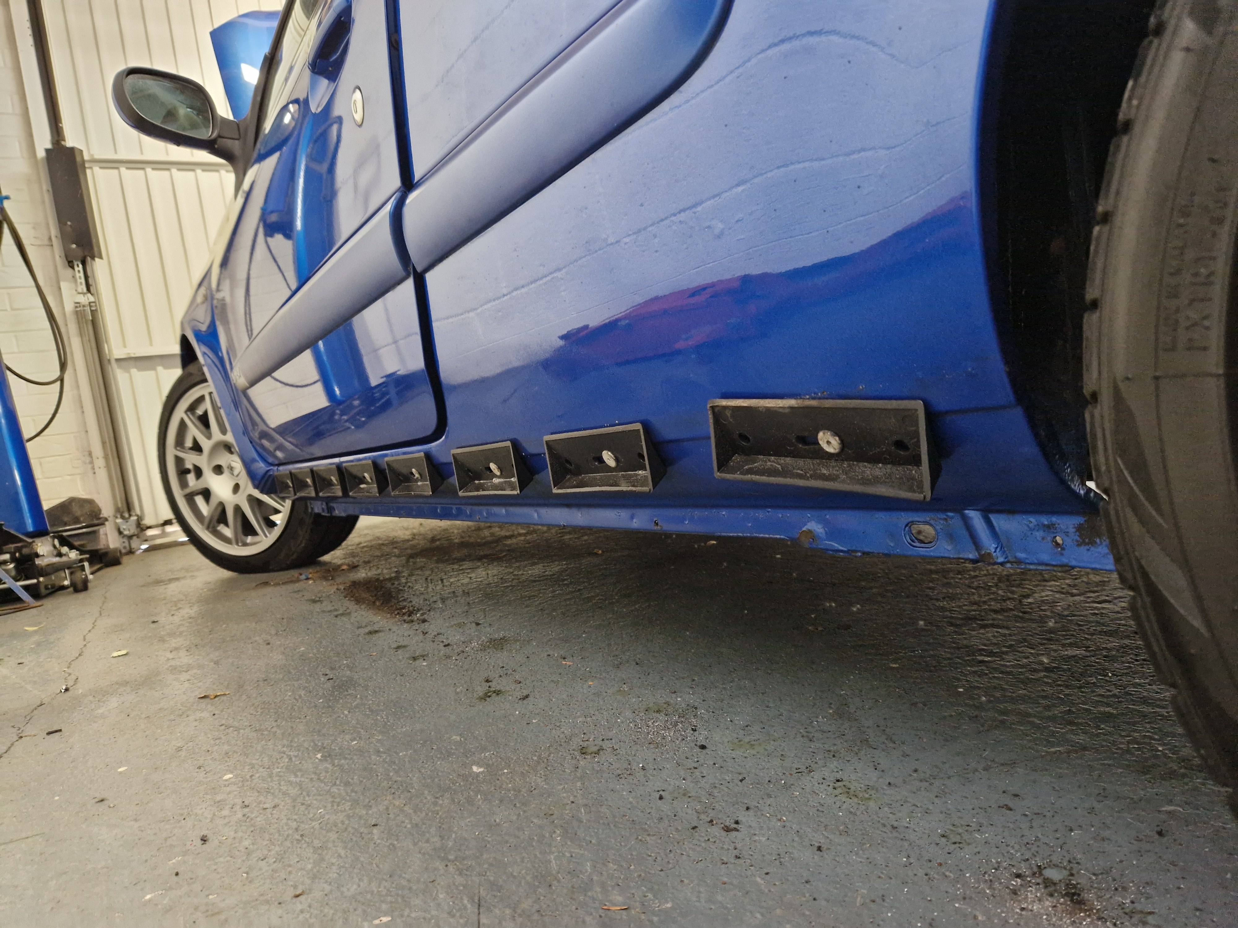

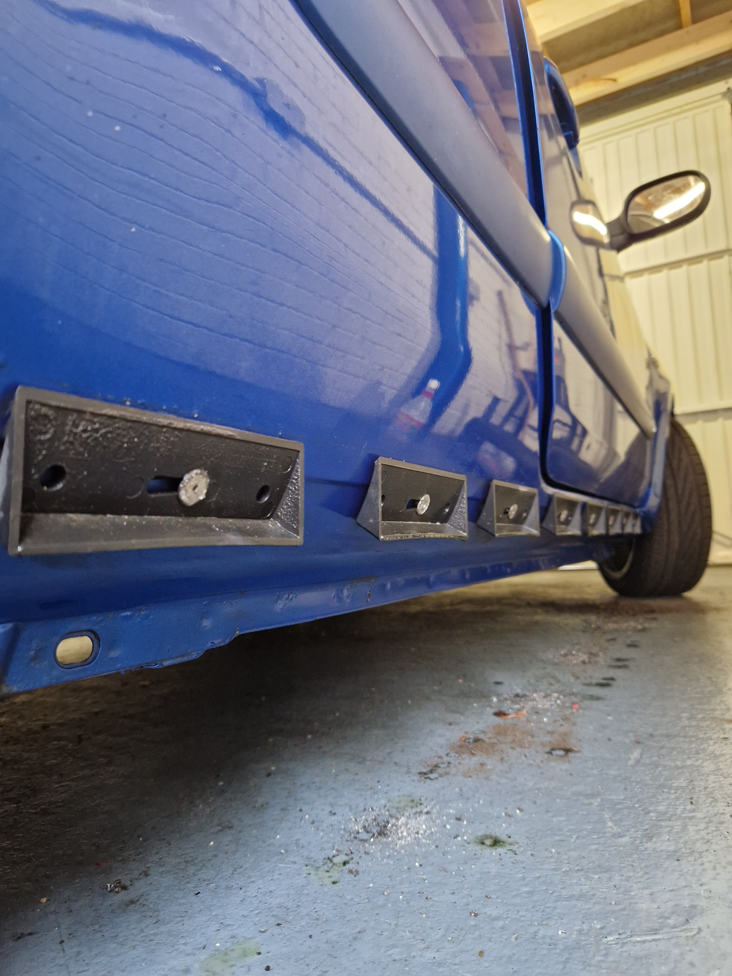

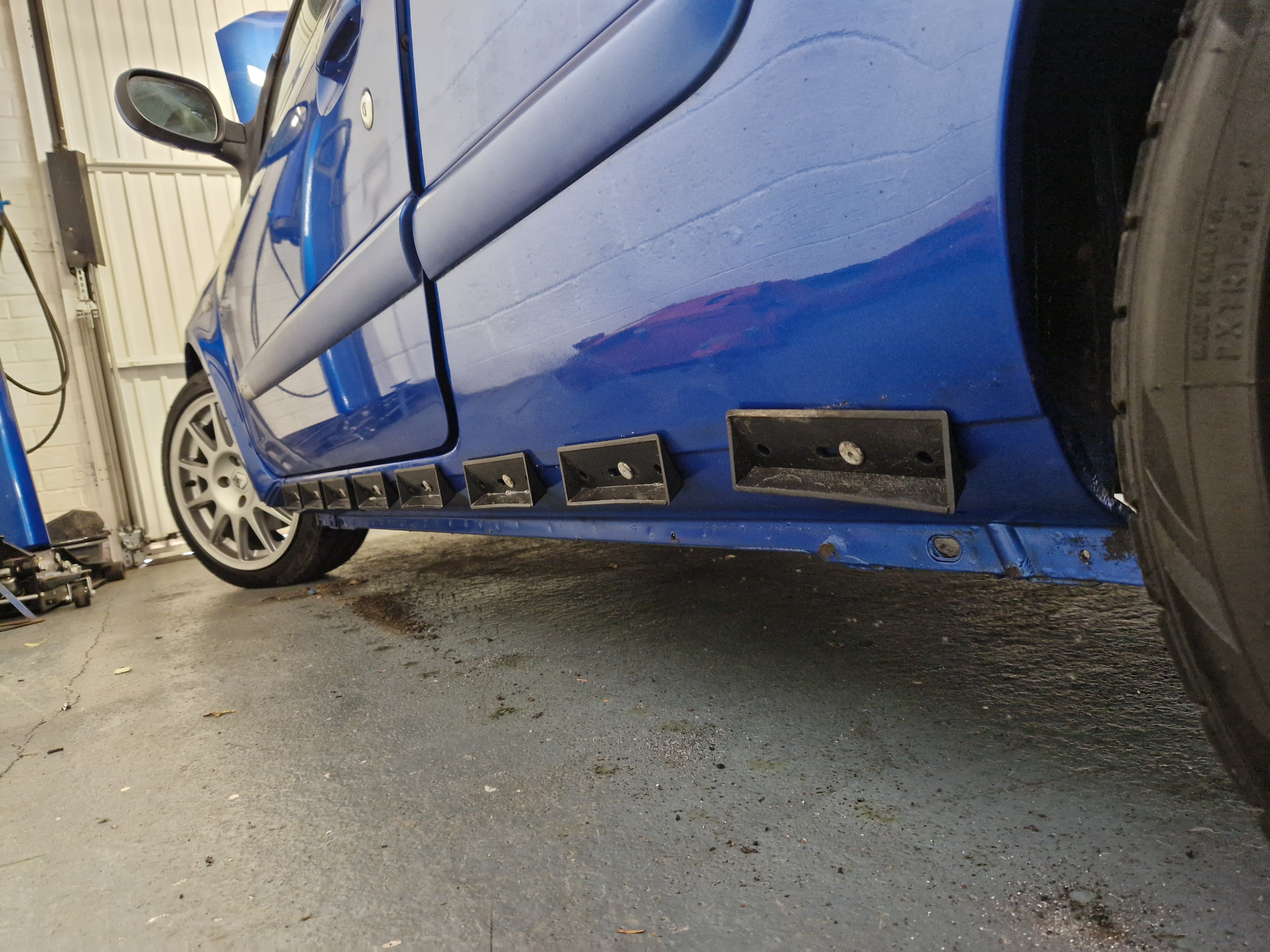

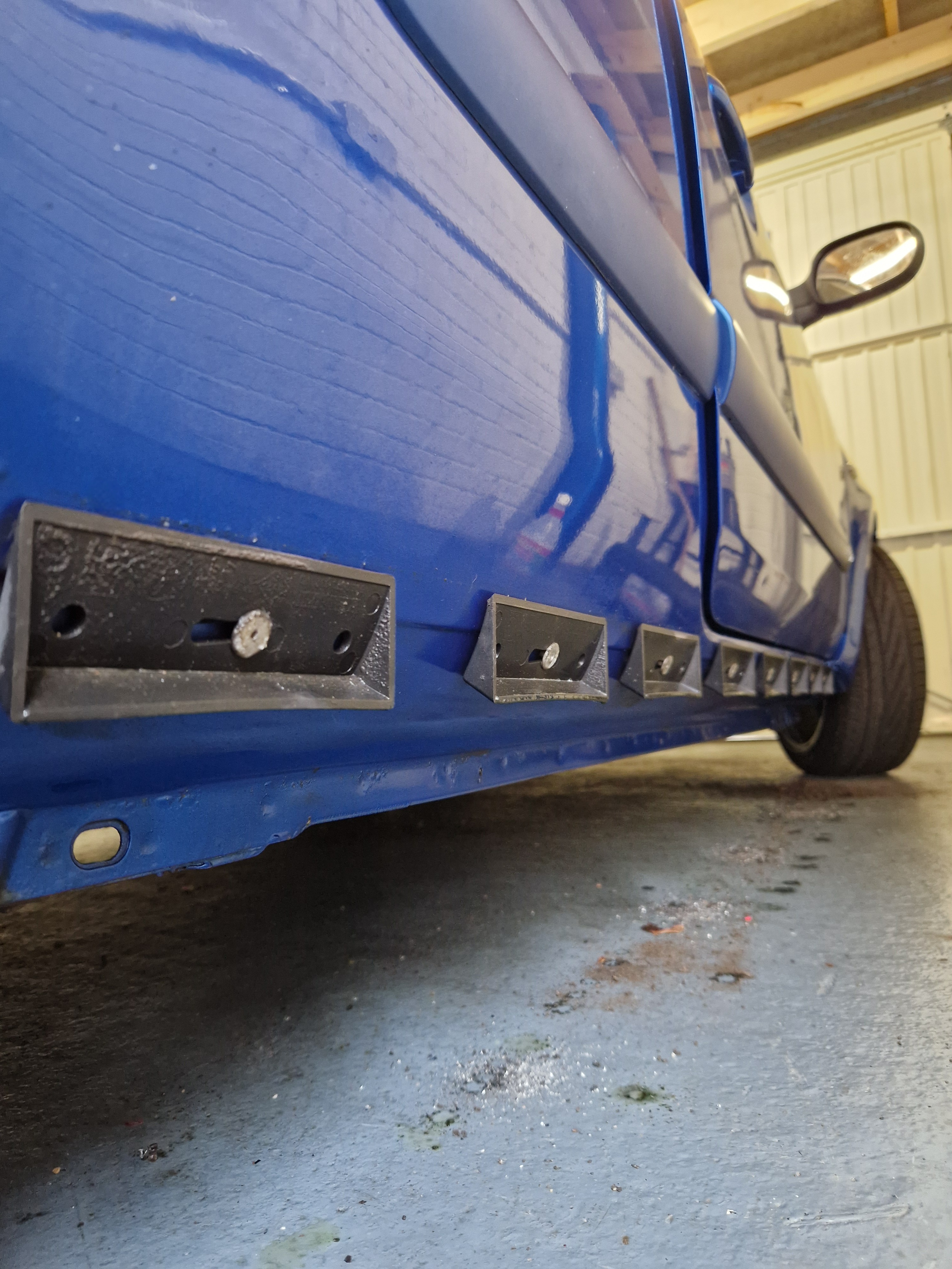

I also noticed the sideskirts had the original Renault rivets in. So out they came and off came the side skirts.

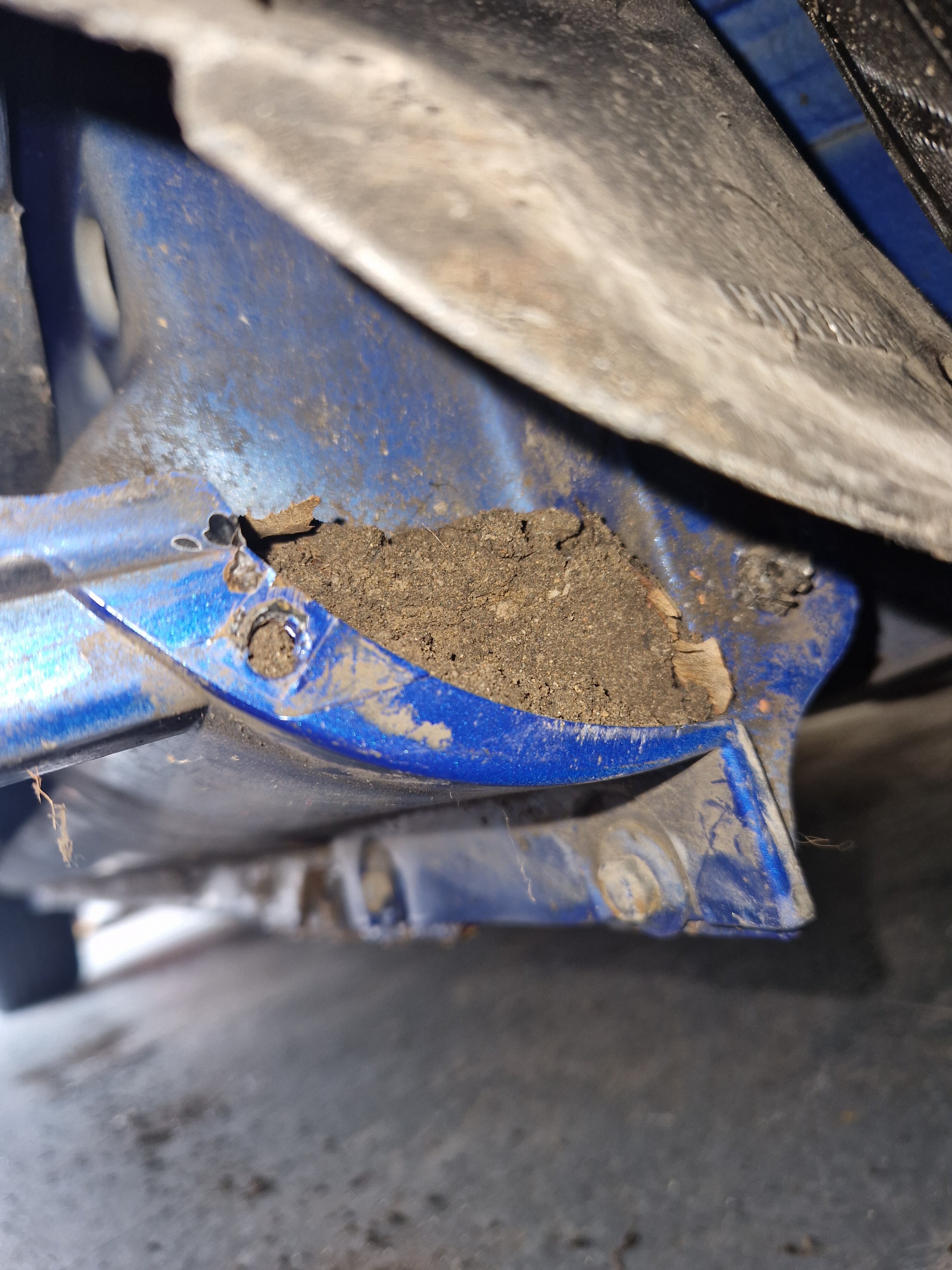

And whilst there I cleaned out the archliners
(sorry for the image sizes).
And whilst there I cleaned out the archliners View attachment 1691769

Result. It’s a rare beast not to have rust in those places. Well done!
Nice, i think i did take some pics from behind the rear door cards in my thread.
Unlucky ref the eml light, never had that come on 😢 probably due a fresh set of injectors anyhow 👍
Looks spot on.

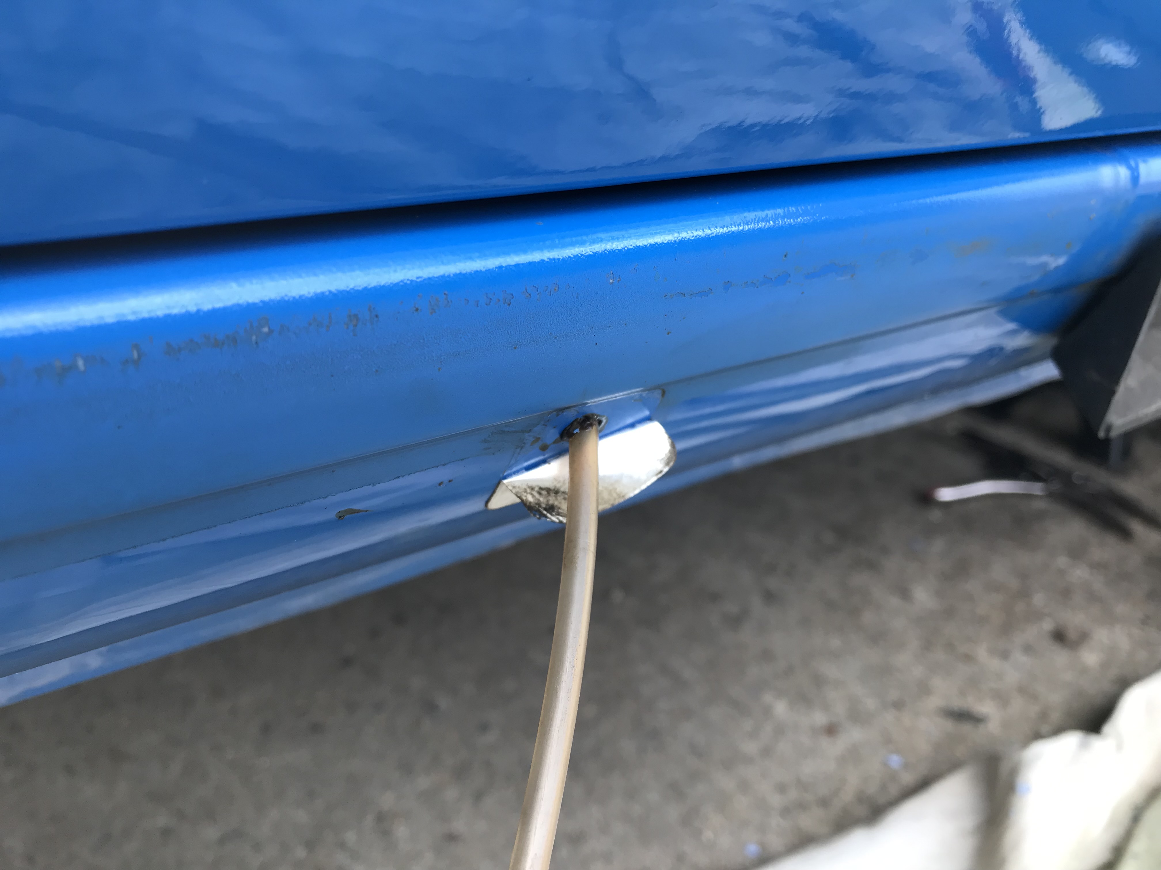

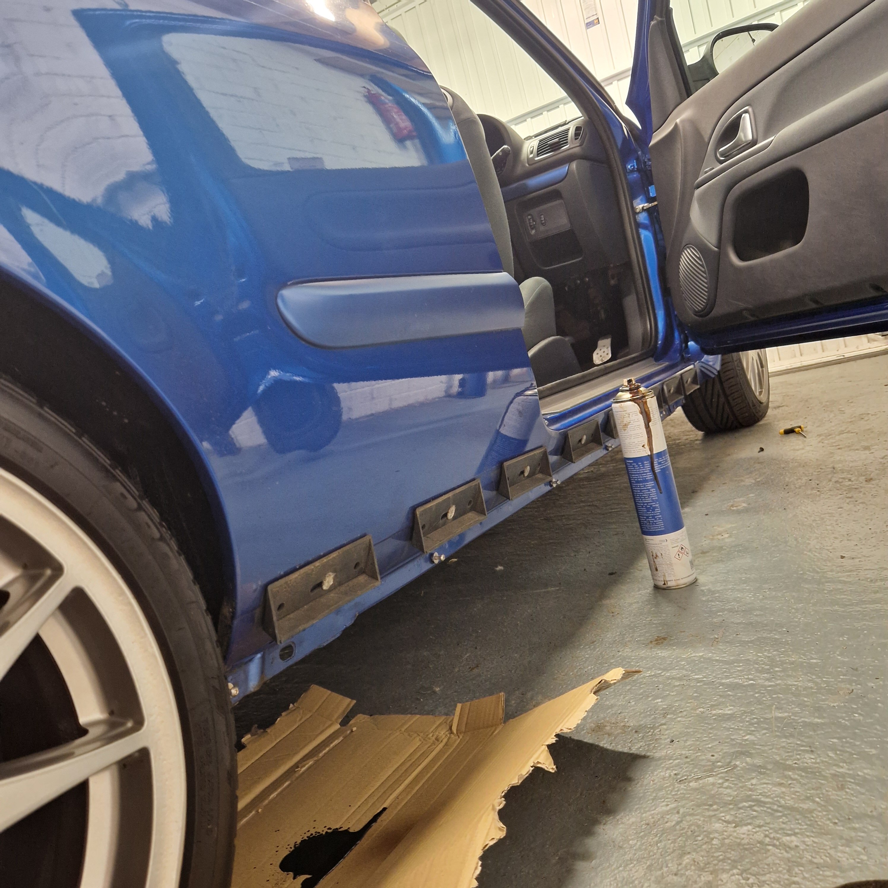

Get a load of cavity wax on the inner rear arches and inner sills, will stay rot free for years.

EML light. It's a 21 year old car. These things are to be expected.
Thankfully ClioSport.net came to the rescue and suggested it could be an injector.
All four replaced and it's running like French watch. 😂

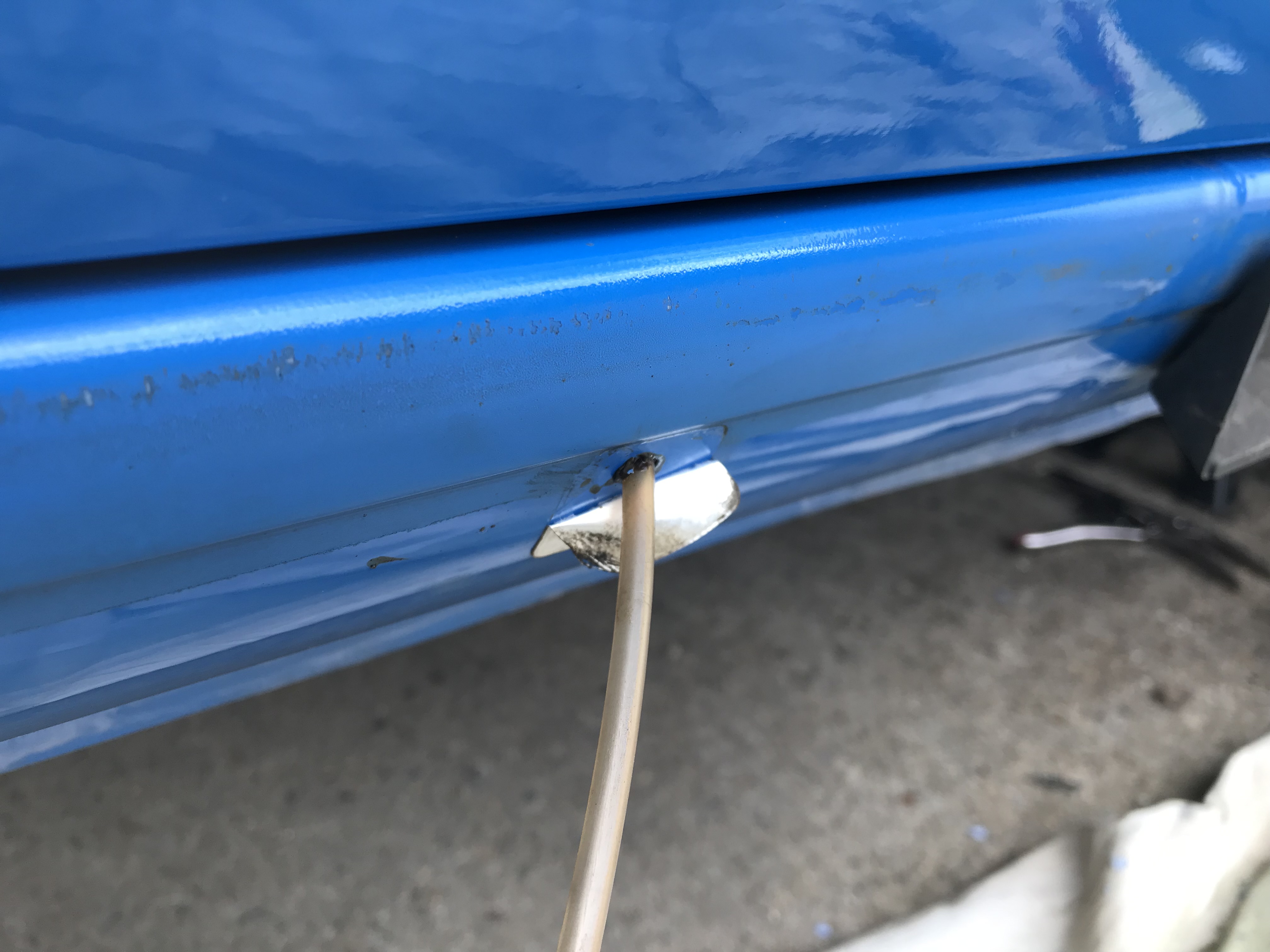

How do you get cavity wax in the inner sills? Is there a trick to it?
Under the side skirts there’s a sticker, peel it back. If you buy BH S50 Dynax it comes with a lance.
Push the lance as far in as you can and slowly draw it back as you spray. Then turn the other way and repeat. It’ll usually hit those rear quarters without taking the inner cards off.
As @Mr Underhill said above get the lance in. Id whip rear doorcards and blast it in on the rear arch seams and sill.
Dont forget to put some cardboard or whatever underneath the sill as the cavity wax will run out of any small gap onto the floor.
Is this sticker on later cars as I can't see it on this Cup?
Not sure fella. You’ve got the side skirt off?
Yeah, skirts off. Stood here now and no silver sticker.
Unless I am blind.
Skirts off and the black rectangular brackets twisted just to check it's not under one of them.
I remember all my previous 182s having a silver sticker under the sill and not knowing what it was for, but this is my first 172 (and the oldest clio I've had being an 03).
Unless I am blind.

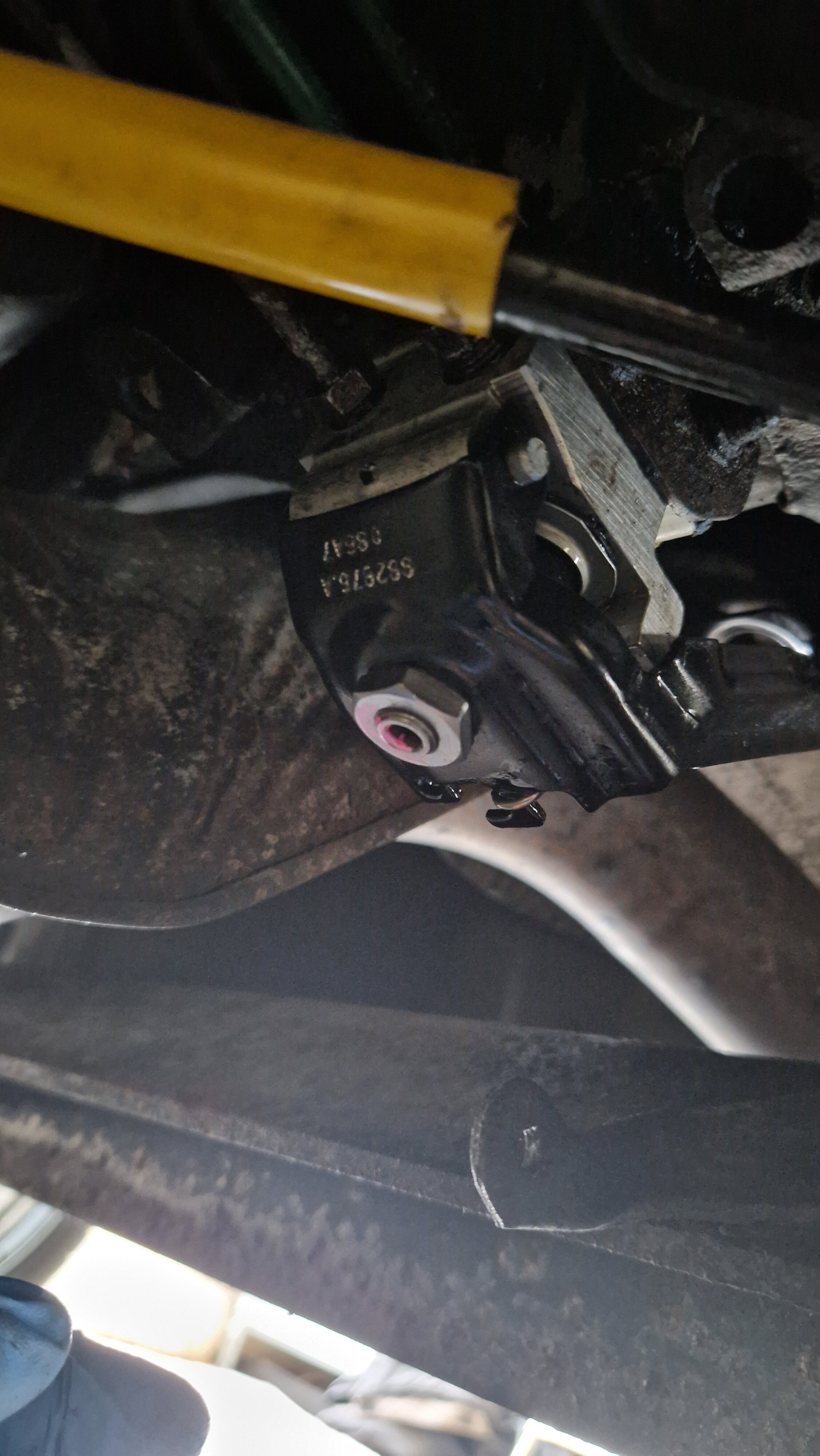

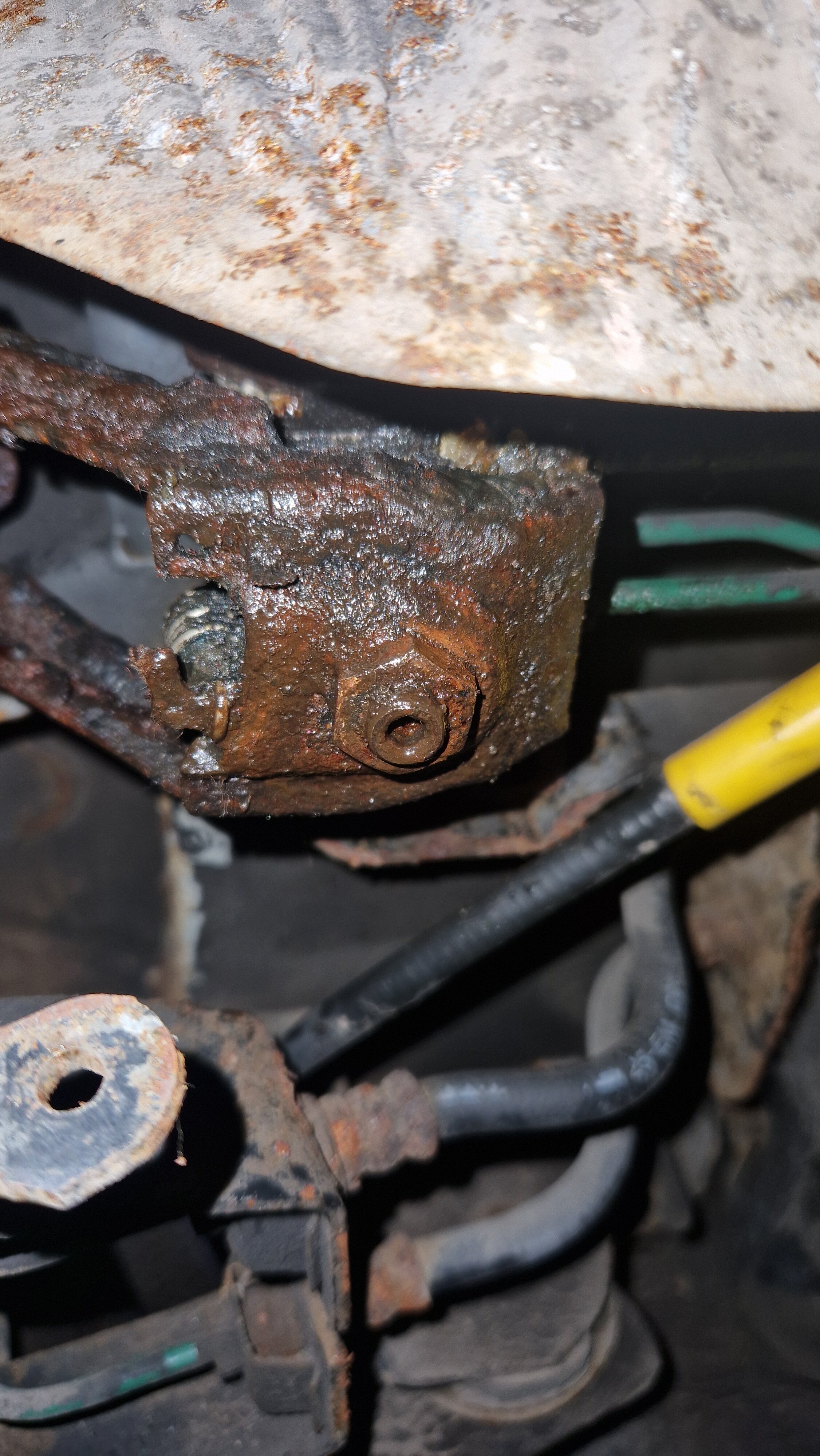

On returning I noticed a little puddle on the floor where the Clio was parked, but it wasn't where'd you'd expect at the front, it was towards the back?
Stuck my head under and could see brake fluid dripping from what I now know to be the rear brake compensator(?).
What's the best course of action? Are these compensators fixable? That nut didn't seem to budge when I stuck a spanner on it.

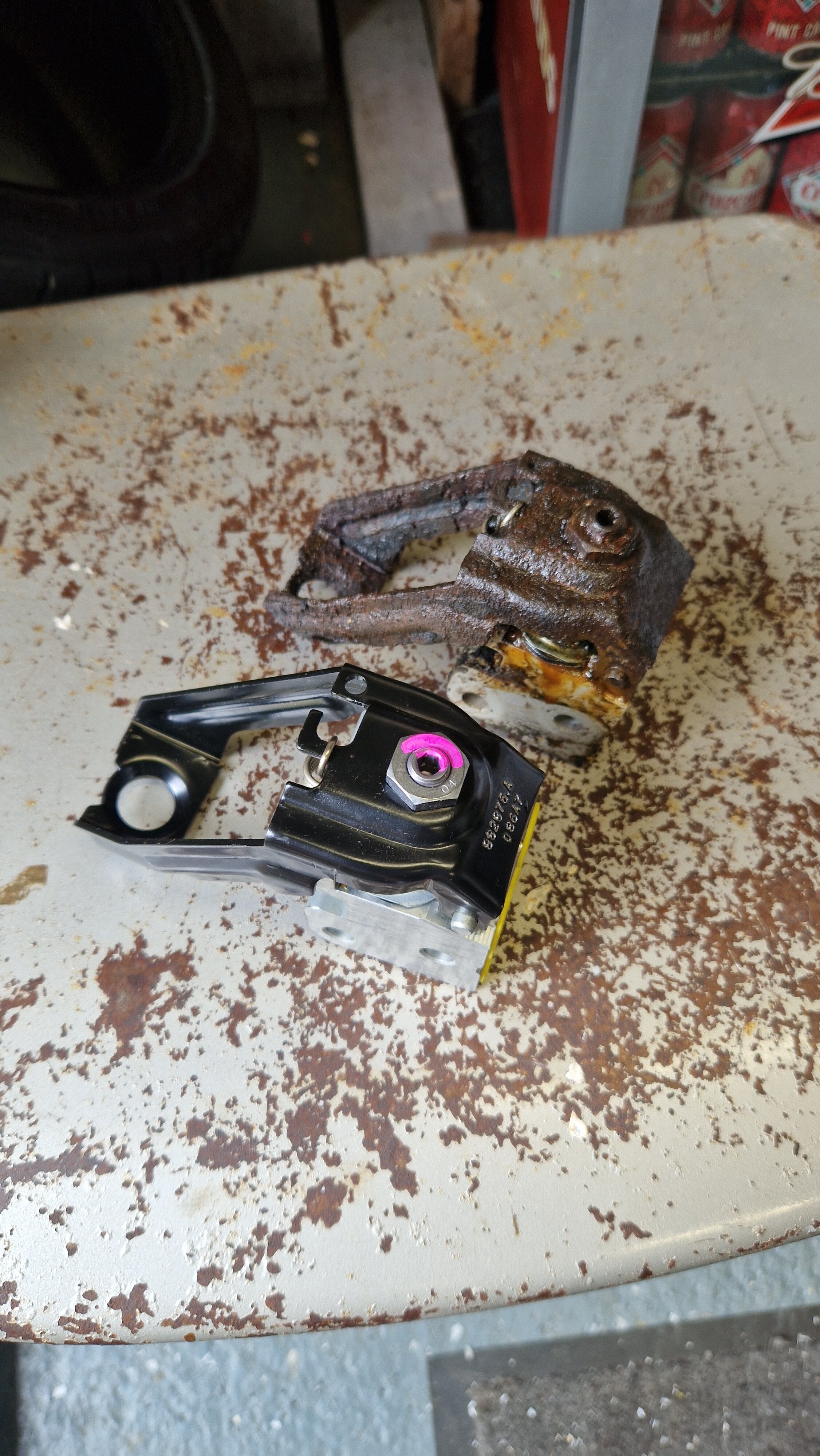

Decided to replace the rear bias valve as it looked awful and didn't have any real movement.
The unions came out pretty easily after soaking them in WD40.
Old and new
As it was a job that involved brake fluid, it made for a messy and stressy job, trying not to get fluid everywhere.
In situ.
I'm not convinced with this new valve, yet.
I've a load of air in the system and need to bleed it over and over and over again as seems to be the norm with Clios.
I've noticed when tapping the brake pedal the arm of the valve moves freely. But it also seems to make a tapping noise as it's working?

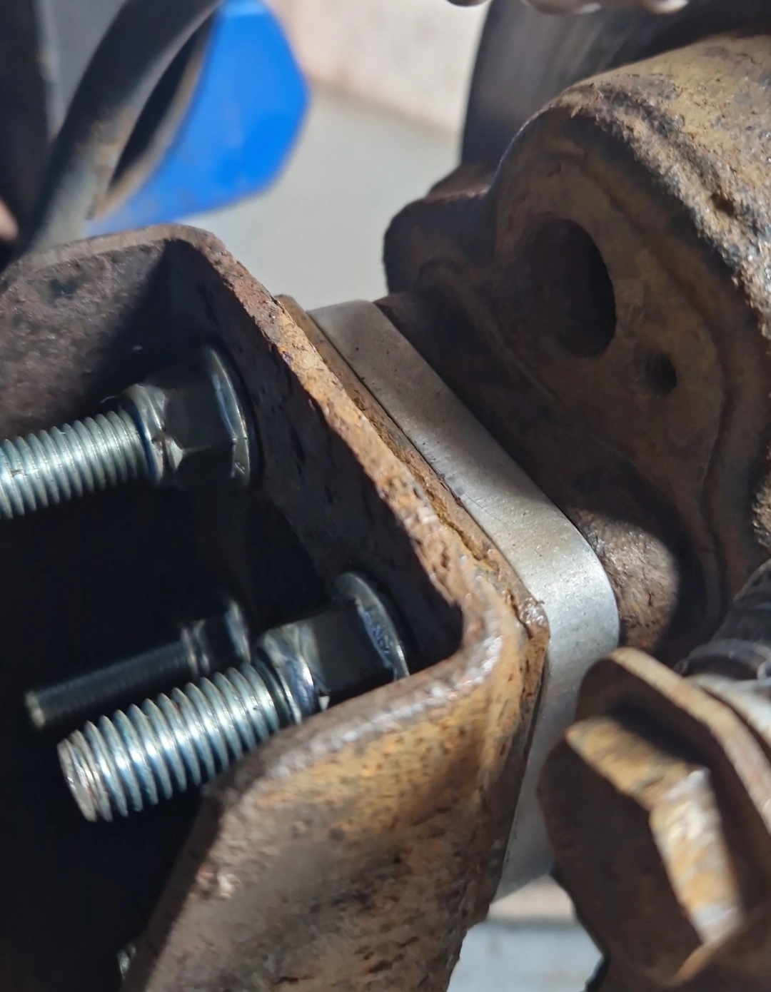

Also fitted a pair of PMS 10mm stub axle spacers. Not fitted stub axle spacers before, simple job really. Done a 1000 times to clios but here's a pic anyway.

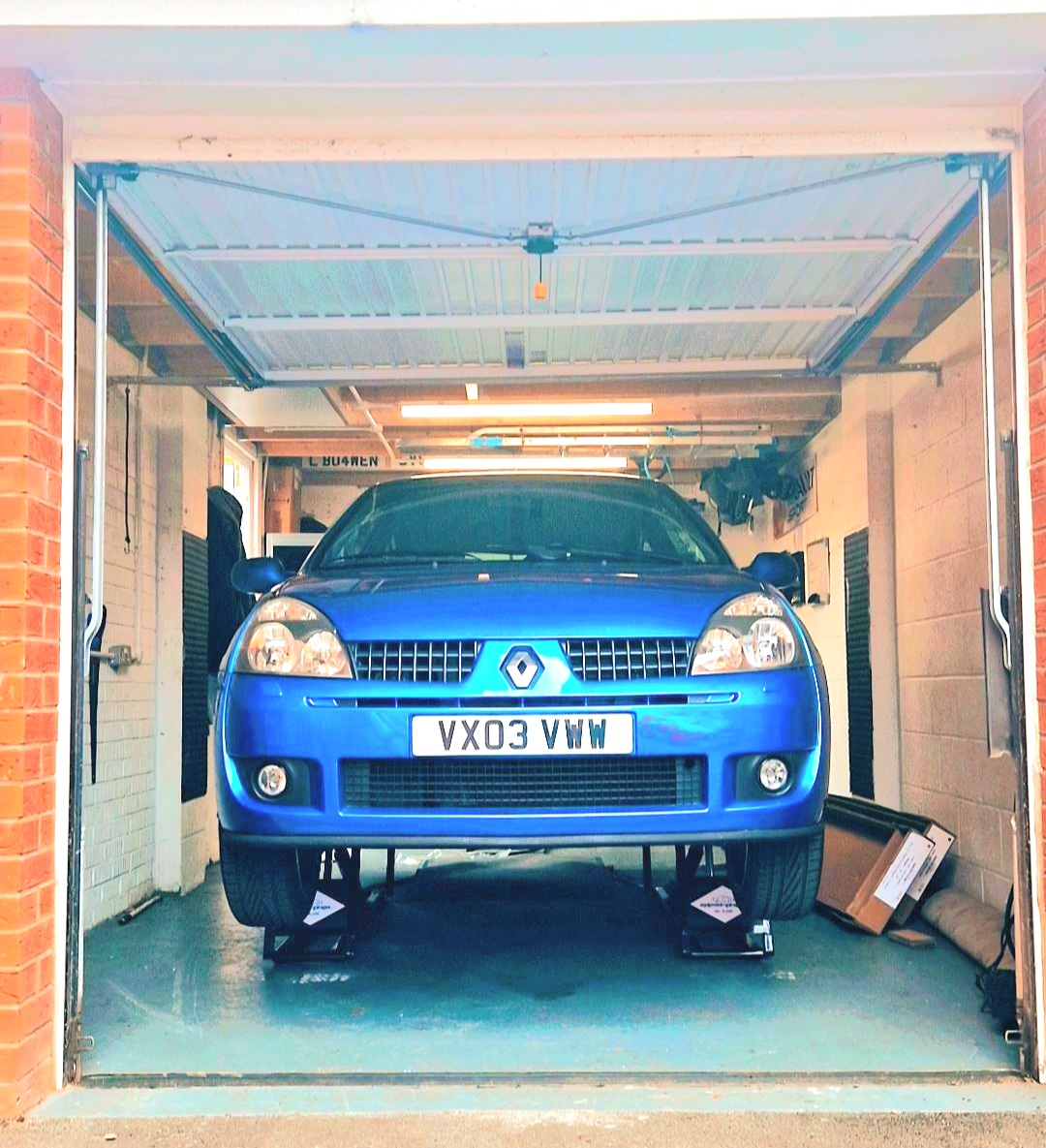

Got tired of jacking the car up on axle stands so ordered a set of Kwik Lifts. Best money I've ever spent.

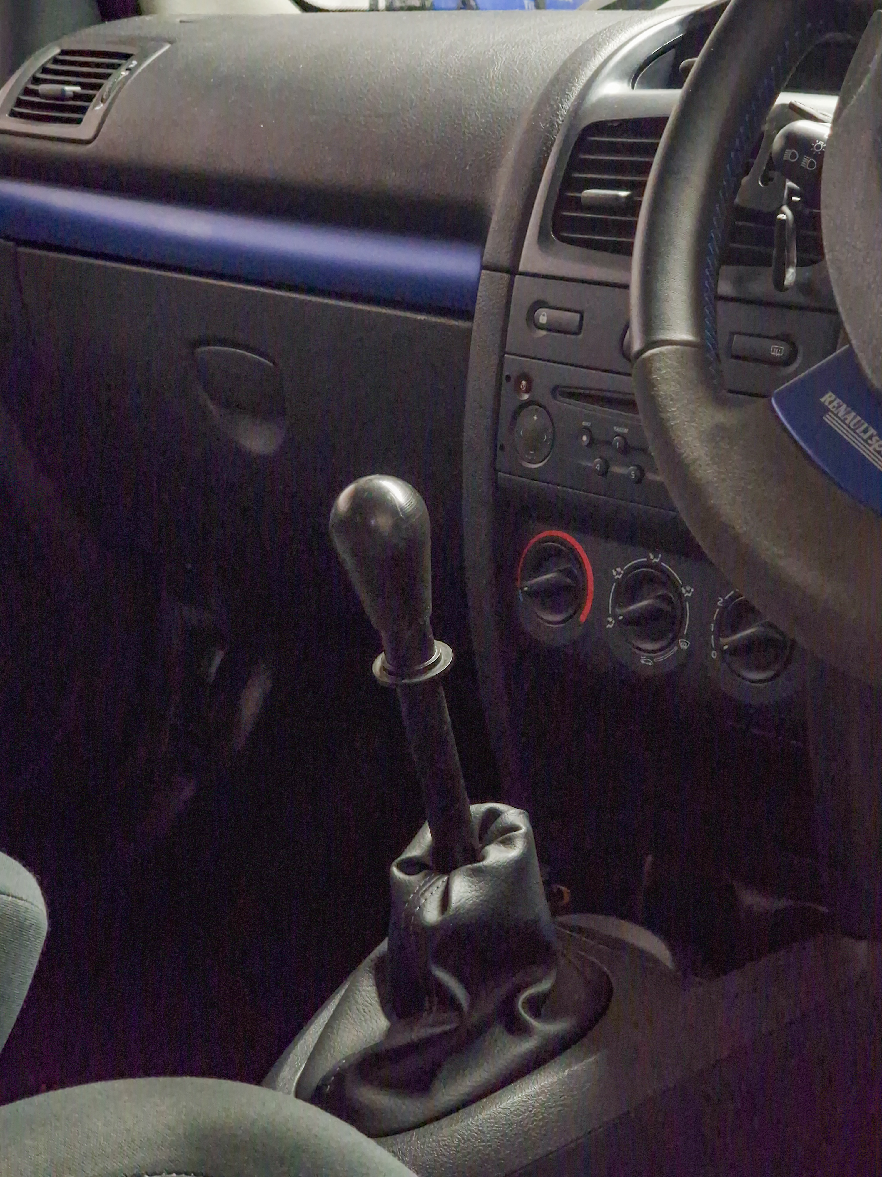

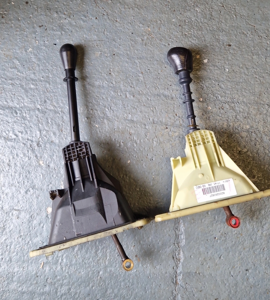

First up I spotted a BMS shifter for sale. I've never had a BMS only PMS and as I wanted to keep this Clio 'user friendly' I knew that a PMS may not suit my needs. Yes it's a great shifter but it rattles, yes you can solve the rattle but I couldn't be arsed chasing those rattles. So I opted for the BMS.
Fitting was easy. I also sprayed the shaft black as the standard metal looked out of place.
It looks and feels like a PMS, ok it hasn't got that 'Lee Enfield bolt action rifle' feel of a PMS but it's silent and brings the knob much closer to the wheel, which was ideal.

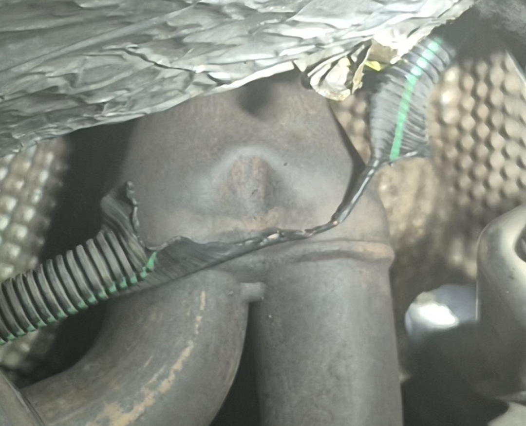

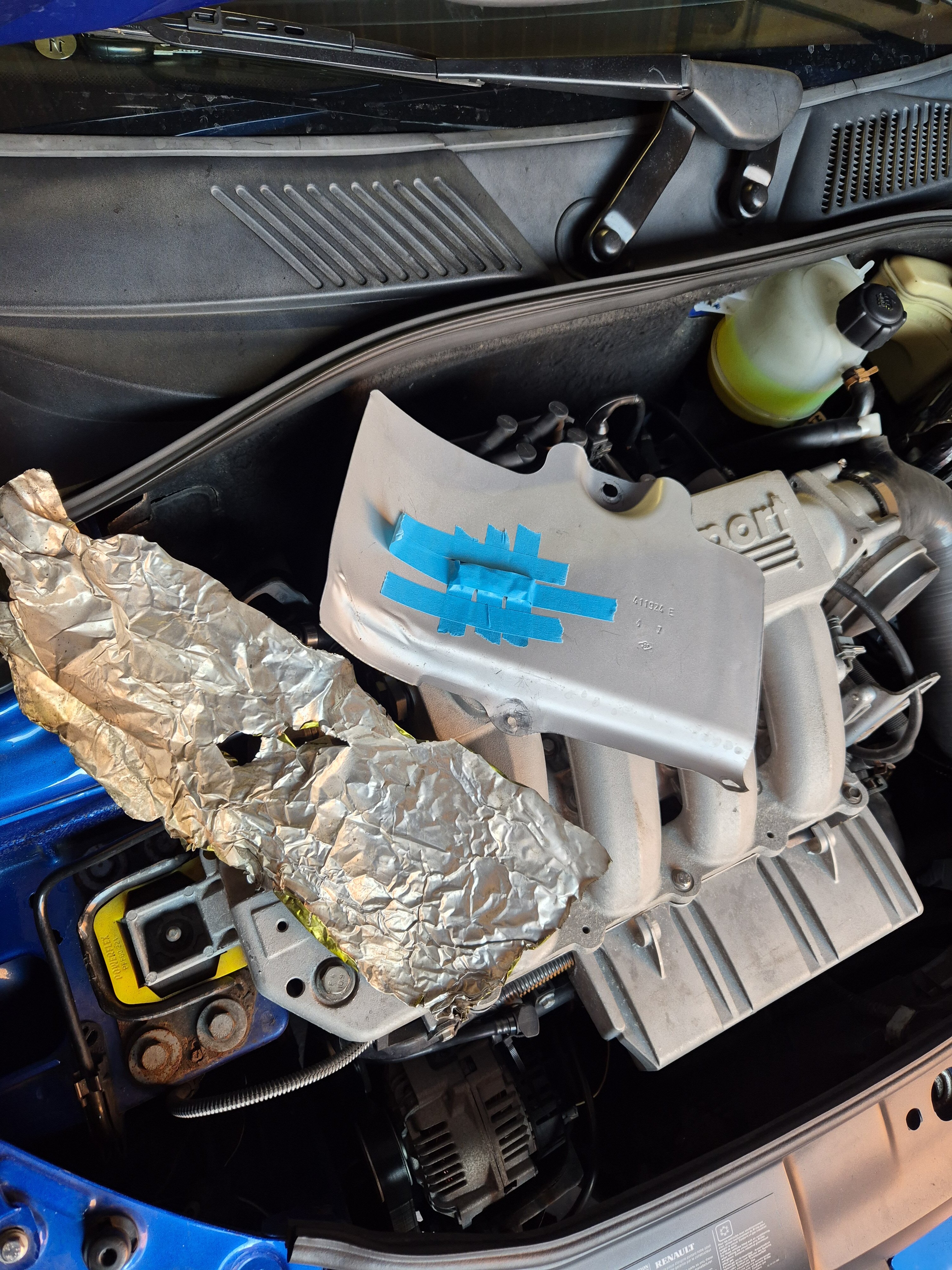

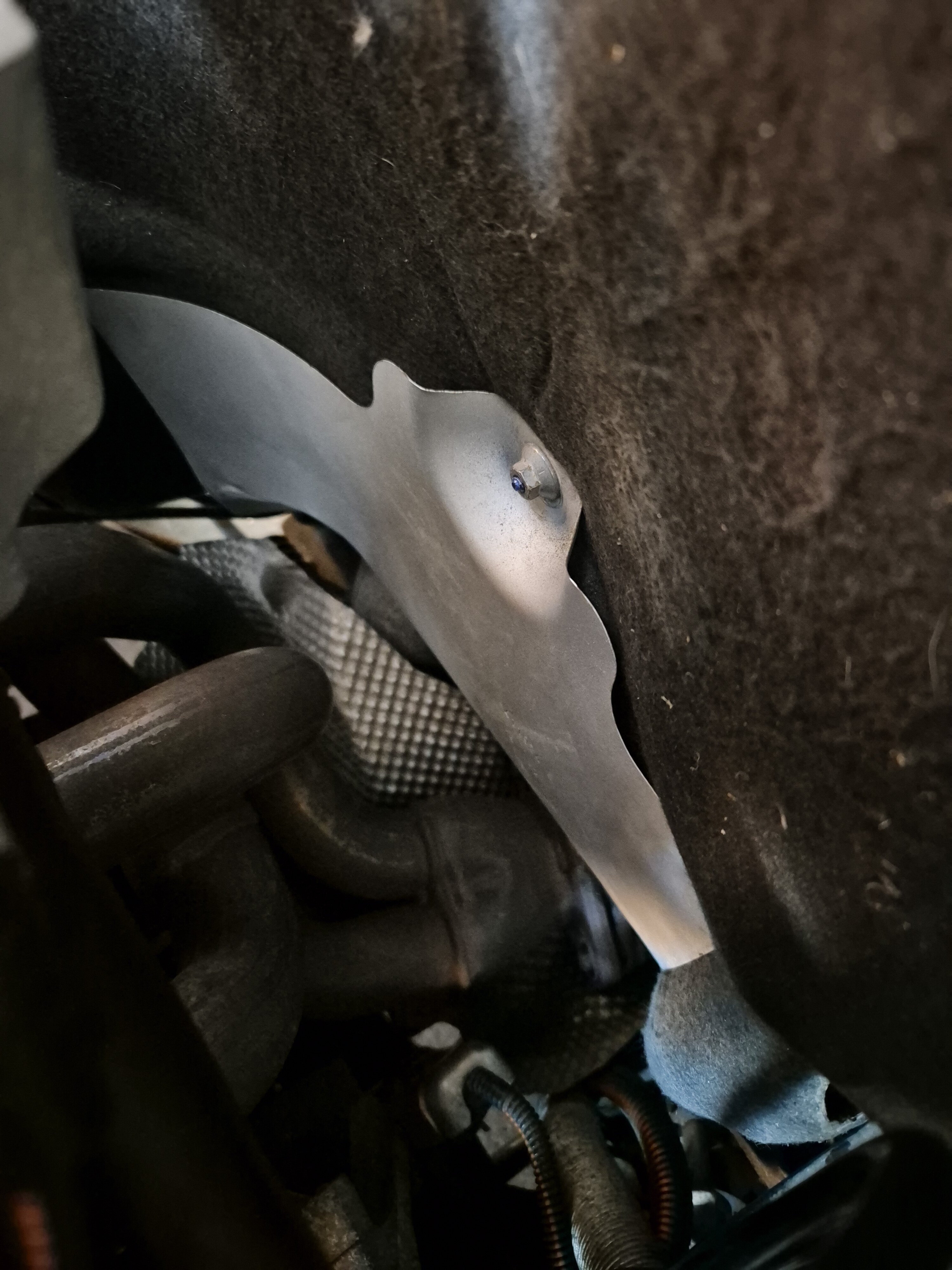

After fitting the clutch I had an intermittent flashing stop light. Quick search on here and it was recommended I top up the brake fluid. So I did and the light went away, for a bit.
When I went on the drive pictured in the last post, the stop and handbrake light were on almost constantly. I could get both lights to go off by accelerating. Problem solved, accelerate everywhere, always.
I started digging around and followed the new clutch cable around the fire wall and spotted this....
Clearly the new clutch cable knocked these wires on to the manifold.
That'll explain the lights and why my 5 year old daughter asked "Daddy why does your car smell like a barbecue?"
I stripped back the conduit and soldered in some wires, routed the wires higher and for now just wrapped in electrical tape, until my amazon next day delivery conduit arrives.
Quick test drive and the lights are out and no more BBQ smell.
Clio and the BBQ sniffer.
Following on from the last post.
I soldered, heat shrunk and put fresh conduit around the cooked wire.
I placed the wires high up out of the way and refitted the remaining heat shield which is attached to the carpet. The heatsheild was hanging on for dear life so I ended up binning it and replacing it with a Clio 1.2 heatsheild which is OEM and a tidy upgrade.

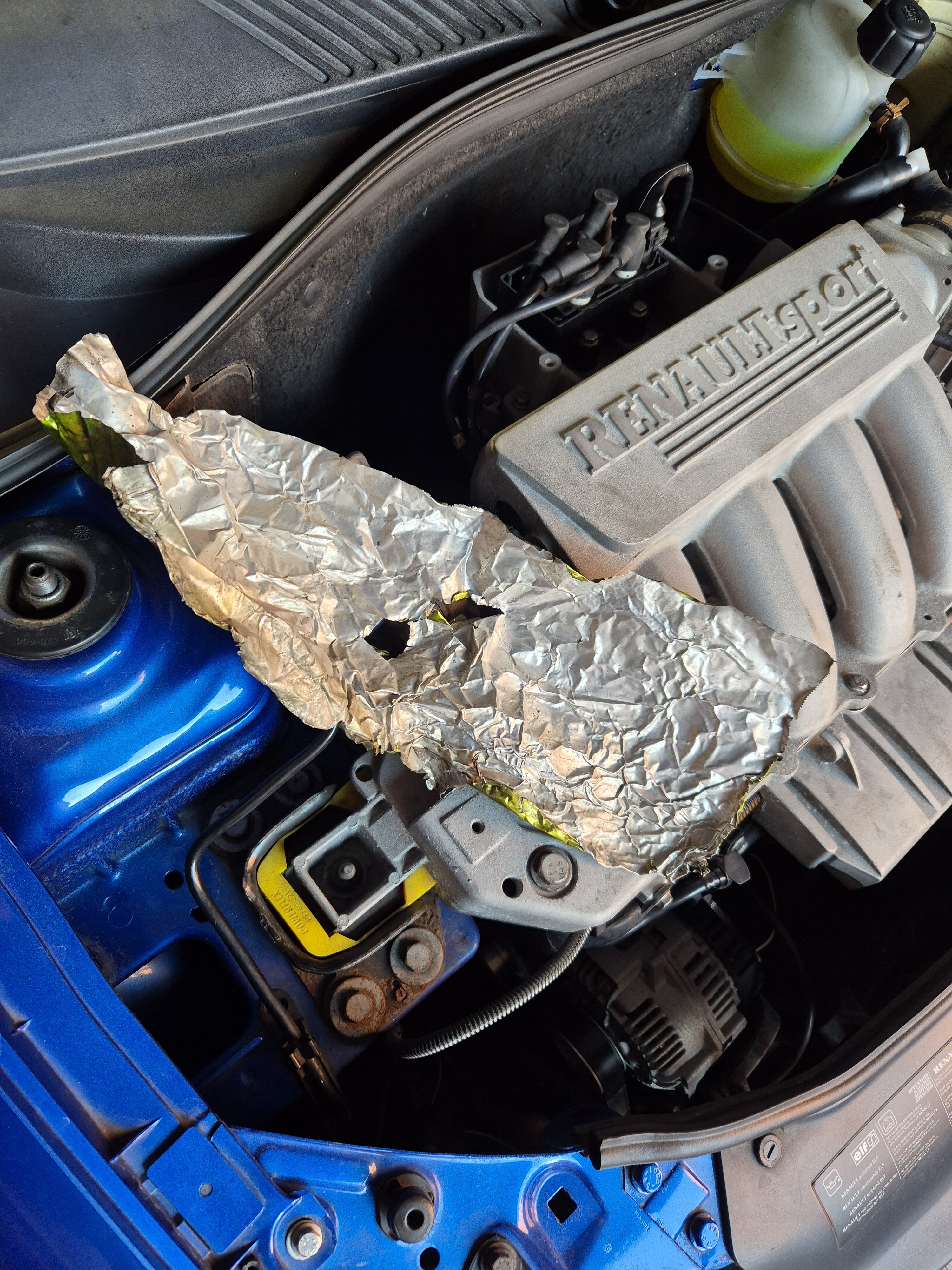

The 21 year old tin foil.
Next to the 1.2 heatsheild.
Fitted.

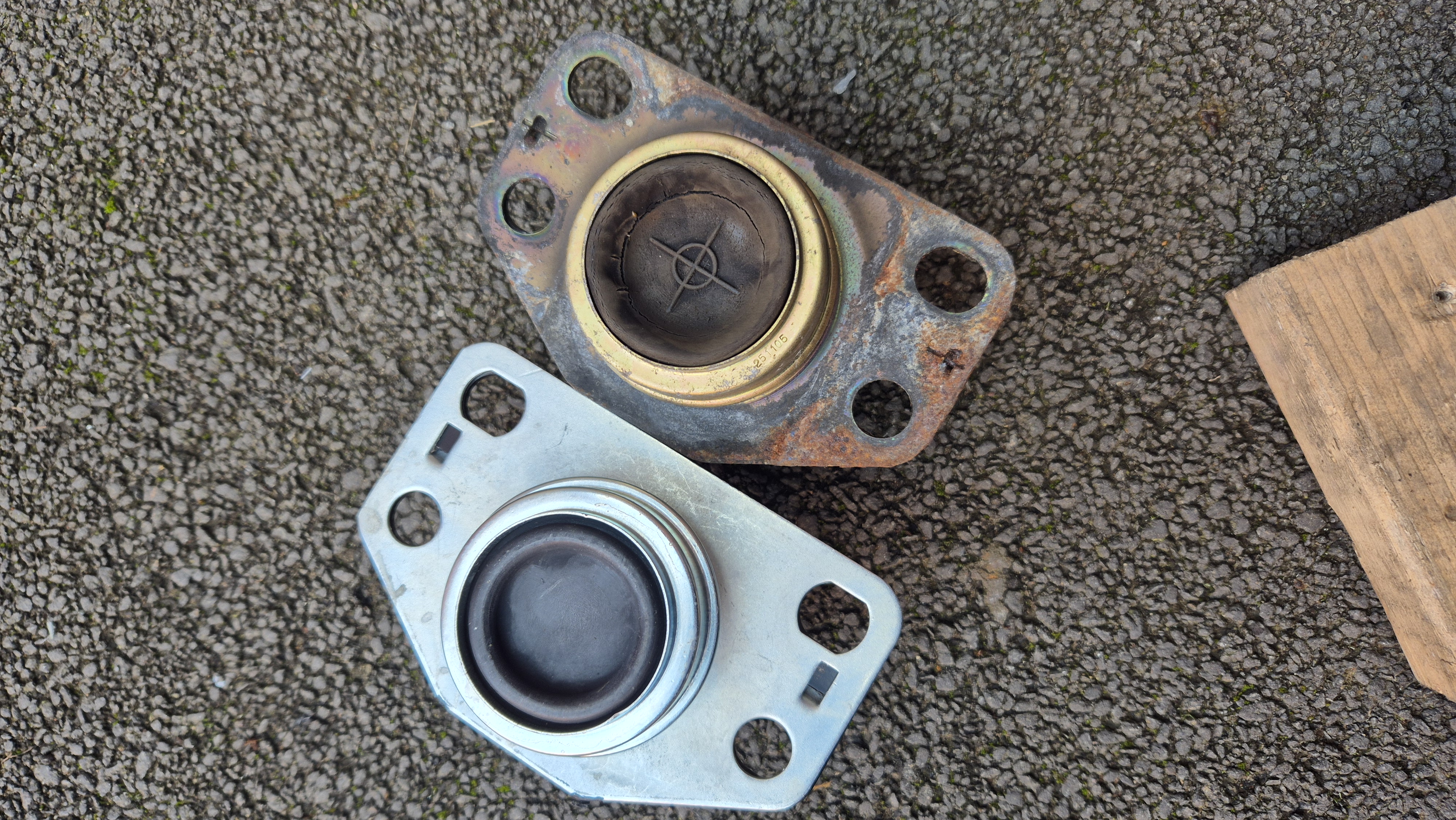

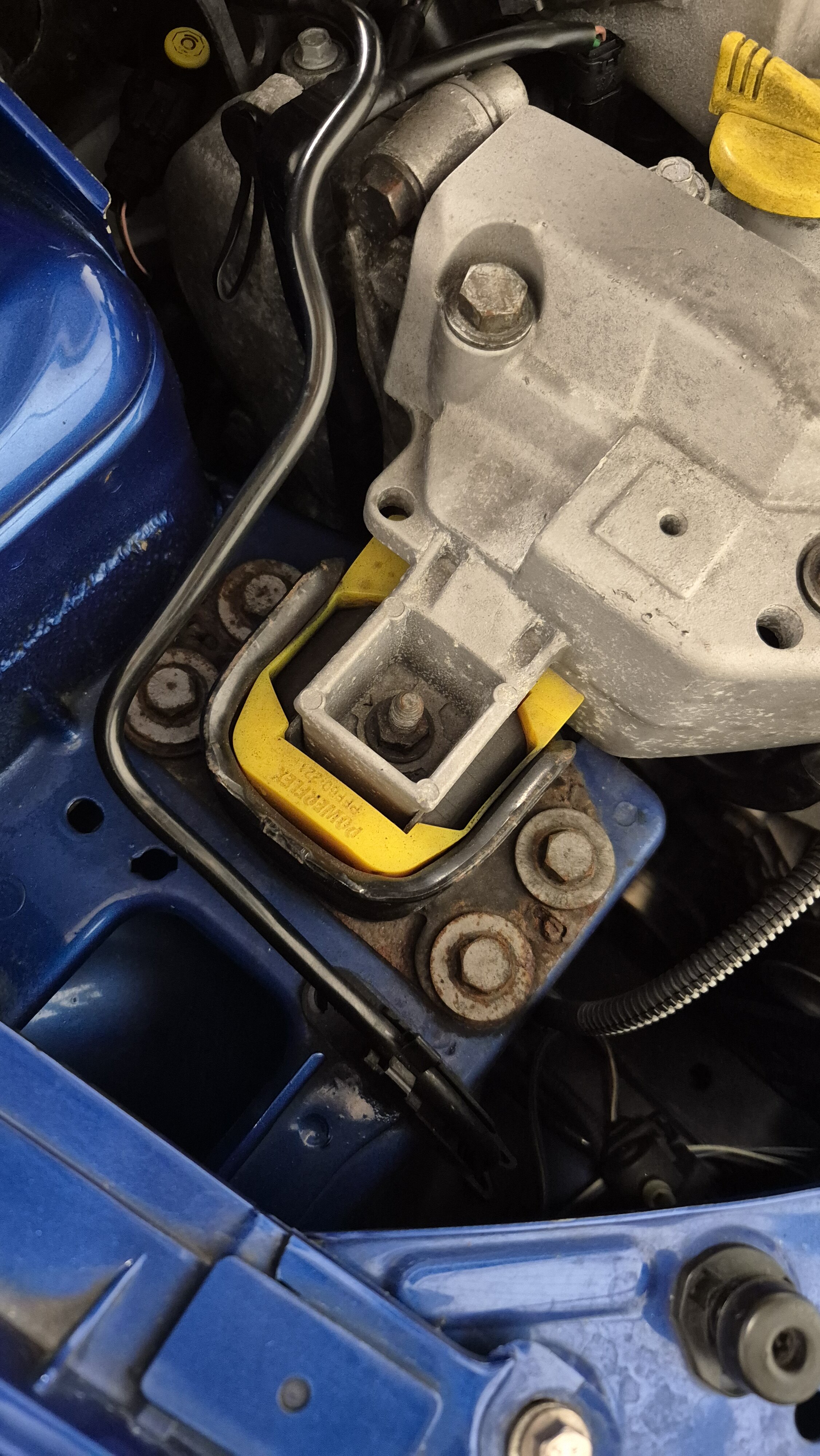

Engine mount looks a bit tatty, so I might freshen that up.

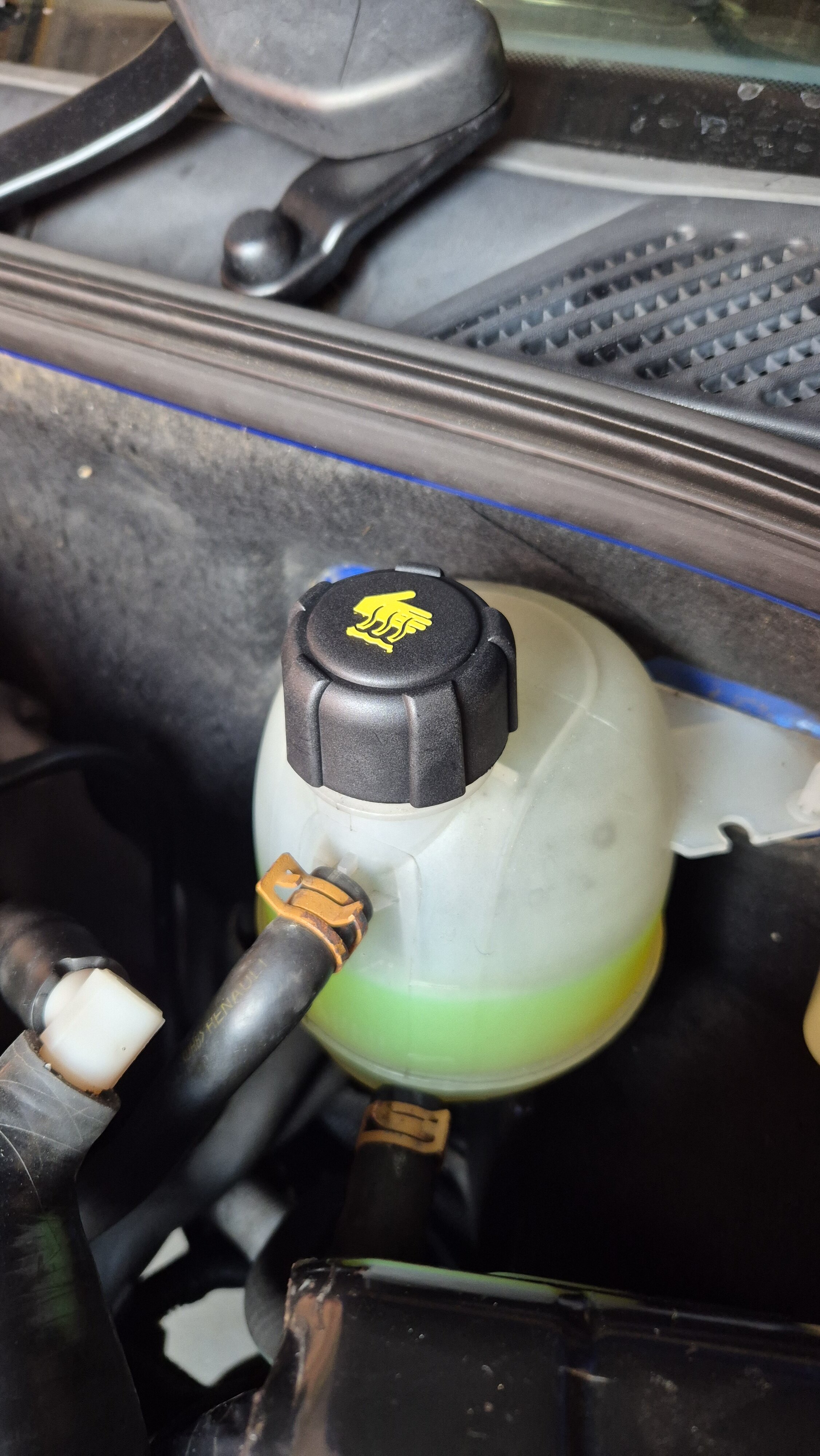

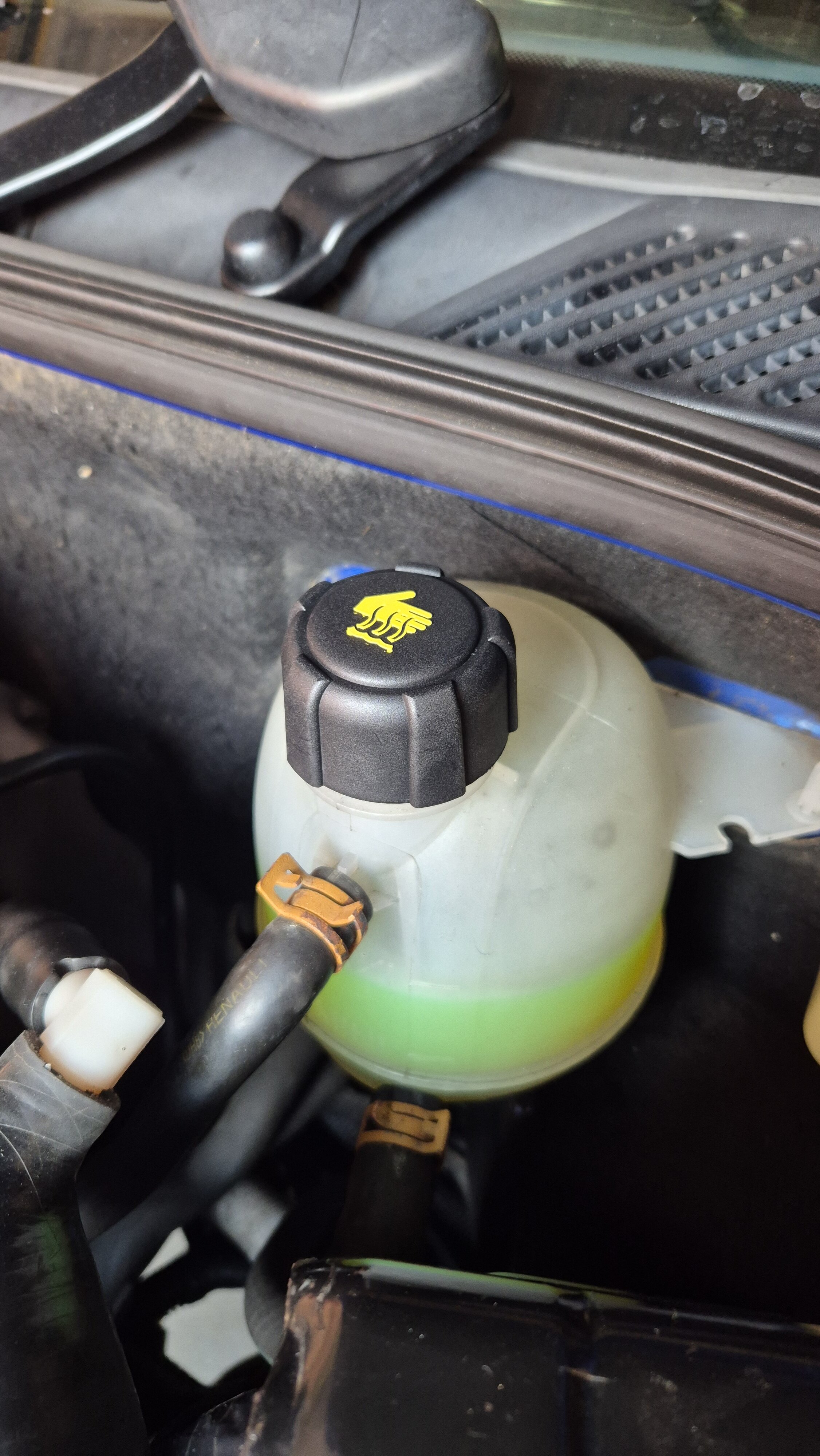

New coolant cap.

Suspension - could do with a freshen up, nothing wrong with it but I'd like to 'upgrade it'.
