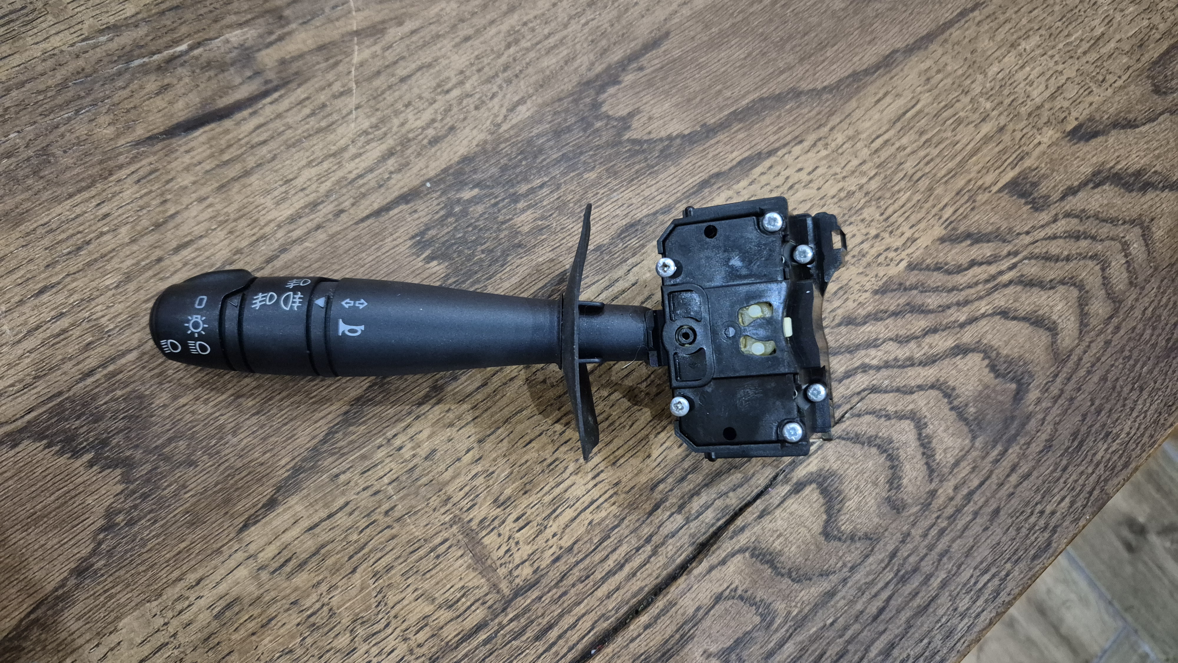

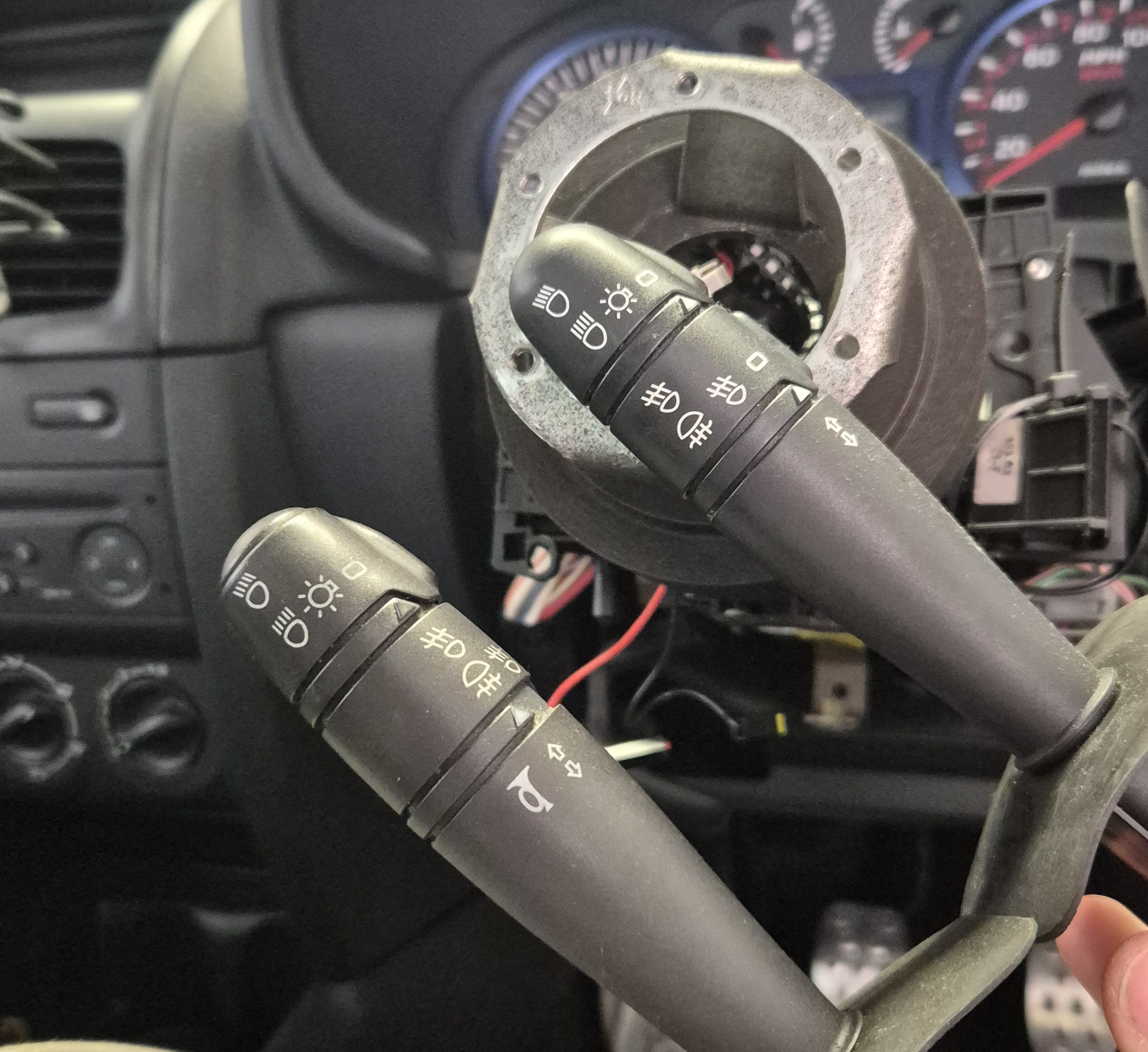

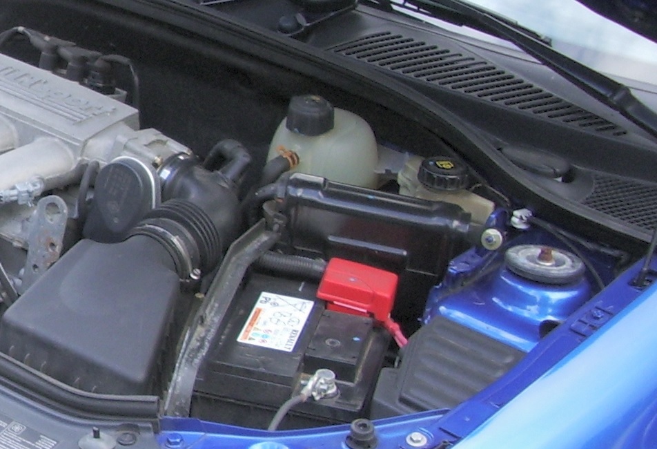

In the effort to keep things OEM+ I've decided to swap in a PH1 Stalk with a horn and a genuine Sabelt Steering Wheel.
That's this weekends jobs sorted...
They do look a bit odd and out of place. God knows why they're brown?

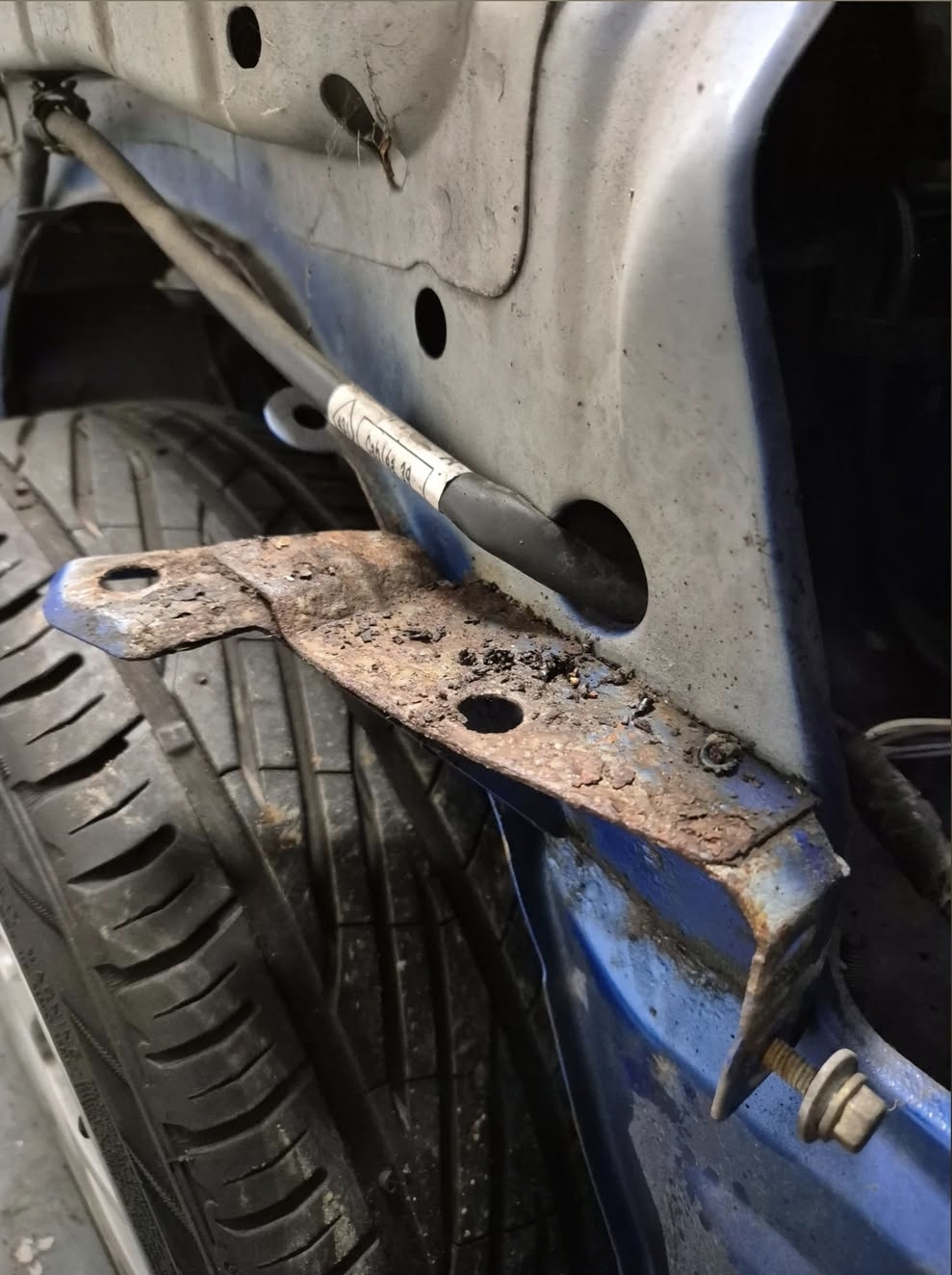

Rust - they've been cleaned up but start to corrode immediately unless treated. To retain the "metal look" ACF-50, machine oil, WD-40 can hold the rust back, but a bit of a chew as it soon dries out. I use a clear coat, which does that job or a Cold Blueing oil - for guns - which leaves them Black.
MRBILLYUK
  FF Jeden Osiem Dwa
I stand corrected. I've just been to fill the screen wash up and checked mine. They are lightly coated in rust. I've had the car since new and they've always been rusty as far as I can remember lol.

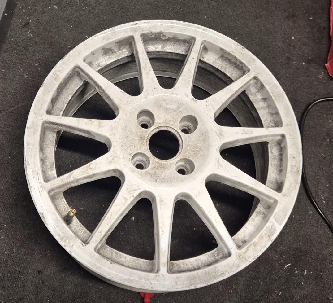

I picked up a spare Turini from a nice guy from Carmarthen called Andrew. Said he was a member on here.
Genuine, straight, cup offset Turini.
Refurbed and a tyre stuck on it.
Just adds a little something to it IMHO.

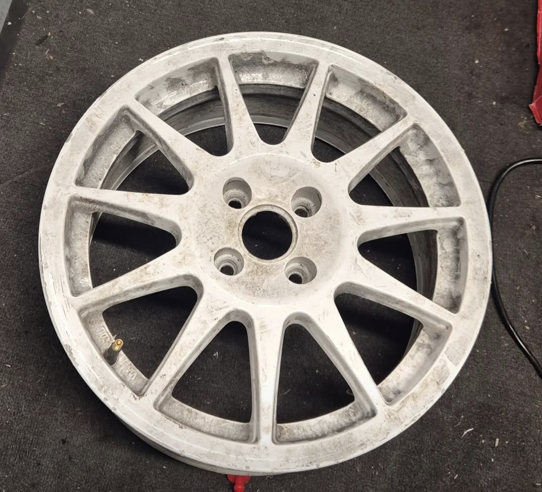

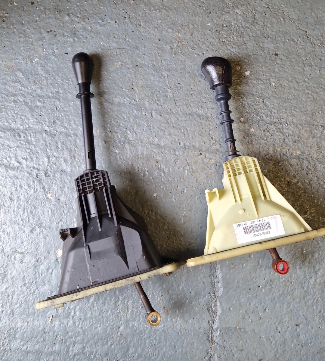

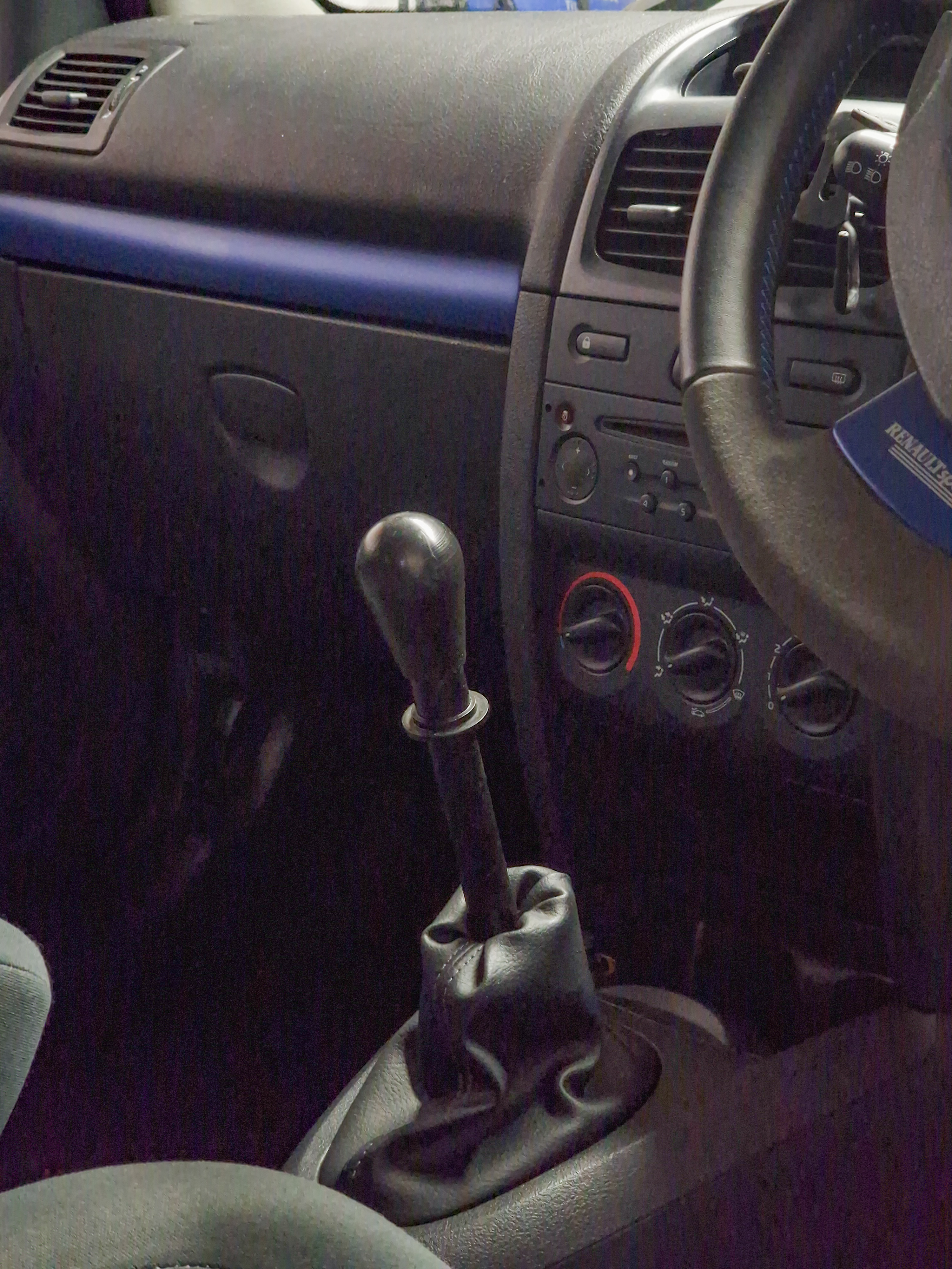

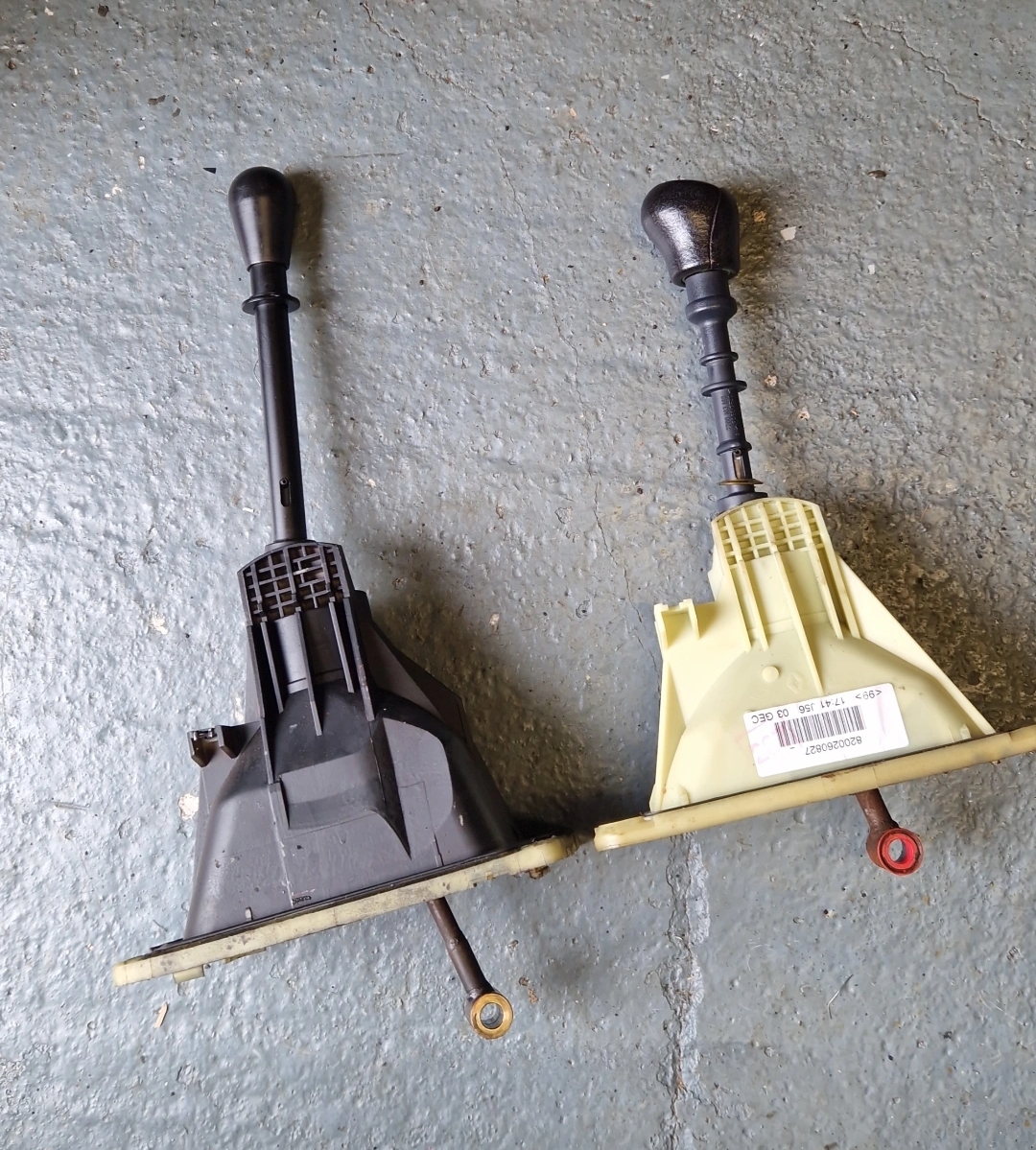

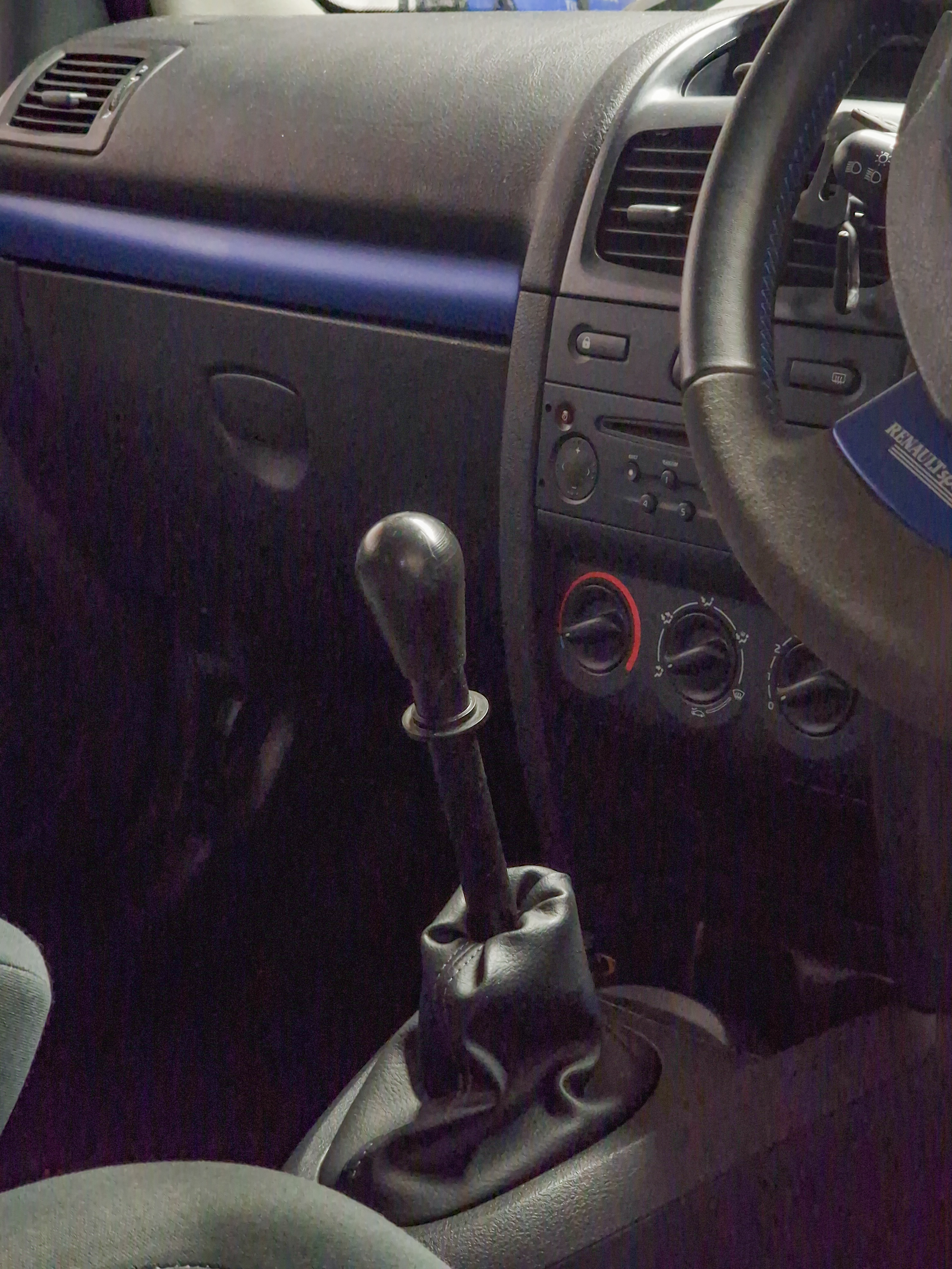

First up I spotted a BMS shifter for sale. I've never had a BMS only PMS and as I wanted to keep this Clio 'user friendly' I knew that a PMS may not suit my needs. Yes it's a great shifter but it rattles, yes you can solve the rattle but I couldn't be arsed chasing those rattles. So I opted for the BMS.
Fitting was easy. I also sprayed the shaft black as the standard metal looked out of place.
It looks and feels like a PMS, ok it hasn't got that 'Lee Enfield bolt action rifle' feel of a PMS but it's silent and brings the knob much closer to the wheel, which was ideal.

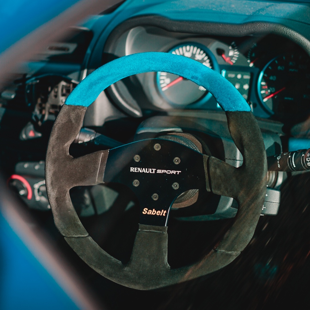

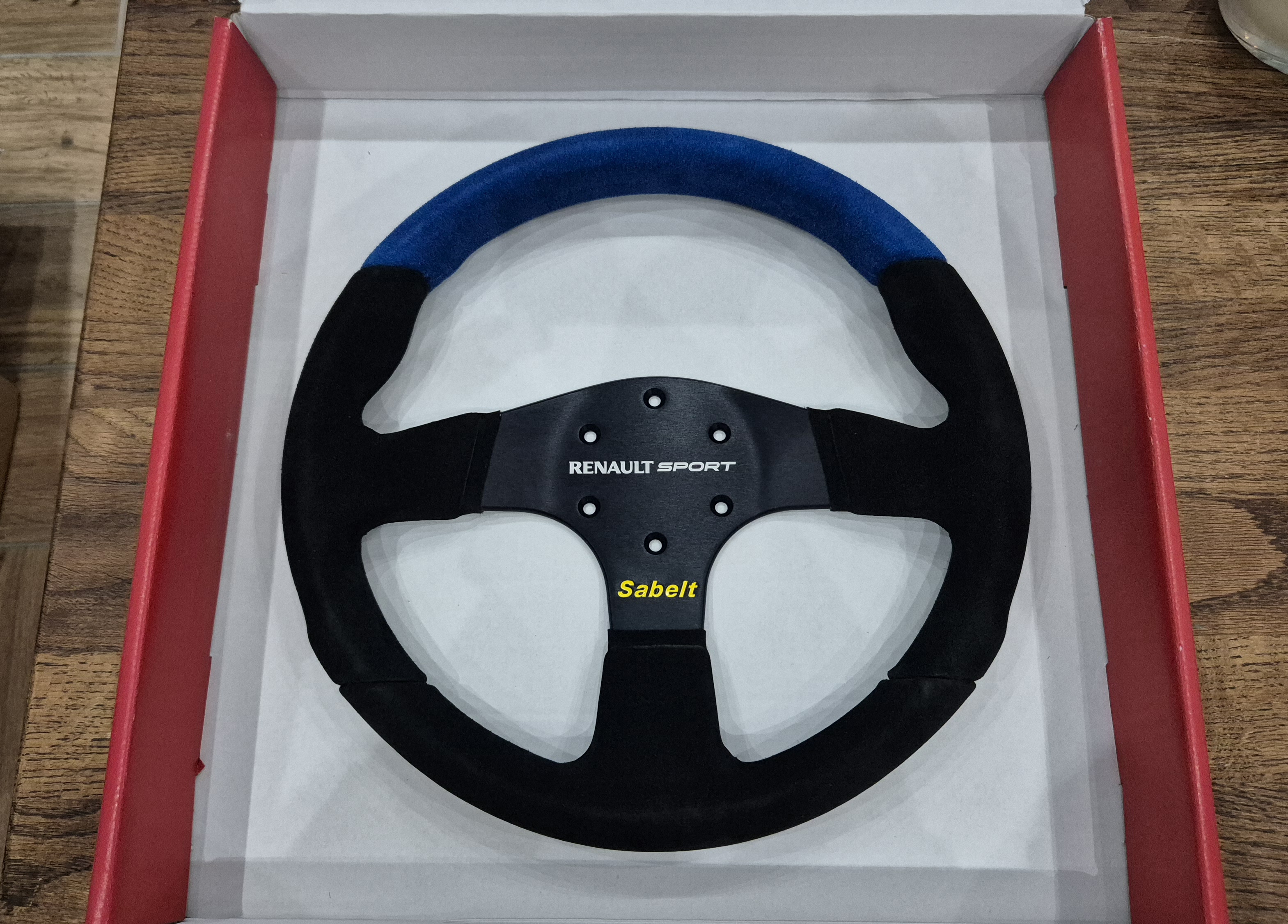

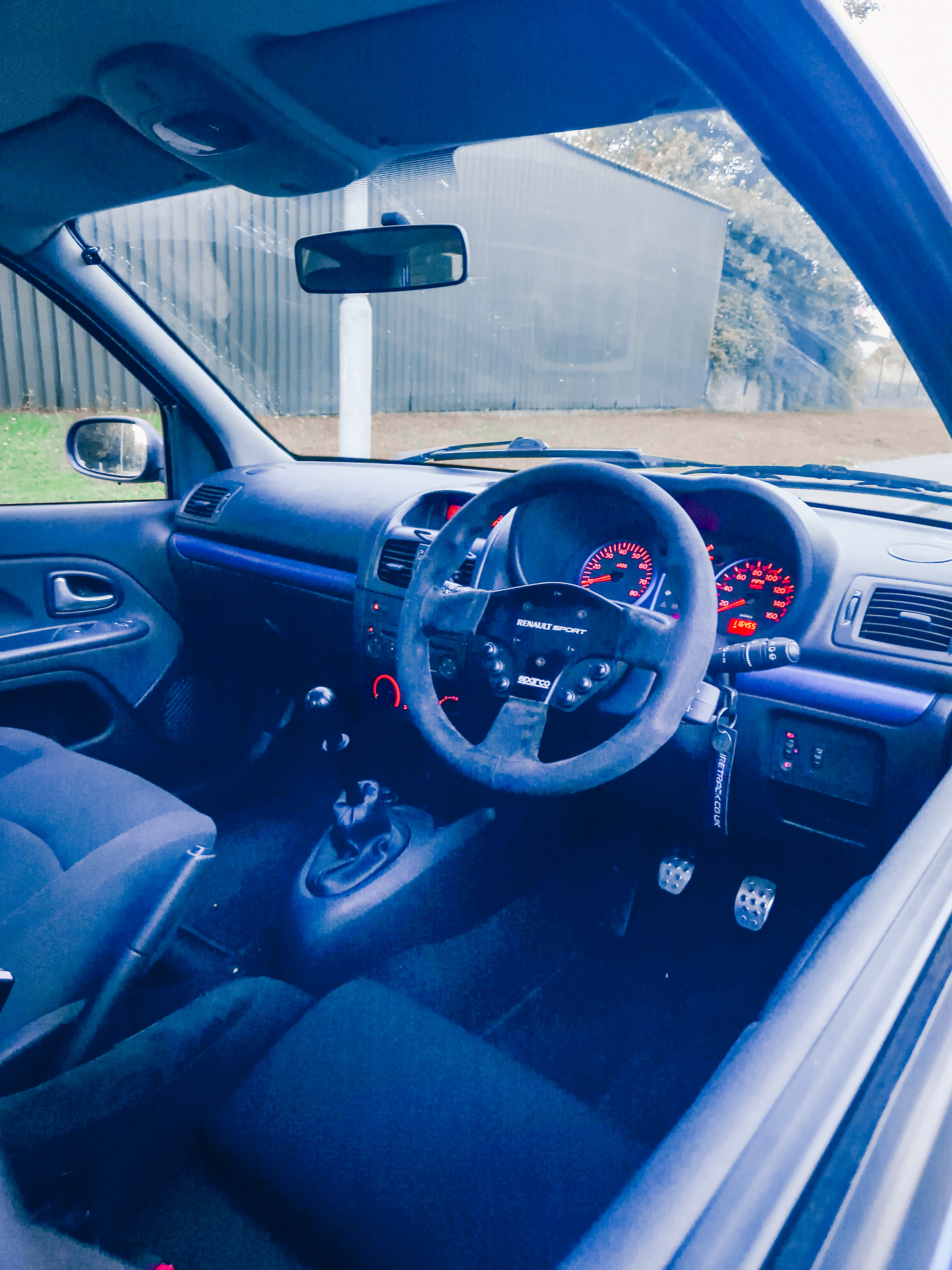

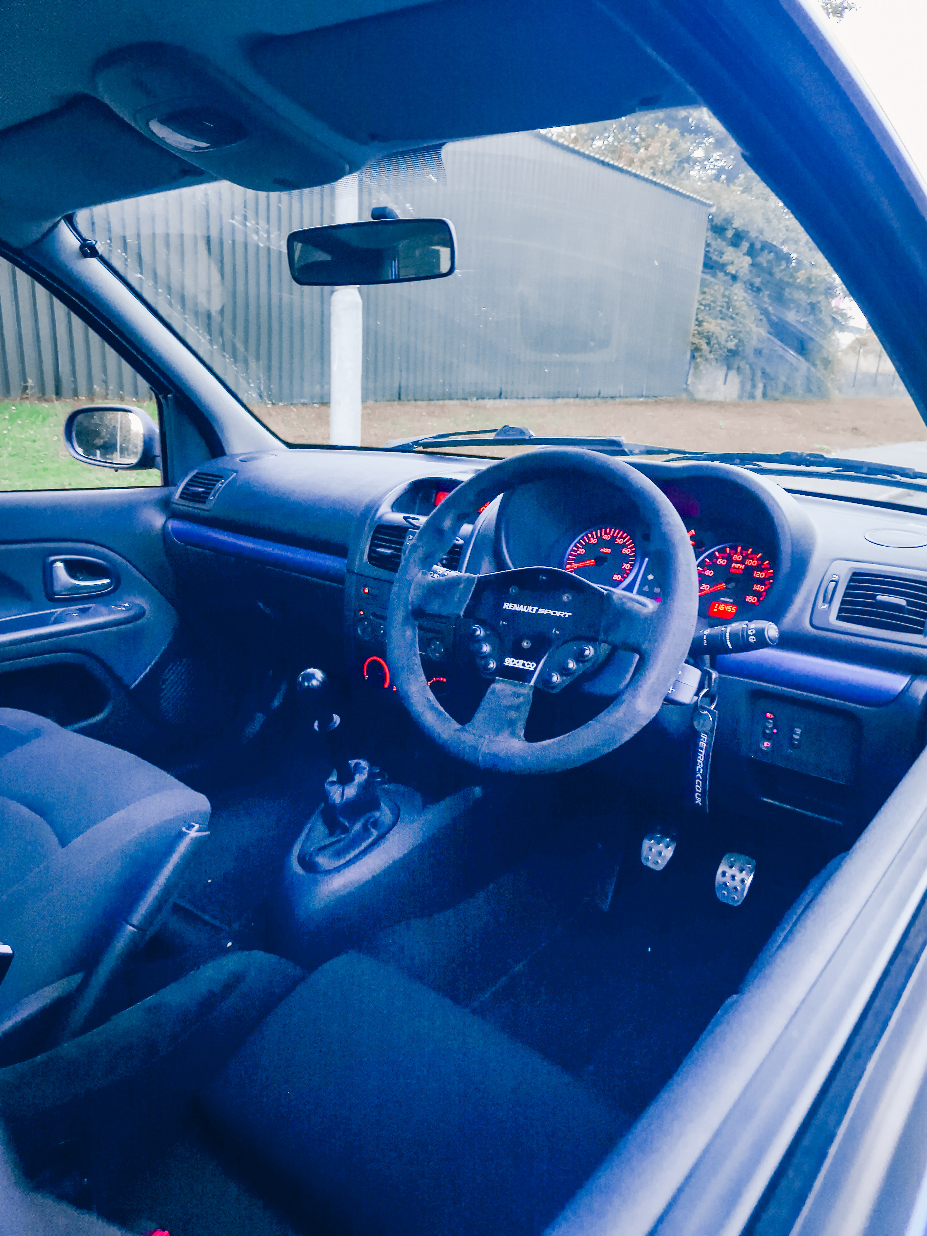

Then a smaller steering wheel was purchased. I'm in the process of giving this a really good clean any tips on what to use or how to clean it let me know.
The six button panel came with the wheel and boss. On the look out for a two button panel.

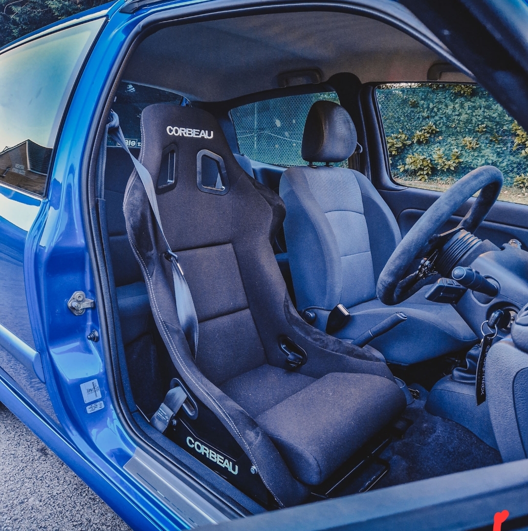

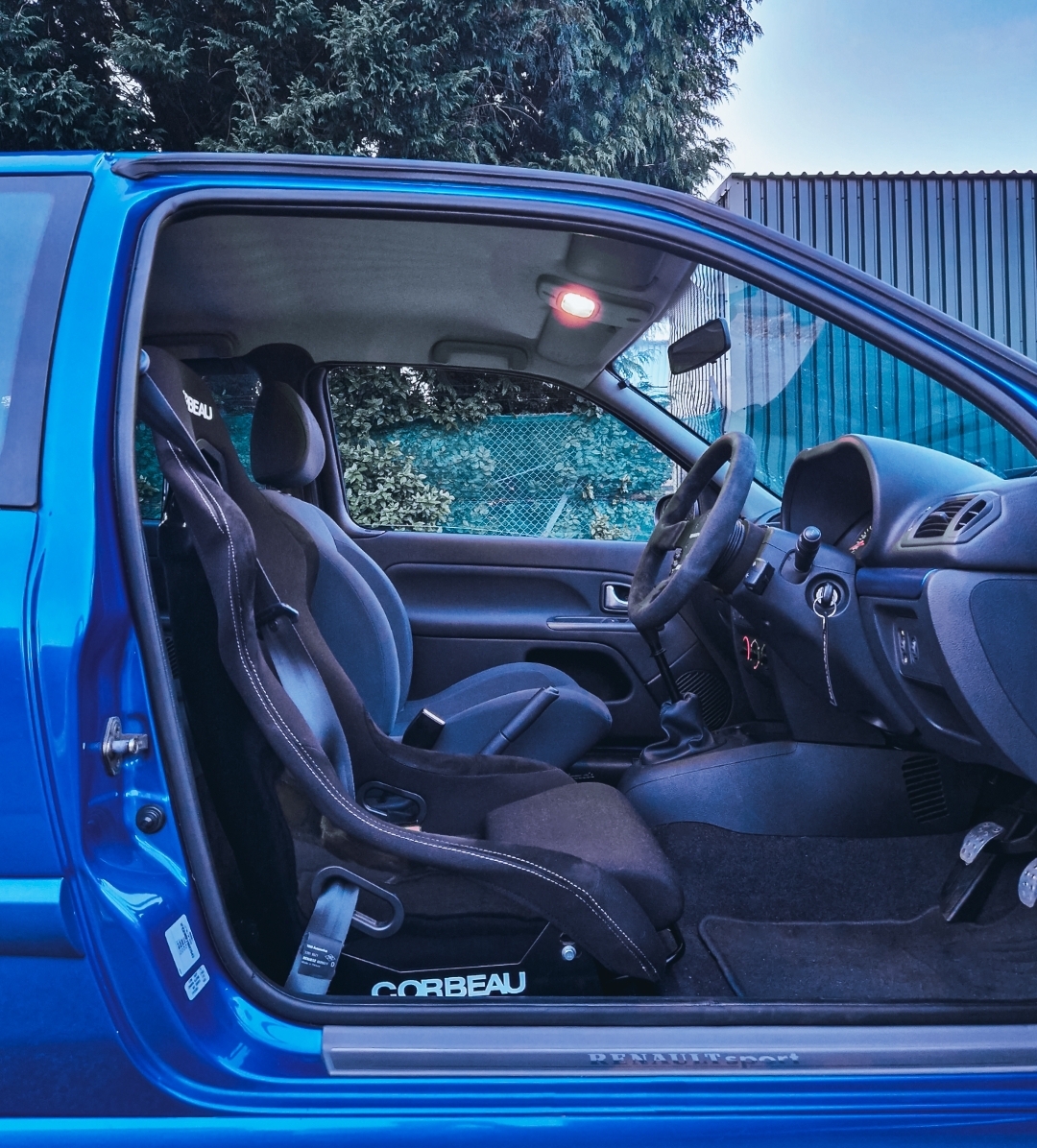

Lastly, for now anyway, Seats.
The Cup seats are actually quite comfortable and more hugging that the normal part leather RS seats. However, they're just too high for me at 6ft 1. So I picked up a pair of seats, runners, sidemounts and bases up.
Now, I am tempted to leave the Cup passenger seat in place as the whole idea of this car was to make it 'family friendly' and this means access to the rear seats. However having one bucket in there is messing with my OCD slightly.
I know the answer is reclining buckets but I could find any I liked. There doesn't seem to be a method of having a tilting bucket seat, so this is it for now.

Where did you get the BMS shifter from please? How has it held up over time?
Lovely car - will keep an eye out as also based in South Wales.
bowen86
Fel
BMS was for sale on FB. Quite hard to come by now.
Feels OEM but a better position and not as bad at rattling as a PMS. It doesn't however have that PMS feel.

Rusty bumper brackets, worst grinder back, deox c gel and Hydrate 80 before throwing some paint on it.

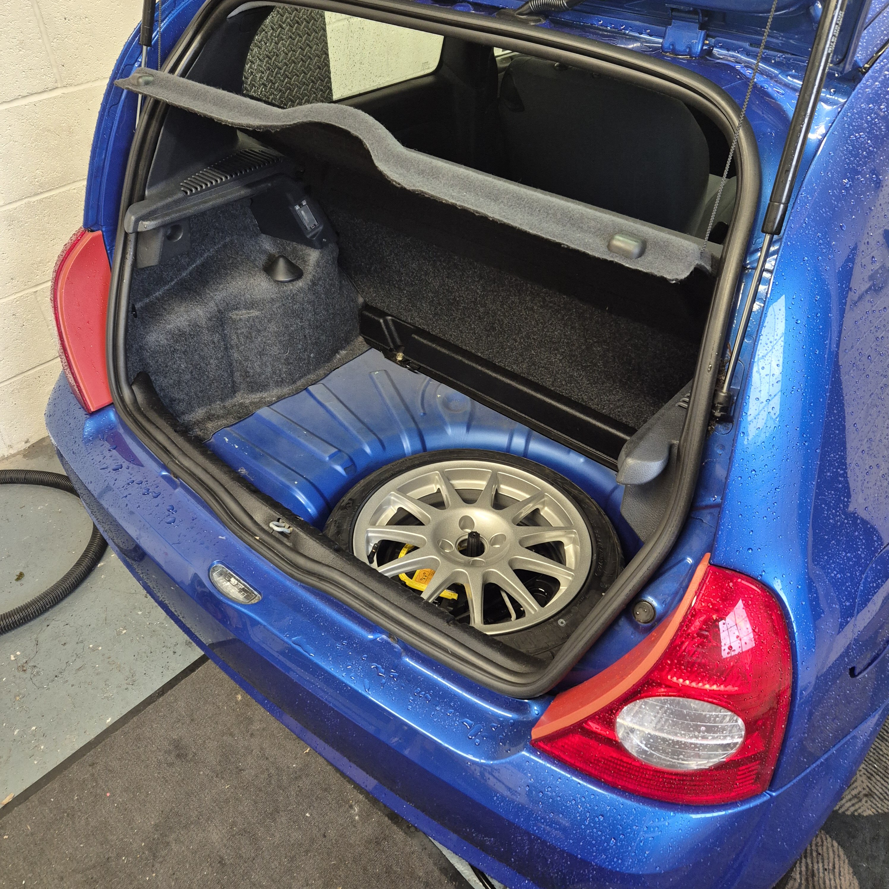

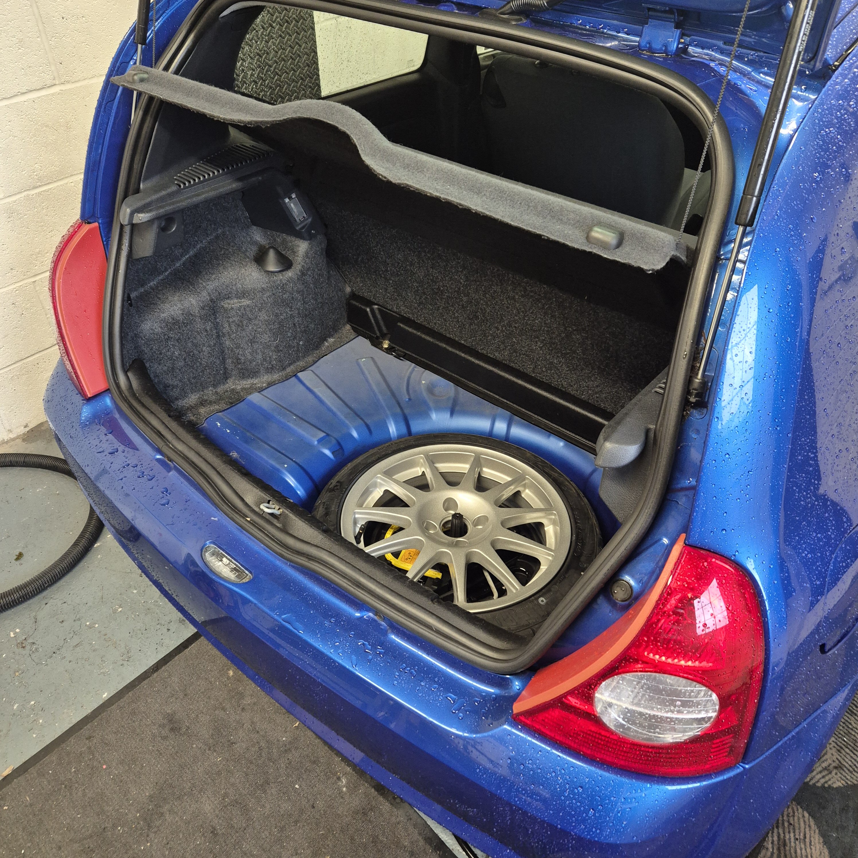

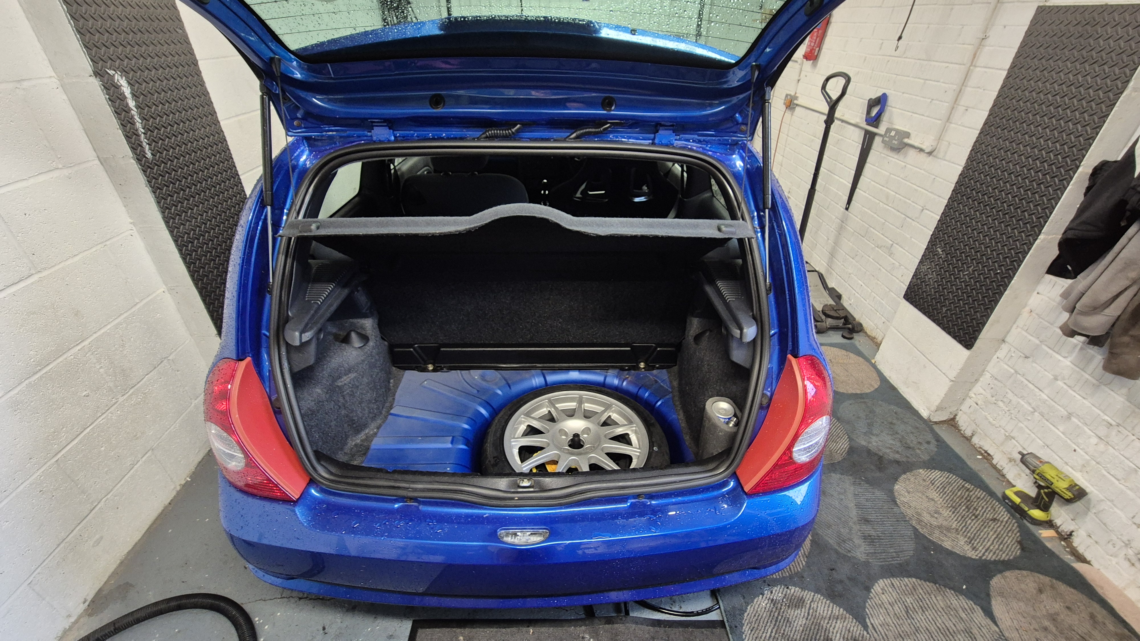

I previously mentioned I'd bought a spare Turini but the original tool kit wouldn't fit or rather thread on the bar in the wheelwell. Thanks to @Mattcup for the recommendation of using a yellow spare wheel tool kit thread. The wheel now fits.
Yes the wheel is face down, but I've used a few microfibres to protect it. The wheel won't fit face up with the tool kit below it, I've tried.

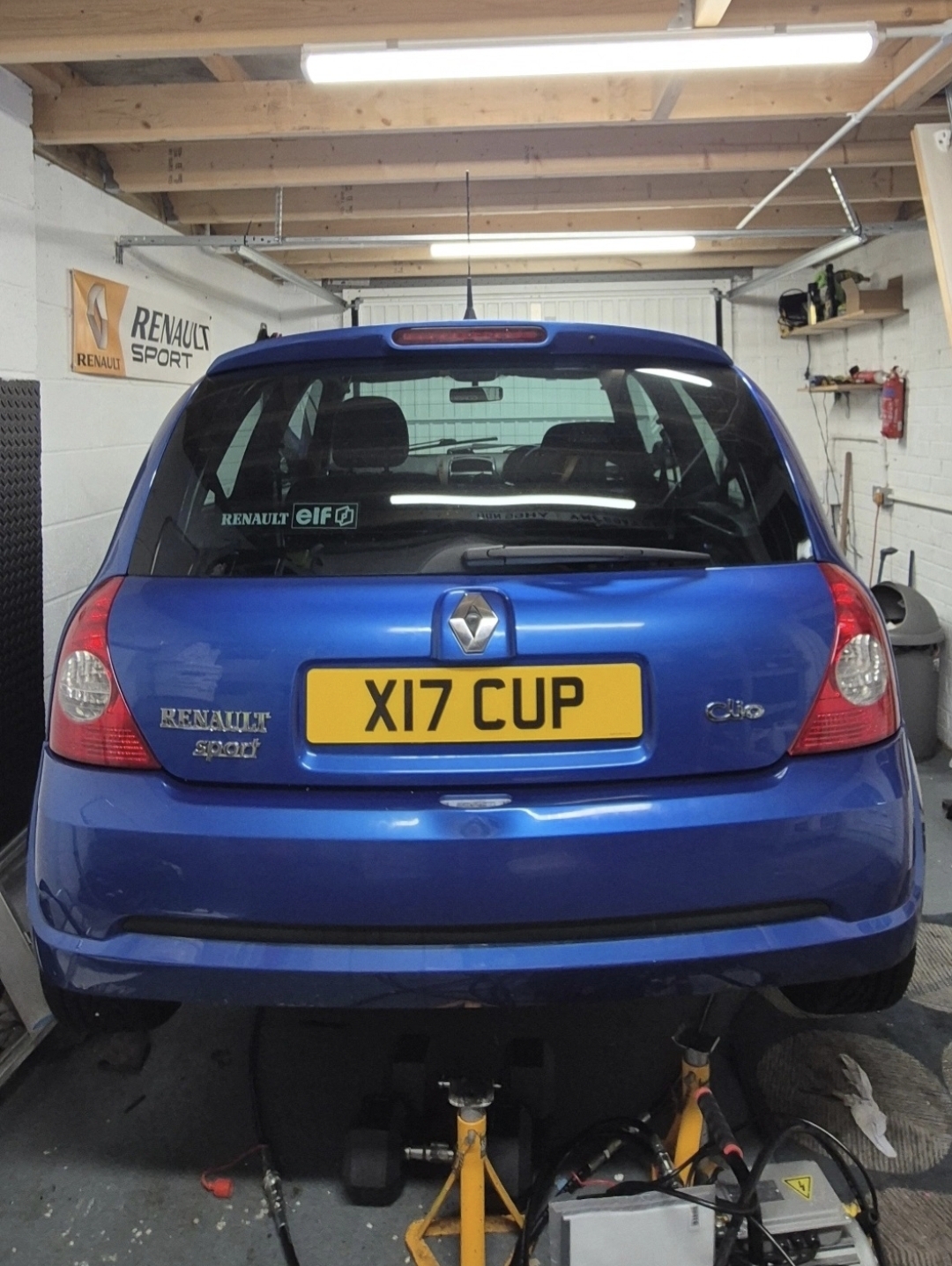

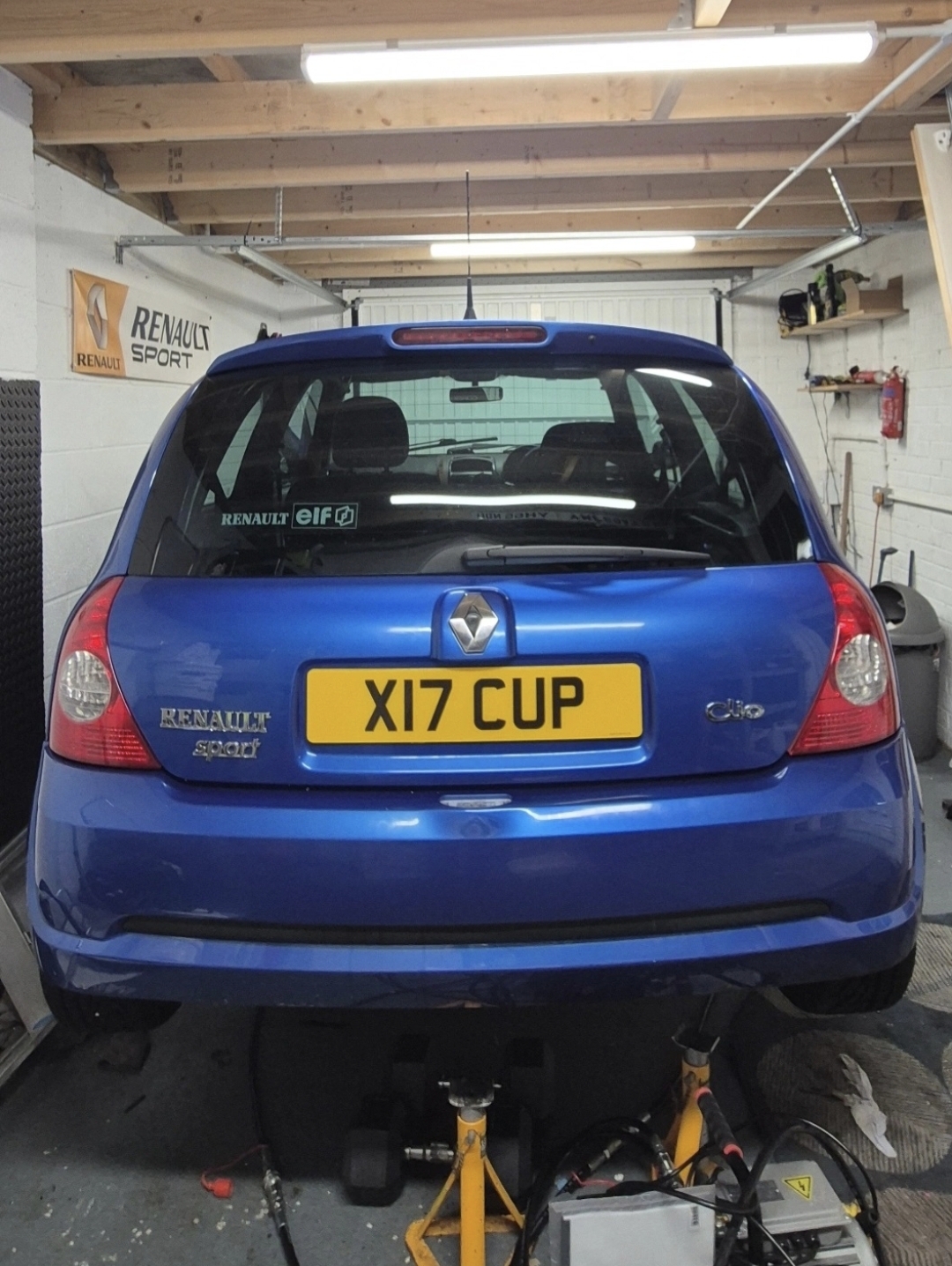

Dropped the car off to a local place for removing the rear beam, tank and exhaust etc and having any surface rust treated with dinitrol RC900 and undersealed with dinitrol 4941 and lastly front wheelwells treated with dinitrol 4010 and a linolin based coating. Also the rear beam was given a lick of paint too.
Before
Bits off
After
Really happy with the outcome.

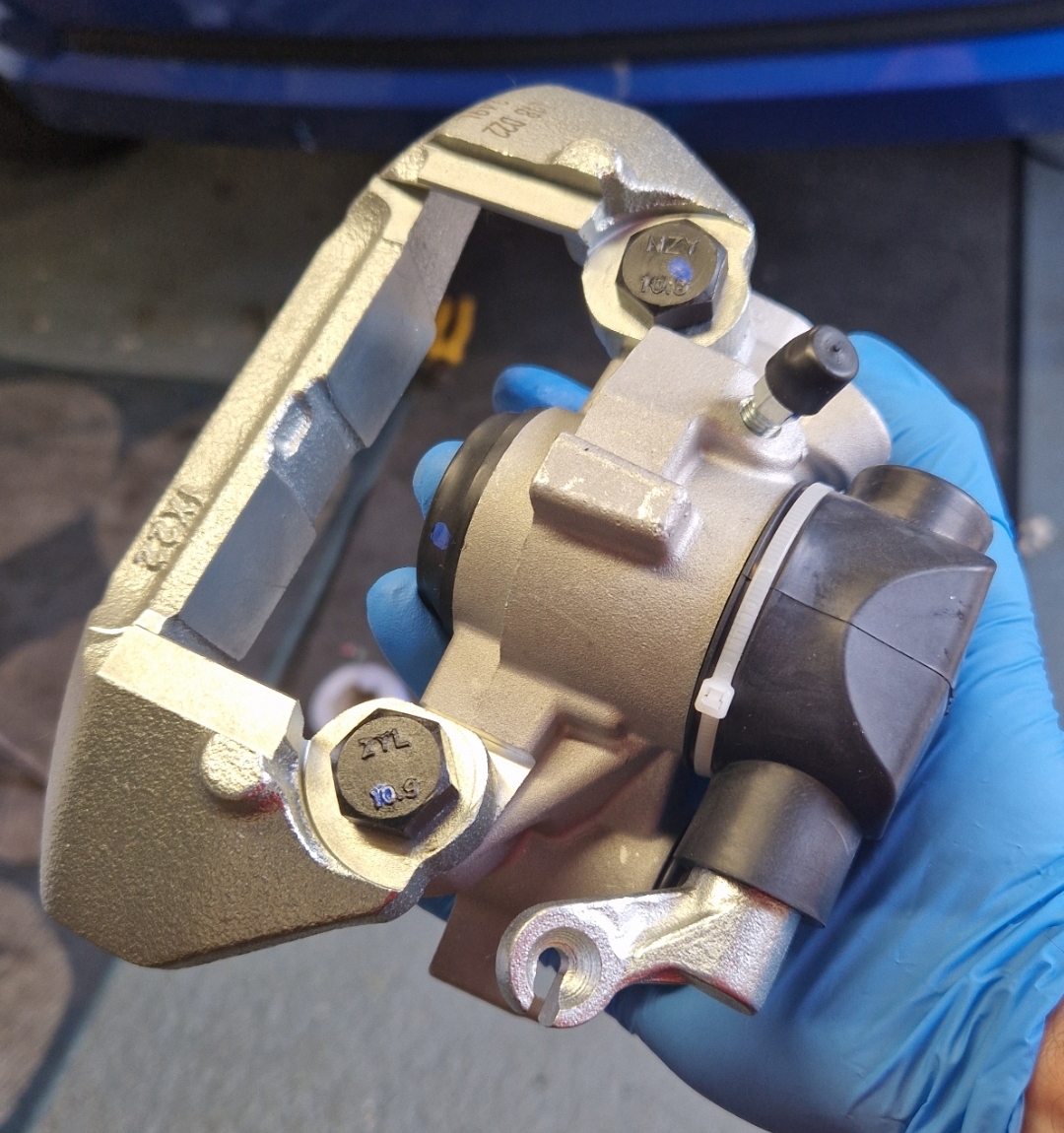

To finish of the rear refresh I thought it rude not to add some new rear discs and pads.
Sure we've all seen what old discs and pads look like but for the sake of documenting it:
Before
After
Looked like one bearing was on it's last legs as this rubber (at one time was rubber maybe?) seal decided to just fall out.
Also gave the hub spacers a spruce up and made sure to install them the right way around, thanks to info found on here.

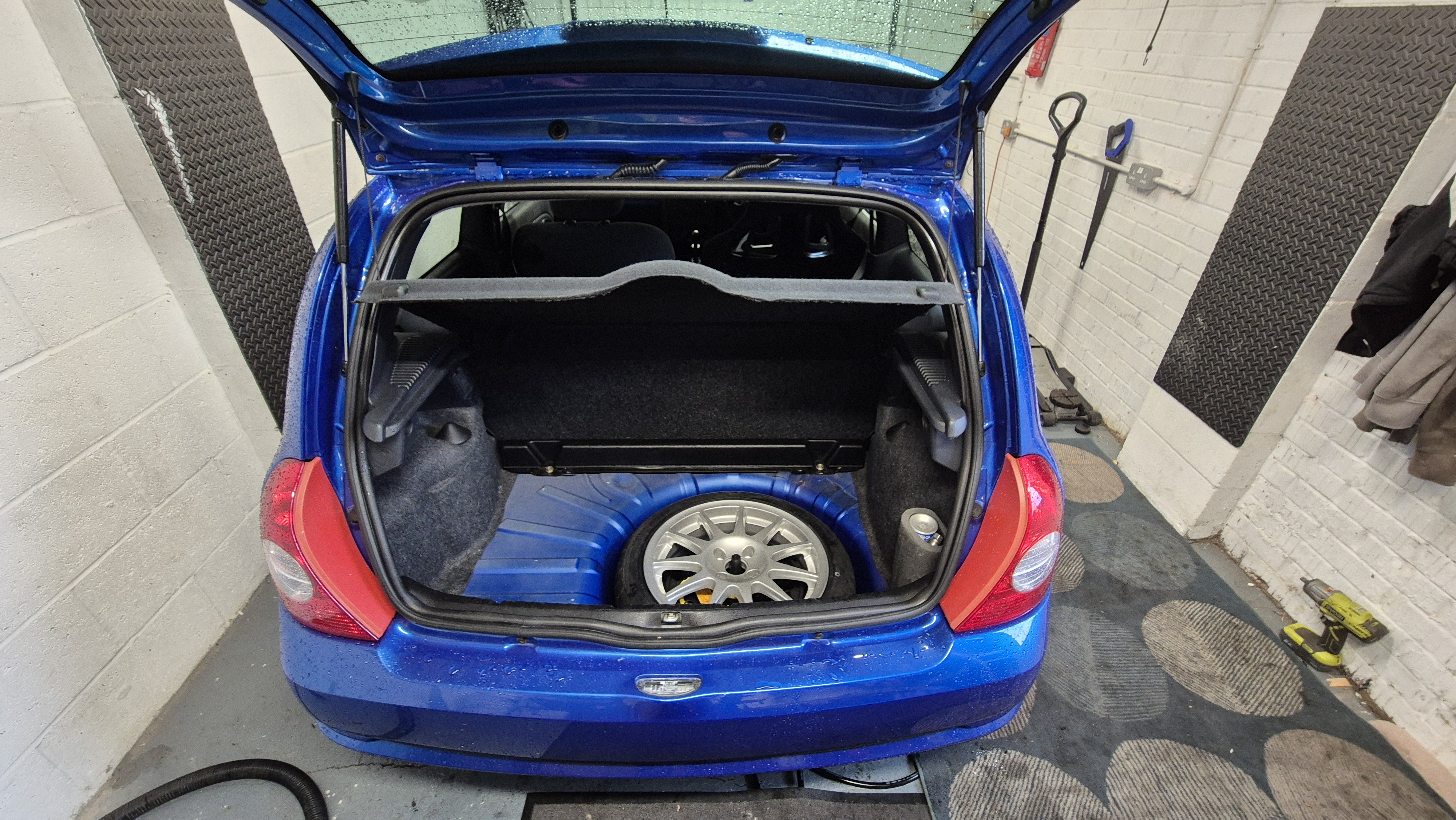

Hunting rattles and I'm snooping around the boot area.
The boot latch. Is it adjustable, I seem to recall reading that they could be adjusted but I can't see how?
@Brigsy I think it's your thread I read where you adjusted the boot latch?

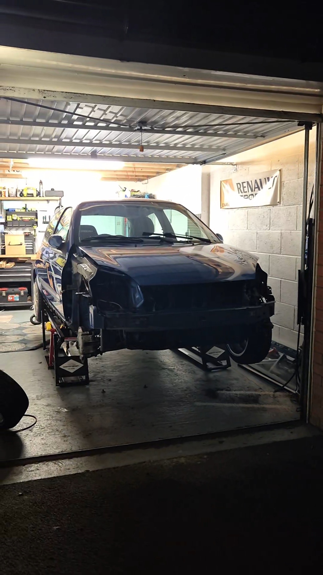

Made an amazing mistake yesterday.

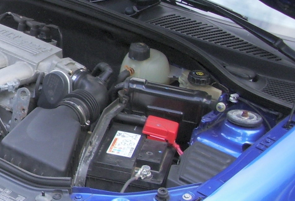

In an effort to bring this up to scratch I thought I'd replace some of the cooling system, namely the radiator, thermostat and thermostat gasket.
All was going really well.
The coolant that came out was OK. But the radiator was a bit crusty around the edges.
Feeling quite proud of myself here. I was making good progress and in a good time too (I'm an office worker 😅).
I'd fitted the thermostat and gasket. Not many photos as I needed two hands.
Old radiator
New radiator
At this point I was flying.
Until (and if you can tell what the issue is already, 10 CS.net points to you)...
Yeah, wrong radiator. Balls.
I bought this new one a few months ago, doubt the seller will take it back. Anyway, ordered the correct radiator this time.

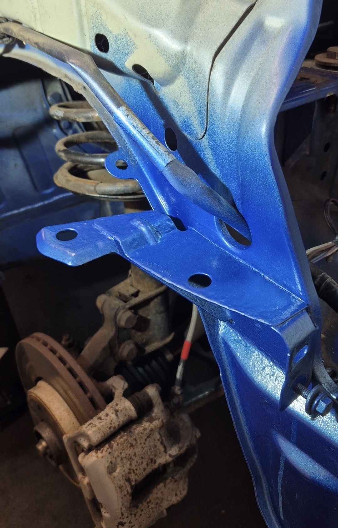

I did notice some crusty bits under the front T slam panel thing.
As well as the radiator mounts.
These are all now wrapped up in Deox Gel.
Will sort those scabby bits out and sat here waiting for the correct radiator to turn up.
