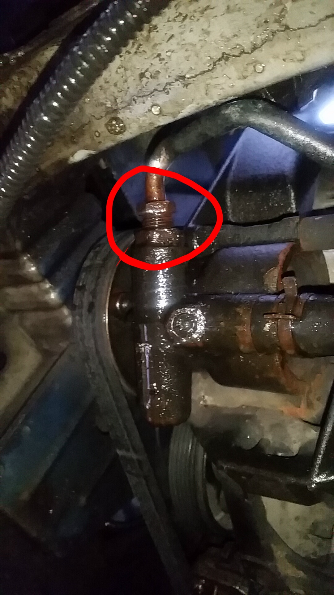

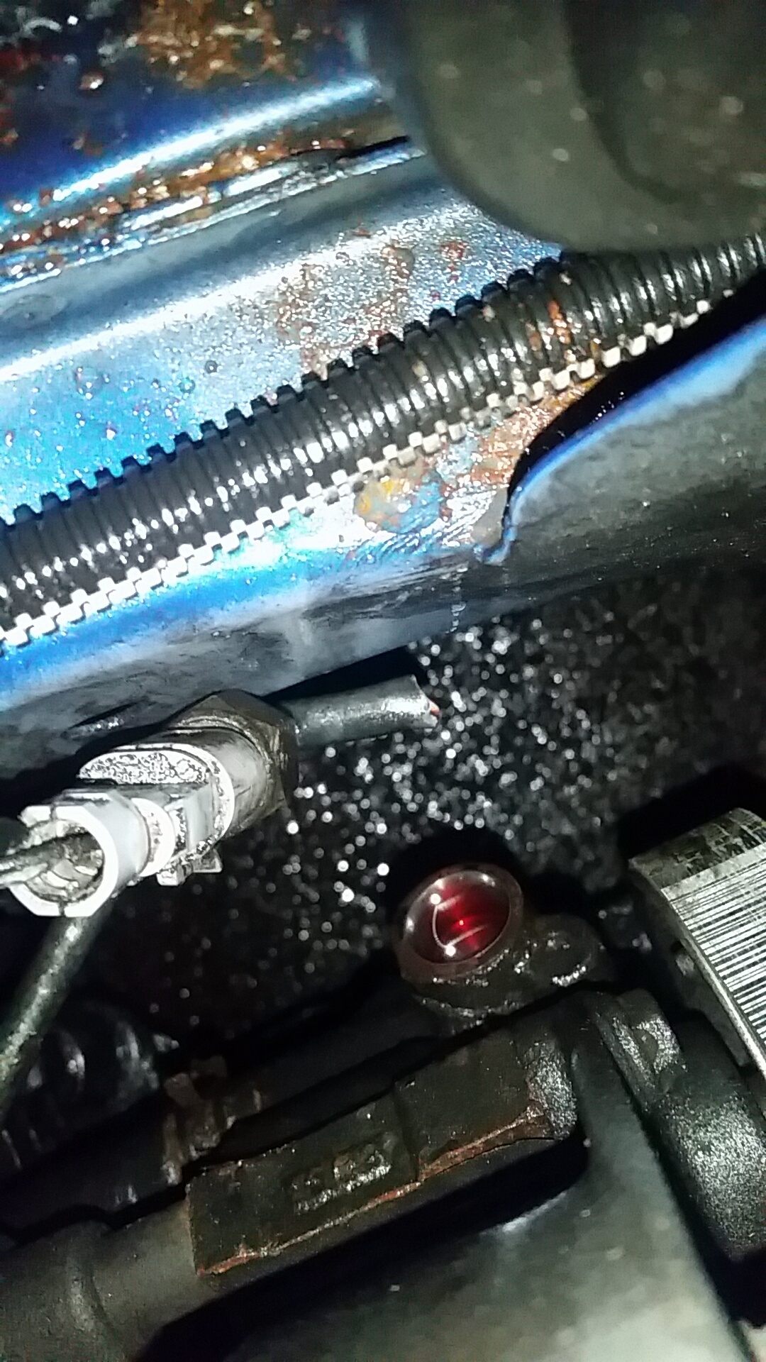

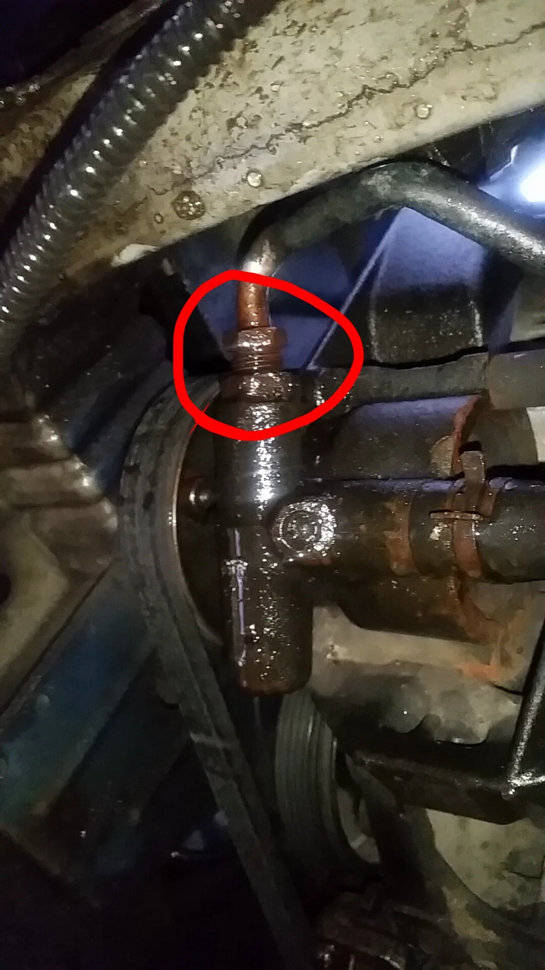

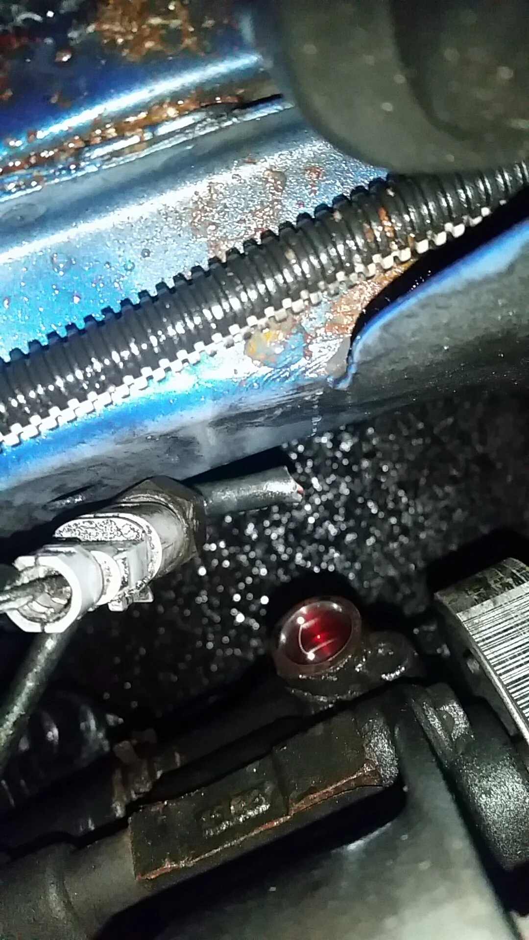

I'm struggling to get a mental image of which part your on about mate. Can you upload a pic?
There's a few brackets here and there that hold it in place and it also passes under the gearbox mount from memory. It's just generally an awkward t**t to get out.
Have to use my phone to upload these.
That's where it was lose and I couldn't tighten it, it was proper solid. tried today and when I went to tighten it, it gave way and because of the force it bent the pipe and the pipe broke so I'm left with broken end of the pipe.
Well you might be lucky enough to get a compression fitting on the remaining steel pipe, but not 100% on that. Might be worth calling pirtek to see if someone will come out and repair it on the drive rather than have to rave it all out.
The pipes can be a c*nt Liam, I ended up cutting mine at the rack end to get a socket over it!

Liam I might have a new (to you) pipe down at coney hatch you could have for a small fee during the week, I could check tomorrow.
Worst case you just need a flexi hose with two compression fittings on it, cut your existing pipe at the best spot nearest the pump (with it in situ) and cut the end off of my pipe and just tighten the compression fittings up.
Voila problem solved at a fraction of the cost and no hassle at all.
