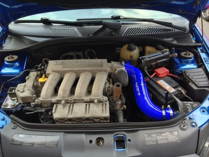

I've known of this car for the last year as fellow member yorkshiredaz owned it. The previous owner before him spent a fair bit of money on it and it had a decent spec;
Cat cams
btb stealth
decat
182 manifold
Poly bush dog bone mount
itg filter
Daz added vibratechnics engine mount and spax rsx coilovers so the car so was already a good spec.

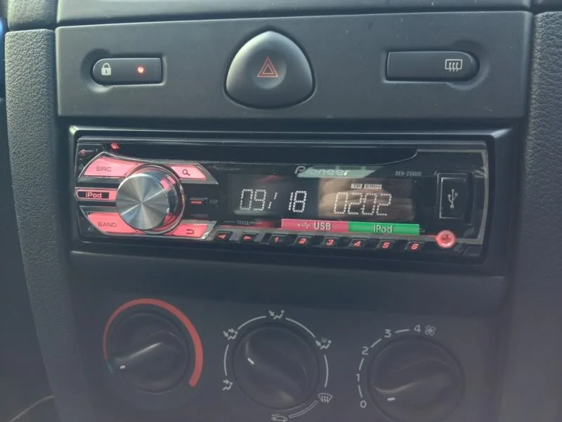

My first problem occurred 5 mins after collecting the car - the stereo didn't work! So the first thing I bought was a pioneer stereo for the tunes;

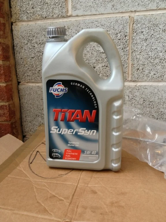

The car was due an oil change so decided to try doing this myself. I'm not what you'd call handy with the spanners but decided to have a go myself and using the guide on here managed to sort it relatively easily!

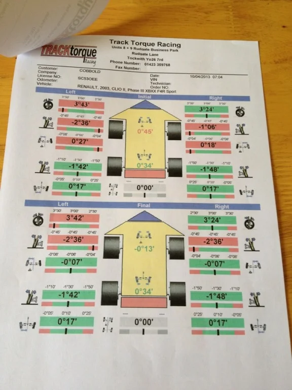

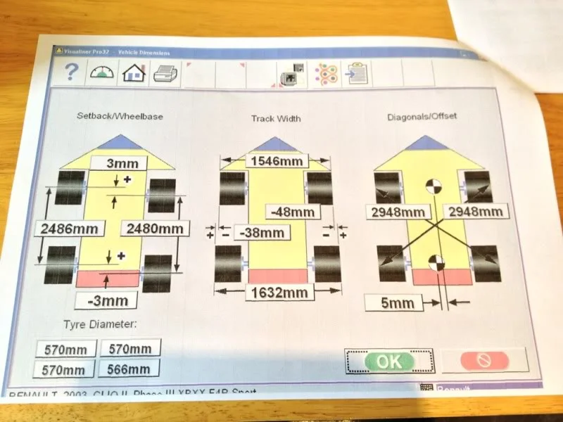

When I bought the car the wheel was at a 45* angle when going straight and was clear the tracking was all over the shop so booked into track torque for a full geo set up;
When I was there they confirmed a wheel bearing was shot and front anti roll bushes warn so these are now on the to do list.

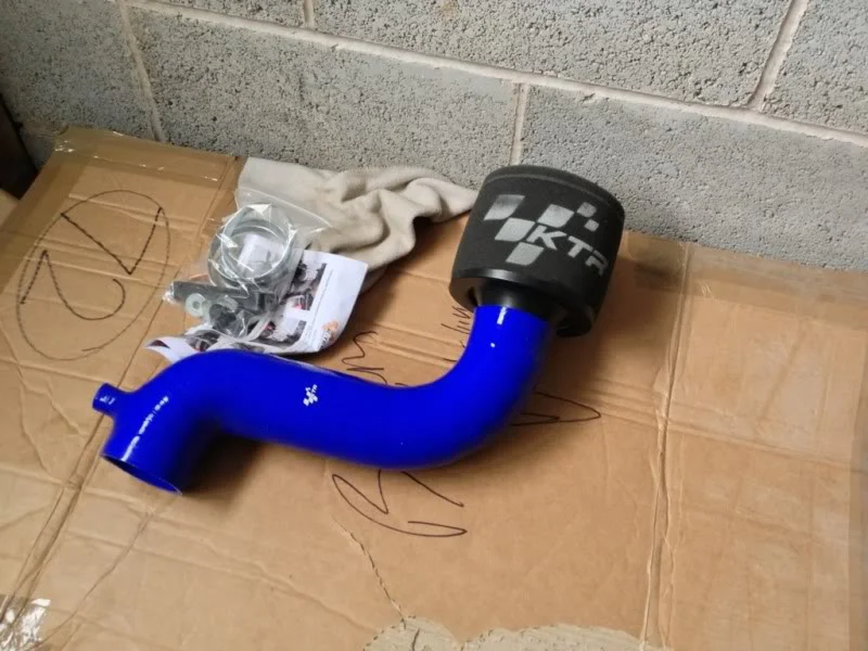

I also purchased a ktec kit from someone on here;
Fitted;

Crikey that's an epically straight rear beam - identical camber and toe both sides virtually!
Looks like one of your top mounts might be slightly shot as the castor is a bit out on the left

Im glad you understand the diagrams because I certainly don't!
They told me my arb bushes are warm and will need replacing so don't know if that would affect the readings....
Nah wouldn't affect the caster - that will most likely be top mounts
It's not out enough to affect it but it's outside the manufacturers tolerances according to that printout :)

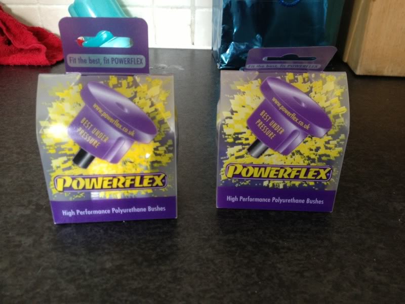

Few new bits have arrived over the last few days;
Powerflex arb bushes as the standard jobs were worn;

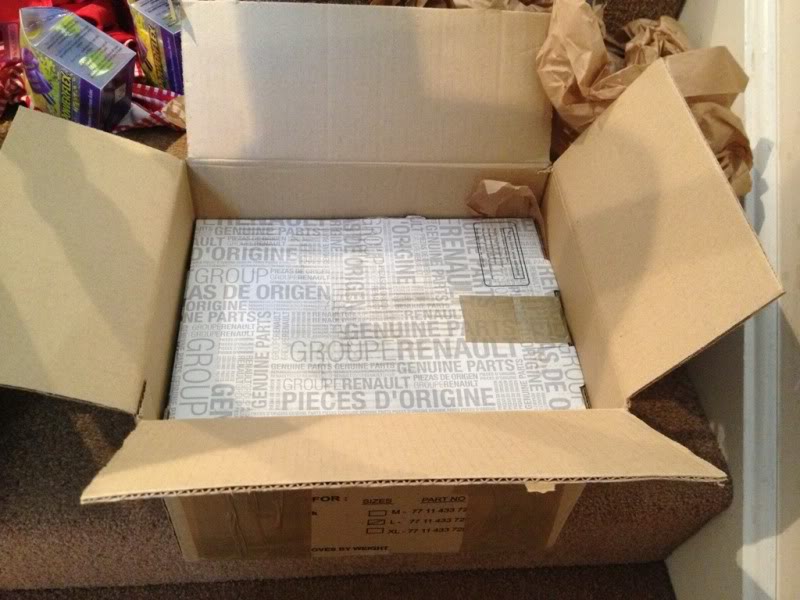

And new discs and pads from btm as my rear wheel bearing is screwed so thought I might as well do both sides;
