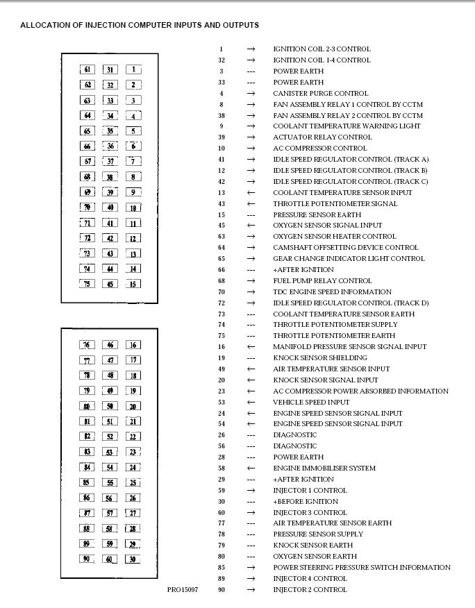

No feed to pin 30?
Yeah plugged it in to Renault Clip which said a fixed immobiliser fault and there's no feed to the ecu. Tried several decoder rings to no avail also.
Got another interior loom from a 172 cup and still came up with the same results. :(
Havent tried a looking for a feed at pin 30, what does that do?

There are two pins which recieve voltage, one before (pin 30) and one after (pin 66) ignition. If the ECU is recieving the correct voltage, and clip is showing all computers except the ECU, i'd be going down the route of a second hand engine loom.
