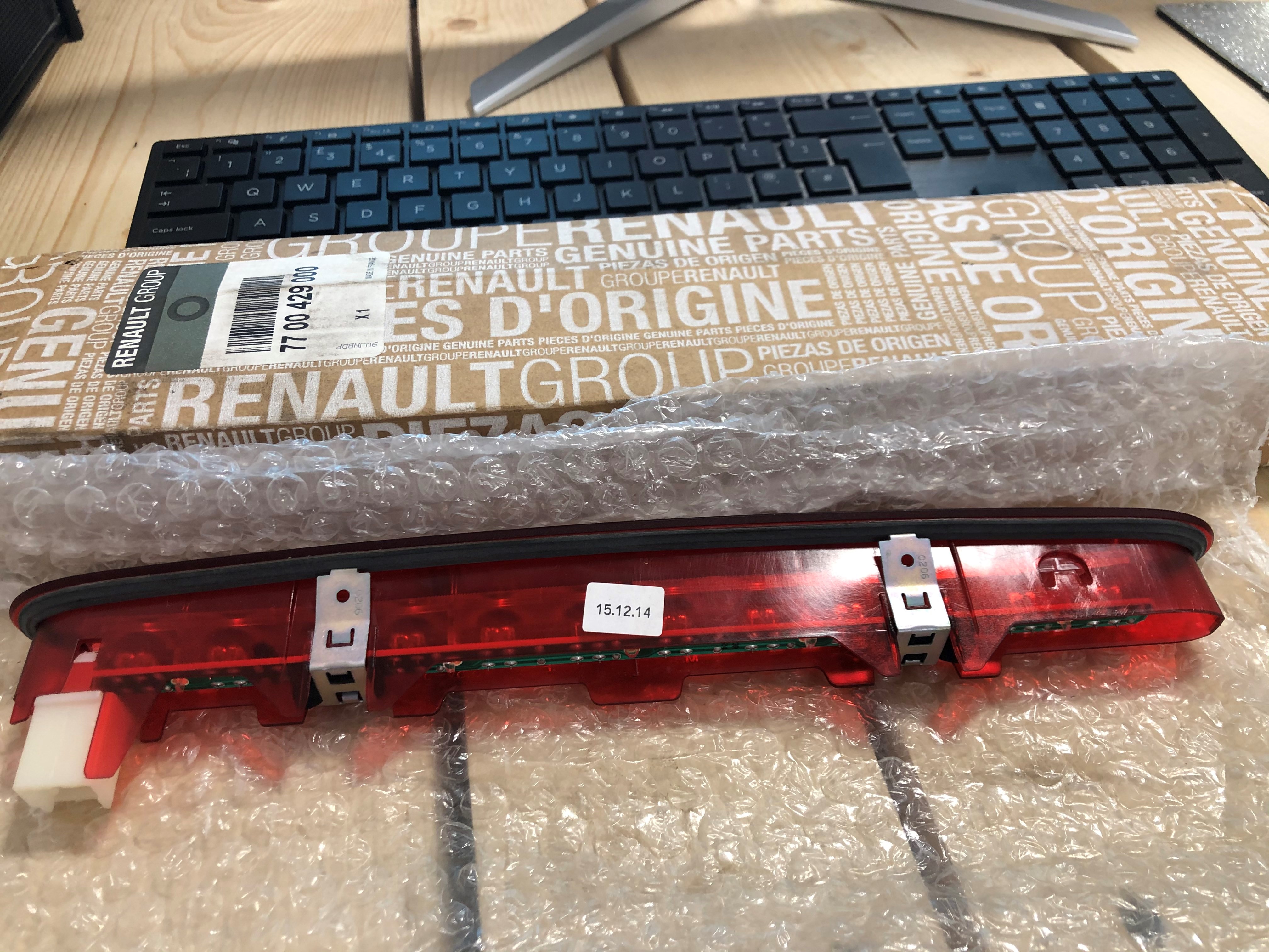

I remember replacing mine in my 182 years ago because the leds failed, lobbed the old one in the bin😭
Bit of an update, managed to a get a refurbed unit shipped from the Netherlands that came off a mk1 megane coupe, only 35 quid in the end so worth the punt, and the plastic is in good nick thank god!
