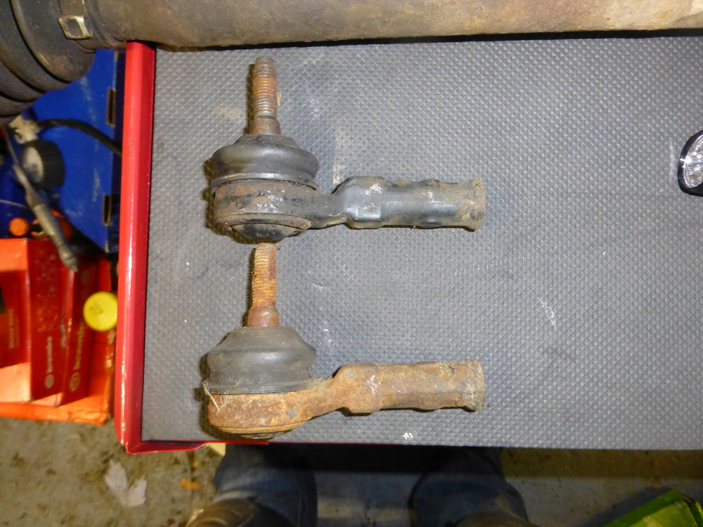

Track rod ends longer on cup

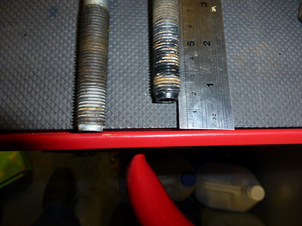

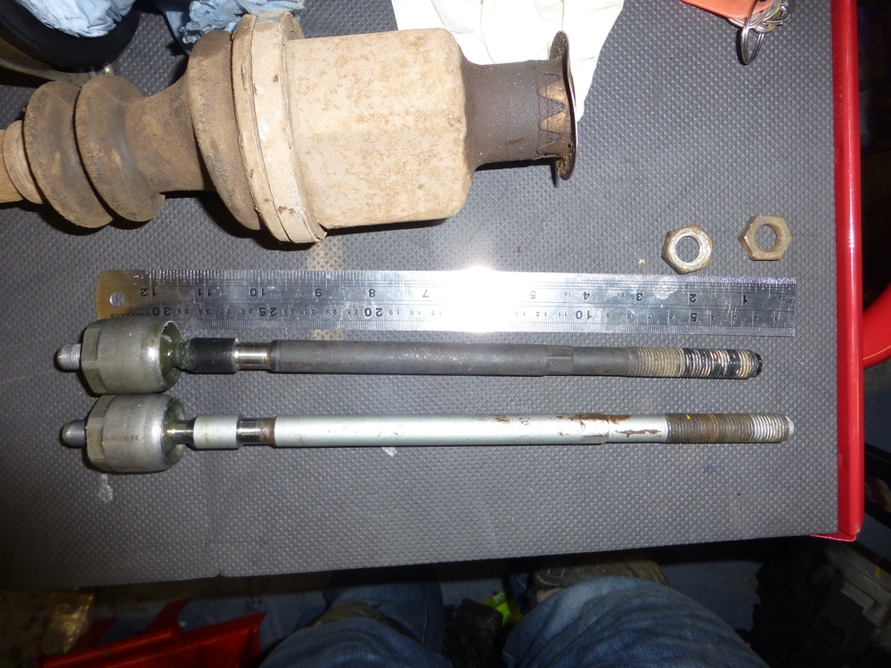

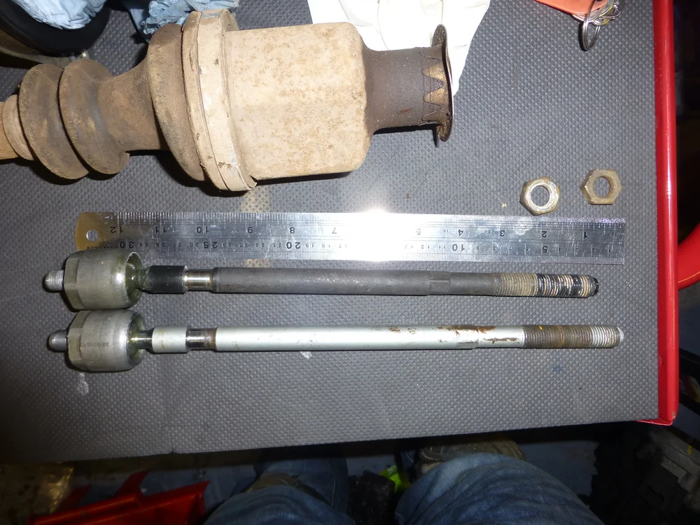

The 172 cup tie rods are about 20mm longer, the track rod ends are the same. They are about 40mm into the track rod end though so even the shorter tie rods would still be about 20mm inside the TRE.

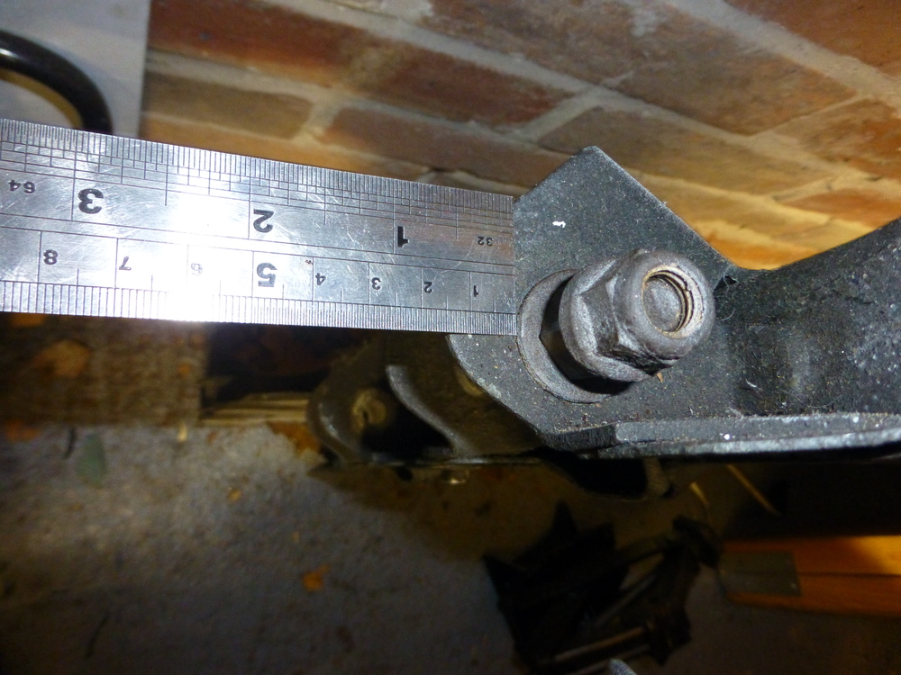

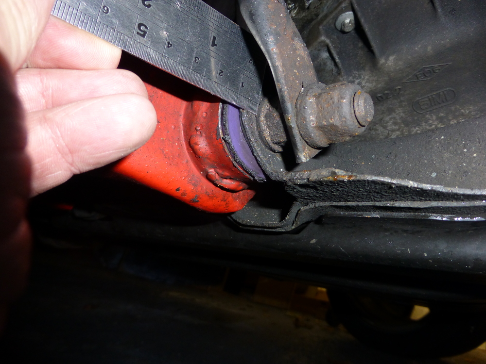

I would have thought the 182 cup/cup pack would have the same longer tie rods and also the bottom arms with more caster like the 172 cup. You should be able to tell with a quick look at the 182 cup arms, post a pic up if you can't tell.
Do you think the measurement shown above is smaller than 21mm on your car mark?
Yes I think so. I'll try and remember to measure it this evening.
That would explain the longer drive shaft's, longer track rod ends fitted to cups. Extra caster from the offset holes on wishbones and extended track and camber from the subframe. Seems like an easy solution on Renaults part.
And I've just been out to look at my 182 with cup packs and the wishbone looks the same as the 172 cup i.e. it has the extra caster from the different ball joint position.
