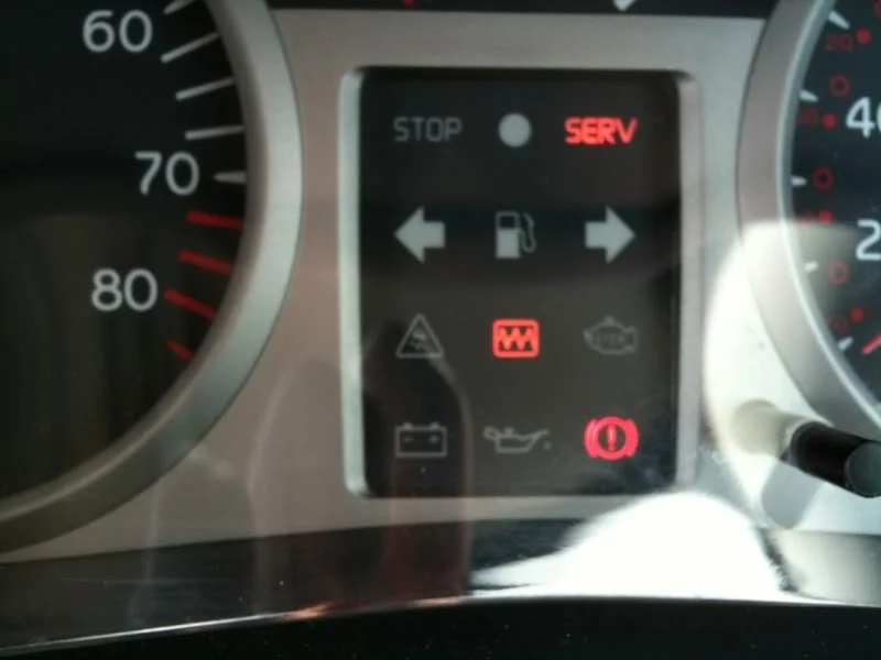

Does anyone have any ideas why my Ph2 172 is going into limp home mode, won't go above 3k rpm and looses power ?
There is a light that comes on and it has a line going through it like a heart rate monitor.

When i turn off my ignition and turn it back on it seems to clear itself which i think is weird.
But even after i turn of my ignition and turn it back on it happened again, so off the ignition went and back on again and it hasn't lit up again since.
