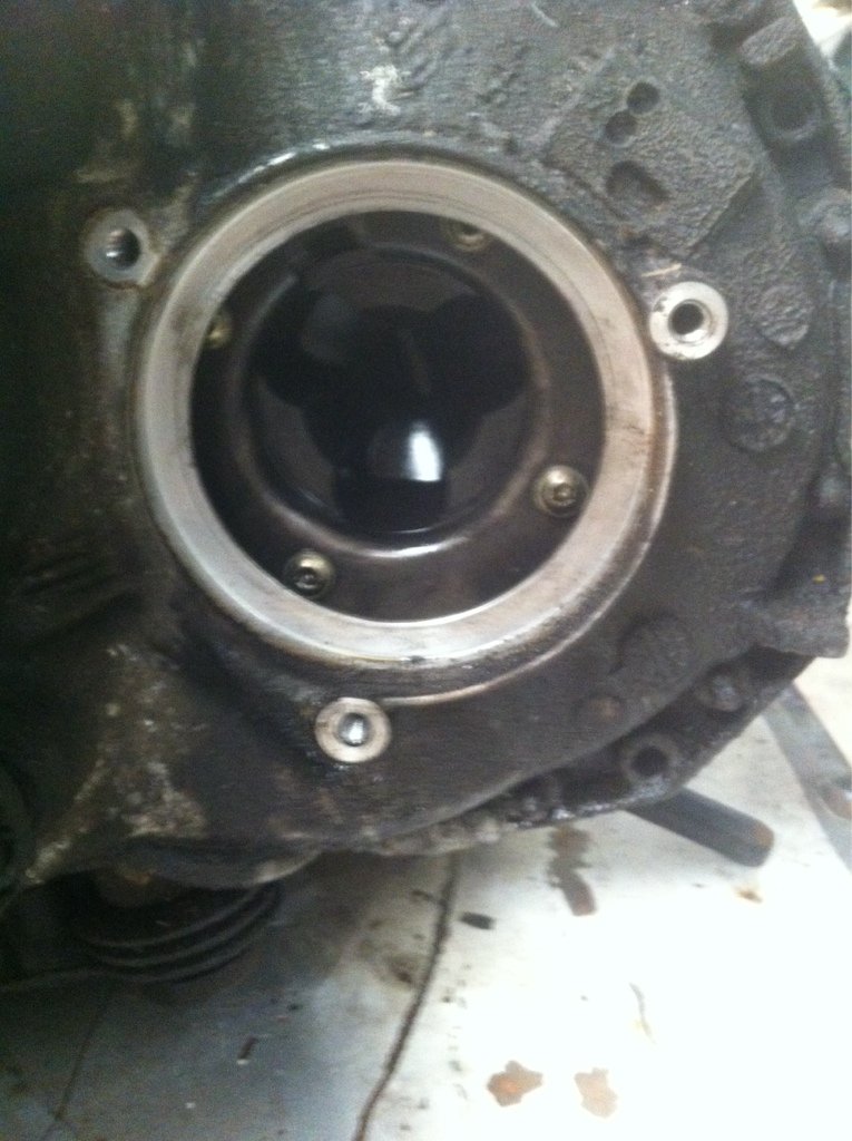

I've lost drive in a 172 cup. After removing the shaft I found this

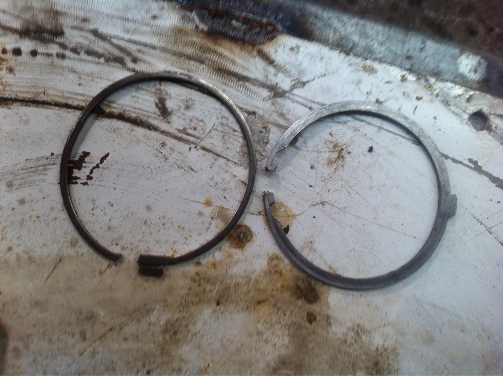

It looks as if the circlip has snapped? I've looked at my other 172 & couldn't see a circlip just this
Am I right in thinking that, this 4 bolt part replaces the circlip? As you can buy a aftermarket 8 bolt one. It's just confused me abit.

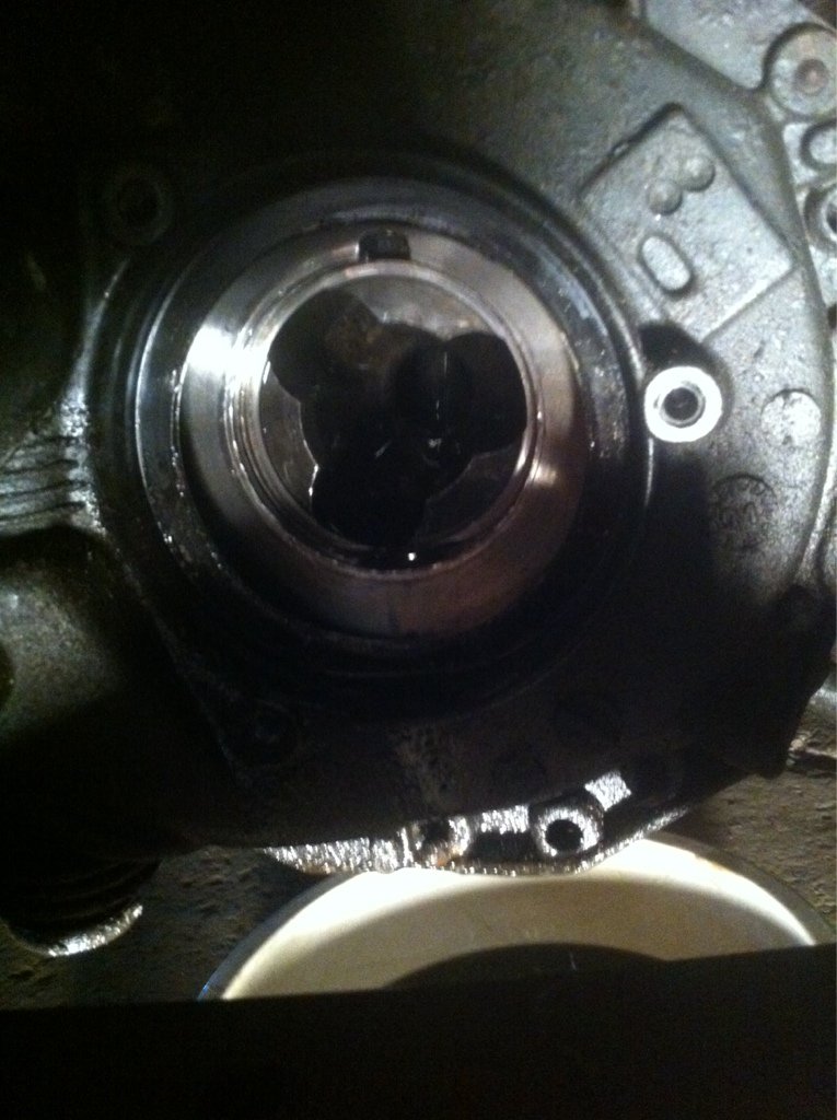

For comparison here's my cup:
Am I right in thinking I just get the 2 new parts, slot the 1st one in, rotate it slightly. Then fit the retaining washer with circlip pliers & rotate that slightly. Job done?

The 8 bolt item you can buy off eBay replaces the circlip mate. You will need to drill and tap your diff to fit the plate though. In a perfect world you'd split the box so you don't have any stray bits of metal entering the box, so just be aware. If you cover a rag in grease and stuff it around the circumference of the diff you will more than likely get away with it tbh. It's how I'd do it and I know how to strip these boxes down! Lol
