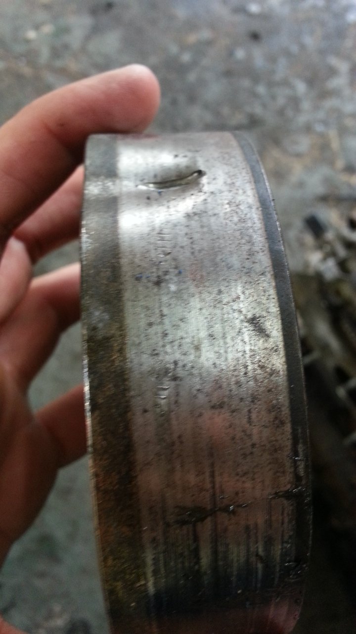

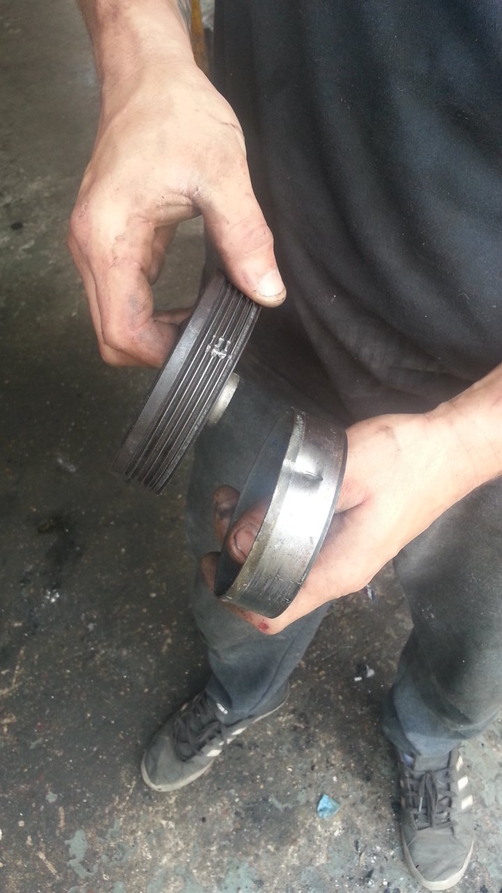

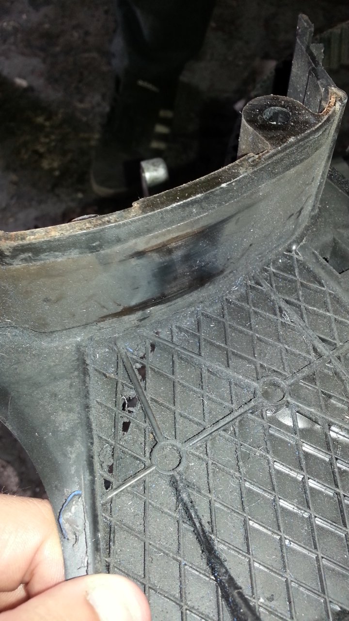

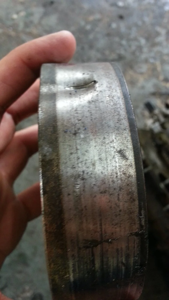

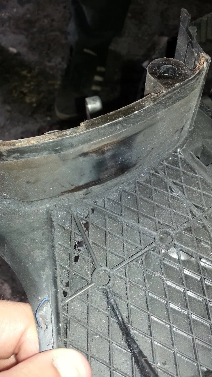

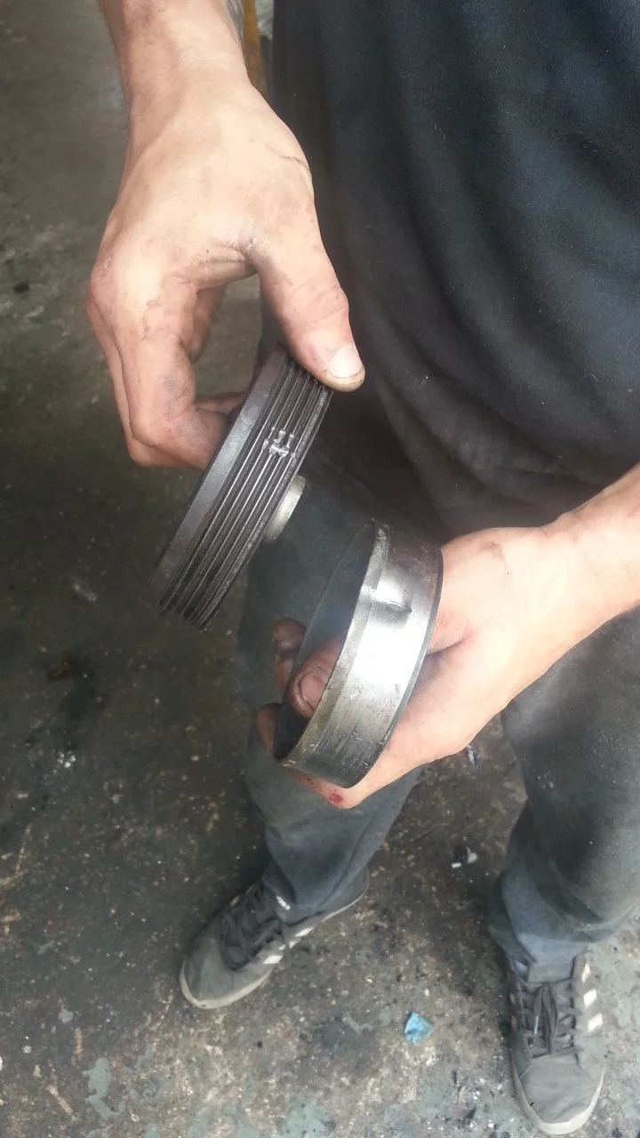

OK time to update this thread with the cause of the belt fail. My suspicions were correct and it was not the tensioner to cause the fail.
After taking the engine out it's plainly obvious to see a bolt that has been left on the top of the engine has fallen between the crank pulley and water pump. This instantly seized the engine, causing the belt to skip teeth, taking a chunk out of the crank pulley and a big dent in the water pump pulley with thread markings. This in turn threw the aux belt off, and even though it has pushed off, it hasn't worn all the way through the cambelt casing, partially yes, but not all the way.
There were no missing bolts from the engine.
This is why the engine failed. So obviously the guy who changed the box, left a bolt on the top, which fell off 2 miles down the road.
I've had to source myself another engine and put ANOTHER set of belts on, this time with a new tensioner. :smile:
Would everyone now be in agreement that the responsible party is in fact the garage who changed my box after seeing these pictures?
Would also like to add the state that the gearbox change was done. The positive lead on the starter was over tightened, which cracked all the plastic. This was bodged together with a self tapping screw, which crumbled to pieces when it was removed. Also 2 of the gearbox bolts were stripped, packed out with washers and held in by a couple of cross threaded threads. These are the obvious things that have stuck out so far
can you prove it was a bolt left on the engine? who's to say it wasn't flicked up from the road?

It looks to be quite a small bolt?
If you look at the water pump pulley you can vaguely see the thread marks coming away from the head of the bolt, guessing it was just a standard 10 or 13mm bolt?

Only reason i question it, there's no m8/m6 bolts on the gearbox that you remove to do it.
Depends if you've taken the bumper/headlights off. Or inlet.
Both entirely possible if you've not done one before and want better access/views.
