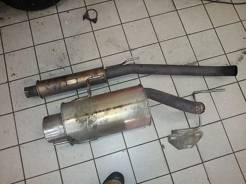

Hi, just purchased a exhaust for my 172, i take it this is just the cat and the back box yes. Is it worth fitting the cat or just leaving the one on I have?? And also do I need any more brackets/fastenings before I take it to the garage to get fitted??

No mate thats a center section and back box, looks like a Magnex.
You look like your missing the bit which connects the center section to the cat. Its a pipe about 6'' or so which slots into the center section for adjusting the length and has a flange at the other end for bolting to the cat.
Thanks for the reply bud, yea Ive got it, its just not in the picture, its fitted to the end of the center section, which i presume attatches to the cat. Is there anything else i need?
