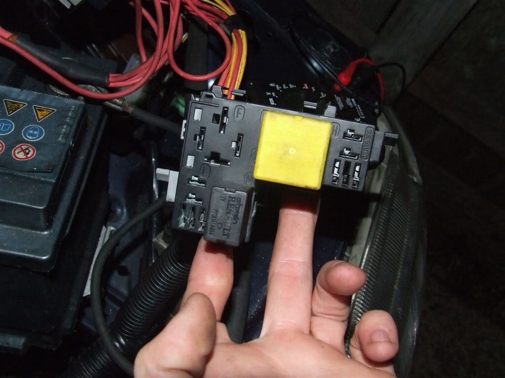

The fuel pump relay (not fitted) is positioned at bottom left of this picture on Ph1 if you have not relocated it.
