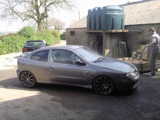

Coilovers fitted and Keis back on. More engine updates to follow.

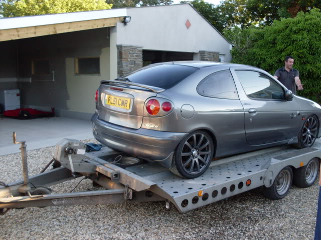

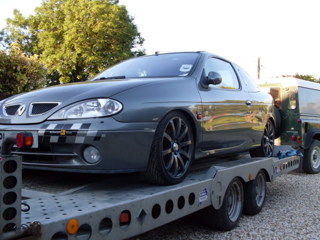

So a very long time since i updated this thread. After failing to sell the car ive persisted with it and the decision was made to send the car to AP-Developments in Swansea where she has been for the last 4 months lol.
Trailored up to APD
Once the car arrived at APD it needed:

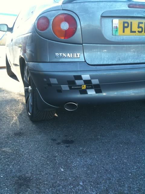

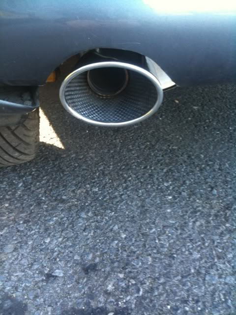

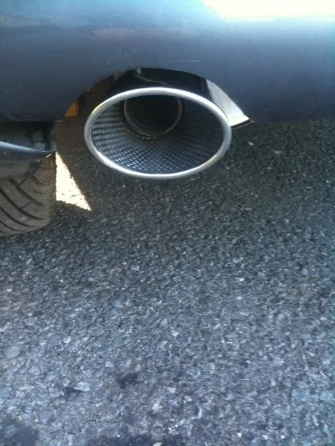

Then the car went to highly recomended by you lads Prospeed and had a custom manifold back system made to imcorporate the 172 CAT and a full two silenced system from there back with a lovely oval tip.
Pictures
Ive not heard the system yet but im confident with Charlie and his crews work and just cant wait to hear it.

Needs some clean number plates and decals removing and thats a lovely car!
Well done for sticking with it. Nobody likes a quitter. ;)

To be fair shes been sat 1hr away from home for the last year. Just you wait till shes home and she will get the full works lol.
