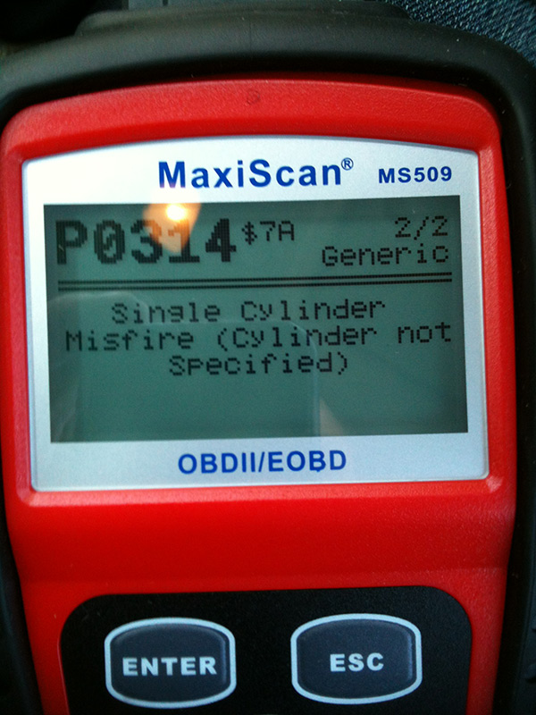

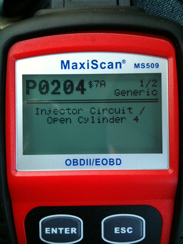

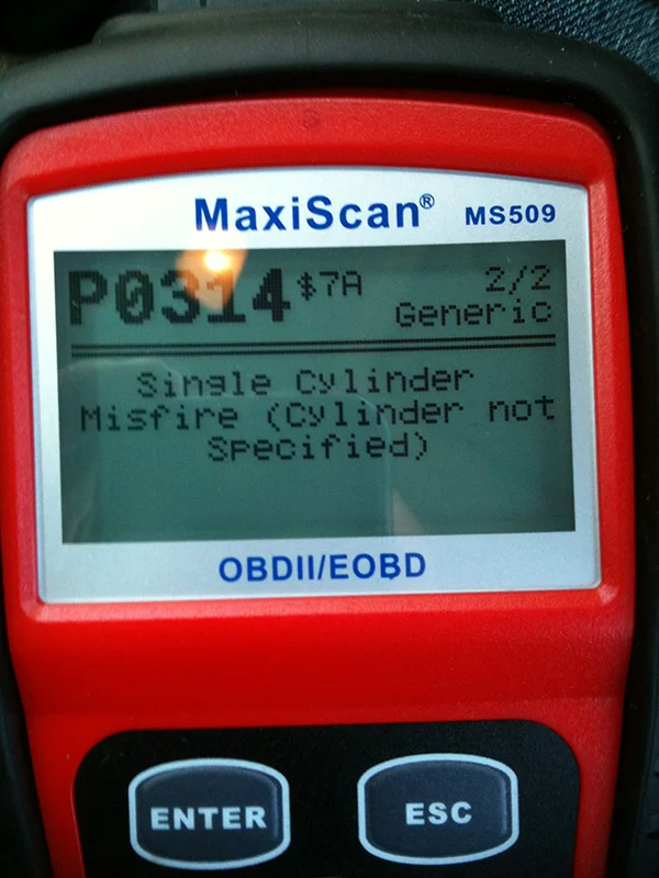

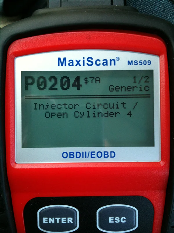

Right, managed to get my code scanner today, did a scan and as I suspected there is an injector problem, got a P0204 and a P0314 error code back, it saying Injector Cylinder 4 is the problem?
easy test for this, take plugs out and clean them, refit and let car idle for a bit on the lumpy lumpy. whip plugs out and check for one that's different in colour, usually clarted up with soot, clean plugs and refit and then swap the injector from the sooty cylinder to a clean one and run the car on idle for a bit again. check the plugs to see if the sooty one has followed the injector. if it has that's your culprit!
