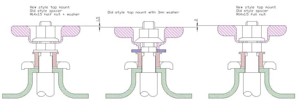

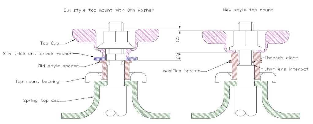

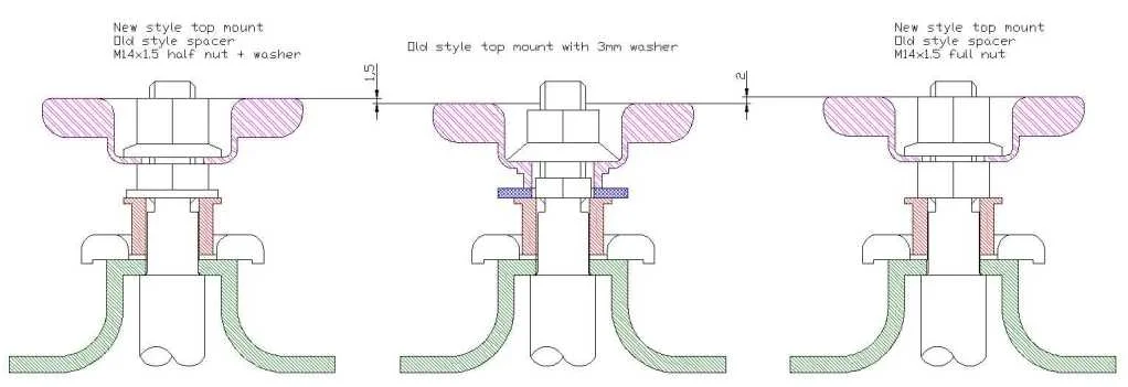

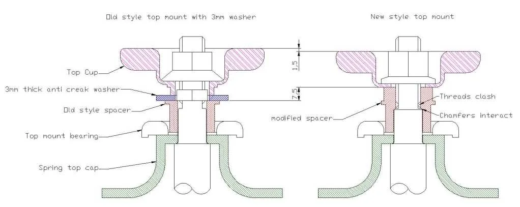

Right, had some time to look into this today and decided to draw it all up, so I could see what was going on behind the scenes. I found that in 2 areas, the design of the modified spacer could lead to issues, as it interacts with something other than the top mount bearing, which it should be holding in place! This ties in exactly with what I found. Here's a cross section of what I have done, with the problem areas marked. I have also drawn the old stlye top mount with the 3mm creak fixing washer in place, to see how the new spacers compare to the new design. What I have found is that the new design sits in between the old design and the old design plus a 3mm washer. This should reduce creaking issues in some cases but not when running more extreme camber or castor.
My fix will be to use the old style spacer with an M14x1.5 full nut, measuring some 11mm in height, and then the new style top cup and lock nut. This will sit the top cup 1-2mm higher than on the old setup with the washer, which still creaked on my car, and should make things work properly. It also means that I only need one 22mm spanner to take off the top mounts in the future but that's just luck.
Just to finish this off -
I've just purchased 2 off M14x1.5 half nuts (7mm thickness) and 2 off M14 washers (2.5mm thickness) from a local fastners place for a massive £1.10 the lot. The washer and half nut are an equivalent thickness to the old style top mount top cup and 3mm anti-creak washer leaving just about 1 full thread above the lock nut, so the top cup sits in roughly the same place with the top of the new nut sitting a little higher, due to a difference in design, as shown in the diagrams above. A full nut (~11mm thickness) is as large as you could go without running out of threads.
Fitting was really simple, as I only needed a 22mm swan neck ring spanner or diesel injector socket for the both the half nut and Renault locking nut (as opposed to a 17mm & 22mm for the old setup or a 22mm & 27mm for the new style) and there was easy access to the 6mm hex to make sure things were properly tightened.
A brief test drive shows that all is well with no clunks or grinding and all with £10 back in my pocket for the returned spacers, minus costs.

Also kudos on the drawing skills!
Nice diagrams, will keep this in mind.

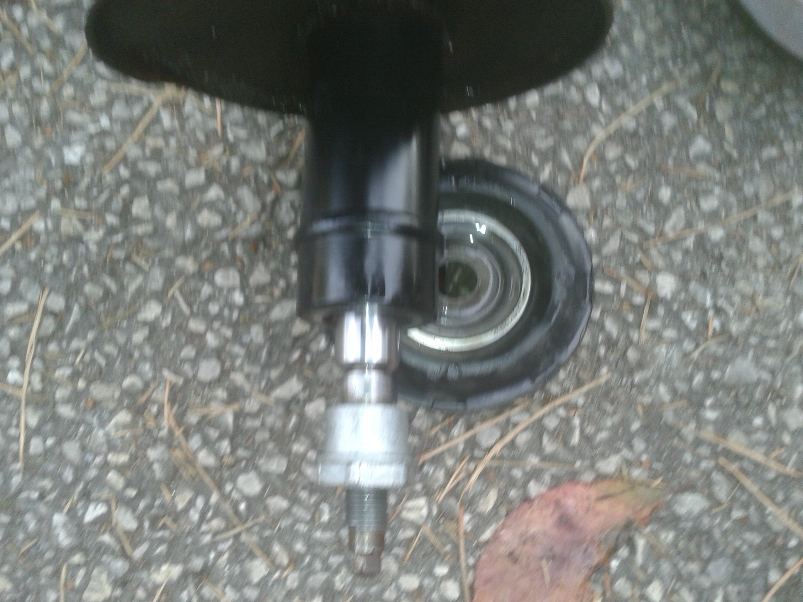

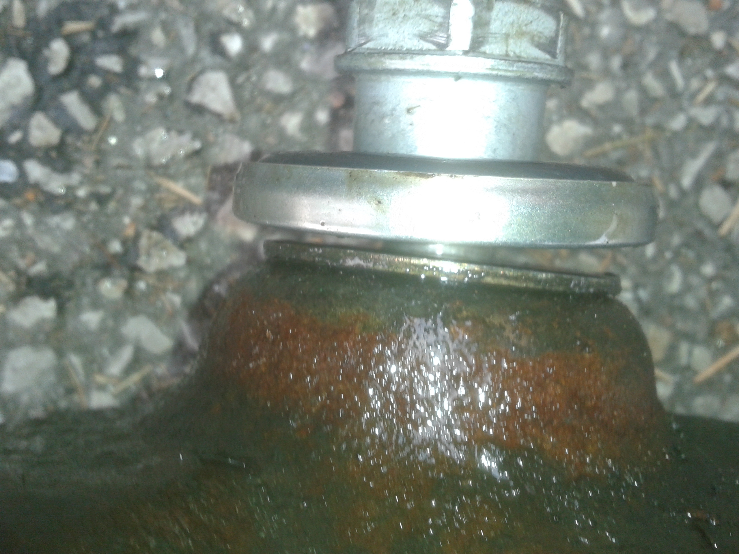

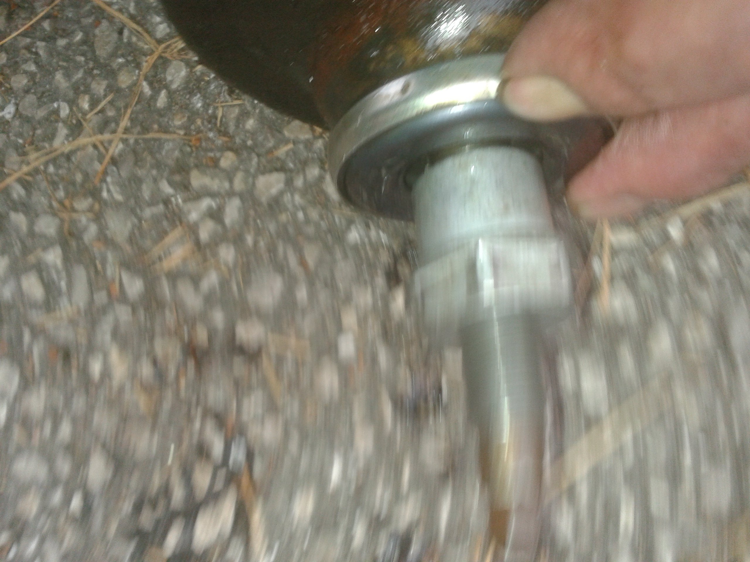

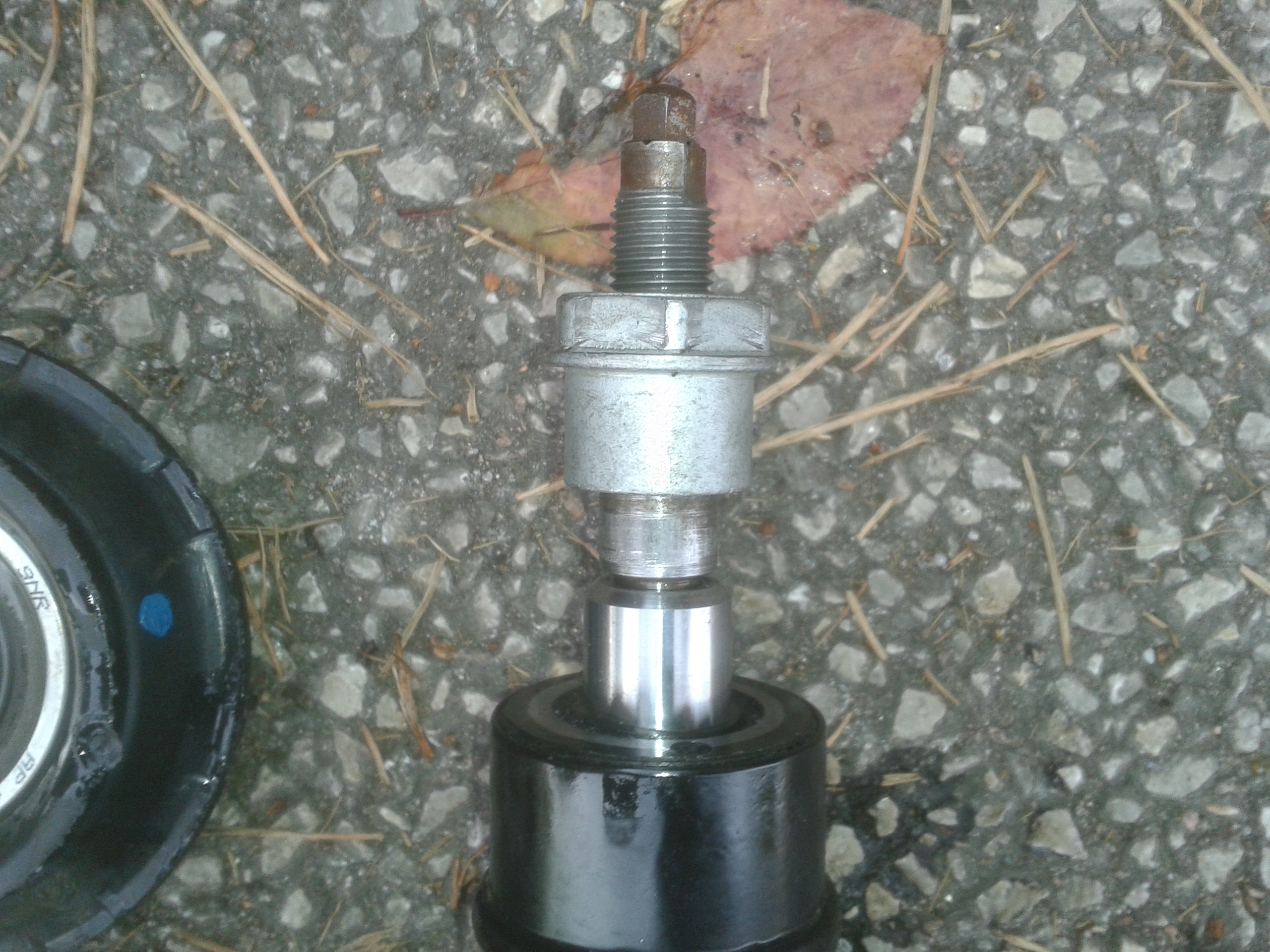

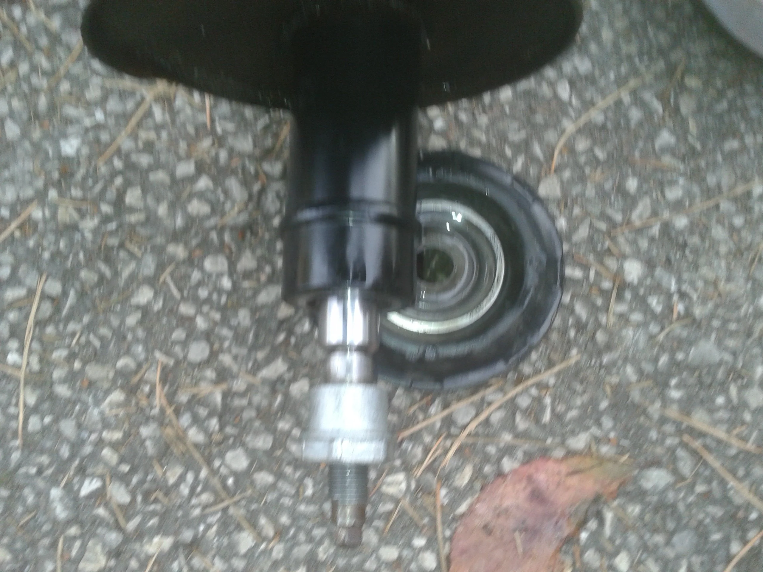

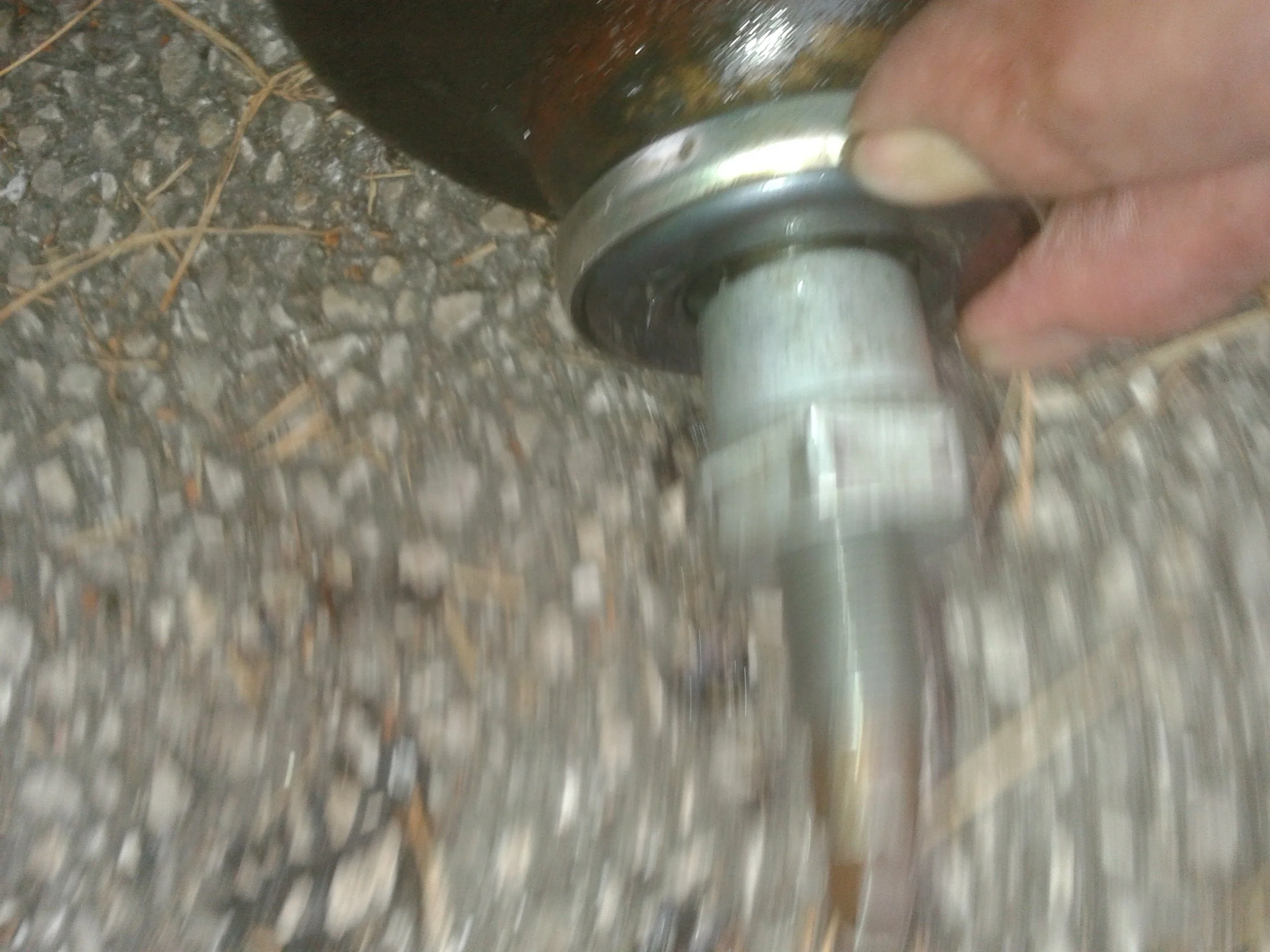

I had this problem,and as you can see in the photo`s,the thread of the modified nut bottoms out on the damper rod before making contact with the bearing.Which top mount kit you have is totally irrelavent to this problem,before someone says it only works with the modified kit.
This was with some Spax shocks,and was exactly the same with the Gaz GHA`s I HAD to replace them with.
Numerous CS members have had this problem,but these are still being supplied without acknowledgement of the potential problem.
If anyone knows if this a design fault,or incorrect manufacture,please post.
If you have successfully utilised these nuts,part no R82 00 867 250 without modification,please post the make of shock you were using.
