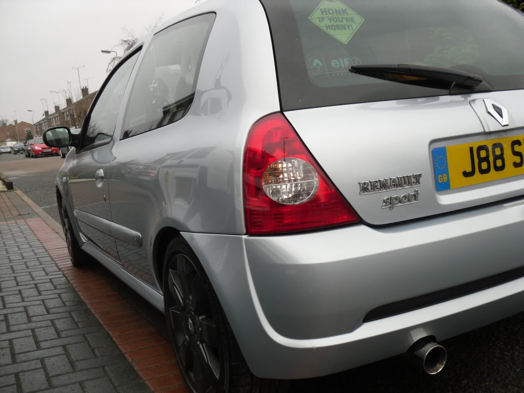

Got this one mate, You may have seen it before but im going back a lot of years lol. Sounds perfect for me, never had one issue and its been on 4 years. Powerflow from MrTyre. £300 fitted catback.
