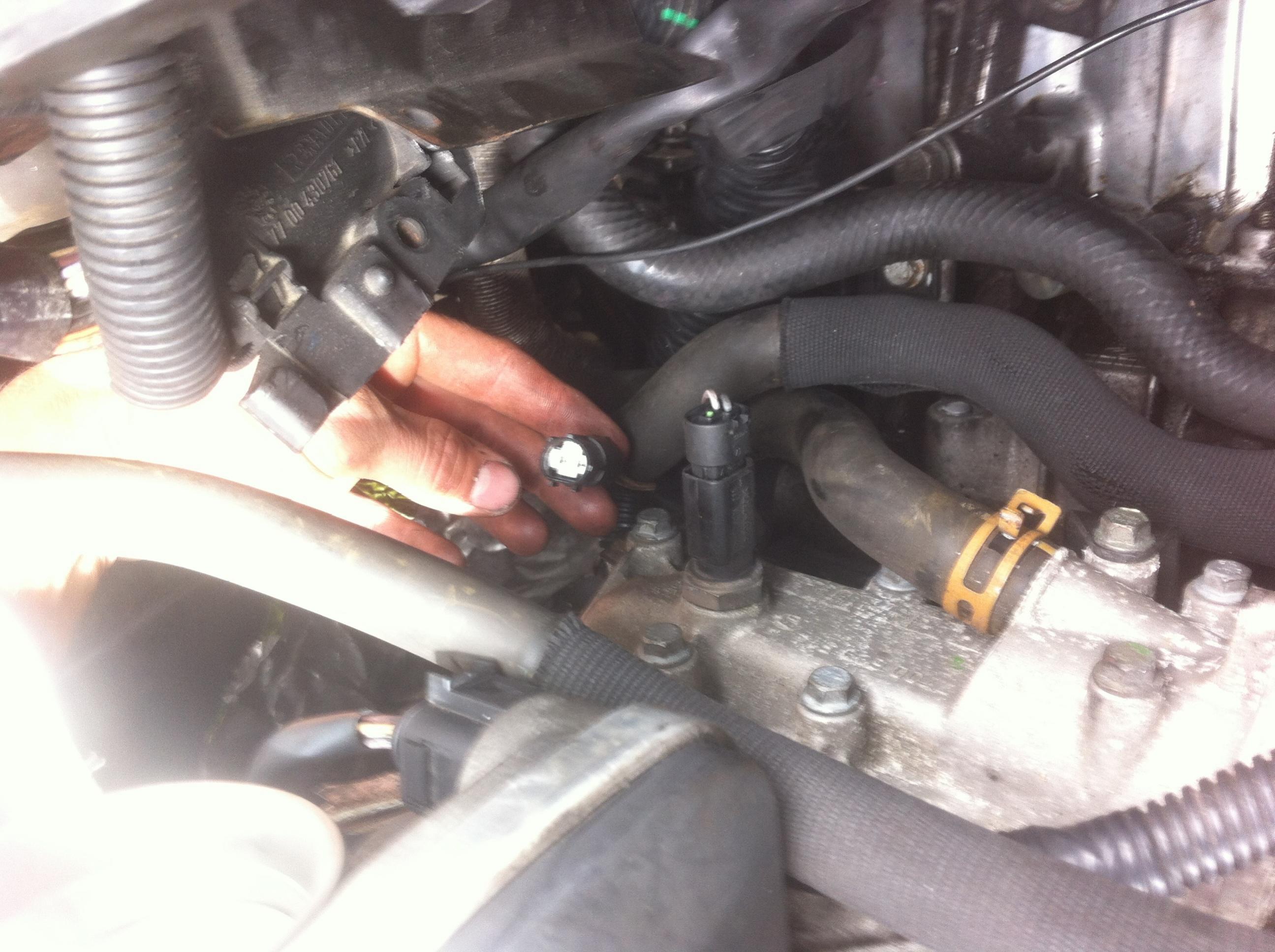

Changed the clutch over the last week. It hasn't been driven for 2/3 weeks. I've put it all back together and when I tern the key from off to on immediately the starter cranks over for about 3 seconds. But if I tern it to on, then start nothing happens. As far as I know all the sensors, leads etc are back in the right place... Anyone got any ideas?
I do have a mystery sensor though . Here's a pic hopefully

You were spot on with that one Fred, cheers!! That's solved the 3 second then shut off problem, now it cranking over but not starting up :s the other sensor so the sub frame brackets on. Ill take it off and clean it. And the one behind he headlight, this is just to the left of the passenger headlight where the air intake clips on? That seems ok, I didn't take it off. Could it not be starting now because the air filters off?
Lol there's your problem! Thats the crank sensor by the look of it (on my mobile so the pic is tiny)
Hmm, I just can't seem to find a home for it. In my gearbox I've got the sensor on top plugged in, and the sensor my the wheel plugged in, the earths on the box, battery and chassis are all plugged in. God knows where that other sensor goes.

Found a home for tat sensor and it started streight away! Really hidden away. Nearly broke my hand trying to plug it in aha
