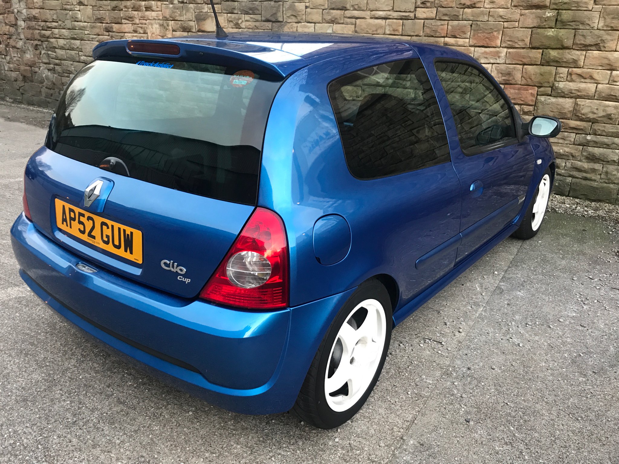

So after everyone's advice I finally got my new wheels really happy with how it came out
Sent from my iPhone using Tapatalk Pro

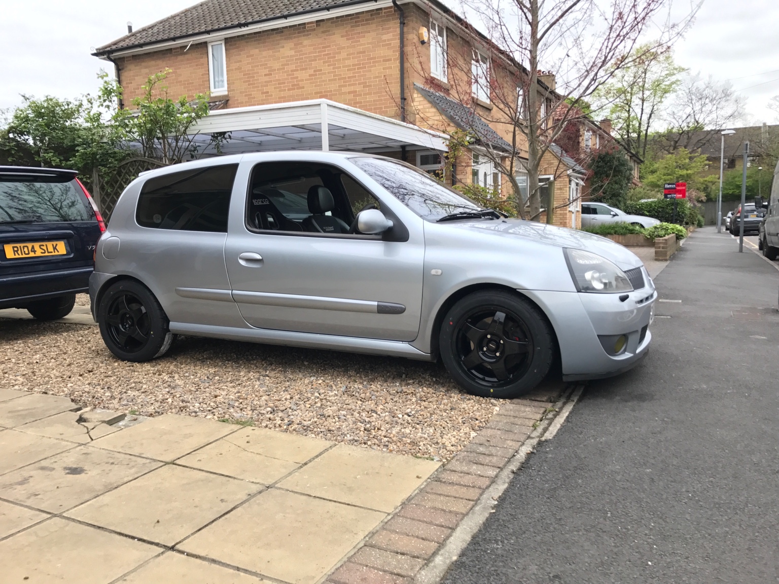

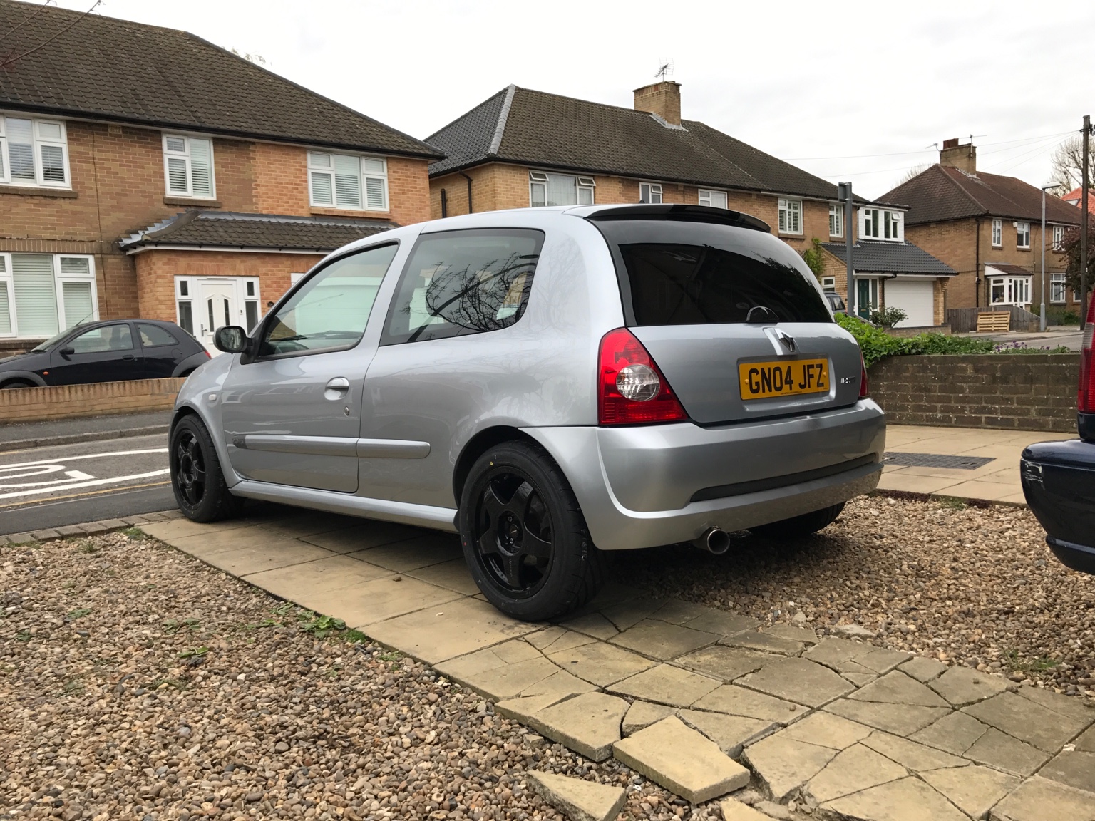

K_McDermott
  Megane 230 r26
Same as mine bud same specs with looks of your pics too [emoji108] good decision they look great
