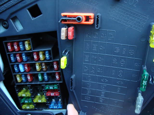

Yep, found the fuse box on the passenger side but not sure which one(s) control the windows.
It looks like a toss up between the vertical arrows in row 4 of the picture below, (not my car), or more likely, the two horizontal ones located in the row underneath. However the fact that both windows failed, at the same time, means it might be something else so I'll check out the UCH fuses as well, as I've read that the windows are operated via the UCH. (Fingers crossed it's not the UCH itself)
Will pick up some fuses over the weekend and have a fiddle!
Neither of mine work at the moment (my choice though lol) As you said it should be the two left and right arrow symbols for the fuses, hopefully that's all that is wrong
In case anyone is interested in the future, problem solved.
After a little trial and error swapping out the fuses which I thought might power the windows, it turned out to be the 10amp fuse for the UCH. (Bottom right, third one up in the fuse layout above)
