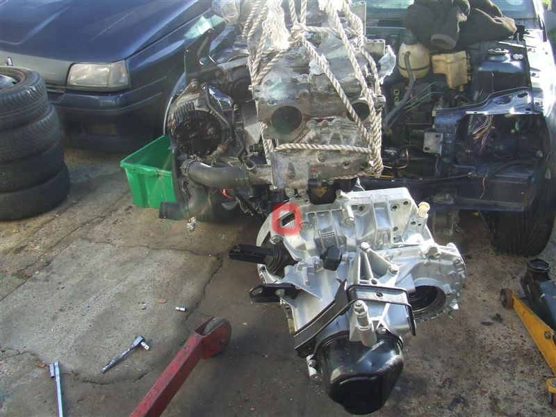

When putting the engine in, I broke the sensor that plugs into the right hand side of the plenum (looks like a vacuum sensor) - at the cambelt end

It's the map sensor I broke off - that must be causing it! didn't expect it to have this big an effect on things!!

Good old renault pricing strategy as ever then, yep well considering its how the ECU meters air full stop it has a small effect :rasp: ;).
