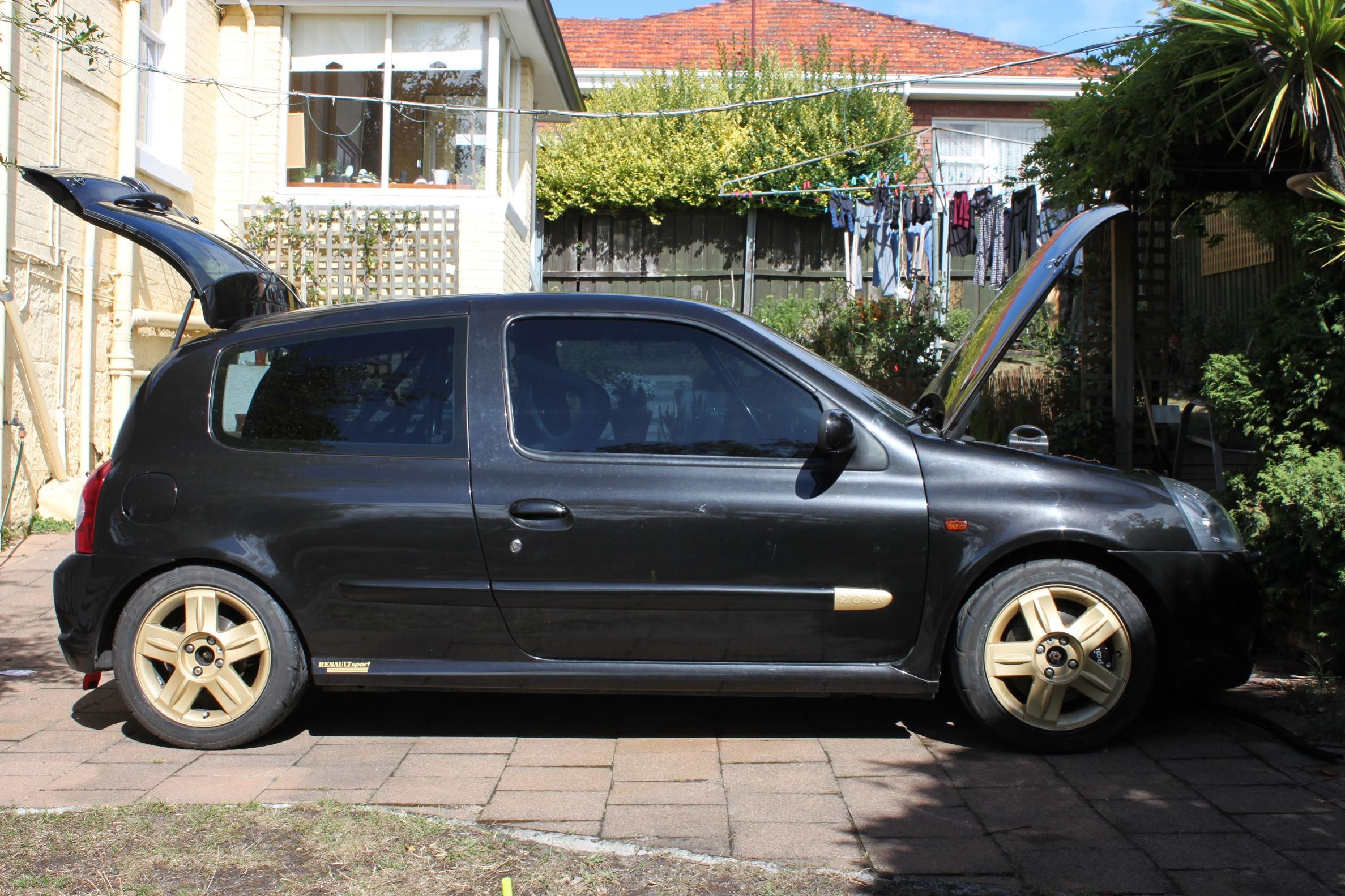

172 Track Car
  Clio RS 172

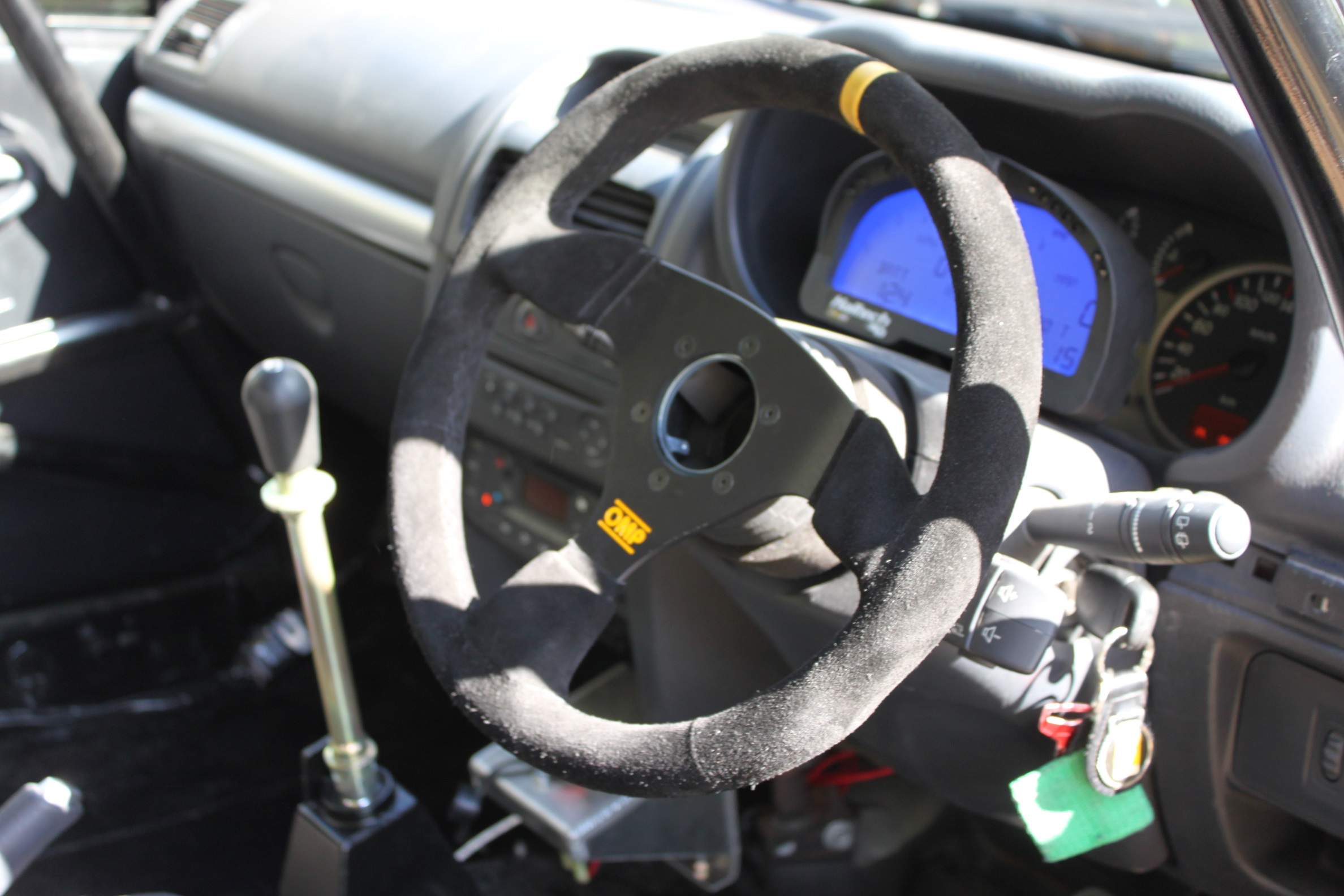

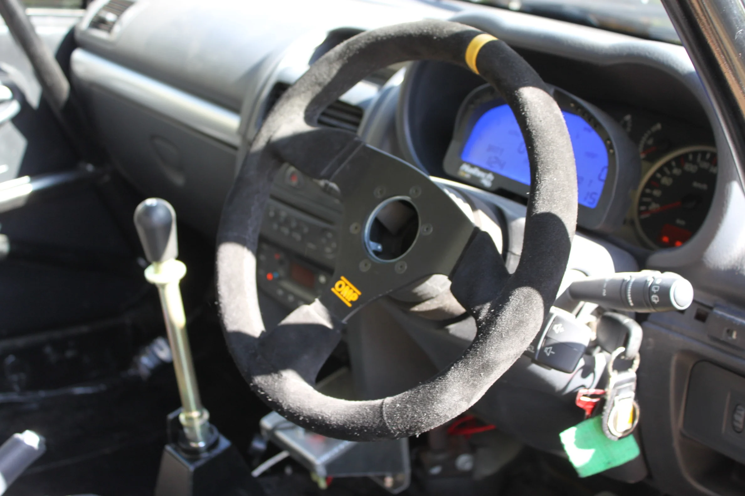

Started out as a standard 172 with 90k KMs on the clock.

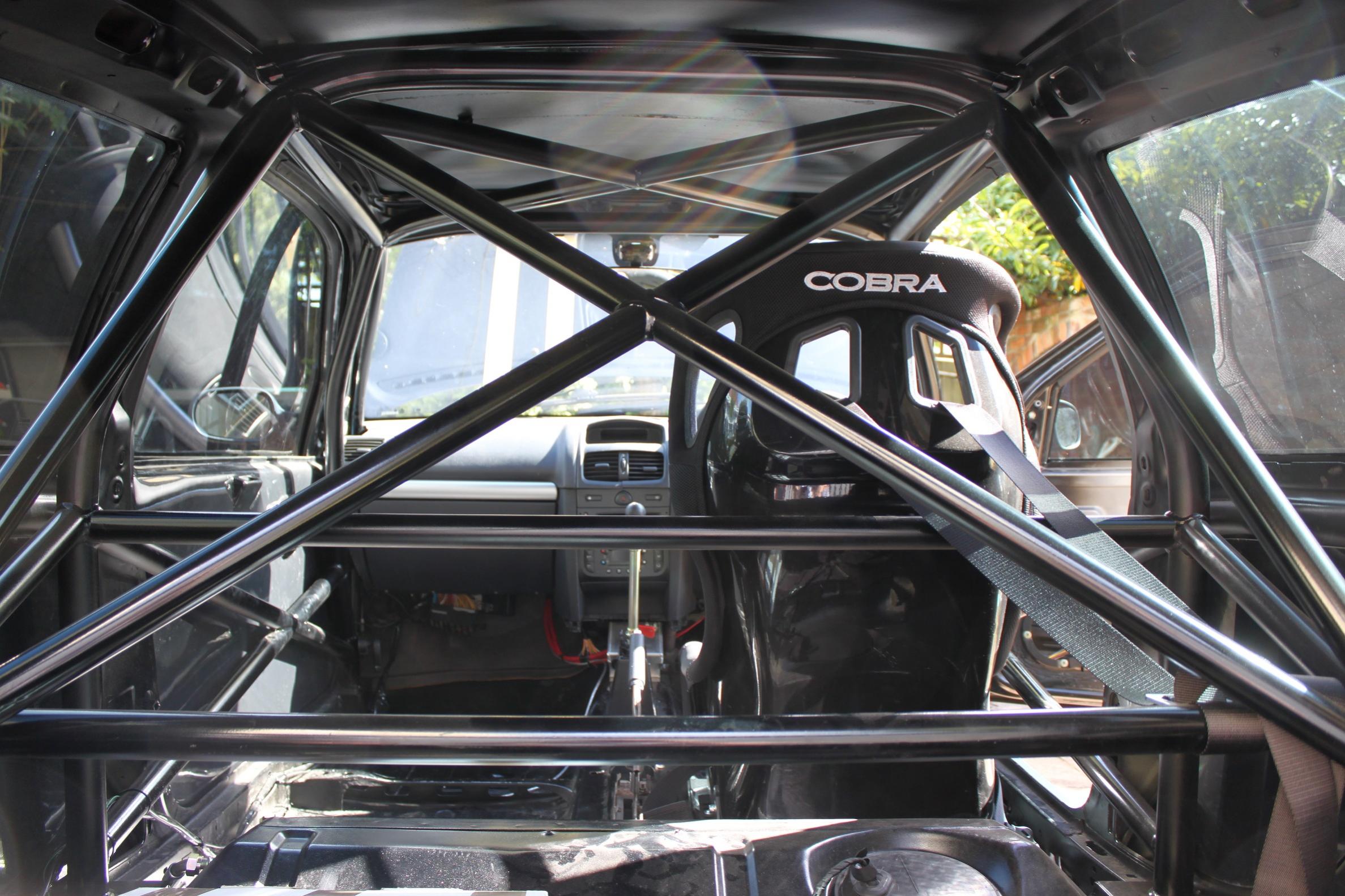

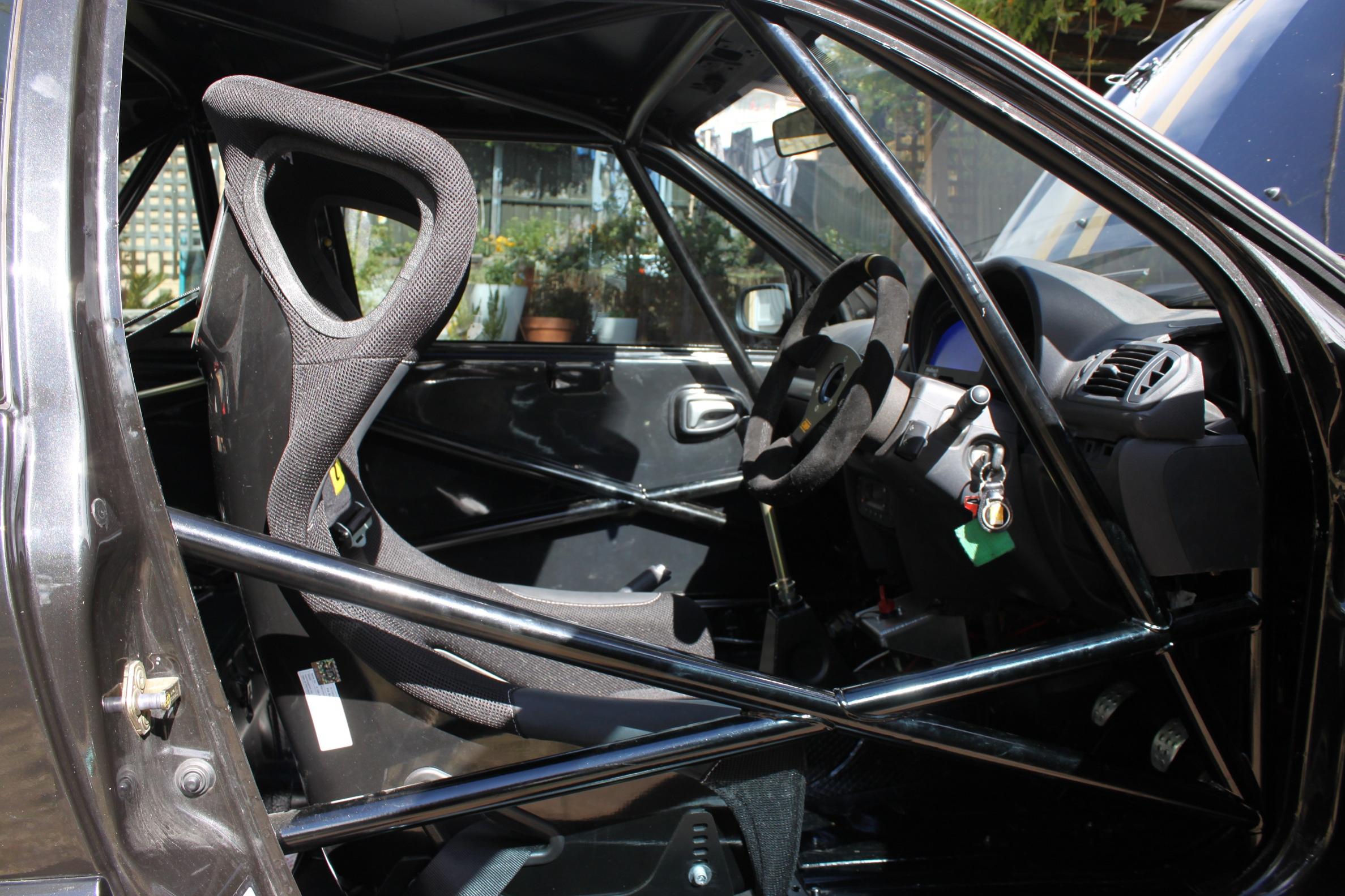

Fabricated CAMS approved roll cage

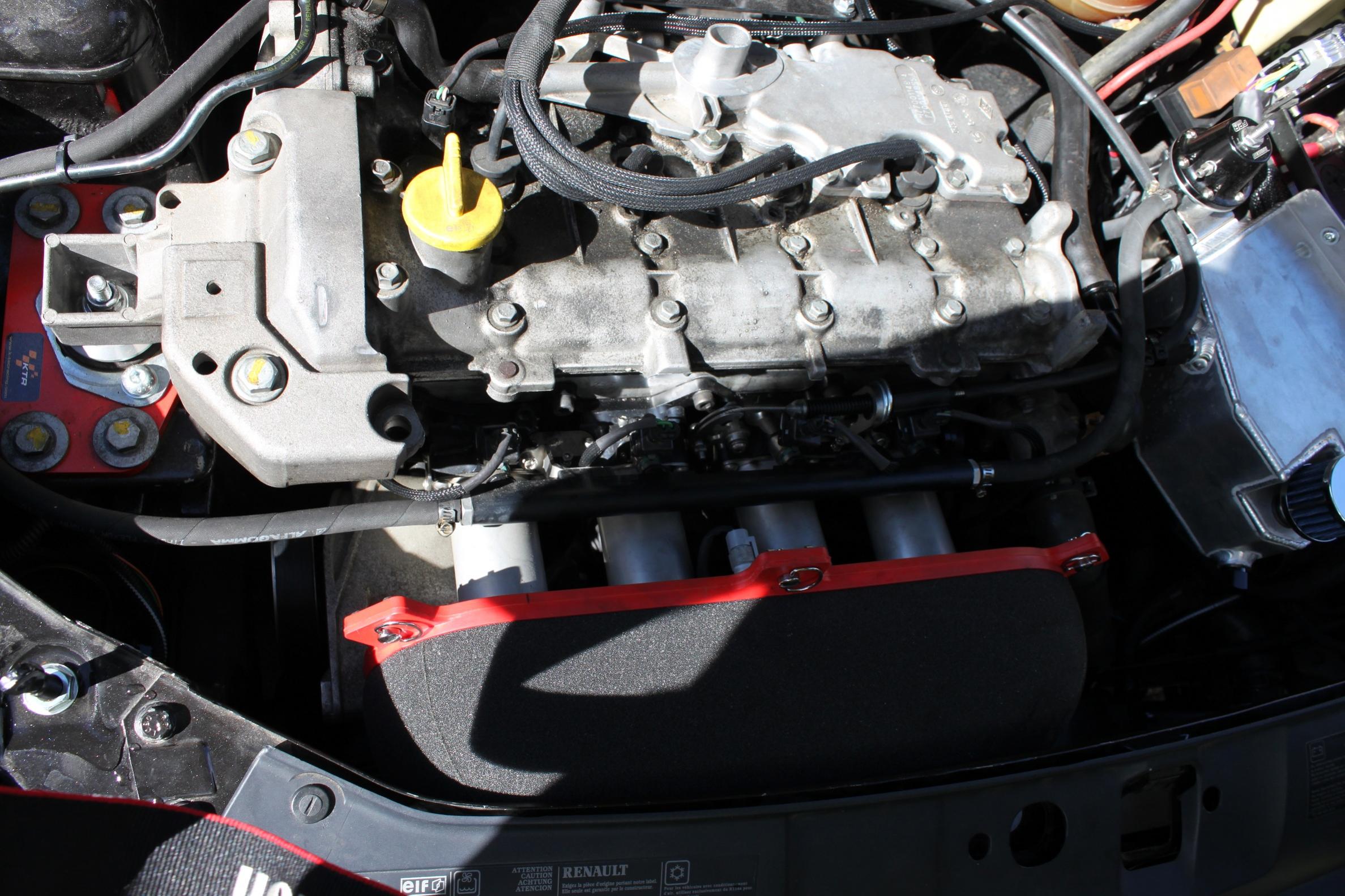

AT Power throttle bodies
PMS AC delete
PMS Shifter
Haltech ECU and dash
AST IIs
Wilwood 4 pots

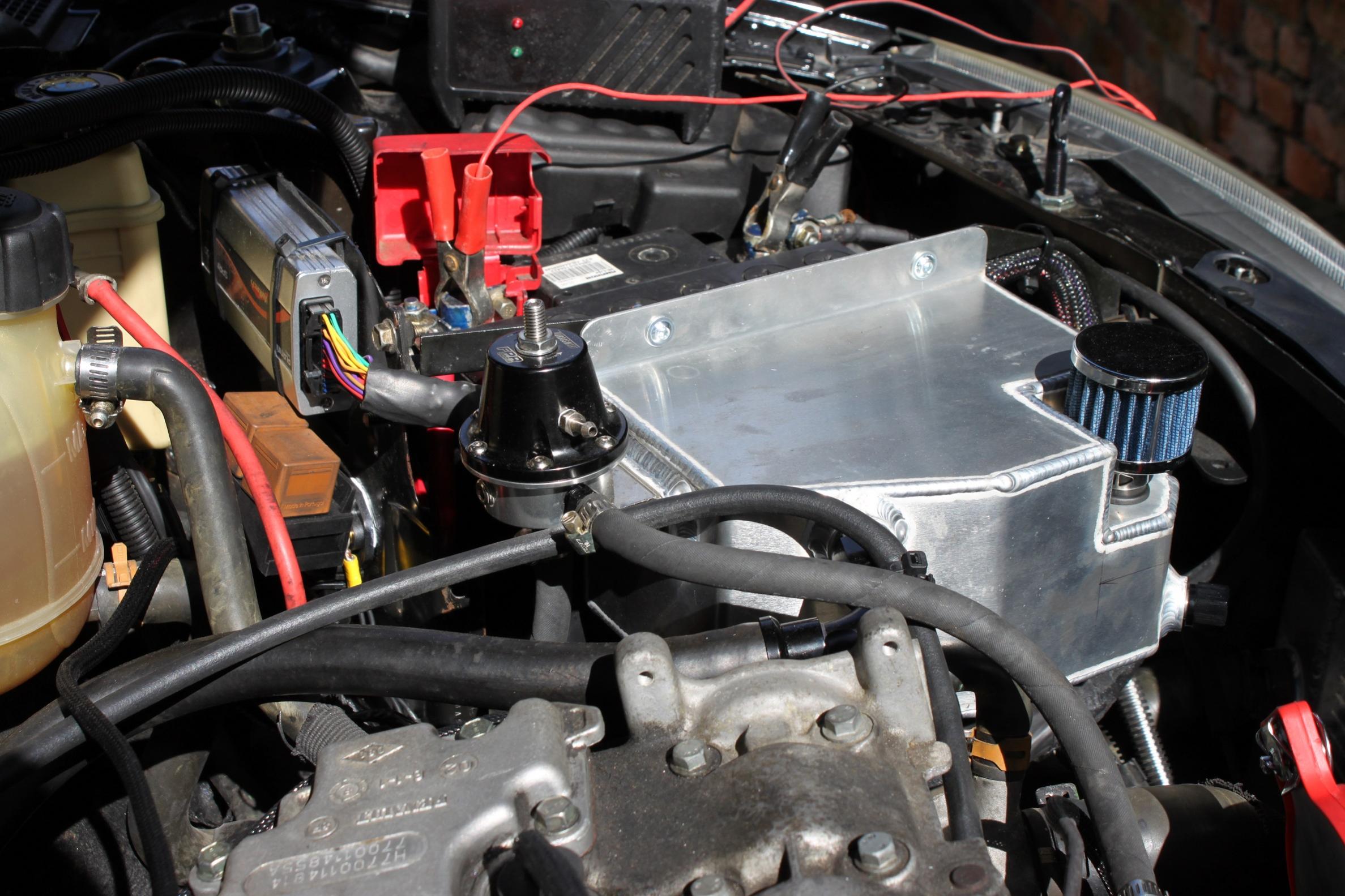

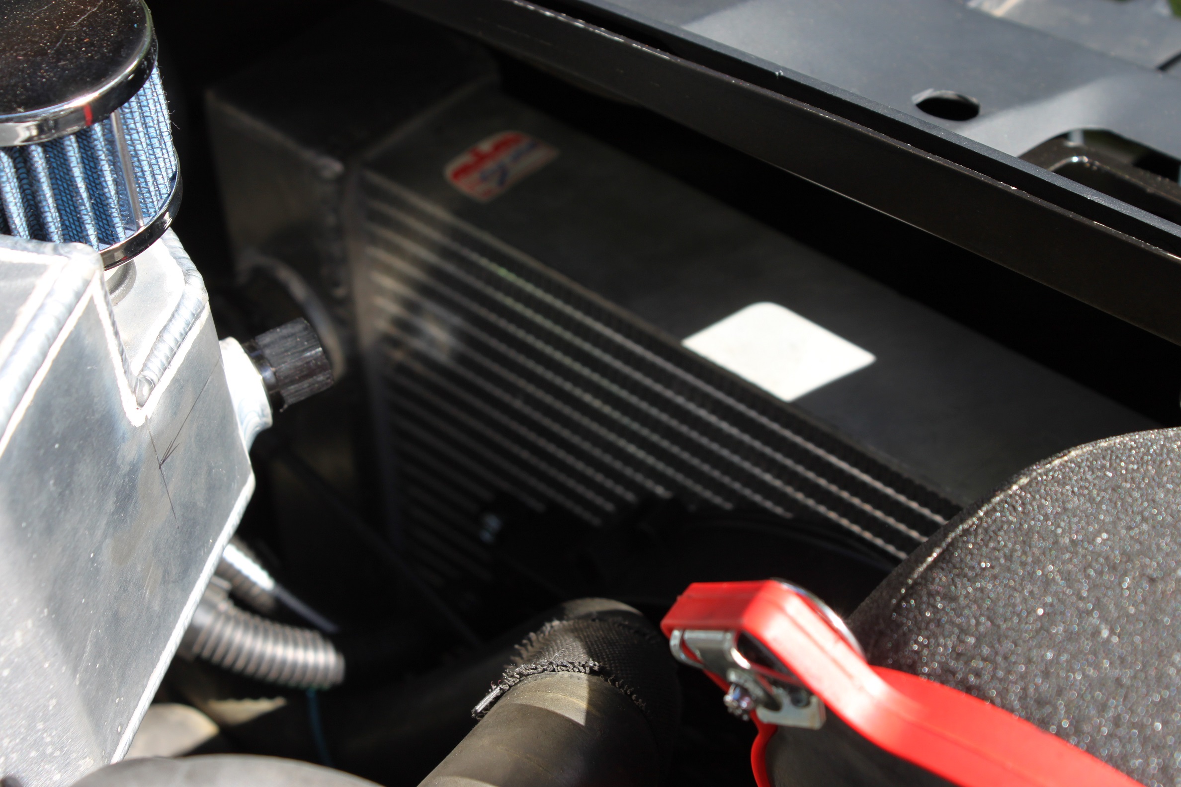

Fabricated rad and catch tank
170 atw
It is road registered and I plan to drive to the circuit and race in the Tasmanian Sports GT.

  Clio RS 172
So I took the car out for a shakedown http://racing.natsoft.com.au/635776308/object_859464.86Z/View?2 and it was awful! The brakes were crap and the rear end too soft. The turn in on tight corners was horrible. The gearing was also bad, for the tight stuff 2nd too low and third too high and on the long straight (Its a short circuit) it was a toss up whether to grab 5th or not before the end
Current work being done
New pads and discs
heavier rear springs (650lb)
Gripper diff
new cwp and shorter 5th gear
Billet flywheel and new clutch
heavier rear swaybar
Custom front strut brace
Hope to take it out again very soon to see the difference. Driving on the road with 650lb rear springs and gripper diff should be fun!
