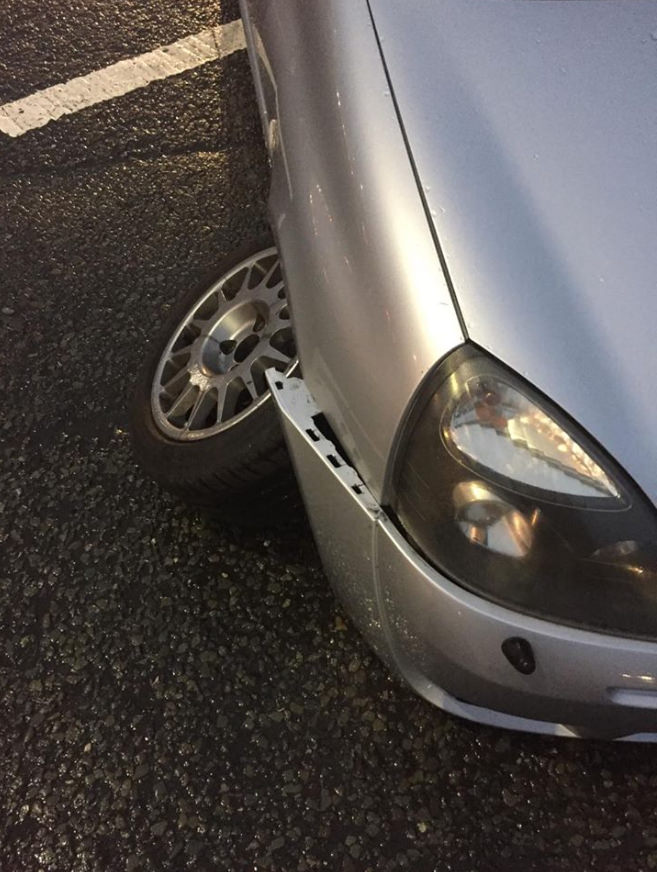

So he turned up, we looked around each vehicle and then completed the relevant paperwork. Sadly, the next day when I went to use the vehicle for work I had an accident.

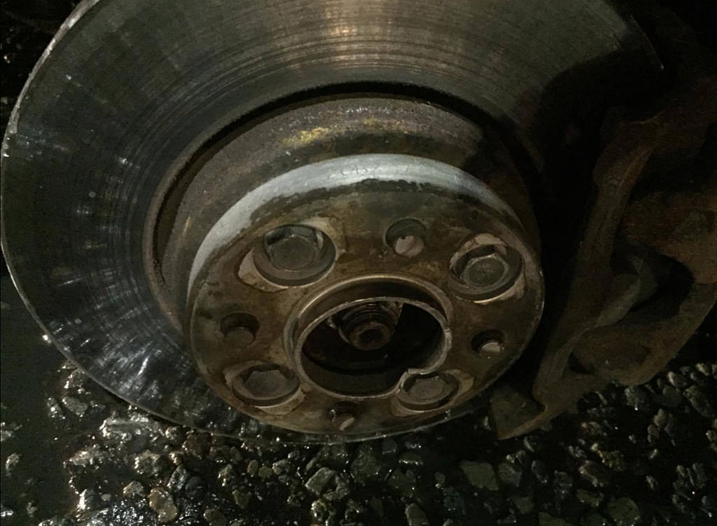

It turns out the nuts on the Pure Motorsport stud conversion had been overtightened, and they snapped on the drivers side! Thankfully it happened as I had just pulled off a busy dual carriageway in the wet, but still left me stranded and feeling gutted! I got the car recovered home thanks to an over inflated recovery charge but I just wanted it home at the time. The next day, I removed the spacers and stud conversion from the passenger side - and that was literally moments from the same fate! Stress cracks across the studs confirming that the nuts had been over-tightened. I'm not going to bad mouth anyone, as accidents happen and he did drive to me in the car so I'm 100% sure he wasn't aware of anything that was about to happen, and he seemed a decent guy when I met him to to the deal. That's used cars for you I guess...
Anyway I managed to fix the damage thanks to the local breakers and a few other places and the car was working again.

I'm keen to see more on the wheel failure and spacers.
Did the spacers have a lip on them or was the entire weight of the wheel on the bolts?
This was the one that caused the accident... All 4 studs sheered clean off but if you look at the metal where it's snapped you can see where it was stressed.
I've no idea what they were tightened up too but to get the passenger side to undo I had to stand on the breaker bar, and I'm not small lol.
I replaced all the bolts in all wheels and checked the hubs for any damage, all seemed fine and tightened them up by hand how I've done wheels on every car I've owned, and there's been a fair few of them over the years lol, torque wrenches unless fairly new or calibrated and checked can't be trusted IMO.
Same mate its not hard to know the diffrence between tight and f**king not getting these f*****s off like EVER!
My hub centric spacers arrived today, sadly I forgot to take any photos of anything but they are on (albeit not as easily as they should have) - previous owner had the wheels refurbed recently and the centre bore hole was actually smaller than 60.1 due to the thickness of paint. This is probably one of the issues with the failure of the old studs/nuts when they snapped as the wheel probably didn't sit flush with the spacer/hub so were then tightened up as much as they could be to get the wheel to sit flush (and in turn stressing the studs). After some sanding and filing of the centre bore on the wheel the spacers now sit inside as they should nice and snug but not so snug that they need to be hammered in! :(

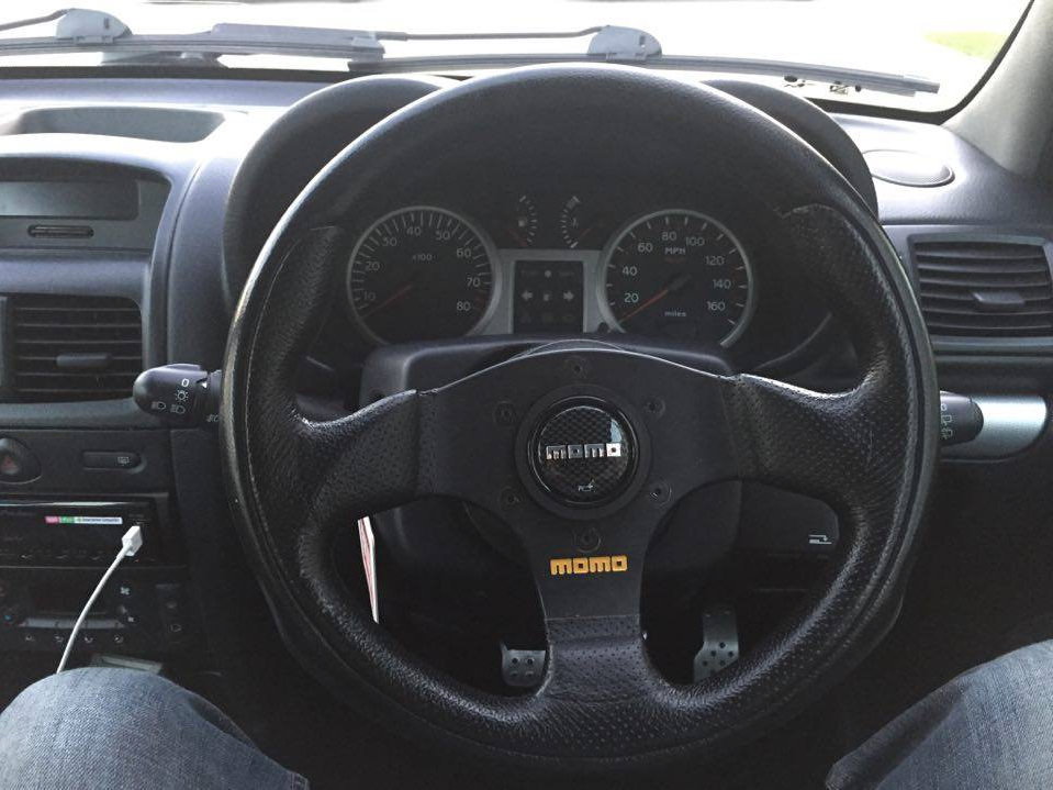

Also fitted my new Momo 280mm steering wheel and Momo boss kit - massive improvement over the standard wheel that is simply too big. The new wheel allows you to drive it so much harder, turn in quicker and just feels a lot nicer (especially as the standard wheel was also falling apart).
