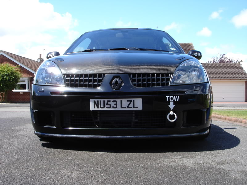

An OIL cooler IS A COMPLETELY DIFFERENT THING. It cools oil. A turbo sometimes spins up to 100,000RPM which makes it farking hot. It needs oil which it takes from the engine. The oil gets much to hot and extra cooling for the oil is required.
See blatant oil cooler mounted in the front of this car. Not a turbo, just driven hard, hence oil hotter, hence oil cooler needed.
