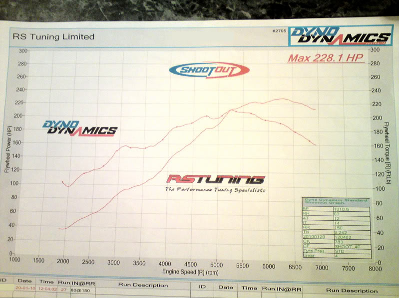

Got to be happy with that? what torque did you get?
I can't believe how well the mapping has come along from when I first had mine done @205.9bhp
really pleased thought it would only get between 212-220 bhp
Here's my print out from RS Tuning. :approve:

Scott will be well chuffed when he see's this as when he bought my kit I gave him a conservative estimate of 210, but looks like theres plenty of scope for more power.
Just a quick one though, what bore exhaust are you running? and have you ditched the cat?

its a scorpion exhaust dont what bore it is the cats gone got a de cat pipe from k-tec
