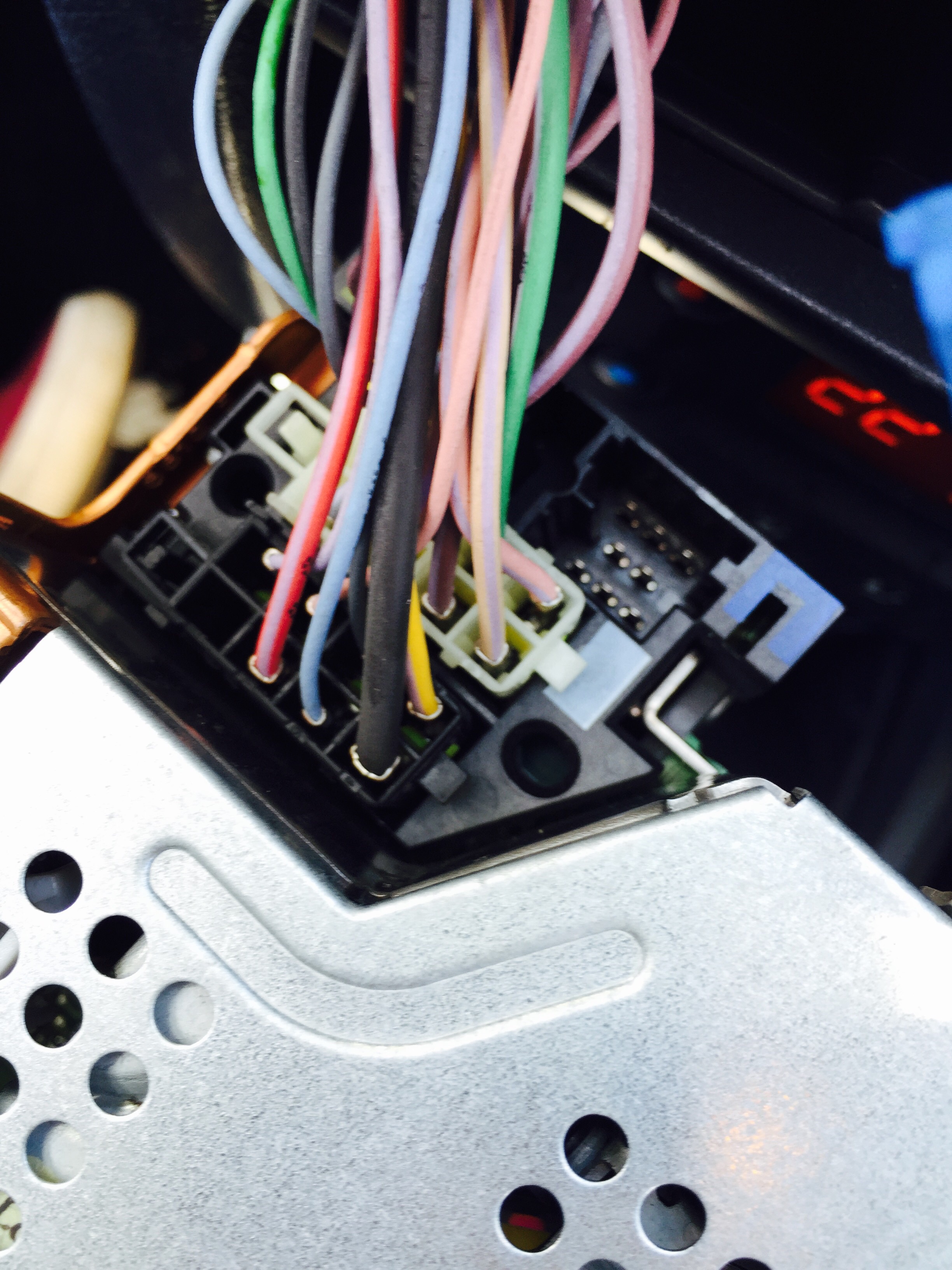

Aux lead arrived today..
I assumed this fat black one was the disc changer, so I unplugged that, and it was the disc changer. This aux lead connector can't fit, the pins are completely wrong! Any advice?
  SQ5
That fat black cable is your earth.
The cd changer is the blue plug socket with 8 pins to the right.

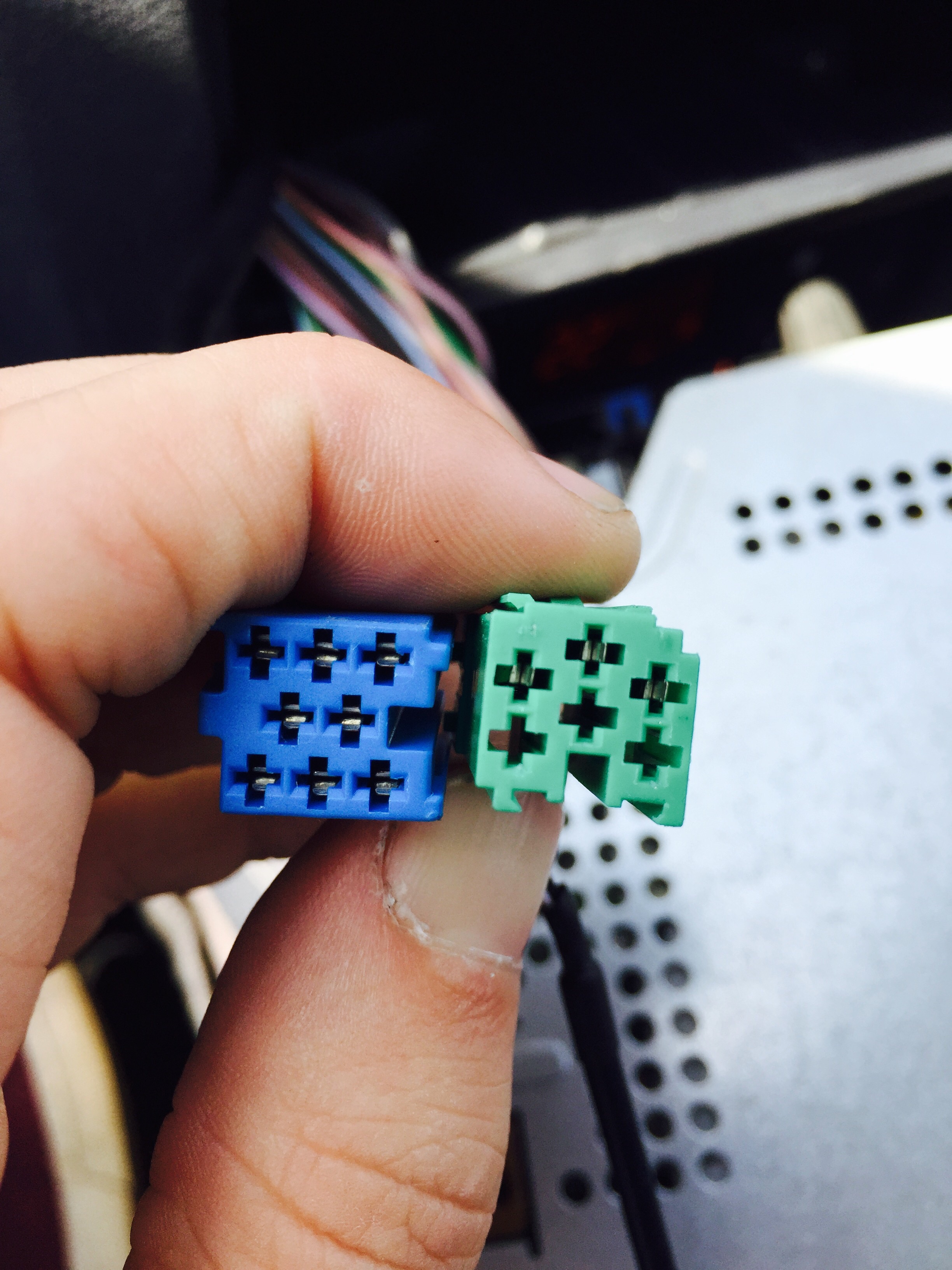

Sorry, black cable with blue socket. Green one is the new aux which is clearly different.

Wasn't it Update list that takes the aux lead. Tuner list requires Connects 2
This thread has made me question it, I got the info I posted from another thread on here but that may have been wrong, I'm nipping out soon so will find out which is which with my radio
