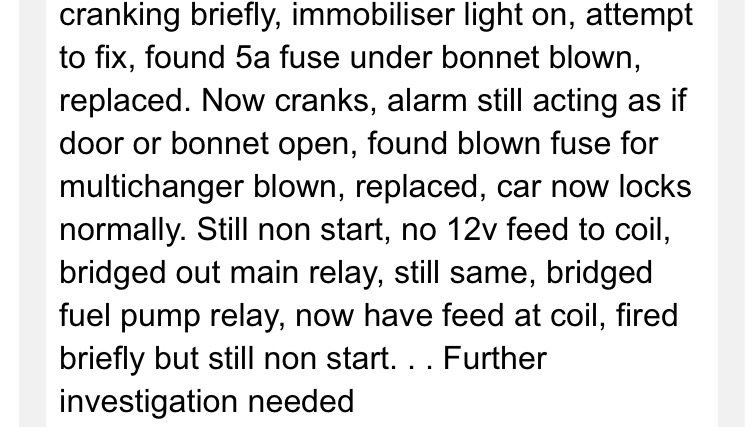

Update on this, bought a new battery and fitted it. Immobiliser light stayed red and wouldn't start.
Called the AA and I'm left with the heartbeat light on. This is a summary of what he did.
