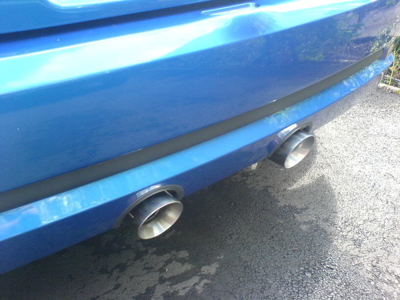

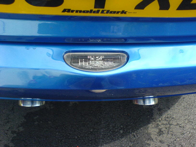

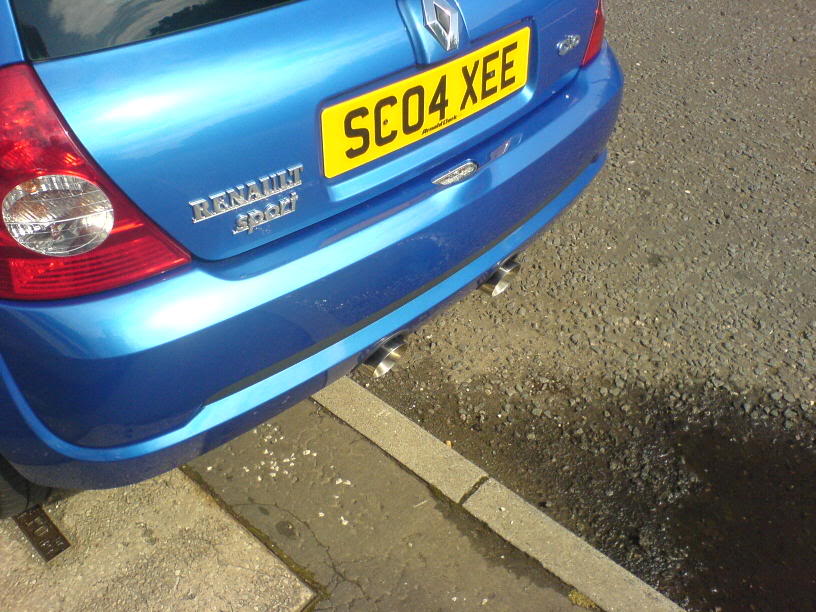

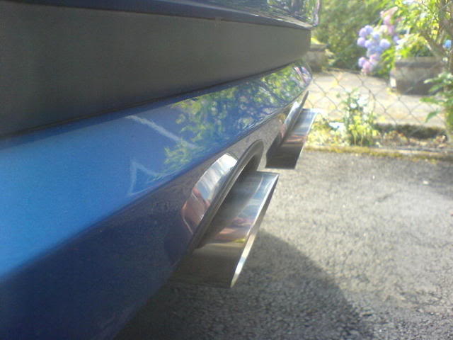

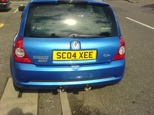

Finally got mine fitted, has been sitting in my garage for 2 weeks as I was busy, the guy who fitted it said it was one of the easier aftermarket zorsts he'd fitted, he commented that the welds were pretty good for an off the shelf system too. Although it was blowing very slightly at one of the welds lol but he gummed that and it will carbon up from the inside too.

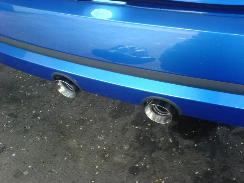

He positioned the tail trims pretty much perfectly IMO, they can be adjusted but I don't feel the need to. He commented that there aint much clearance between the cat back pipe and the heat shield, and to keep an eye on it there and if required bend the heatshield (or cable tie it) out of the way.
I started the car to a nice burble which it didnt have before and was something I always thought it needed. It's pretty quiet, a little louder than standard has a nice tone when you change down.
Other than that I will wait till its carboned up and bedded in a little before I make my mind up on if the car feels any different.
And now what you all opened the thread for, pics......
  Evo 8 RIP, Evo 2 tracktoy
looks fantastic. think that is one of the best positioned ive seen in a while.

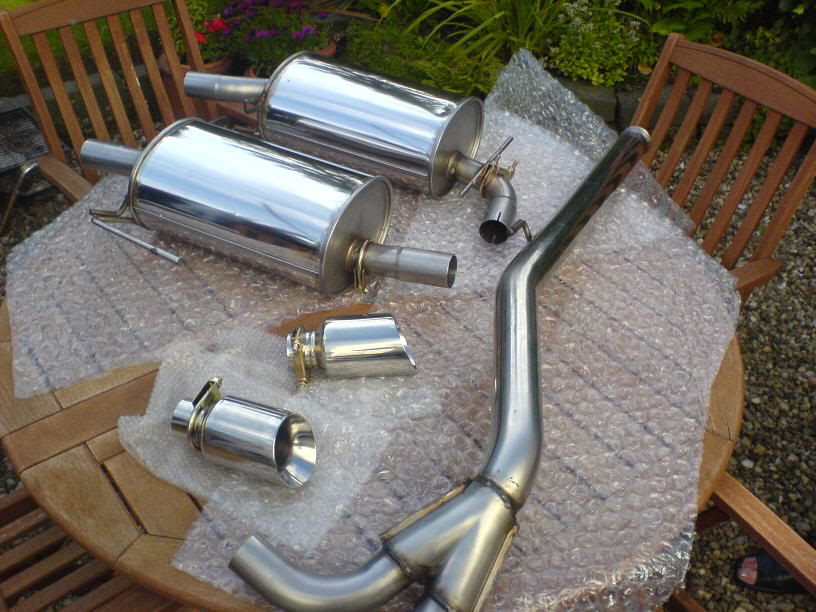

Looks good rory .What are the clamps on the tail pipe in the 5th pic down ?
  tiTTy & SV650
the actual tail trim (3.5" hard slash) is adjustable i.e. back n forward to make it sit as far out or as far in as you like.
I was thinking of sourcing a couple of 3.5" slash rolled trims to bolt on instead but I think it looks just right :D
  VW ....
looks like the clamps are for the end tail pipe section :S ,would have thought that should've been welded also .... unless adjustable

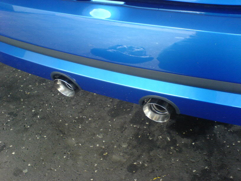

the tail trims are aesthetic, not part of the exhaust itself, the pic below should help clarify:

Oh right .I wondered what they were for . I guess you could have welded them on or like you say change them for different tail pipes if you wanted .

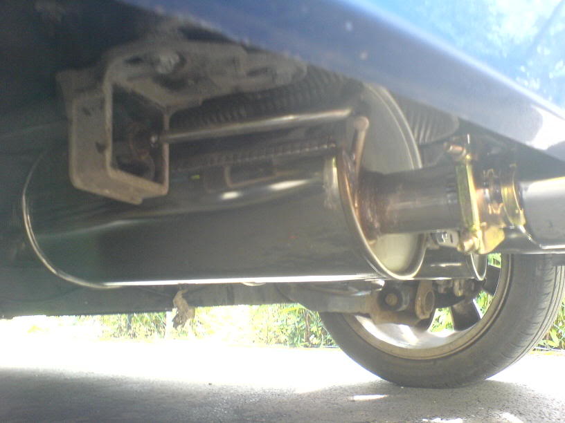

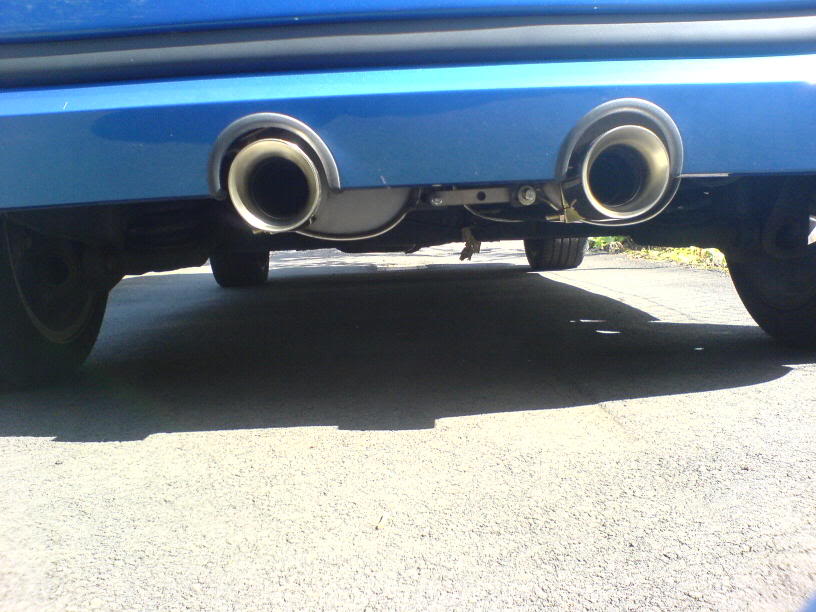

one more, for people who like to lie down behind cars and see if the silencers are visible lol

no rattles at all, they used a different clamp at the cat though, said once they opened up the existing u-clamp there was no way they were gonna re-use it.
