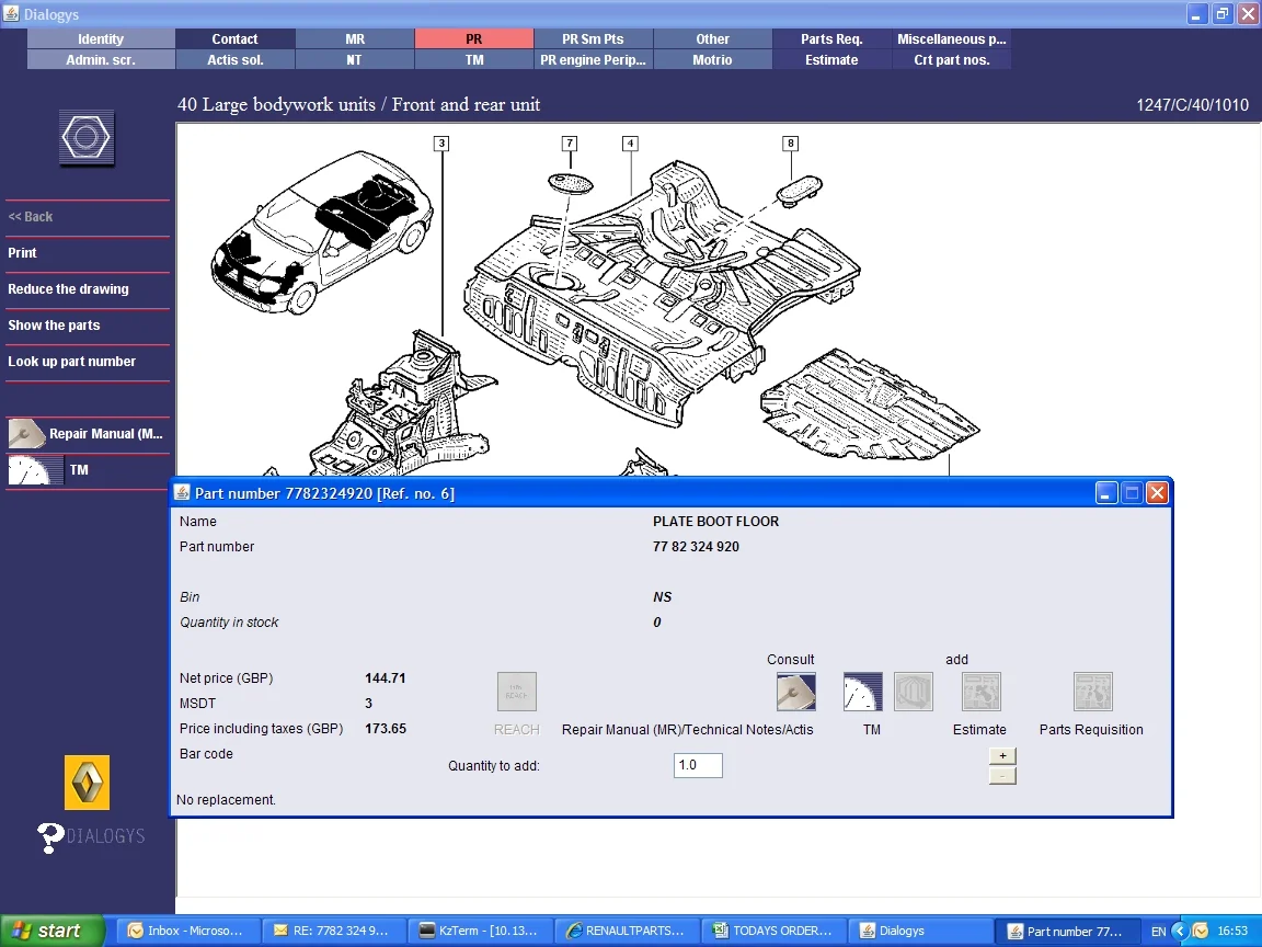

Renault actually do a piece of steel that fits perfectly in place of where the spare wheel well used to be. So you can just cut the wheel
well out and weld it in place, seam seal it and paint it, done.
I'll get the part number for you later on if you're interested.
You shouldn't just weld in a flat sheet of steel as it could reduce the impact strength of the rear end.
The plate you get from renault has been pressed into shape so it is almost corrugated (unsure on spelling) so it is stronger.

Jack, Renault have come good and provided a picture of the boot floor, have you fitted one of these?, do I need to purchase any other bits? Any other useful info would be greatly appreciated.
See picture attached, it’s the bottom right piece and looks to cover the whole of the wheel well.
