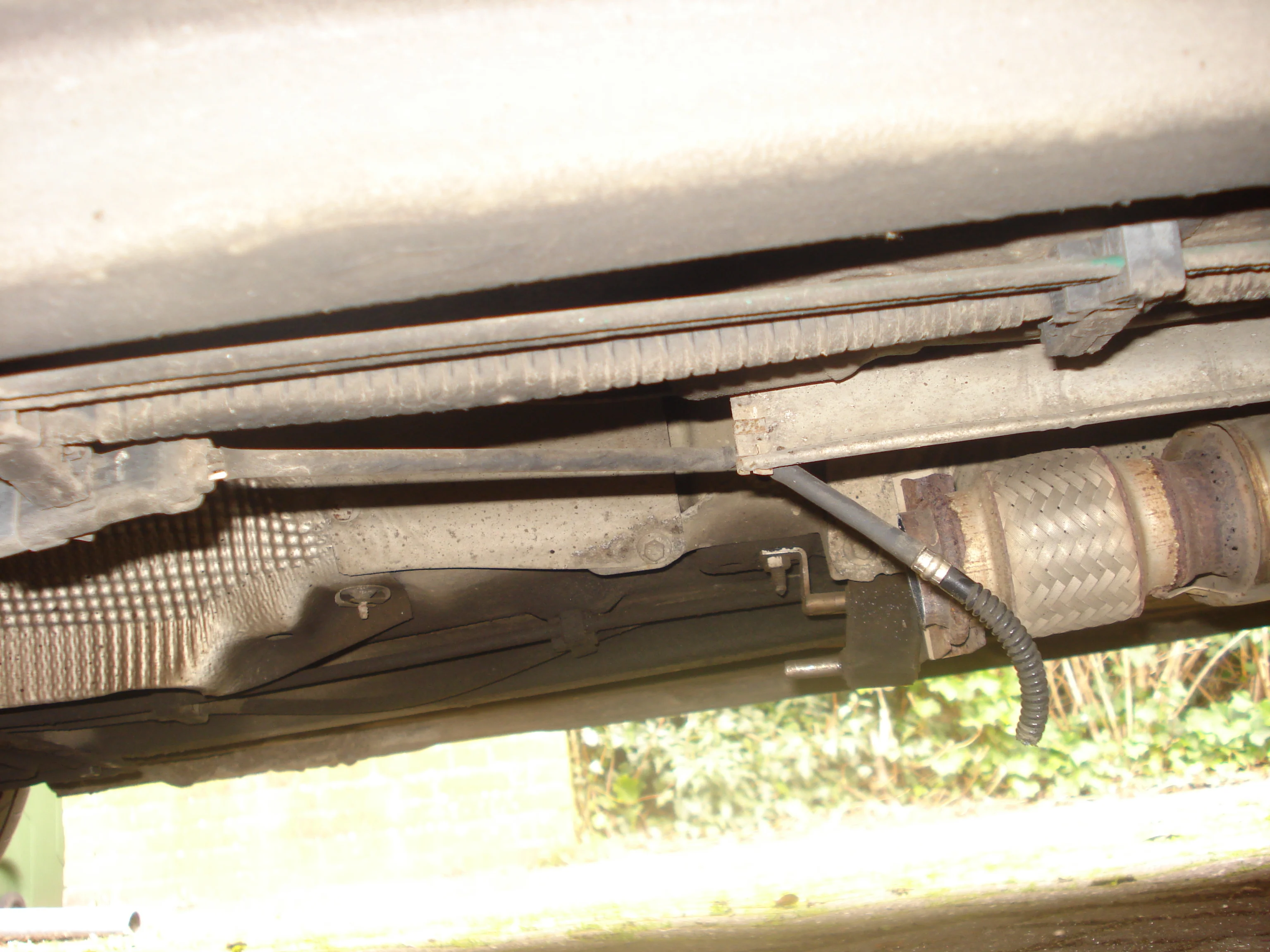

A couple of nights ago i disturbed some toerags stealing the cat from my Clio 182. Sadly they got away having cut out the entire section, through my aftermarket exhaust and through the downpipe. They took everything in between :(
I could do with some advice on what they actually took and how much itll cost to replace the parts. Because im getting some conflicting info from mechanics, insurance etc. Is it even possible to source an original cat?
The car is a Clio 182 16v 2005 Sport with a Scorpion Daytona aftermarket exhaust fitted a couple of years ago when the original exhaust system corroded into an unfixable mess.

If theyve damaged the manifold it's a subframe drop job to replace. You can pick on up for about £50 though. I'd then be getting a simple sports cat or decat that joins up to your centre section. Send some photos of you have them of the damage.

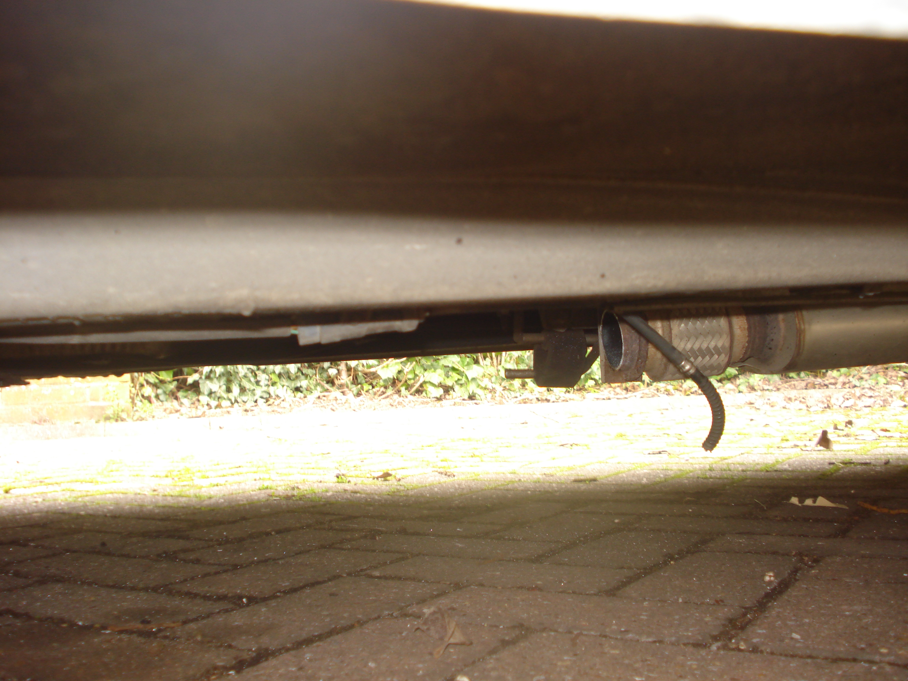

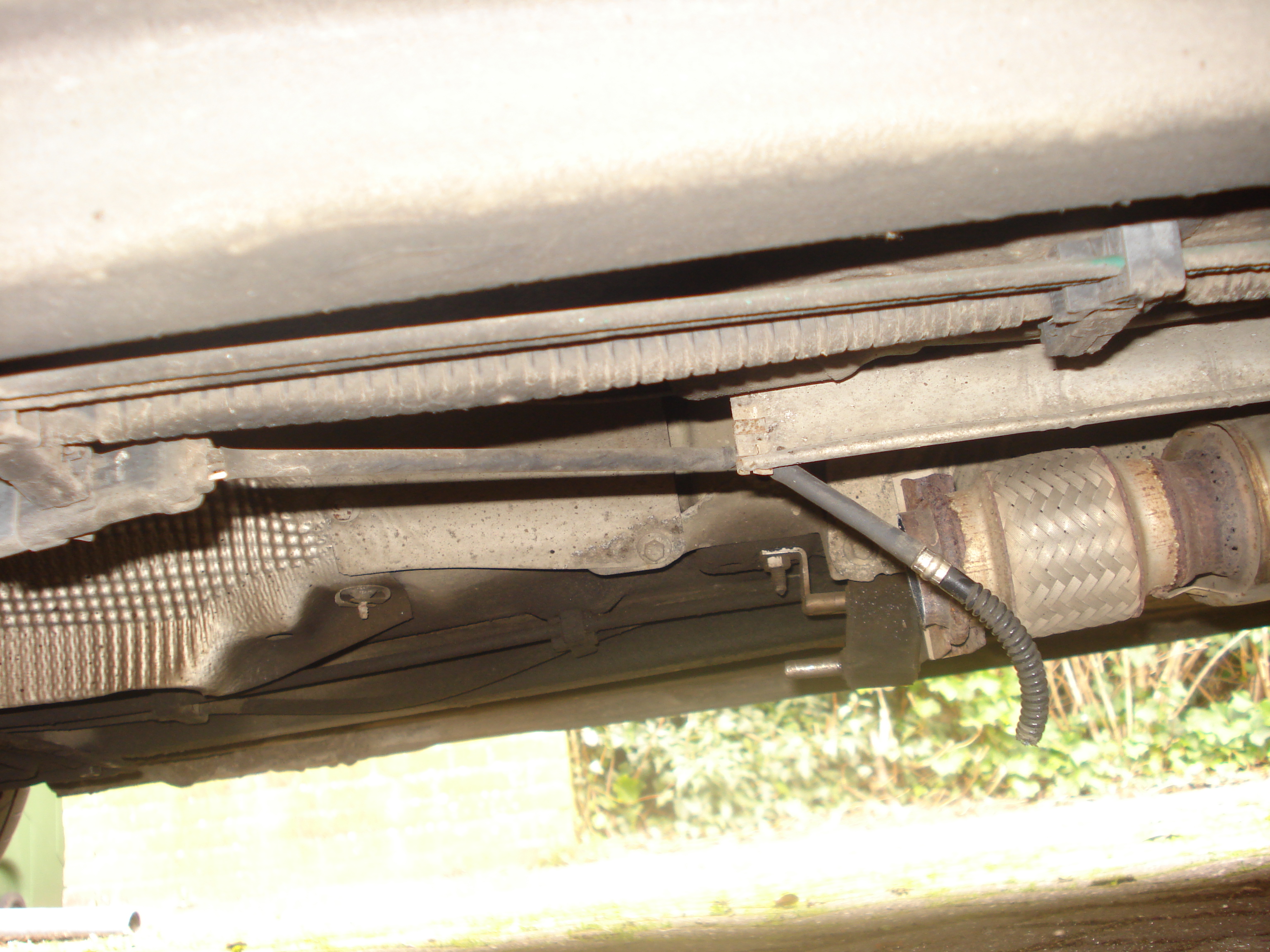

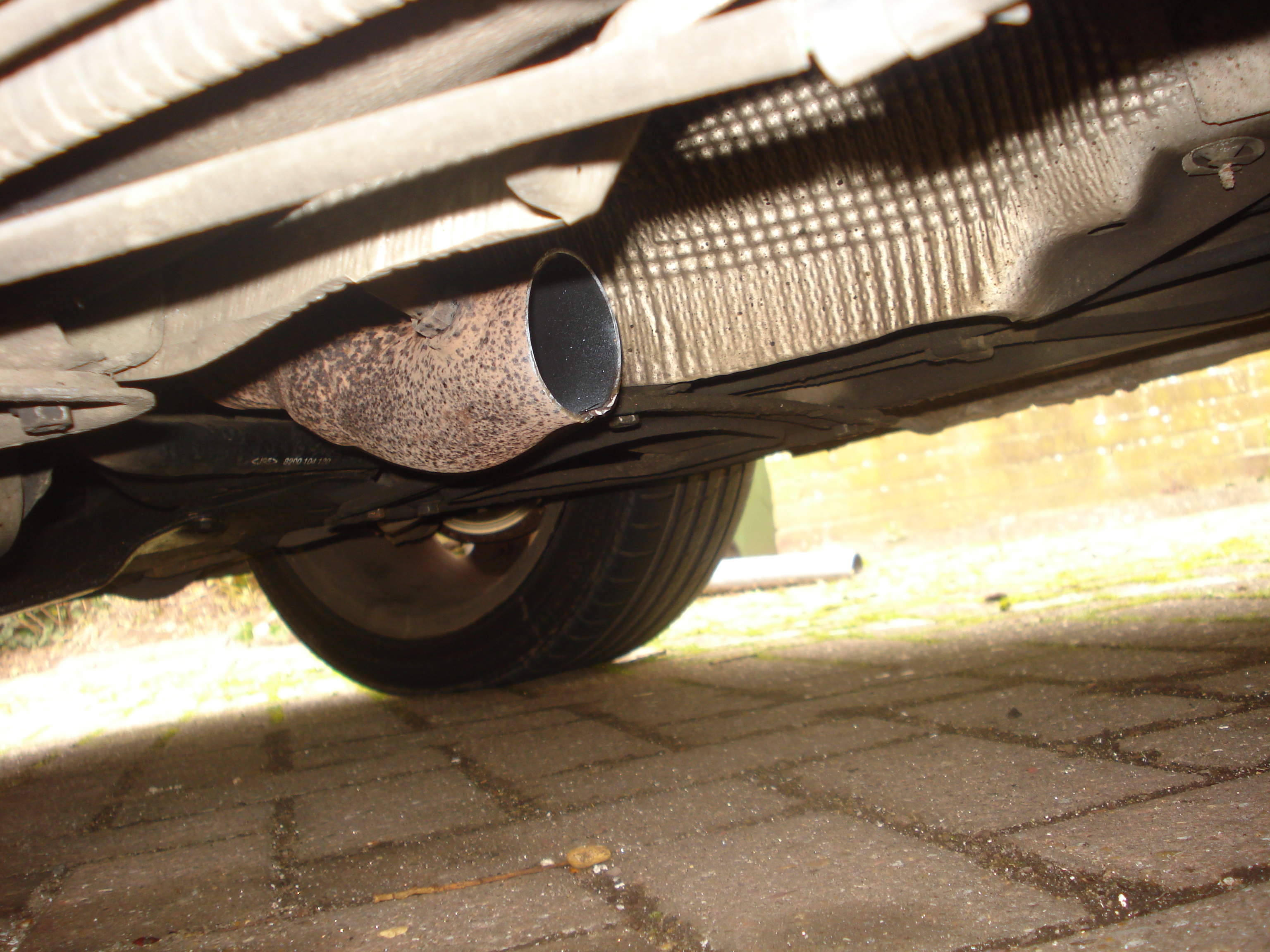

Kudos to the thieves that’s a nice clean cut at least.
Any exhaust place should be able to weld you a new flange on the manifold.
Then your going to need a new cat (probably aftermarket) and a lambda sensor.
Scumbags. Not the end of the world though, new sport cat and lambda sensor should be around 100 for a cheapo to 300 for a k-tec one and then get it fitted at a garage. Not worth getting rid of your car for mate

This is the item i really need u guys expert advice on cos ive been quoted through a Renault Dealership about £2,250 + VAT just for the cat!
That feels waaaay too much imo.
And considering the Daytona exhaust has one attached is there another one theyve taken between the exhaust section and the downpipe?
If you're worried theyll come back just get a cat for MOTs and run a decat. Either that or buy a cheap aftermarket cat off Ebay. They're not worth enough to steal.
You need 1 post cat lambda.

I'd go for the option of taking it to a proper exhaust place, getting them to weld on a flange or vband and do the same to the exhaust and weld in a section of pipe for the decat or an aftermarket cat

if your worried about MOT, id just get a custom exhaust place to weld a new flange onto that manifold then a new sports cat along with a pair of flanges or Vband at the exhaust side!
if not just do as above with a bit of straight pipe lol
