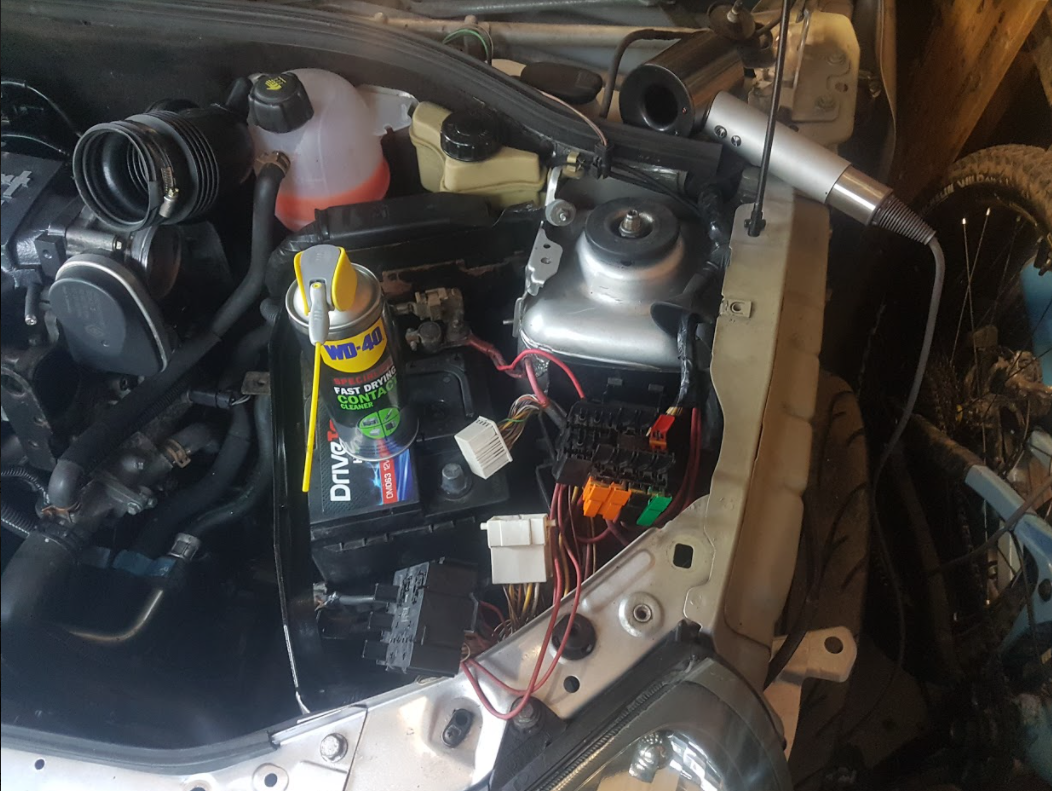

Hi guys, thanks for all the input here :) So an update on this issue... The cars now running!
I started by checking the relays in the engine bay, had them all out and checked that they clicked when 12V was applied. They were all fine. I also checked all of the ground points and again no problem. My plan was to also check that the pump was getting power as suggested but never got that far along in the system.
Reinstalling the relays and having another go at starting but the electrical warning light persisted along with everything else as per my first post.
Heading back over to the engine bay I noticed that the Fuel and Injection Locking relays were clicking really quickly. These are fed by the Small 30A fuse - wiggling it resulted in the clicking stopping. So at this point it seemed that the issue was caused by an intermittent connection from this fuse.
So trying to rule out anything else causing the issue I removed all fuses, relays and separated the white connector beneath them to give the contacts a good going over. I used a hair dryer first followed by rubbing the contacts with emery cloth then a generous application of contact cleaner finished with another round of drying.
I also replaced the 3 smaller (30A, 5A and 15A) fuses with new ones as the contacts on the originals weren't in the best condition. This seemed to fix the intermittent continuity fault from the 30A fuse and on reconnecting the battery no fast clicking from the relays could be heard.
Trying to start the car resulted in all the warning lights going out but the immobiliser staying solid. Waiting for the lights to go out and then trying resulted in nothing but a click from the fusebox, but trying to start the car straight away from the key in the off position meant that it would crank for 3 seconds and then stop.
At this point I turned the ignition key to pos 3, waited for all the lights to go out (except the solid immobiliser) then held down the central locking button on the key for 10 seconds before turning the ignition off and removing the key.
The car then started fine next try and has done several times since.
