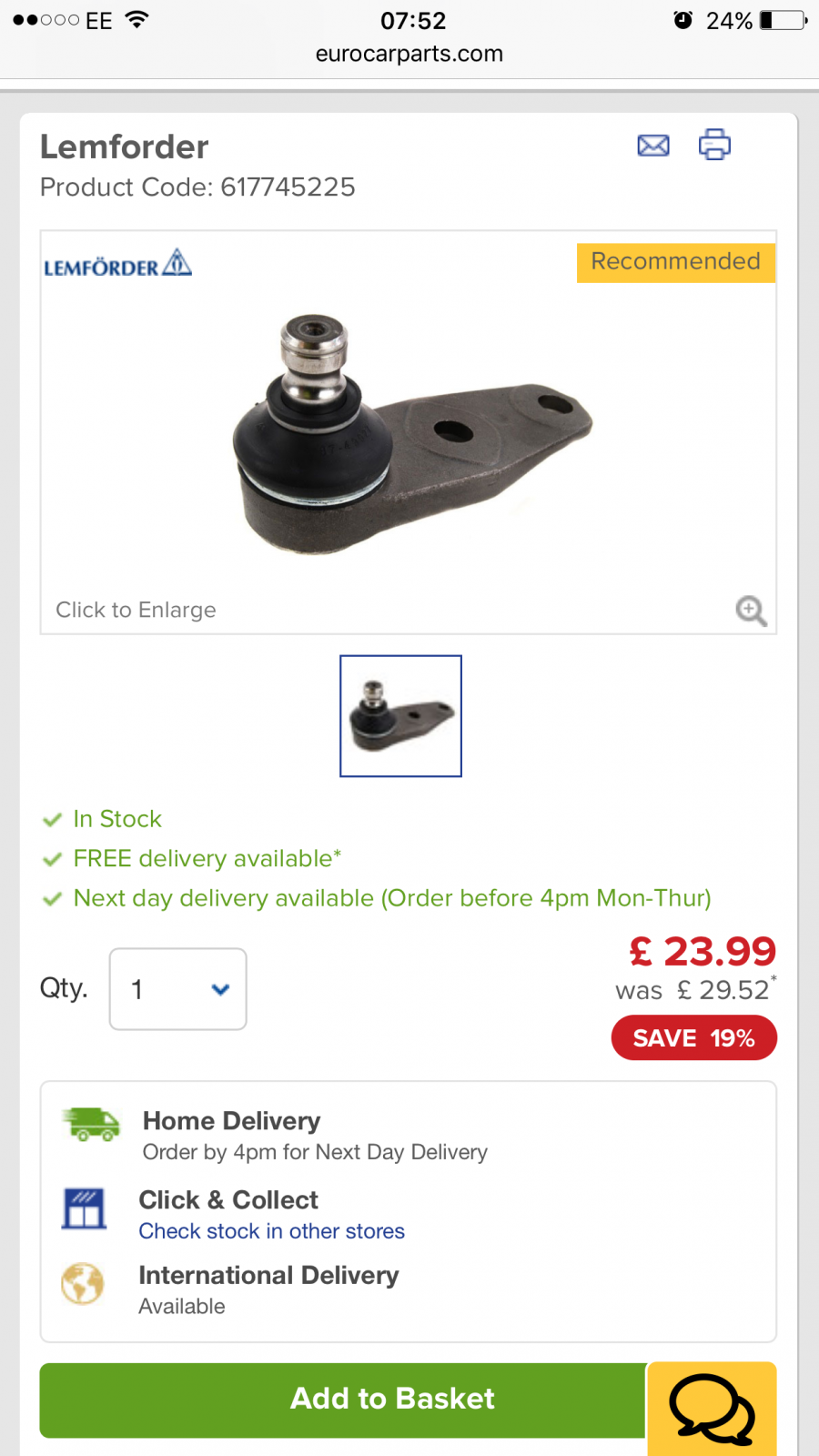

Hi,
Does anyone have the correct part number for 182 cup ball joints? I have received standard 182 part (with reg given) which don't fit
Thanks in advance
Amii

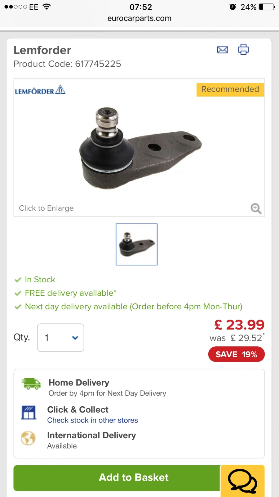

I did a search on here and found this lemforder part from euro car parts that someone had tried on their cup suspension 182 and was ok so ive bought two of them and fitting them hopefully this weekend

I thought all the 182's had the extra camber wishbones, and only the early 172's had less castor wishbones.
Thanks for all your help!
I've read up the bolts are 13mm for a cup and 10mm standard? Couple people here said 12mm cup, thank you for links!
Apparently the wishbones are the only thing thay is the same on standard and cup :s
