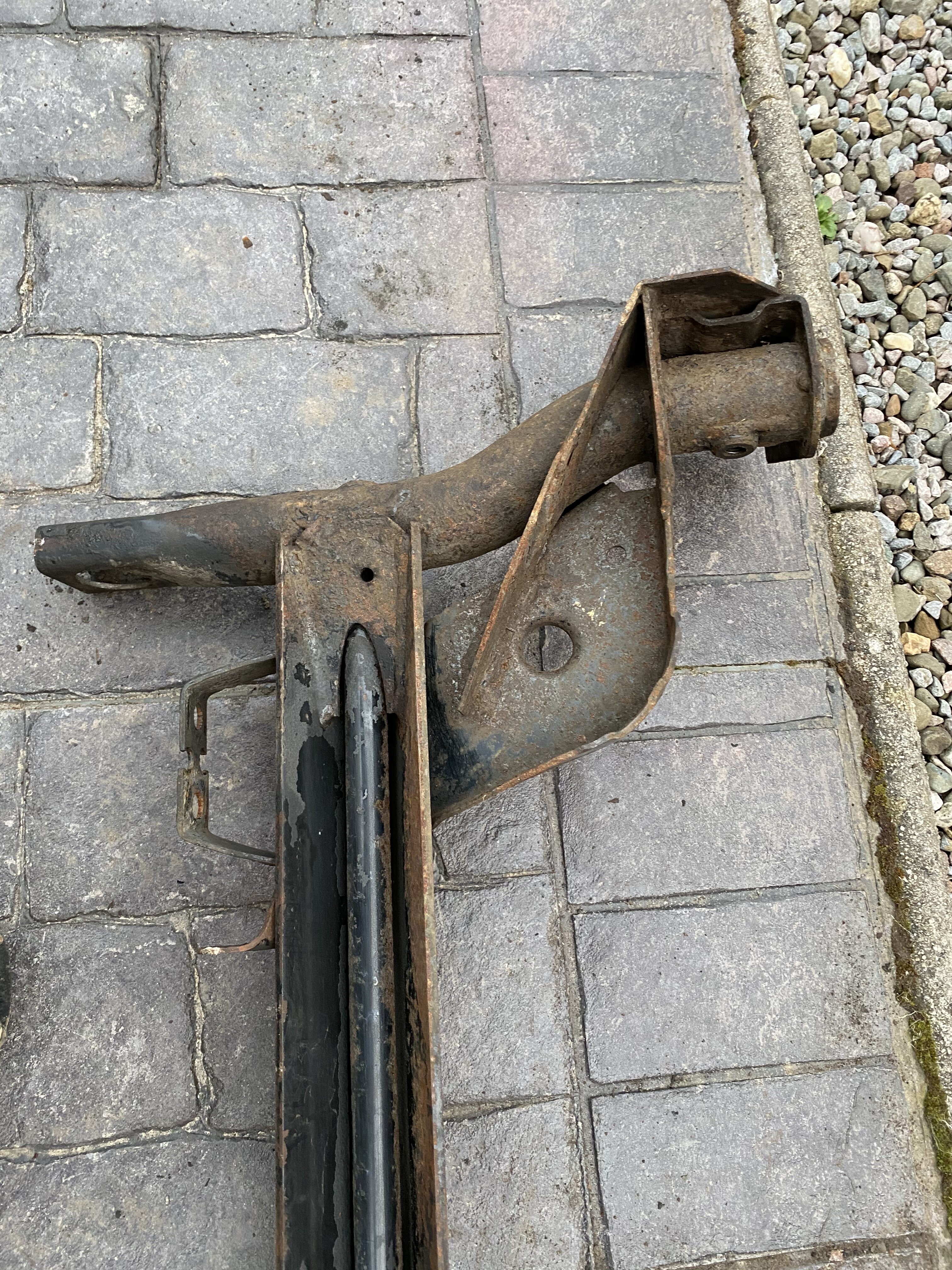

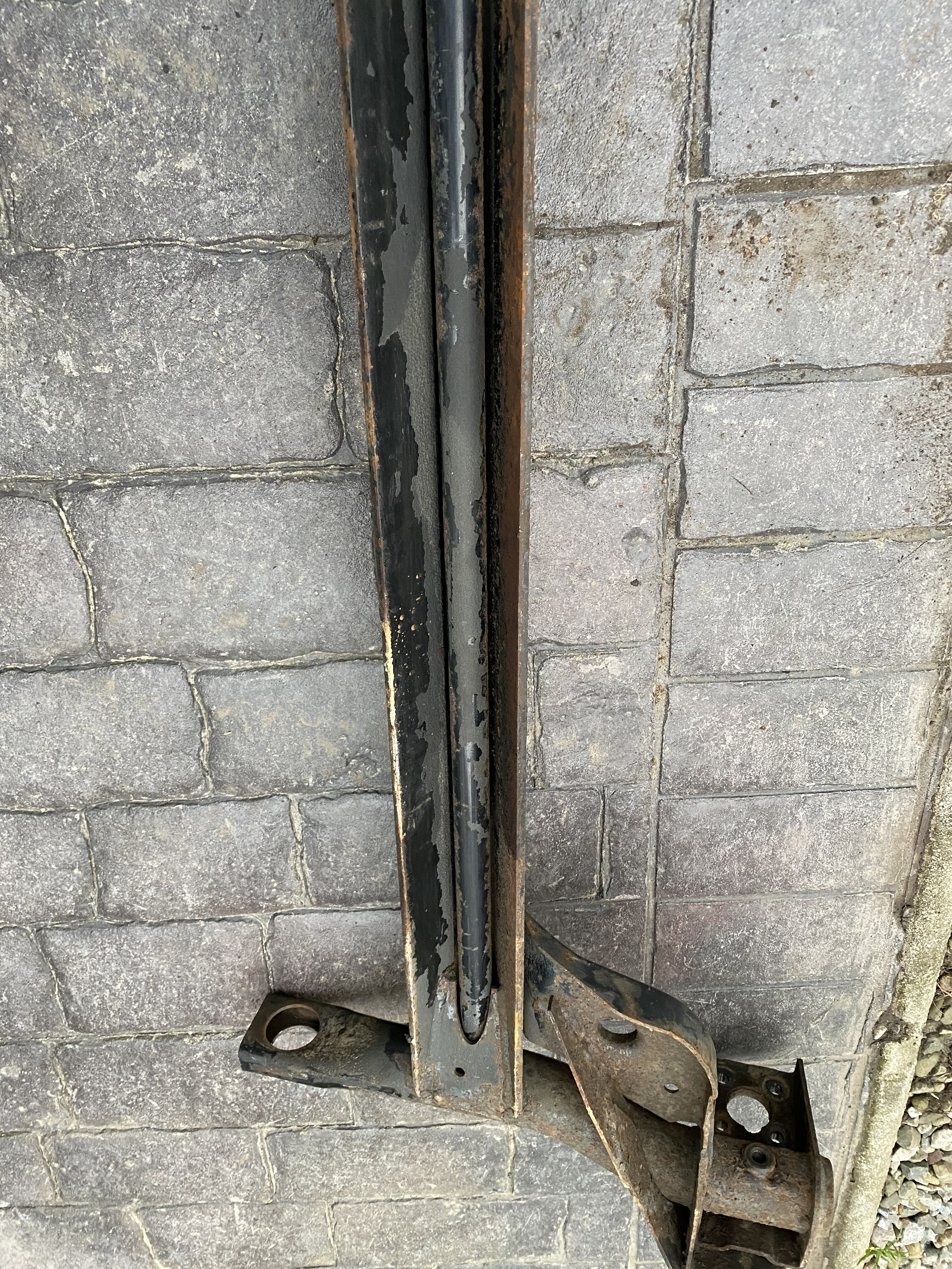

182 cup pack rear axle - any pics?
I believe the cup packed 182s had additional strengthing plates on the rear axle and a larger torsion bar. I've seen plenty of mention on the forum but no solid info on the differences.
Does anyone have any pics, or know well enough what it looks like to find some on google?
Cheers
They have diagonal plates on the spring cups that’s about it.
I don’t think the torsion bars thicker but I can have a look.
Just so happens I took some of mine this morning before dropping it in to be blasted, think the torsion bar is 2mm thicker
