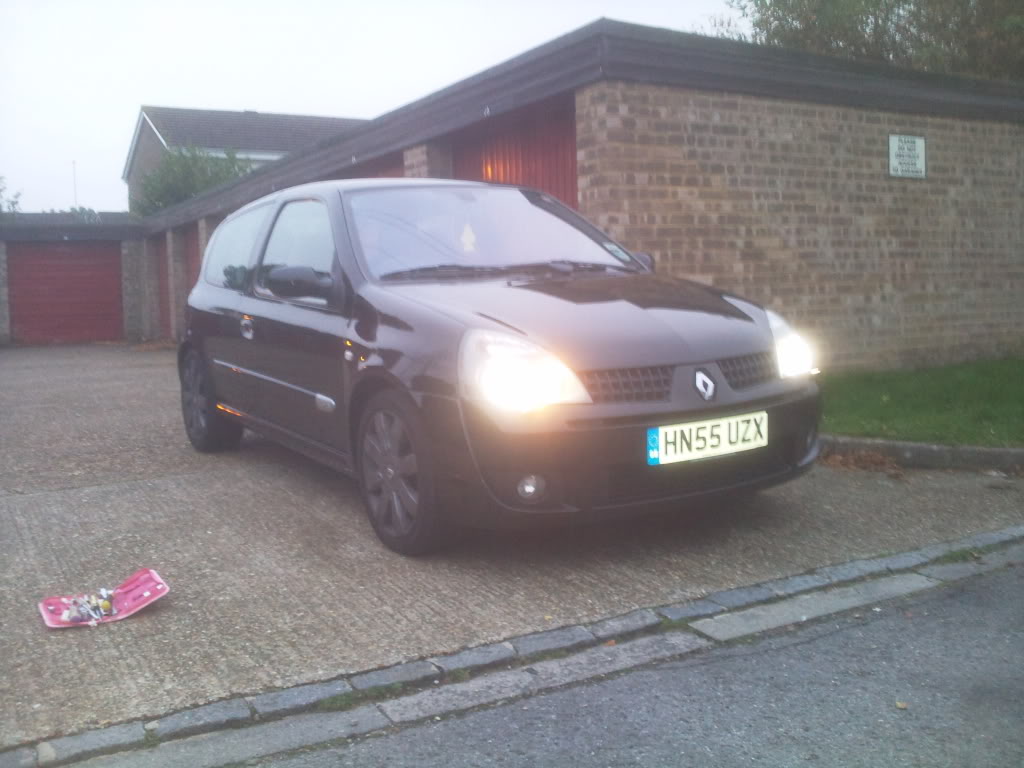

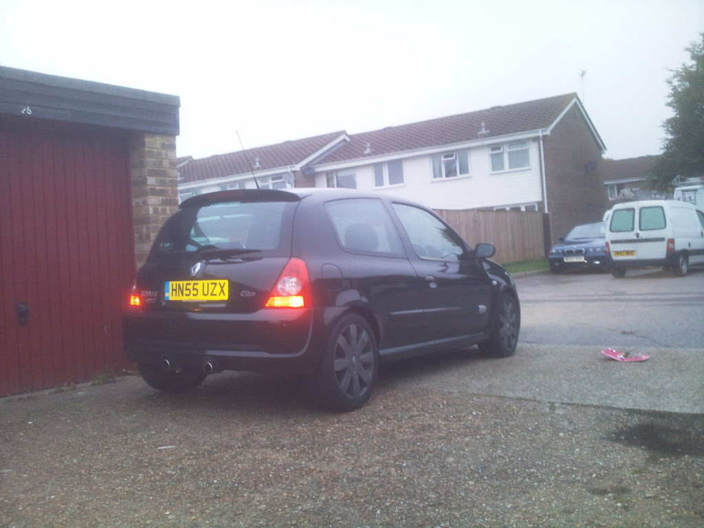

heres a pic of my car if u can tell from that
  Fabia vrs tdi
looks about the same hight as mine but then again i think there is only 15mm of a difference but you have same alloys as me so should have cup suspension
do u have the cup spoiler ? i have mines but missing my splitter the last female owner cracked it

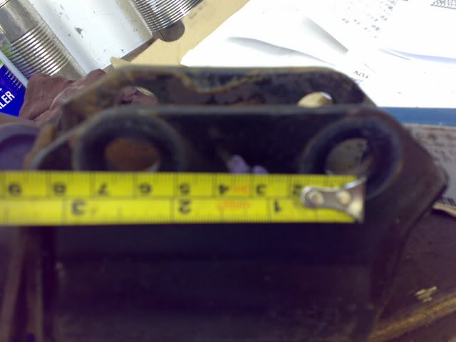

There is. The bands are different colours on the springs. On my 172 cup they are Yellow and White, cant remember what colour the 182 cup ones were (did have one). Only real way to tell it has cupped suspension is to mesure the bolt spacing on hub/shock mounting points. Should be 60mm.
here
Lol. Where did you get that from?
There is 3mm difference between the height of a 182 and a cupped/cup 182.
