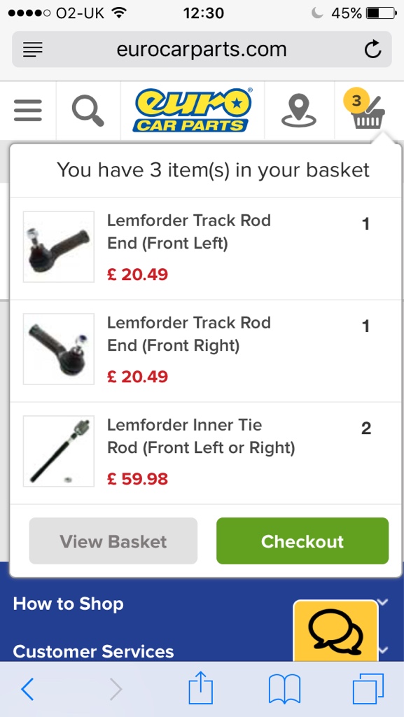

I got the Lemforder TRE's and wishbones from ECP, the wishbones came with ball joints.
