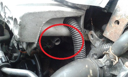

Everything appears to be correct in the enginne bay, the only thing I have noticed is this:
Front right of the plenum.
Should there be some kind of pipe on here and if so where does this connect to?
Would this cause any of the problems I am seeing?

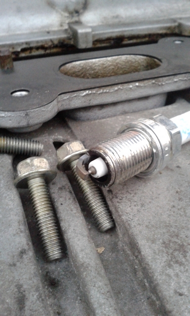

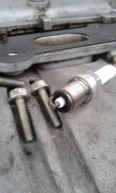

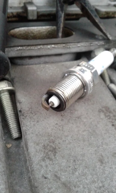

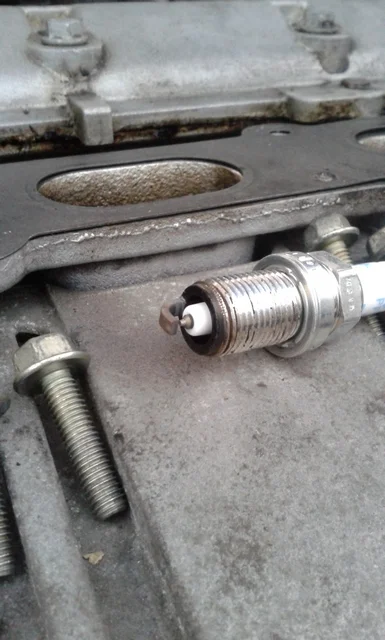

injector on its way out, let it idle rough for a bit, check for a blacked up plug. note which pot its on and then swap injector from that pot with a 'clean' one. clean all the plugs up and refit then fire it up and let it idle again. check the plugs again and see if the dirty plug has followed the injector.

right cheers coops, just had the plugs back out and they all look in the same condition to me
All have clean contacts with a blackened ring around the bottom edge. Do I need to clean then up and see if one blackens up straight away?

the plugs look good, perhaps not an injector then...... unfortunately sound like it could be one of those impossible to trace wiring type issues.
