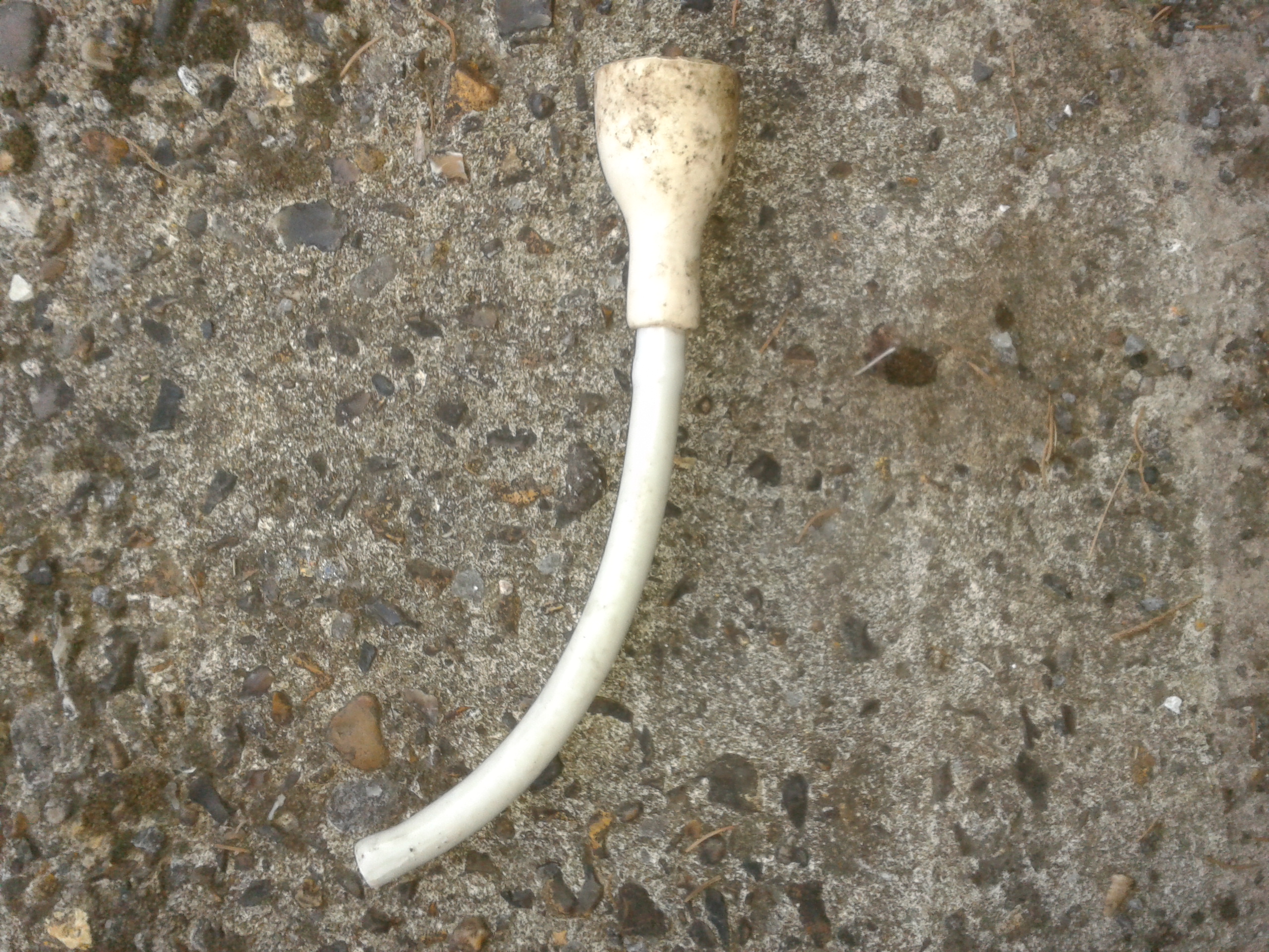

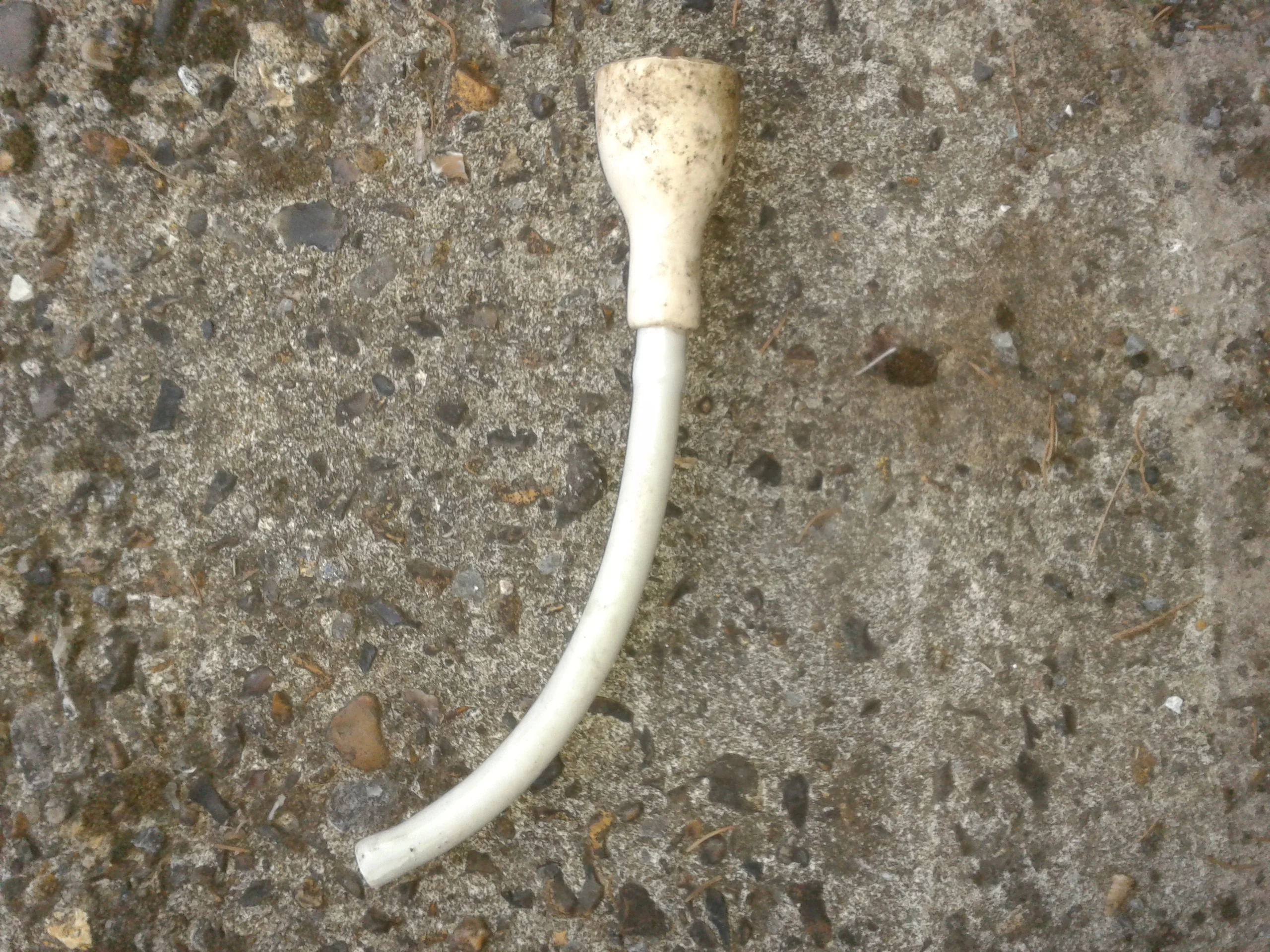

They were £26.00 each. The car is 2001 Clio Mk2 1.2 16V. The driveshafts would fit a range of cars, plus they're been made much stronger. Only thing that I can think of which was awkward was filling up the gearbox. Everything else was simple.
Was that from J&R?Posted this pic before,but for those that missed it. 2015-10-01 18.10.49.jpg Easy way to fill gearbox.
Yeah from J&R. Seriously such good quality. The customer service wasn't too bad either if anyone cares about that sort of thing? That hose would been perfect, I just flattened the bottle a bit and crammed my hand down. Think it was just under 3.5L worth I put in. Next job is front fog lights, not working, need to check if any voltage is applied to the bulbs, might be simple as new bulbs. Although the warning light for front fog lights doesn't light up either?

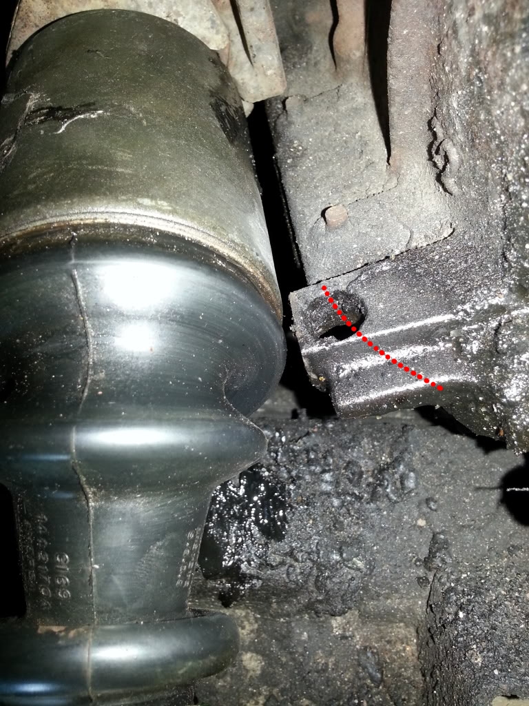

J&R get a bashing by 172 and 182 owners because their CV Boot on the drivers side is too wide, This causes it to fowl on the engine block and split.
Easy to fix, you just replace the Boot with a Narrow one for £10 off ebay, or you trim 8-12mm off the engine block (which is what i did as it was a little pointy out bit that should have been trimmed at the factory)
Its really unfair to bash the actual shaft due to a simple boot issue, Loads of people refuse to use them just based on that and would prefer to buy a shaft at nearly 3x the cost and 1/2 the warranty.
How long ago was that?@EDGES fitted a RH J&R shaft in January this year,and commented there was no clearance problem with the boot.
Perhaps they have changed the boot for a smaller diameter one.
Well that's disapointing mate, that was the genuine part number that they supplied to me but as you pointed out it was in 2013.
Dyno is on Mon now so will let you know how I get on.
Was say 8 months ago now?
Mabey they made a mistake on my boot and they have changed it?
What i found was the boot was actually clearing it, but was very soft so when it spun it would flare out and catch the engine block
